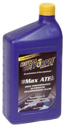

How about this?

I put some Mobil stuff in mine about 10k ago... I don't think it was full synthetic though. I have a new transfer case coming (should of been here the 6th, I wanna scream at FedEx) and that case is supposedly filled with whatever gm is using these days. Dex VI I guess... I'm switching everything over to royal purple though so don't know how long it'll be in there.... I think that stuff best4x4 posted is the stuff. I think my owners manual said Dex III type-h and that royal purple stuff was good to use. But I don't know if it says for use with Dex VI though....
Best4x4
1,042
Vidor, TX
That RP stuff is supposed to be multi-spec for a wide range of fluids like Dex III, but I don't think they certify it with VI yet. All my BW Transfer cases in my Jeep's the 231/241 all took ATF4 and I know that stuff is fully synthetic and the RP is compatible with that.
I think its pretty cool that a brand new t-case comes with fluid already in it. That way you never change fluid. You just change the whole case every 60K (if it makes it that far).

So here's where I'm confused.... My 06 manual says dex III type h or something like that. I'm using a Mobil atf fluid compatible with the dex III... I have a new transfer case on the way and have royal purple max atf to put in it. I'm assuming my new t case will come with dex VI since that's the latest stuff from gm. Is it ok to drain the dex VI and fill it with the royal purple. I can't imagine it makes much difference. Just wanted to be sure.

Yes, it's OK.
