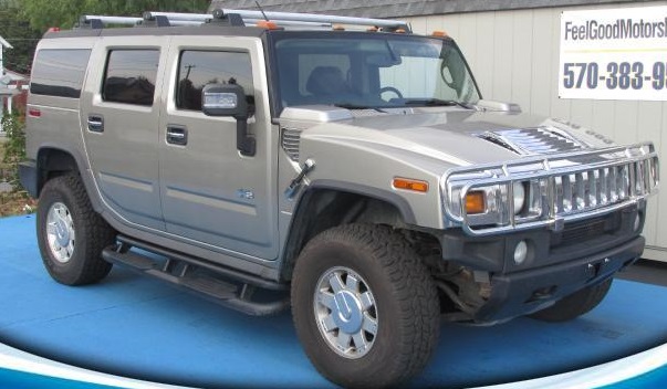

I did a cam in my '03 and milled the heads.

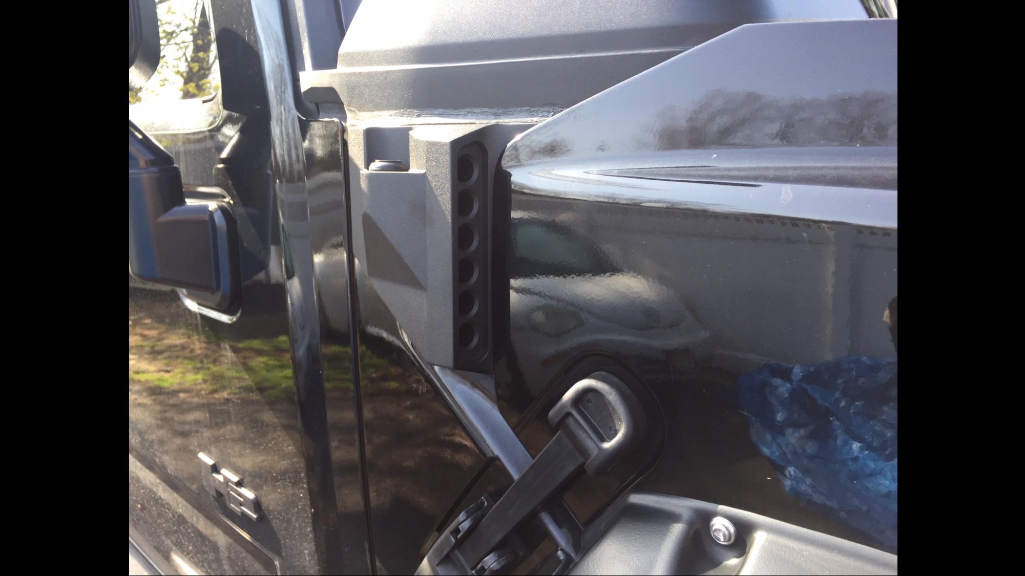

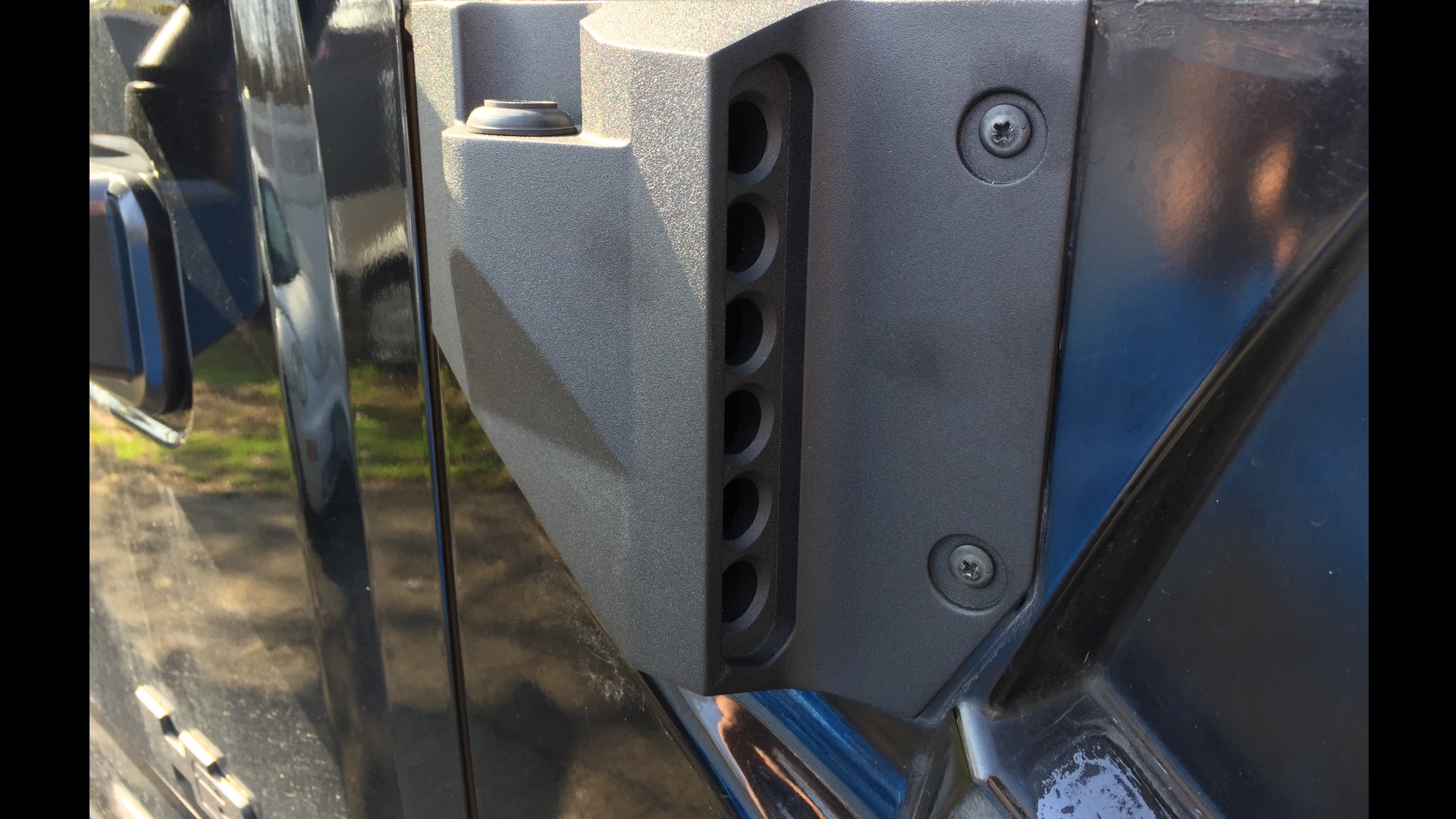

I did billet black side air vents, made by an aerospace company...

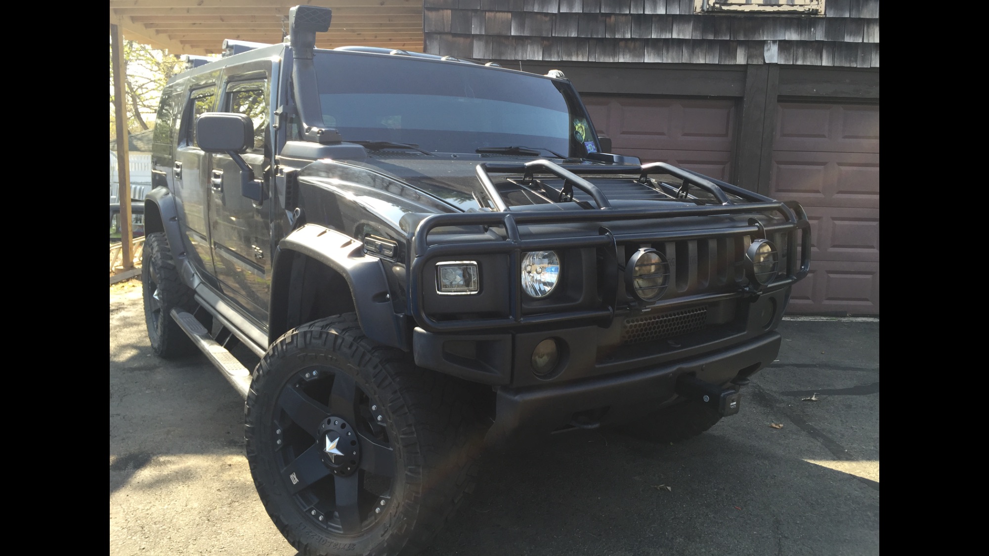

Renegade, your truck looks great. Have some questions, how difficult was it to install those extra wide fender flares? (Can you IM me the part number and cost of the kit?). Also, that air intake nozzle, is that functional? Or just for look? Looks great either way.

ADOR, yes I will pm you, the install on the wide fender flares wasn't hard, just time consuming to get them lined up right. But the great thing is that you don't even have to remove the stock fenders! These mount over them, in the rear you will just have to slightly trim the stock ones, to fit these I believe.
