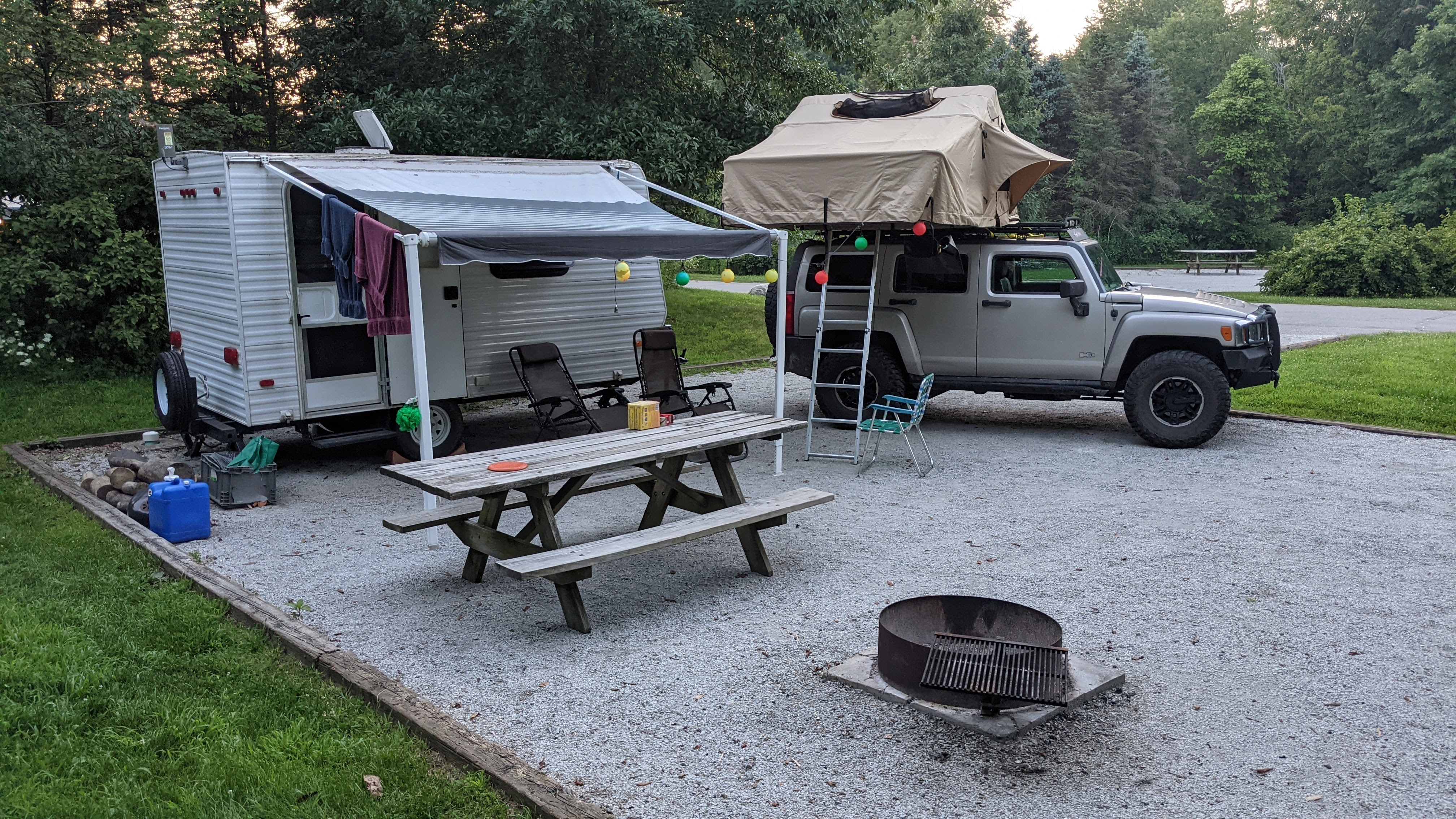

Annual camping trip with my parents, sister, and her family. Being with family was nice, but the more camping trips I go on to public campgrounds, the more I'd rather just camp at home. That's not the fault of the parks though. I think Indiana's state parks are among the best around. We went to Prophetstown, which was quite different from what is typical of most Indiana state parks. Most are heavily wooded. Prophetstown is mostly prairie. That's fine, but with temperatures in the 90s with excessive heat warnings, hiking across an open field did not sound particularly appealing.

That's a pretty cool setup for camping. I like the RTT and trailer.

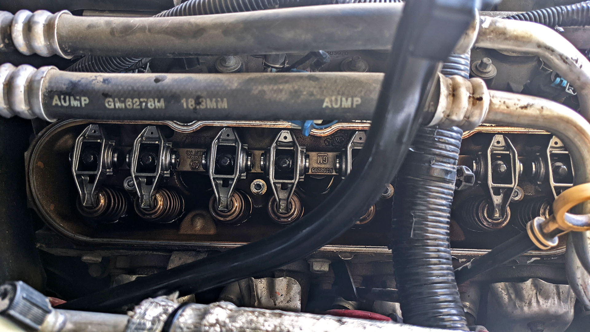

Installed the Summit Racing SUM-141556 - Summit Racing® Pro LS Upgraded Rocker Arms in my H3 Alpha. What a huge difference those rocker arms made towards smoothing out the engine. Wish I had done when my engine was at 180k.

Schwarttzy-H3-Hummer-Off-Road-Summit-Racing-SUM-141556-Summit-Racing-Pro-LS-Upgraded-Rocker-Arms-850x478.jpg

Amazing! I will go the same route than you, the set is still going well in your engine?
Any better feeling except smoother engine? (better response, horsepower, etc)
Why do you reuse the existing bolts? The bolts that came with the set are not good? (just to know)
Thanks for sharing Schwarttzy!!
The rocker arms are still going strong, but it's only be couple of weeks.
The engine sounds a lot smoother now.
The new bolts felt cheap. I don't like hex head bolts. I'd rather have regular socket head bolts.
Its ok! Thanks!
Do you just reuse your existing regular socket head bolts?
Planning to do this mod after the current replacement of injectors due to Spark knock problem in cylinder 5 at high rpm (killing all the power)

Its ok! Thanks!
Yep. I looked at the quality between the two different bolts and decided that the factory ones are better. This is why I reinstalled the factory rocker arm bolts.
