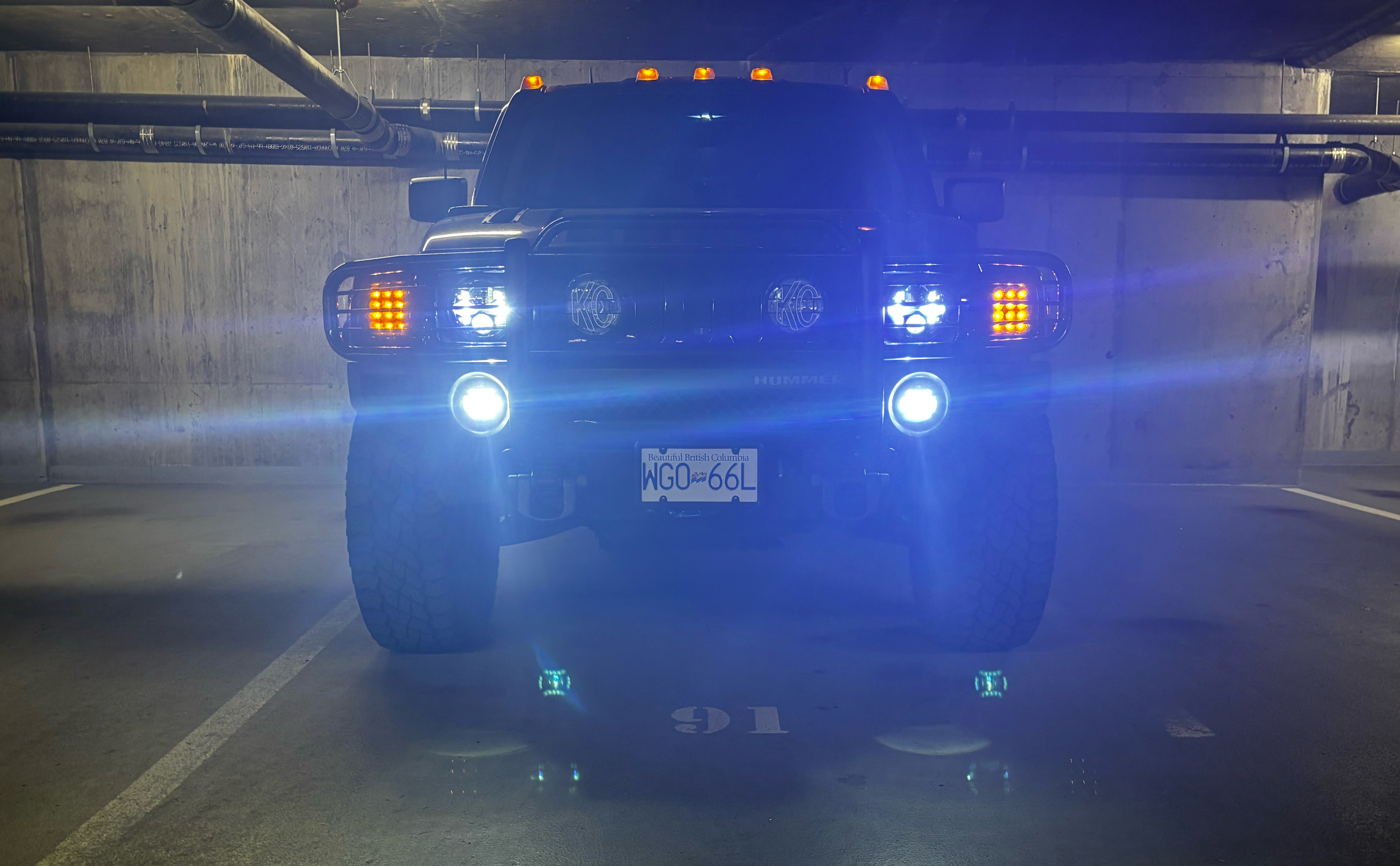

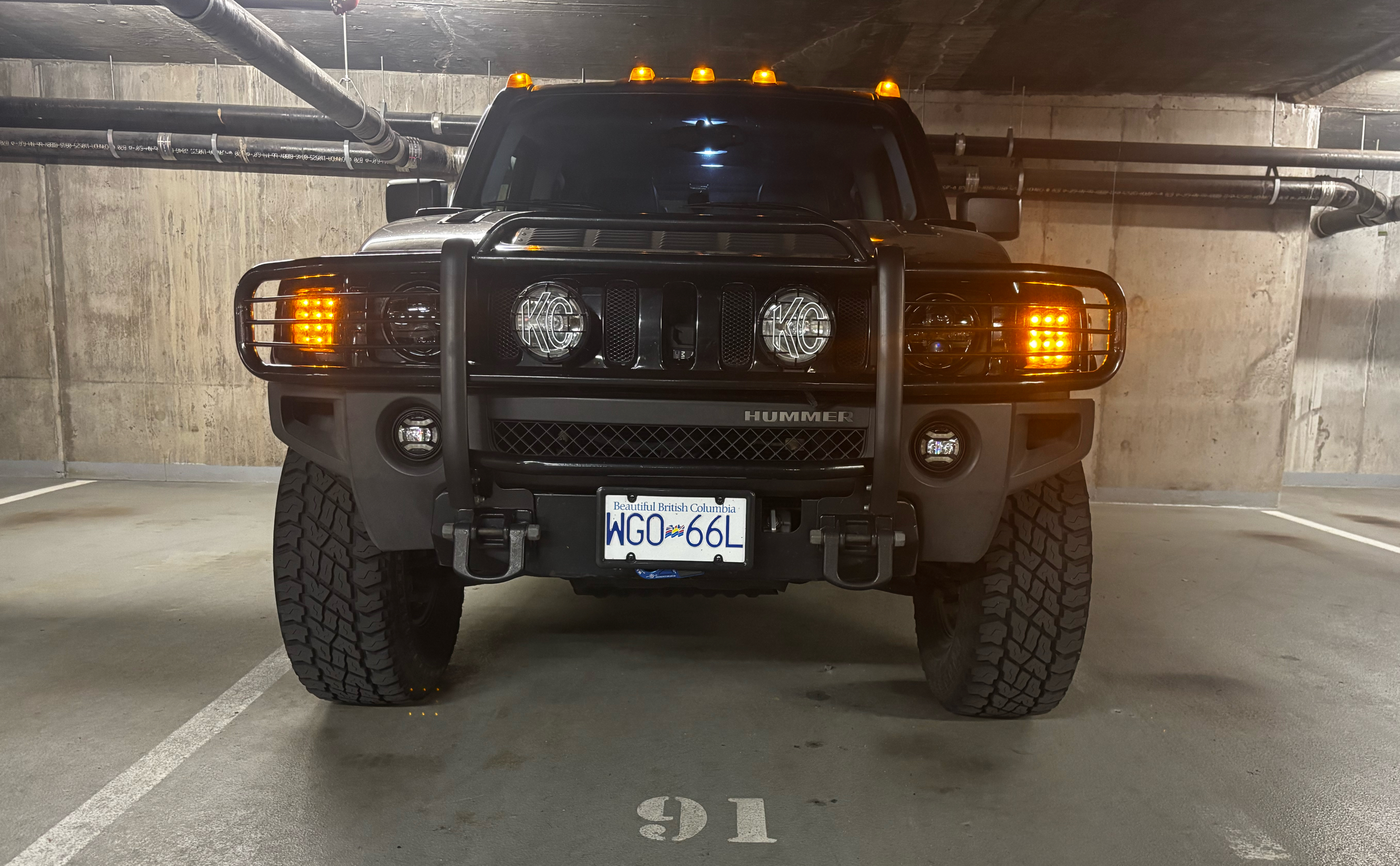

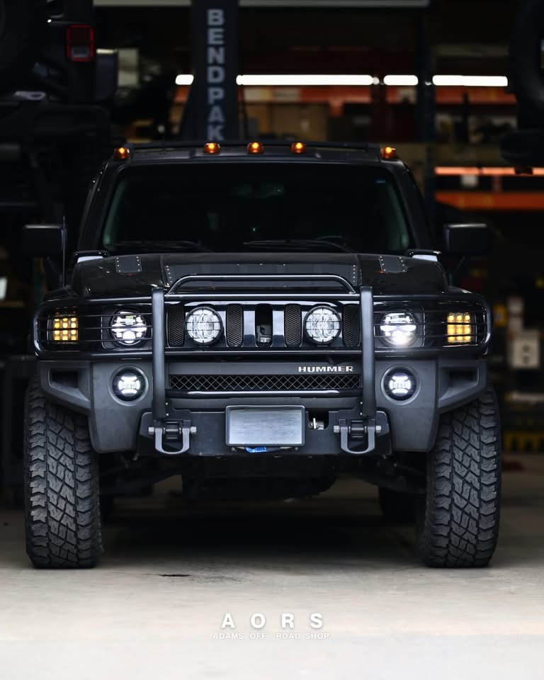

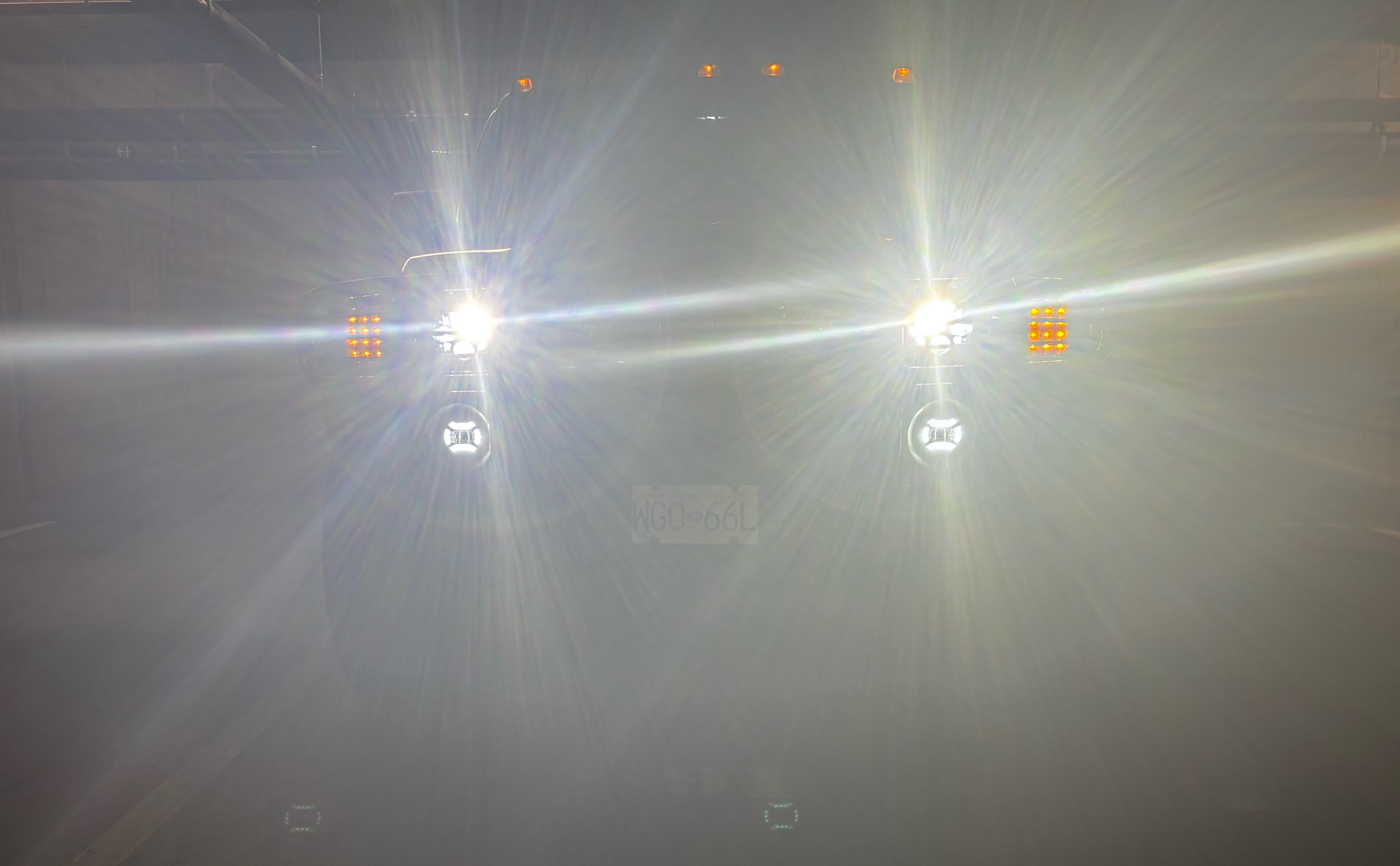

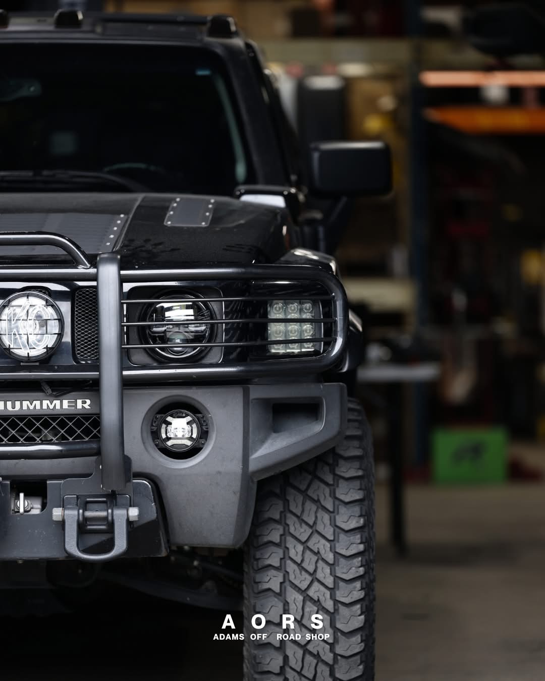

I finally installed the 7” headlight adapters and 4” foglight adapters from ODCH3 https://www.etsy.com/ca/shop/ODCH3
I put in the Morimoto sealed7 and these fogs: https://a.co/d/0bGrfWxx
Worked great. I kinda gave up on a bunch of the options though. Both bulbs have amber lights that can be wired into the turn signals, but I thought that might be too much going on. I did activate the halos on the foglights as extra DRLs when the headlights are on.

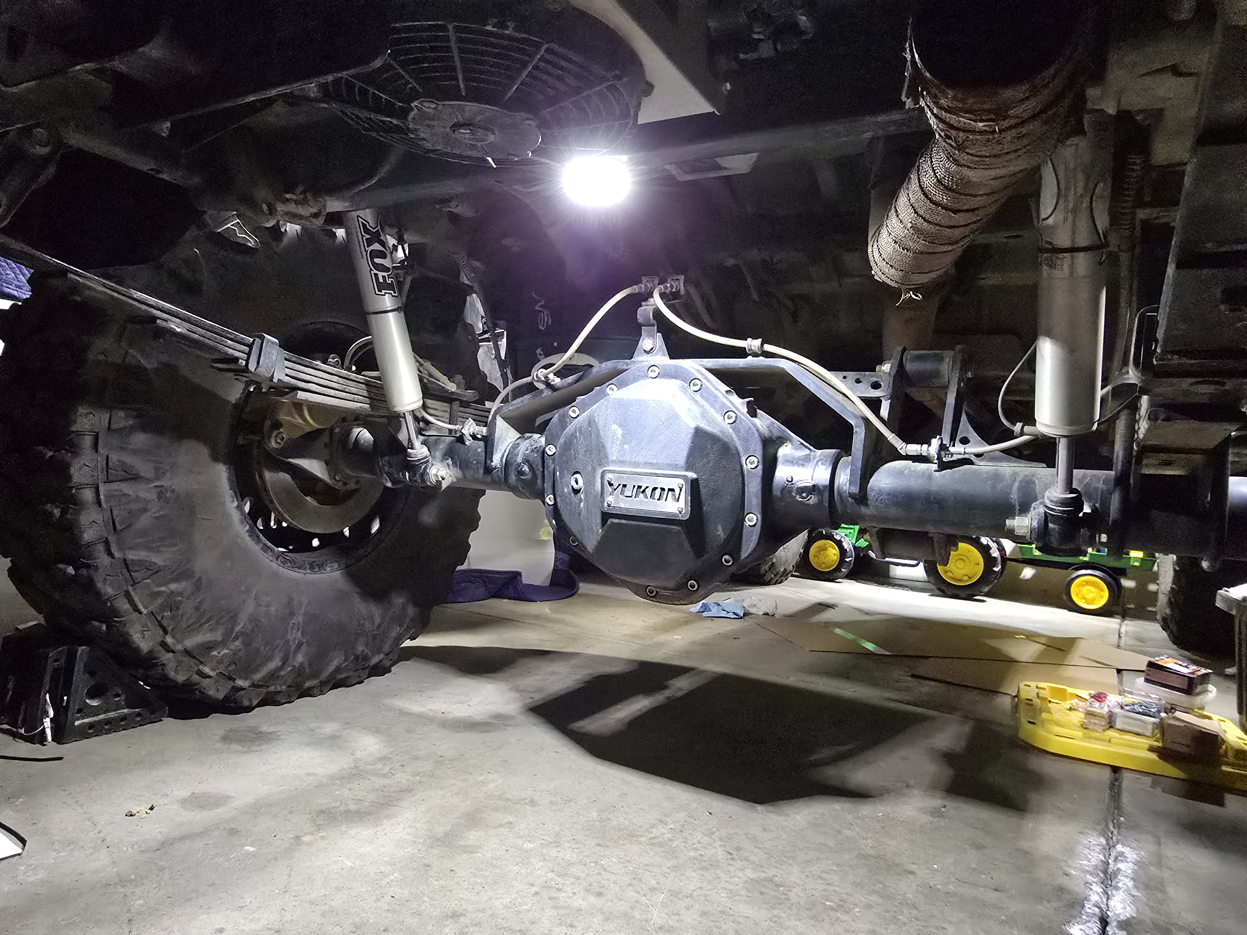

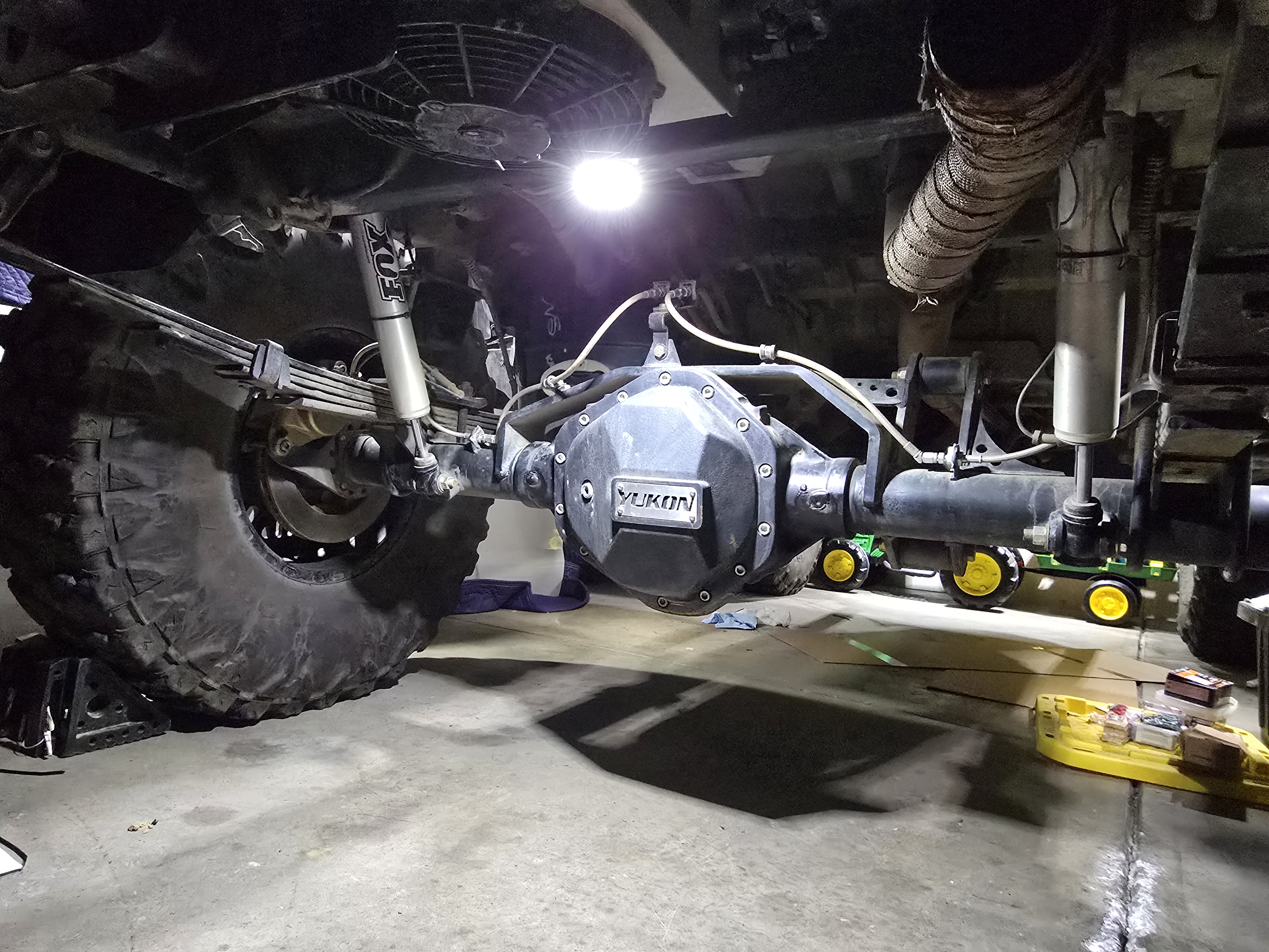

That is my remote transmission cooler. I have it located where the muffler used to be
ah neat
I was thinking of doing a E-fan conversion but a affordable E-fan only does about 2-3k CFM so I might have to run my trans cooler in place of the rear tire with its own dedicated E-fan if I can't cool my rad well?
SPAL does make a E-fan capable of around 4-5k CFM but its a whopping $1200 and takes 80A
3,720
ah neat
I think if you're just running the stock motor, stock clutch fan, the oem radiator, and something like a tru cool 40k or similar trans cooler up front is more than adequate, especially if you're not wheeling it super hard. Some people will add a pusher fan to the trans cooler up front, but at some point that extra fan will block the natural air flow.
I only went remote mount for the following reasons: the power steering cooler was directly below the oem trans cooler and that was heating it up, so I had to find another solution. I also have 40 inch tires and one ton axles now, so a lot more rotating mass/load than a stock drivetrain, thus more load. The engine only ever gets over 200, when I park it on a trail and its hot out and i shut the engine off. Driving it, especially in 4 lo with more CFM coming from the clutch fan , it stays nice and cool ( high 180s, low 190s)

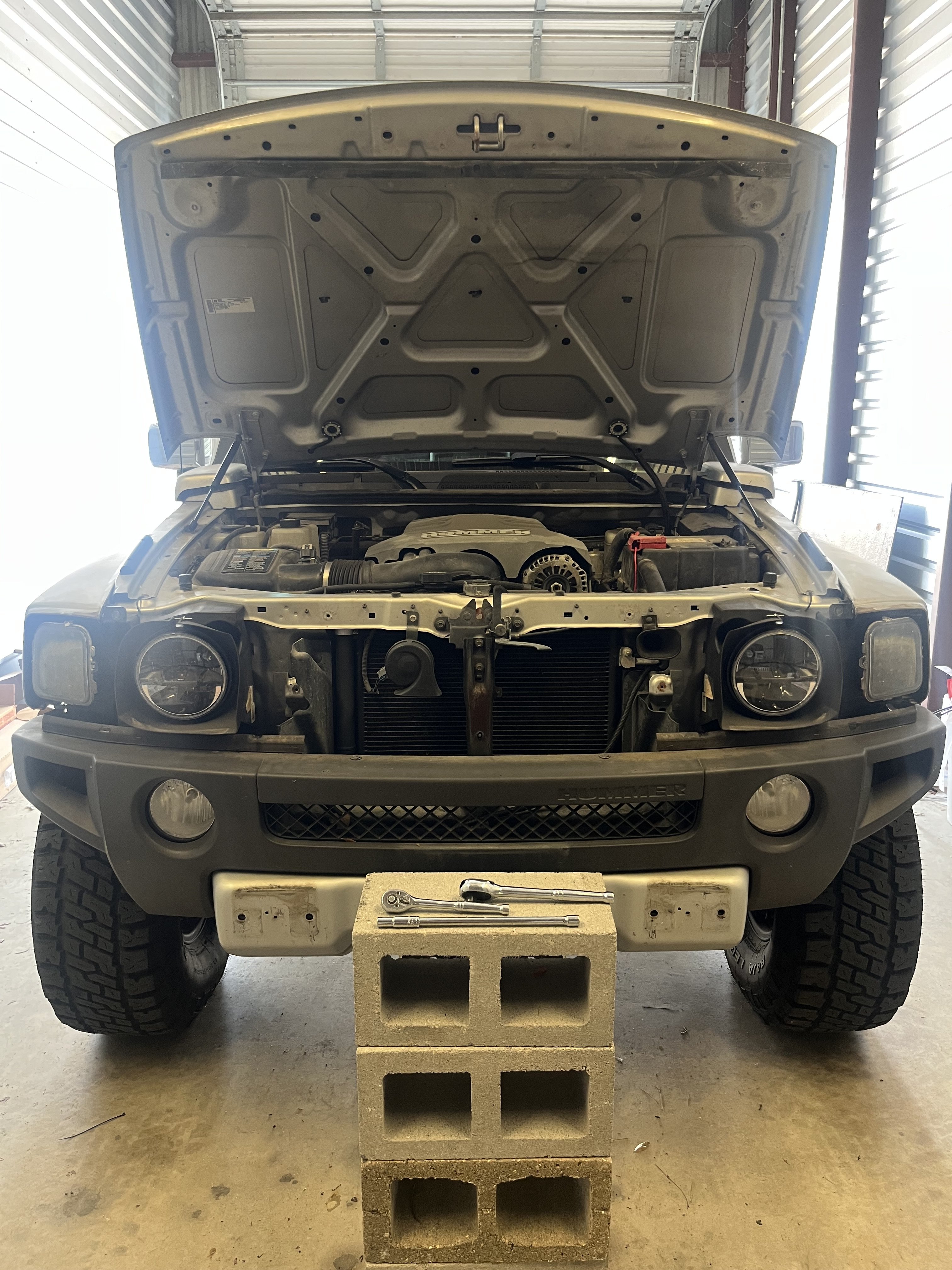

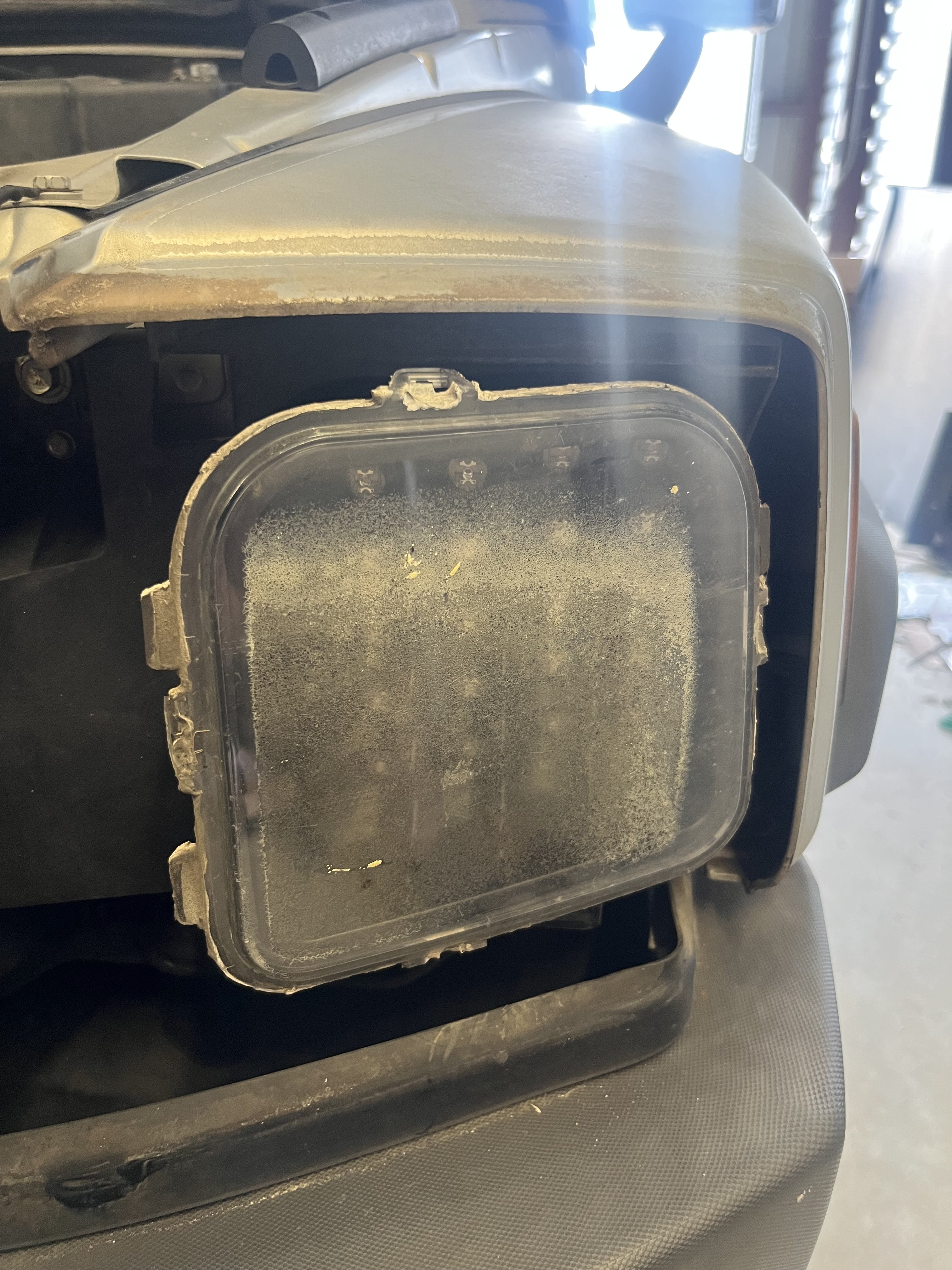

Second issue I need to fix was my headlights not working. I had gone through a couple of sets of headlights over the past 10 years - first set was a custom HID headlight set from a old forum member on here (but these constantly had issues) & 2nd set was an off the shelf LED pair with the 3D printed adapters, but I had a couple of these go out on me. I have a CBPhoto winch mount (I hope he is doing well & saw his old H3T for sale recently) and taking the brushguard and winch mount off everytime I need to swap headlights was a real PITA with how the CBPhoto winch mount sandwiches in between the D rings & brush guard. So I decided to go back to OEM Headlights (& turn signals & marker lights) as it is way easier to change bulbs instead of full headlight housings. I was able to buy new OEM headlights & turn signals off of Ebay surprisingly cheap (granted I'm probably one the few people out there that cares to spend more money of OEM H3 parts opposed to aftermarket parts).

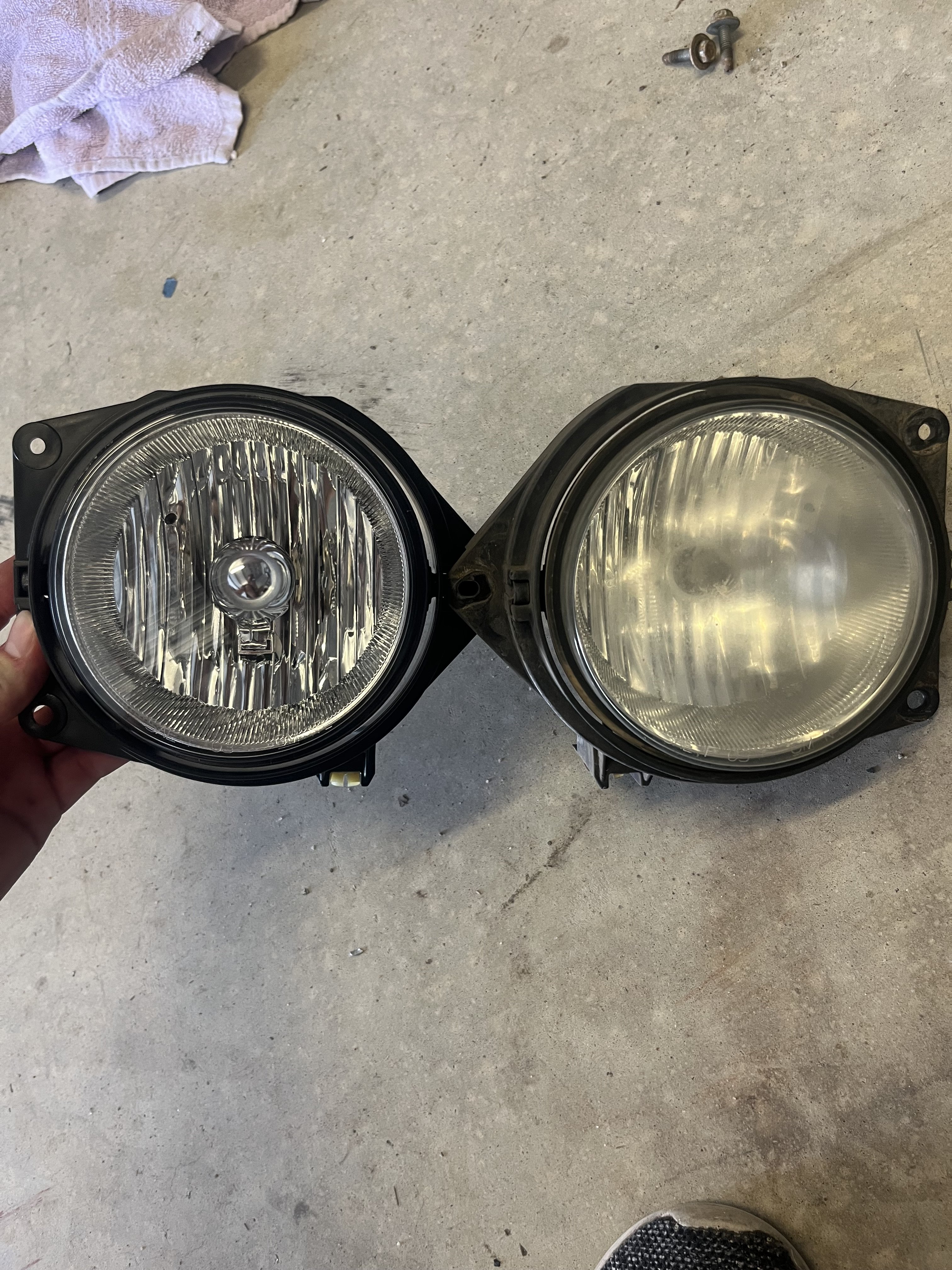

I didn't realize how hazy & foggy my old lights were until I took them off and compared them to the new ones.
Pics of all the new headlights, turn signals, marker lights & fog lights. I really like the OEM look compared to the blacked out look.

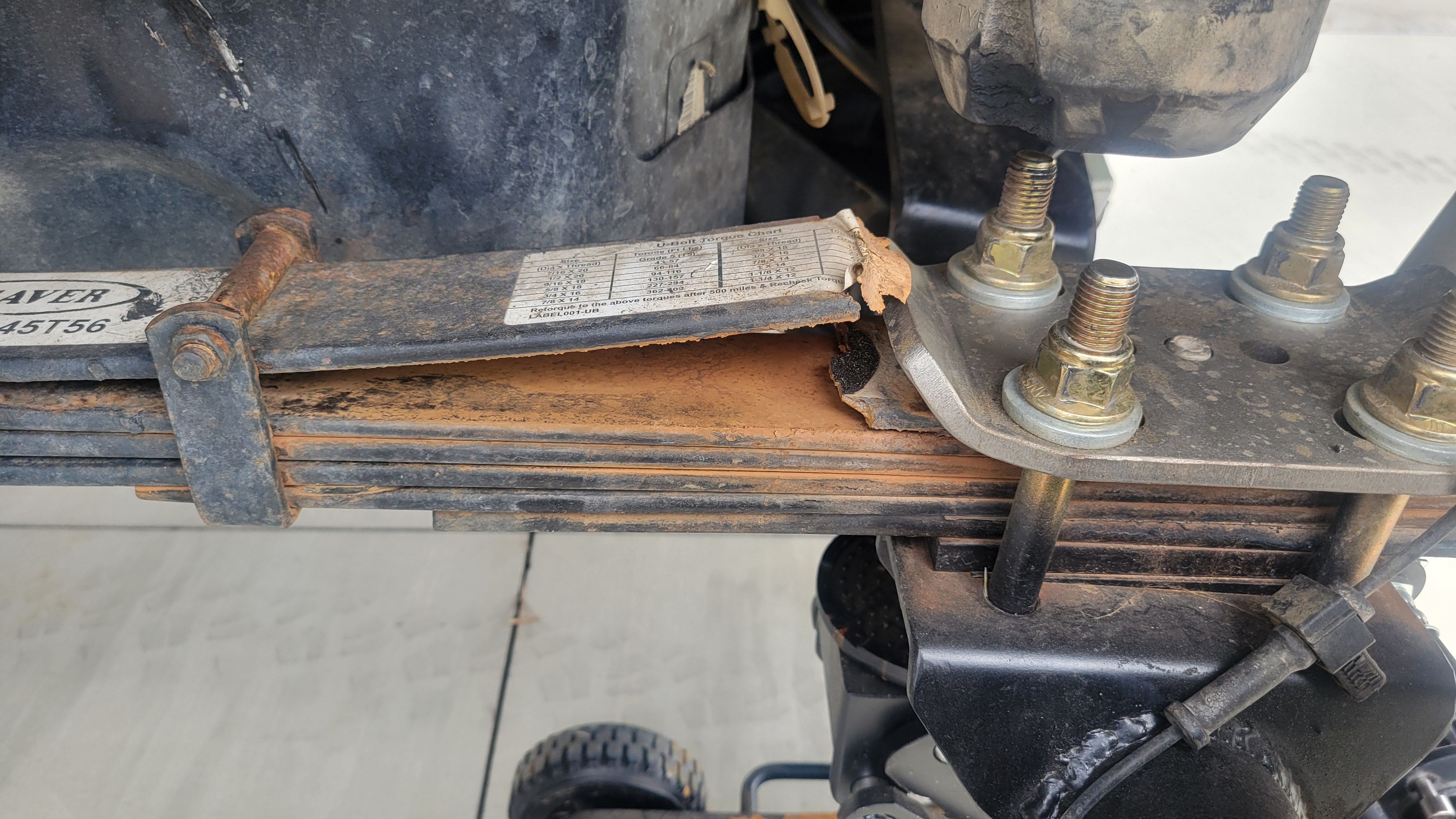

What did I do to my H3 today????? I fixed it....then broke it. Swapped my well-worn T-case. I think it had 1 trip to Moab, 3 trips to Sand Hollow, and at least 20 local trips of varying difficulty. Oil with only 1 trip had plenty of shiny material, and the output shaft has significant play. Put in a spare rebuilt case, and the case is now quiet. But during my roll on the ground, I noticed the driver's-side main leaf spring was broken. 1 step forward 1 step back.
