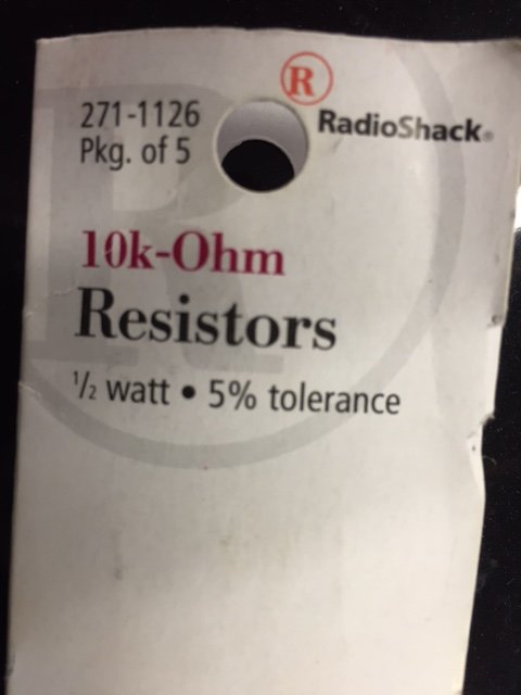

Now that your rear E-locker is gone...do you get any dash-lights from it being un-plugged?
[/QUOTE]
I'll ad the answer here since the question was asked here.
We had the service 4wd light with the factory locker removed
This is what the engineers at ARB had us do when we installed the rear arb in Bebe's H3
Soldered in to the left over plug. Running for a year with no problems

Speedy...so do you think this same resistor could be applied to other devices? Such as an encoder motor?...or a CAD (center axle disconnect) switch?
I'm thinking I may swap the t-case in the H3 to an NP241, in which case I would probably use levers to control it. I was planning to simply leave the factory encoder plugged into the harness, and zip-tie it up out of the way somewhere. This was to prevent the dash light chaos that would no doubt ensue by removing it. I have a similar situation on my 99 Burb, with the stock IFS front axle. I plan to do a SAS on it, and I had the same idea for the CAD switch...rather than un-plug it I was going to simply leave it there and wire it to a crossmember or something. I hate doing redneck mods like this and I would much rather install resistors at the plugs. Do you see this as a "universal" fix for missing electronic devices?
CaseyS
755
Louisiana
Probably but not quite that simple.
In the case of the rear locker, only two wires and I assume the pcm is simply looking for the resistance of the coil to determine if there is a fault.
I'll have to review the xfer case schematic, but I recall two power conductors that run the encoder motor forwards or backwards depending on the polarity, and then a couple of wires for the encoder feedback. Keep in mind that the transfercase controls all GI through the xfer case control module behind the glove box somewhere. I was worried about how this would work in my swap and the transfer case works just fine standalone as long as everything is plugged into it. Keep in mind, the speedo and transmission shift points change when when in 4 lo. There is a single line that I think is set high (12v) when in 4 lo that goes to the pcm to tell it to shift differently and the gear ratio is different. I have not been able to get this to work with my us shift standalone. My workaround is manual shifting in 4lo. Speedo don't really care when crawling around. If you had a cable setup, you might be better leaving the encoder hooked up and matching the cable mode to the encoder to keep things happy.
