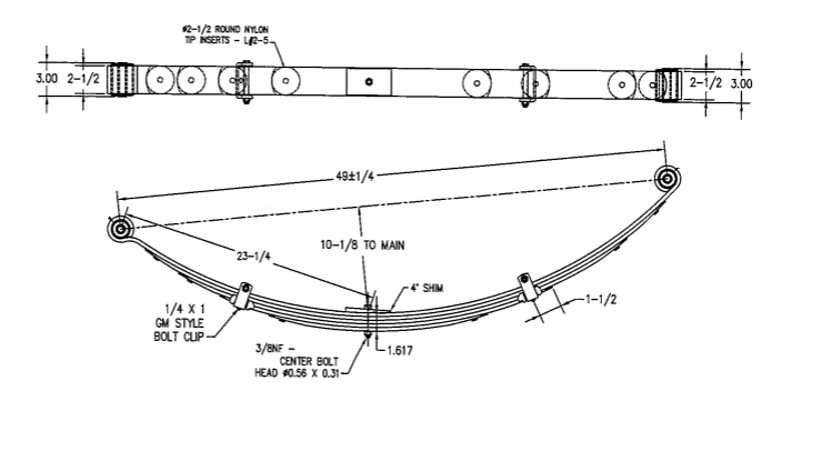

I’ll persuade it into position and see how it looks. Been on the road a bunch so it’ll have to wait another week end or 2. Good news, I did receive the below specs from Rancho. First pulling together the bushing info, now the leaf specs form the depths of obscurity. Thats some customer support for an obscure and discontinued product!!!

Wanted 3” of rear lift with the re-arch of the lead springs. Just got it back together. I got 6.5” of elevation in the rear versus the desired 3-4”. Suspicions confirmed, they put way too much arch in the springs.

LOL, no pics necessary, looks utterly ridiculous and is completely completely undrivable. It is 100% all spring no shock absorbers engaging at all. Just pulling off my street through a tiny dip that my golf cart negotiates with no problem had this thing bouncing all over the road. Less than 5 miles an hour.
Looks like I’ll be tearing it apart again and heading back to the spring shop. Hopefully they’ll cut me a deal the second time around since they promised 3” gained lift.
I’ve got the Rancho specs now so that should help.

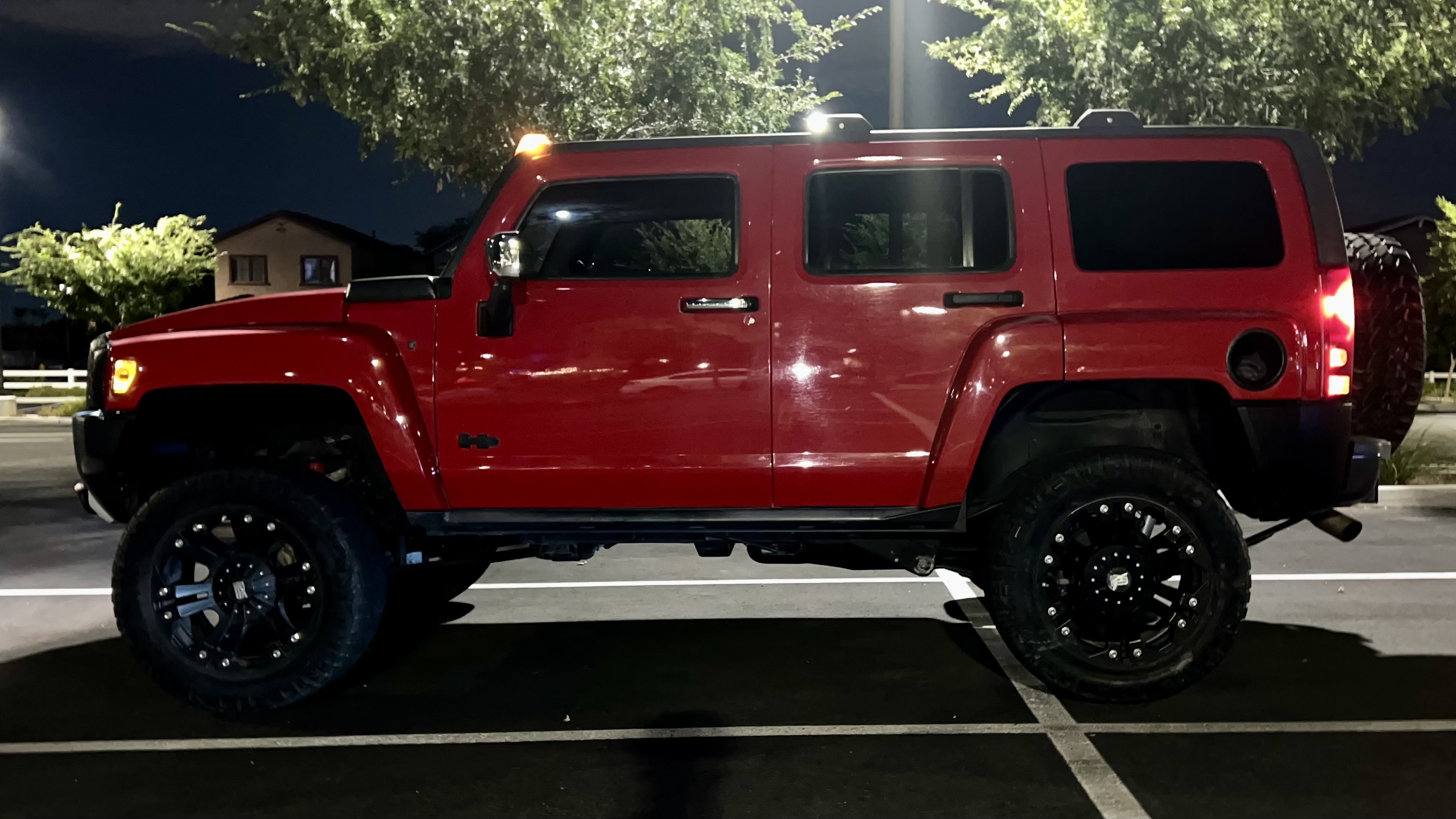

Finally got it right!!! Stance is right on the money!!! No more banging at the slightest dip in the road and drives much better. So nice!!! Spring shop warrantied the whole thing and re-arched them to Rancho’s specs at no charge!
The above Rancho specs are on the money. I measured and confirmed these leaf springs are exactly on spec per Rancho.
