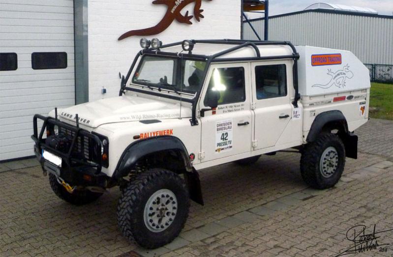

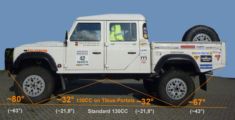

I've given this some thought and I asked myself how would AM General have done it if they had designed the H3/H3T. The conclusion I came to is they would have used Portal axles (AKA geared hubs) like they did in the HMMWV and like most other military vehicle manufacturers do. Portals typically provide 4 to 5 inches of clearance between the axle and the hub, so they increase every clearance number except under the tip of the A arm. In addition, Portals gear the drive train down, which compensates for the increase due to bigger tires (i.e. 37/33) and they allow you to use a lower ratio in the differential. This increases the speed of the shafts but reduces the torque so torque would be lower than the original design specs. The ideal portals for the H3/H3T (which do not exist) would be bolt on portals (so you don't need to built custom A arms, using a 4 gear design (4 gears don't reverse the direction of rotation) about a 4.5" lift and 2:1 gear reduction. A 4.5" lift would allow you to go to 39" tires and between the tires and the Portal lift your ground clearance would increase 7.5" relative to stock and be comparable to the H1. Since the torque would be lower than stock you would not have to worry about the differential or half shafts.

The other nice thing about portals is where the torque takes place out beyond the rest of the system. I looked into this once before. The H1 hubs were actually the cheapest (around 2000$ each corner) over other geared hubs which cost a lot more. But that's just for the front. The rear would have to be a bolt on for a strait axle. If you wanted the same wheel base the axle tube would need to be shortened and with the leaf springs so close to the outside of the axle tube I think a 3/4 link would have to be installed and the leafs removed. That's a better performing suspension system but the problem is your taking a 10,000$ project and turning it into a 15,000$ project just because of the leaf springs being in the way. With some research you may find a old unimog with the rite length axle which would just need the perches welded on and it would be done.
That's exactly what we did for these vehicles we built. These are Unimog axles with HMMWV hubs and rims.

anything is possible (all you gotta do is throw $$ at the truck and see what sticks). It is a commitment though -- better really love the truck and plan to keep it "forever" to dump serious money into it that you'll never get out. Doing stuff like that is really cool but often an experiment -- solving a few problems and creating some you never considered. My airbag mod has done that to me -- It's benefits just barely outweigh the disadvantages so I stick with it.
