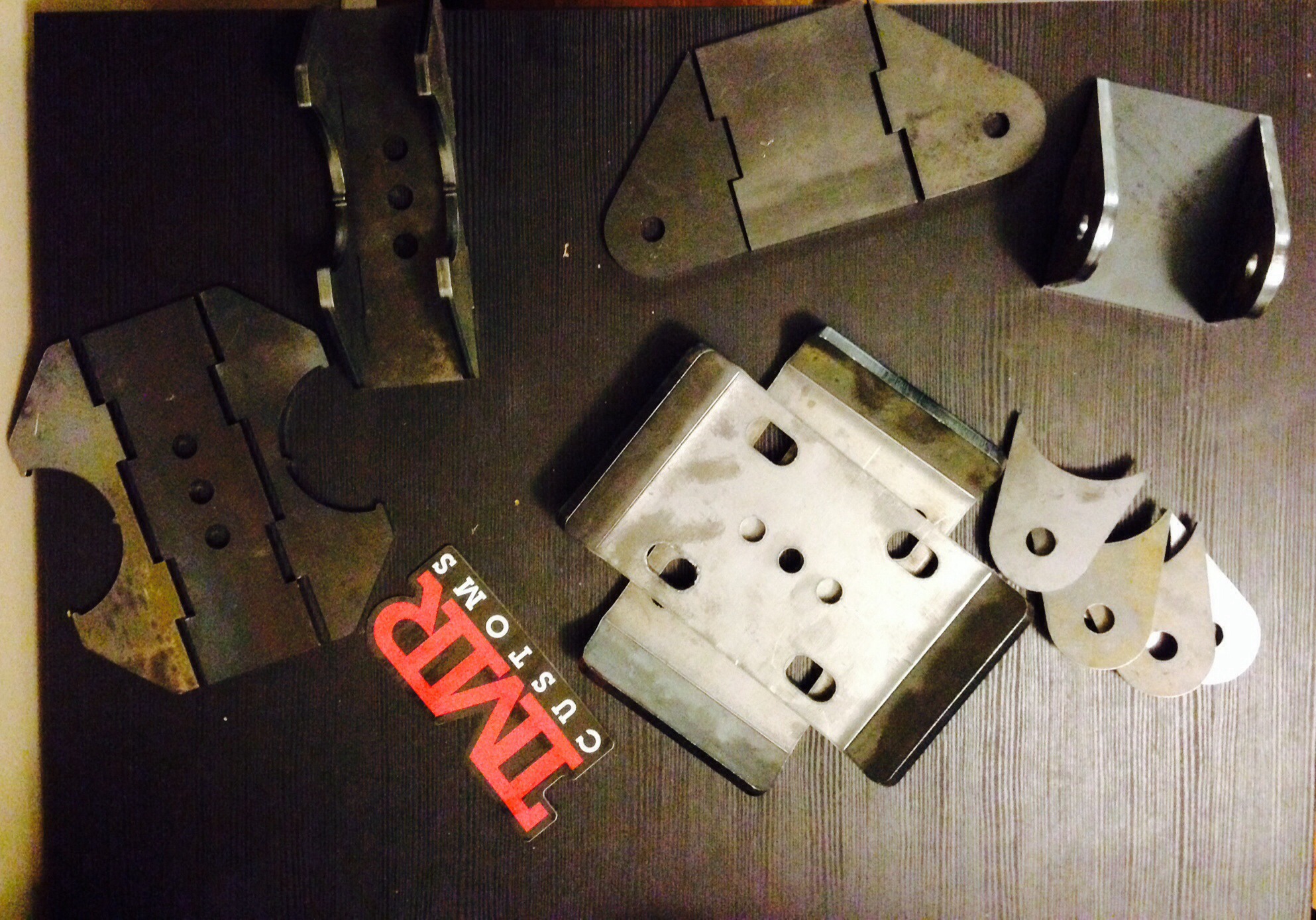

Here comes the SOA!!
Went to order some SOA parts from RuffStuff... but shipping was going to be $91 and then the exchange rate added another $45 to the bill which doubled the cost of parts between the two... needless to say I didn't place my order and will be looking into other avenues for procuring those parts :(
I spoke too soon!
Exectly 15 min after posting the above I found a Canadain 4x4 Custom Fab supplier that was able to get me all the parts for about 40% cheaper then what it would have cost to buy the same stuff from Ruff Stuff, so my order has been placed, I will have my parts next week and now all thats left is to order extended brake lines!
Yay new parts!
Just short a set of extended brake lines and then it's SOA time!
