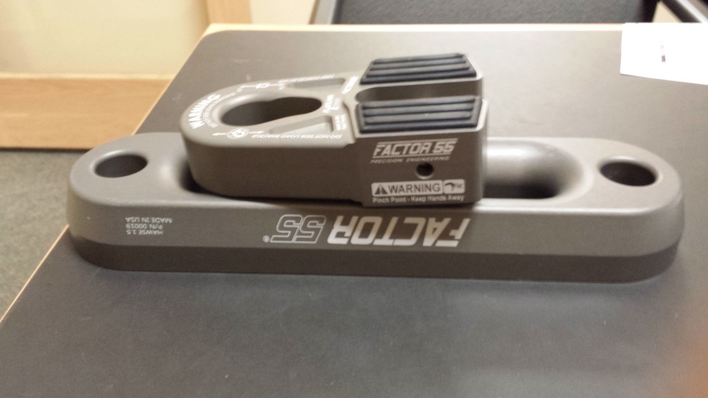

Had a great convo with the guys over at Factor 55 today.
I have a package heading this way with a few bits from their line of recovery equipment!
Love their stuff and its really going to clean up the look of the front end!
More on that later....
Looks like I will be getting a new Winch from Superwinch, one with a synthedic line to use with the Factor 55 hawse fairlead, which I have been planning to do all along to help lighten the load up front (and for the safety benifits)

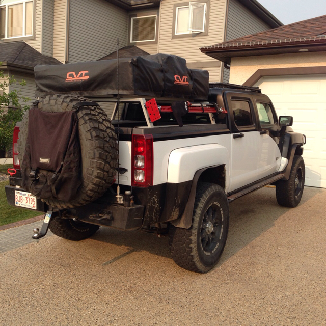

The T is back to summer mode:

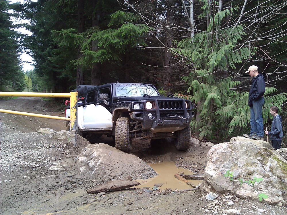

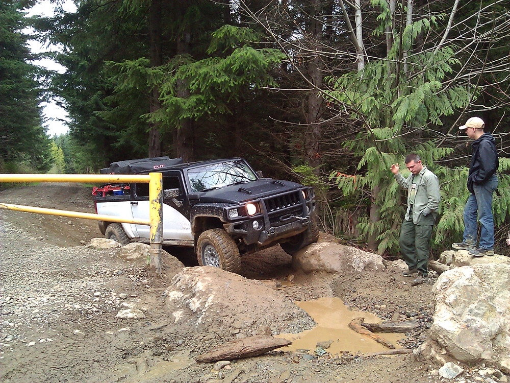

Some pic's from last months Walker Valley ORV trip

I am switching because this winch isn't designed to run a synthetic winch line, and I want to switch to a setup with synthetic to use all of my new Factor 55 gear (their hawse fairleads dont work with wire cable, their thimbles do however).
