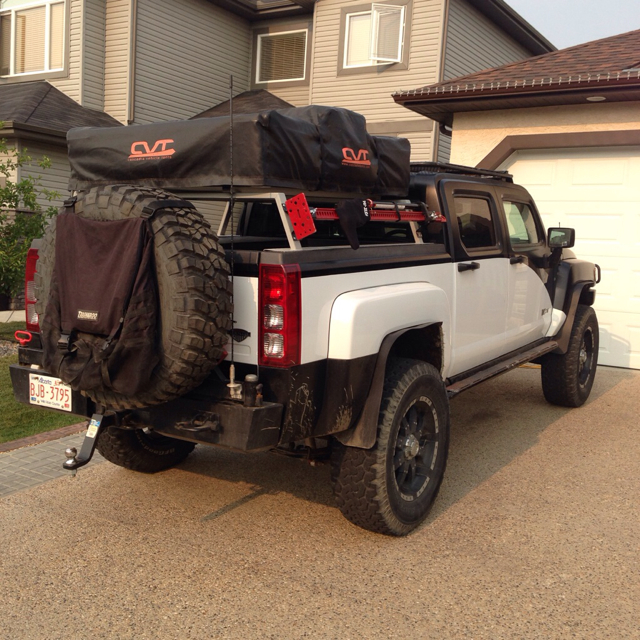

Lots of change has been happening, but haven't been taking many pics.. here are some that I do have:

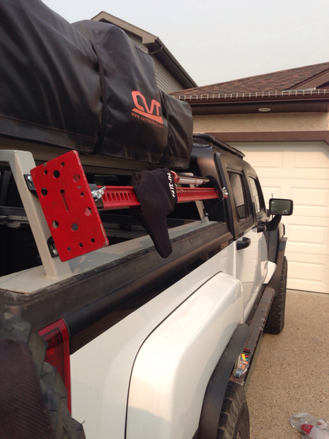

New Hi-lift mount:
