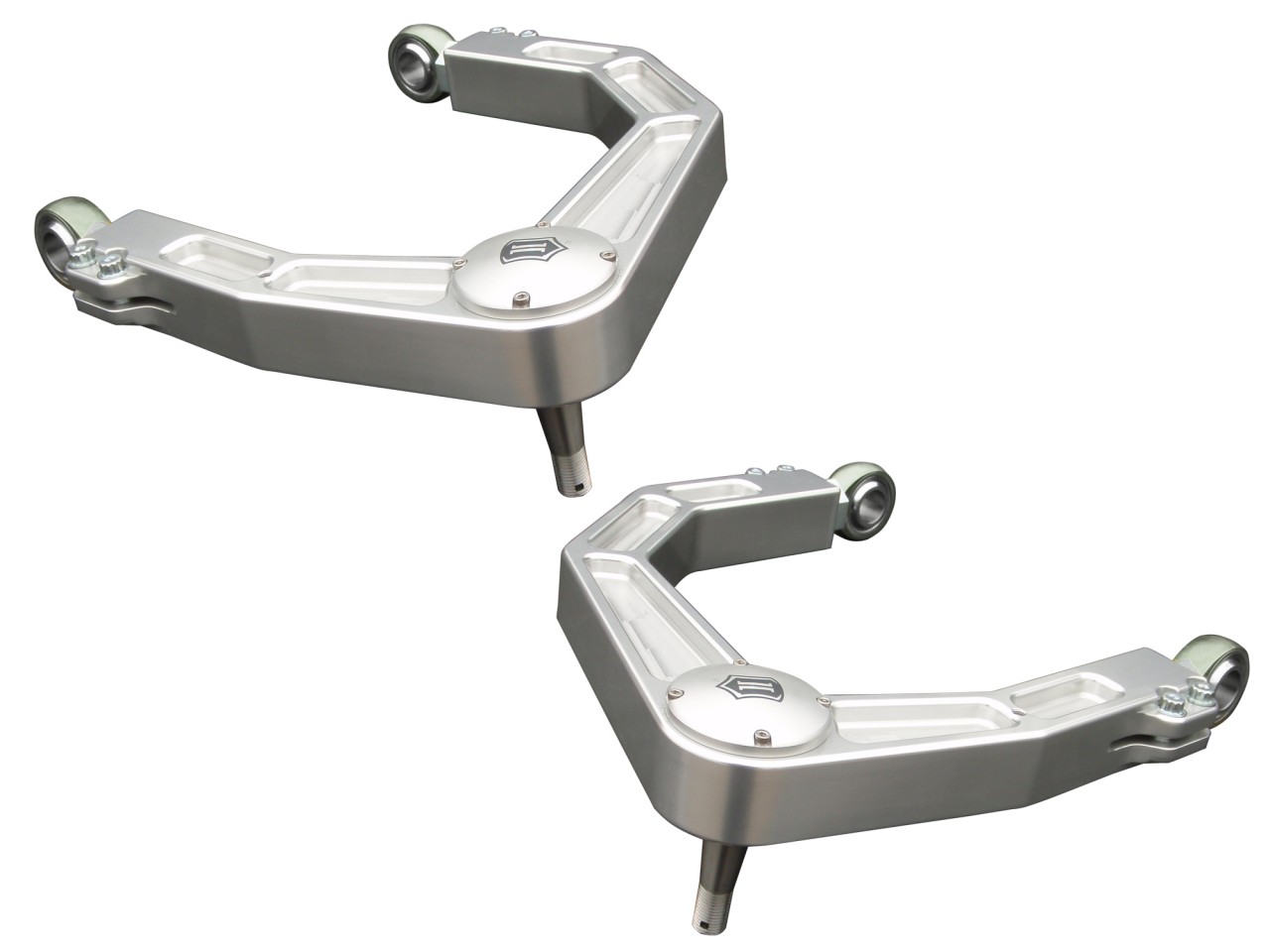

I would not be afraid of keeping the TB set up for high speed. The more suspension guys I talk to, the more they say the torsion design is much better than most get credit for. What would be the cats ass is to convince Icon to make one of these for the H3.
They have adjustable Hiems to adjust the camber as you change the ride height. Also cutting down the upper hard stop on the frame and going to a strap will help. The uniball and clearancing some of the knuckle to U/LCA will help get travel too. Then, IMO, it is down to dialing in the shocks and using jounce shocks.

Icon is the **** but they are pricey. You have to be willing to fork over some cash, not saying that to anyone in particular but to everyone. If you wanna play you gotta pay. To keep up with the big boys, if its long travel you will fork out some money or if its a solid axle swap you will too. The only low buck ways to do it is do it all yourself and pay up for the necessities like the 2 links in my long travel ifs low budget thread.
