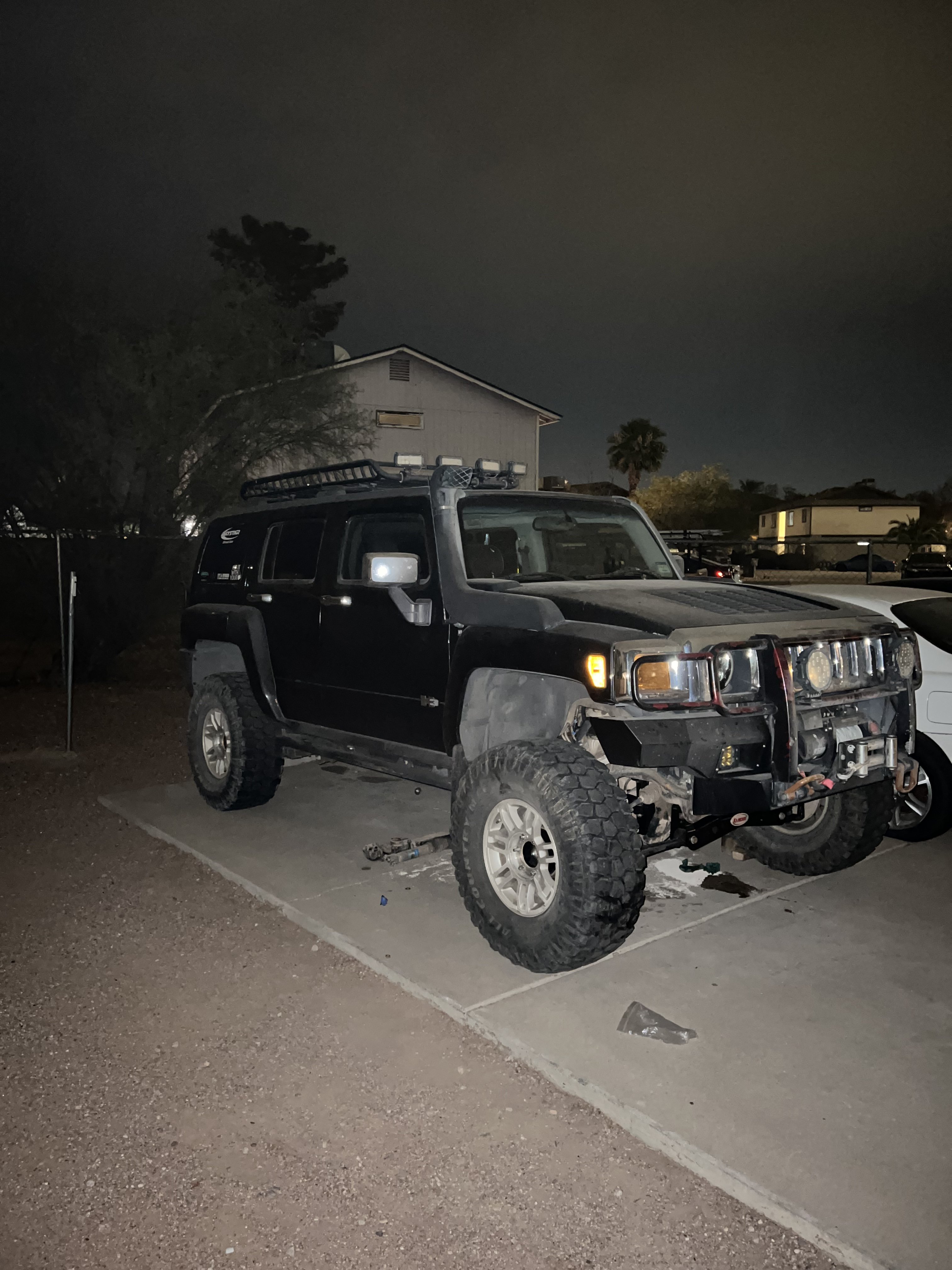

Looking back, it was not the season of the 14 bolt. And I, in fact didn’t make sand hallow.
Changing that outcome this year, @cgalpha08 ‘s progress is lighting a fire under me to get everything done. Acquired all parts to my half door. 14 bolt project is moving. Might show up to sandhallow 4 inches taller. Lots may happen in the next 6-8 months.

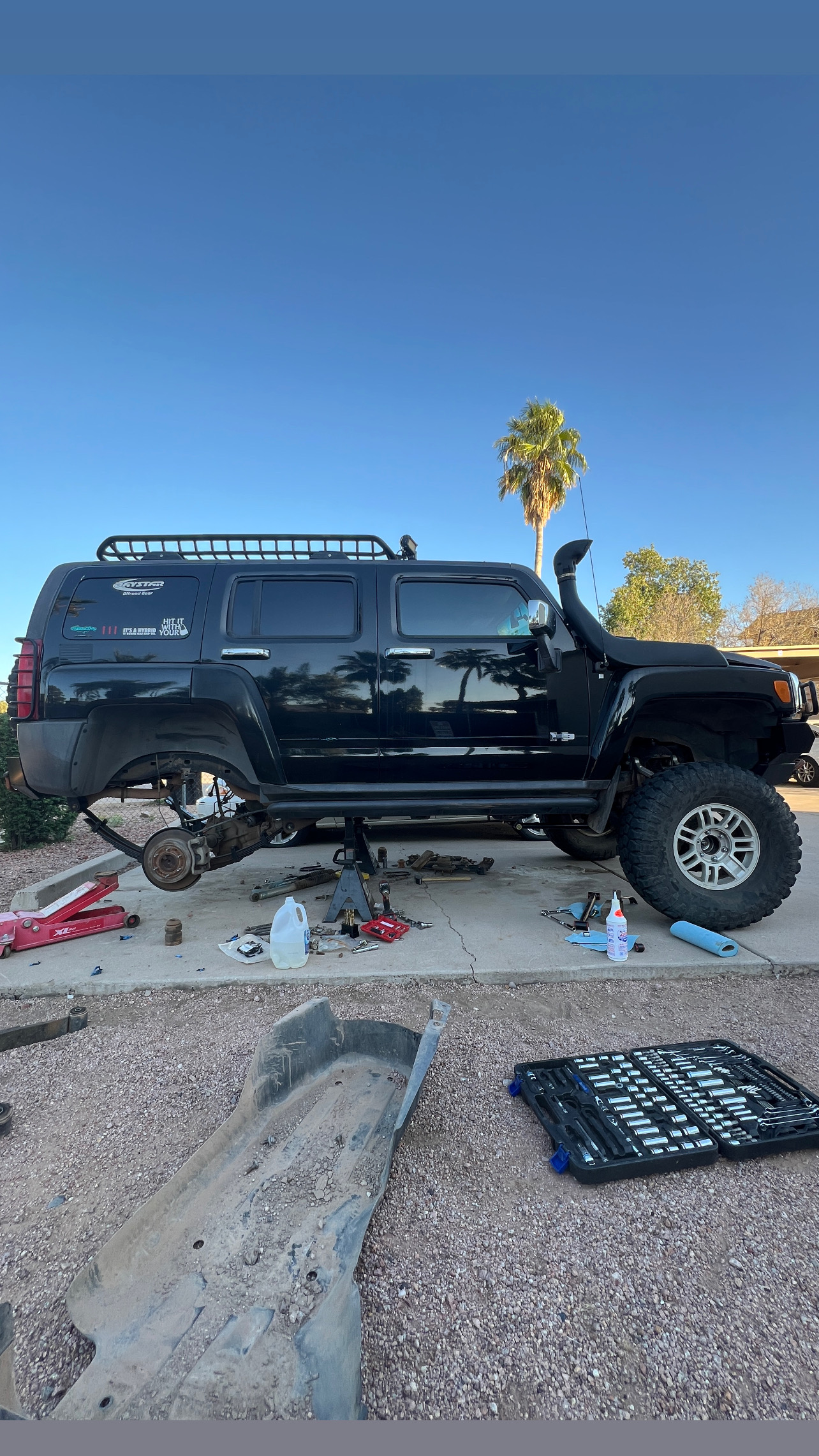

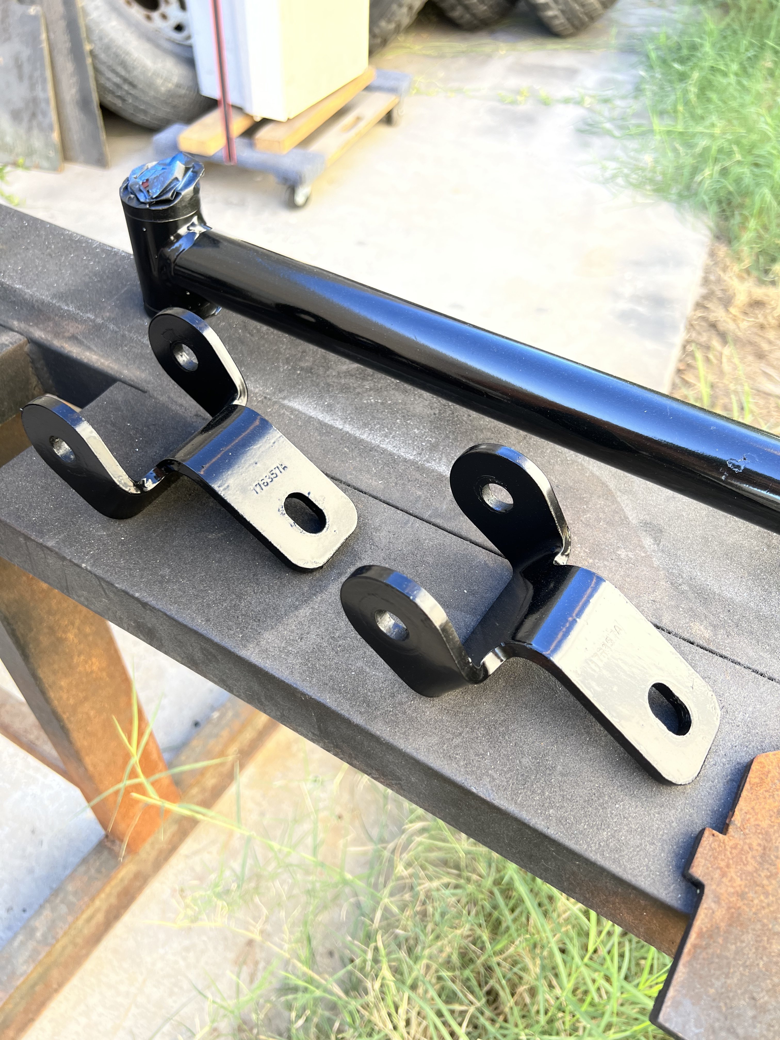

Rancho prep, getting all the redux parts done along with adding a layer of paint.

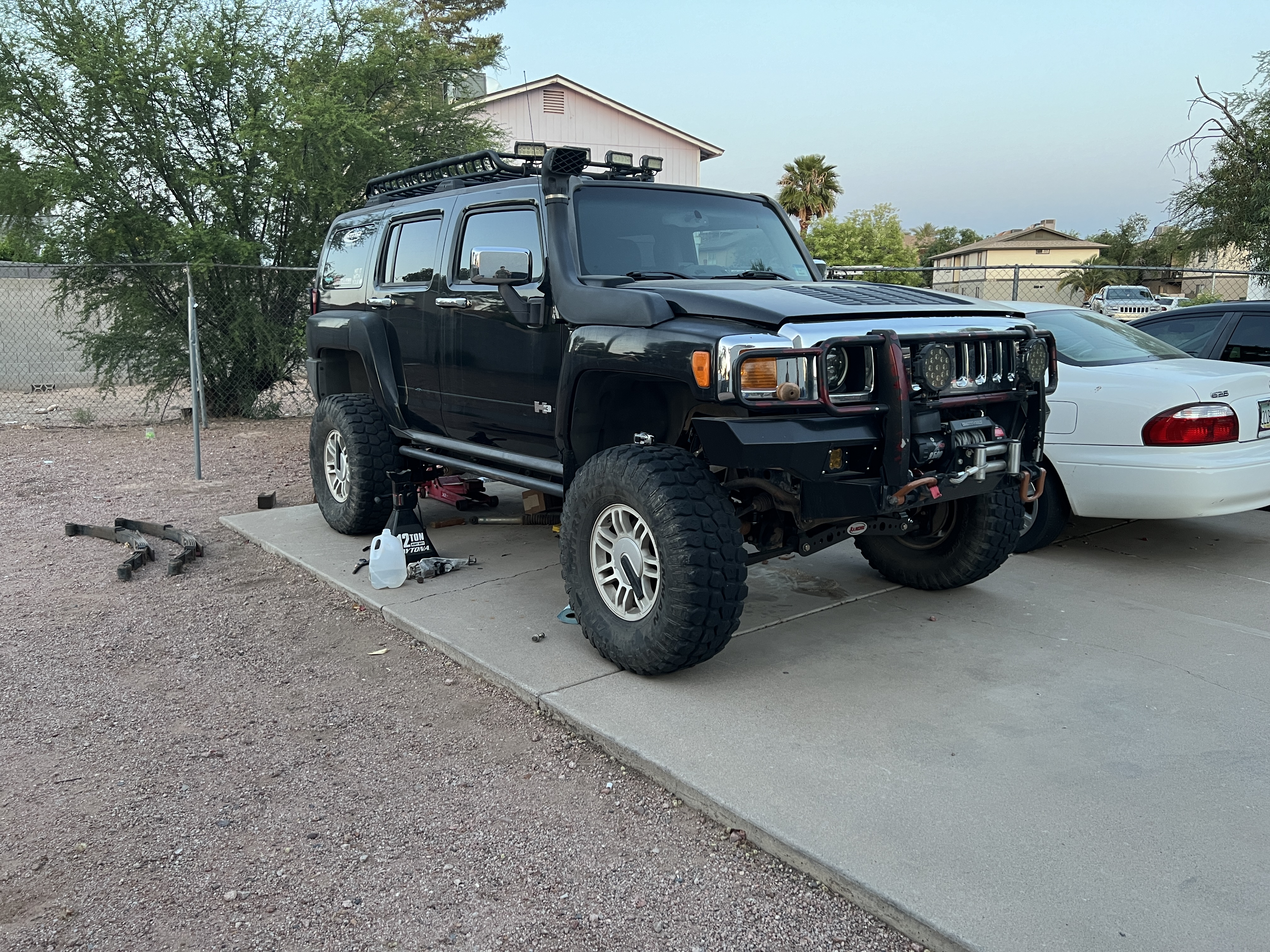

Front ends about wrapped up, waiting on some measurements so I can fabricate some bump stops, need to order shocks, etc.
For the rear I’ll be buying a new set of leafs and sending them to get rearched about 2” (whatever the fab tech add a leaf is), pair it with a 6” long shackle and that should work until I get the 14 bolt under.

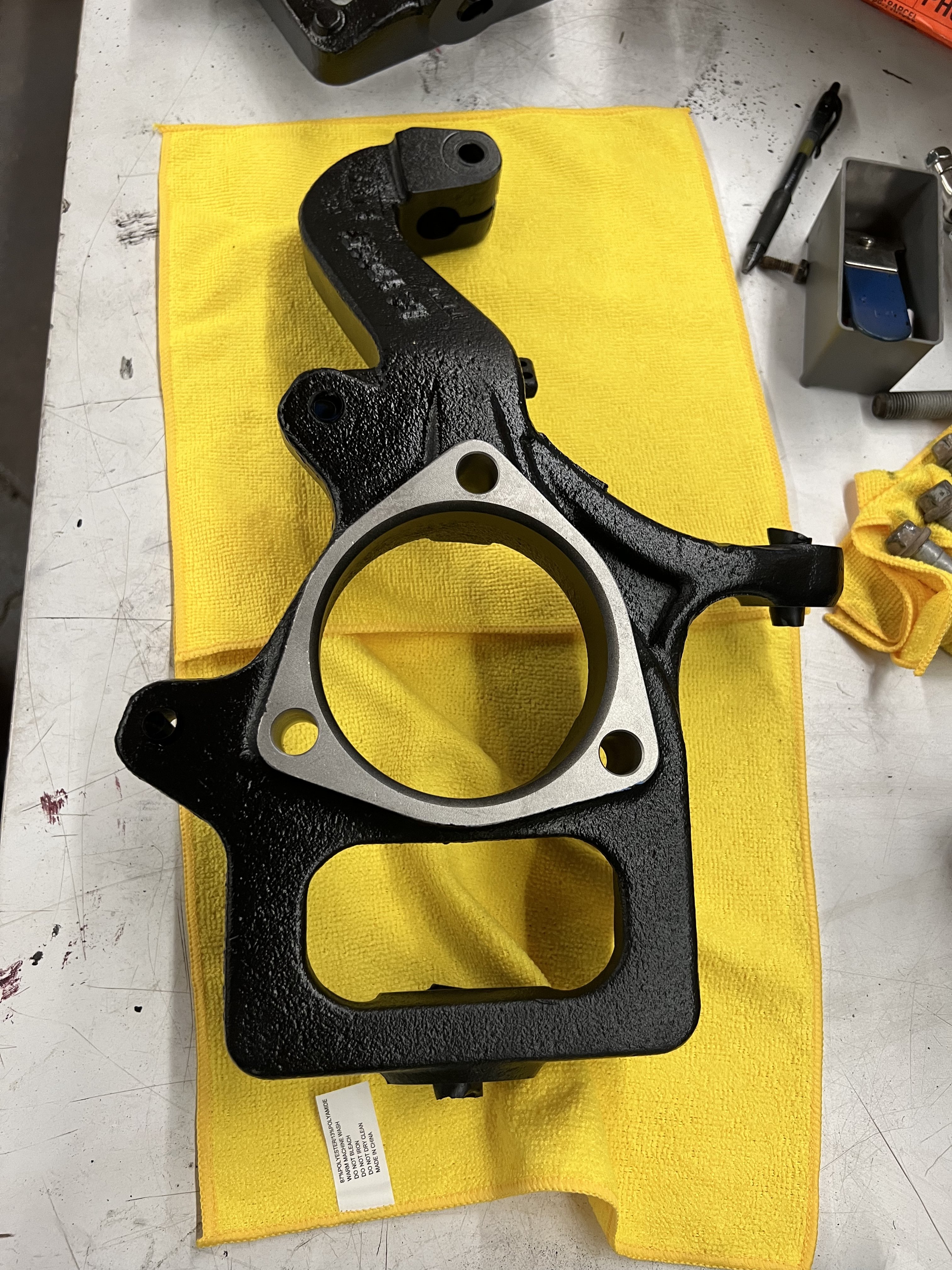

Cleaned up the hubs, sending them out to get sandblasted and machined for tone rings.

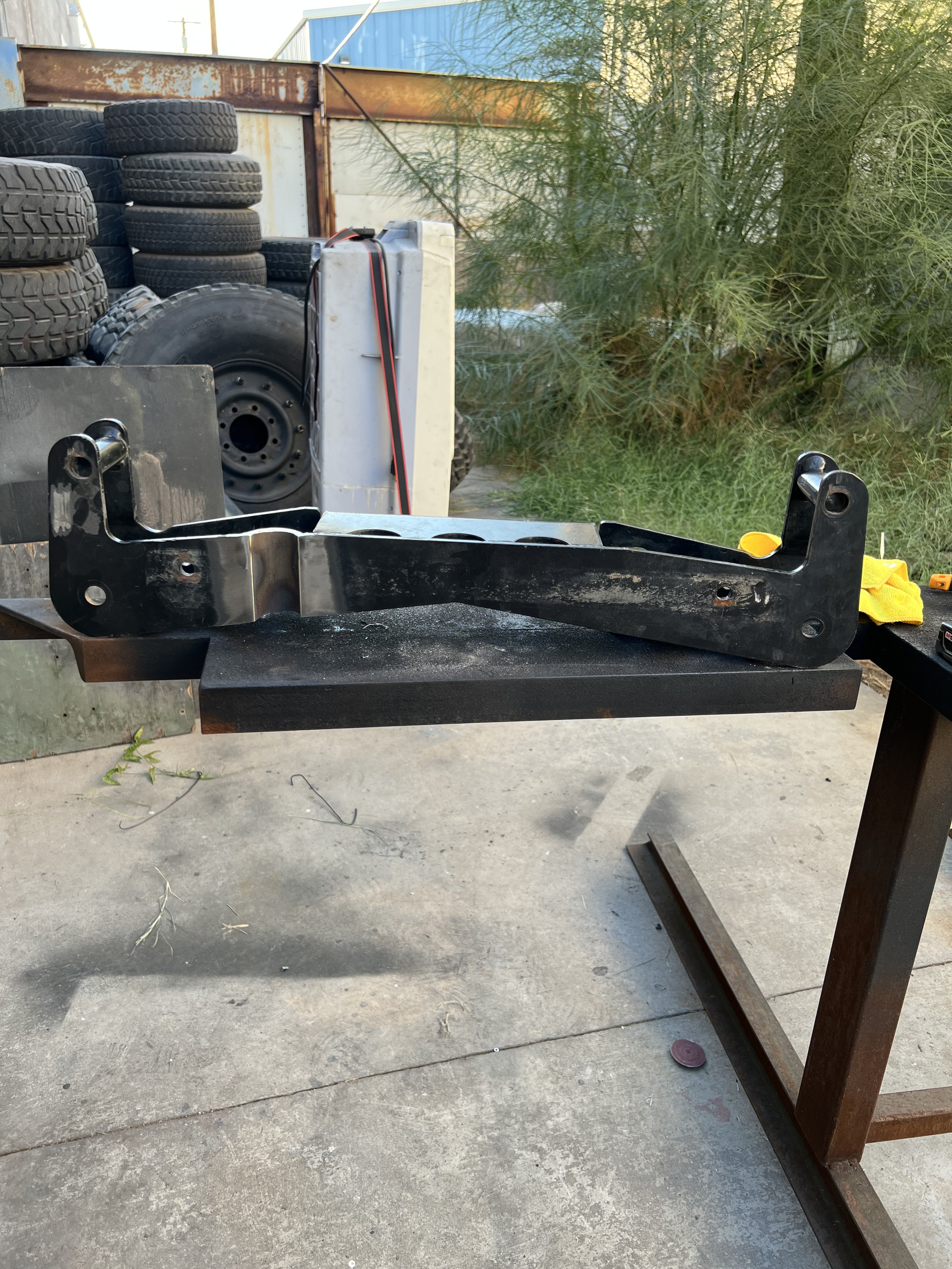

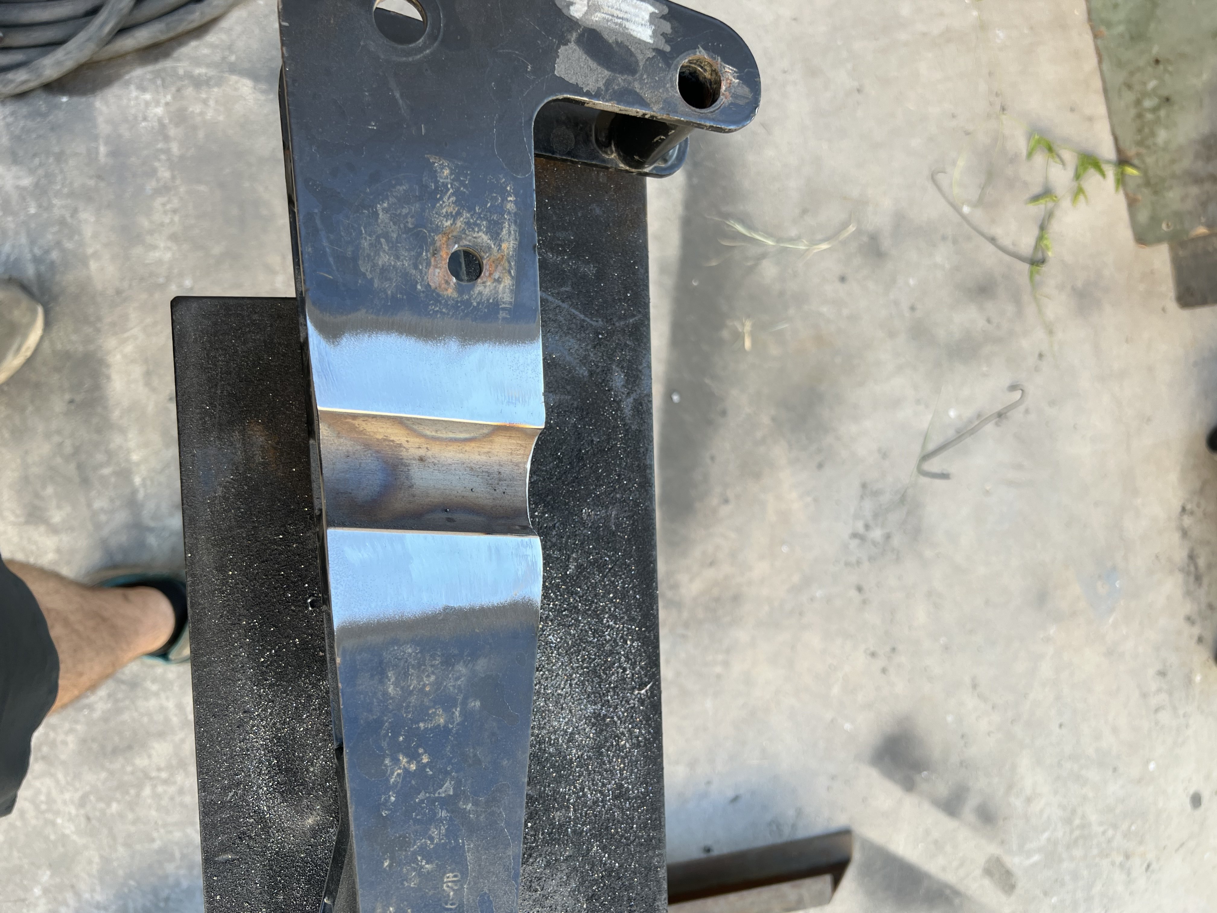

Xj bar pin eliminator machined out for the H3, going to run a bead on the other side to compensate for the amount of weld machined out.
Better late than never to paint my tomp low profile mounts, slapped them on raw 4 years ago.

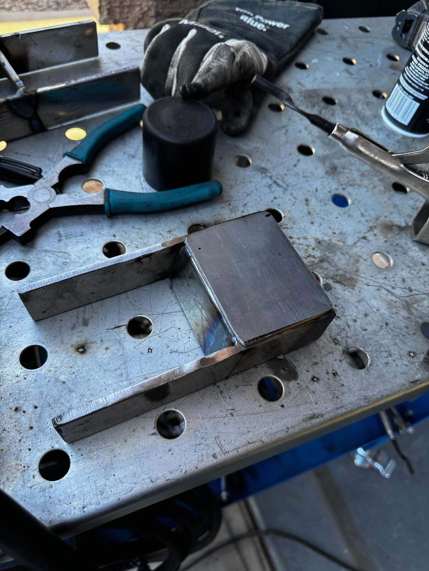

Buddy of mine helped save me some time with fabricating some bump stop mounts for me. We decided to box it in for strength.
