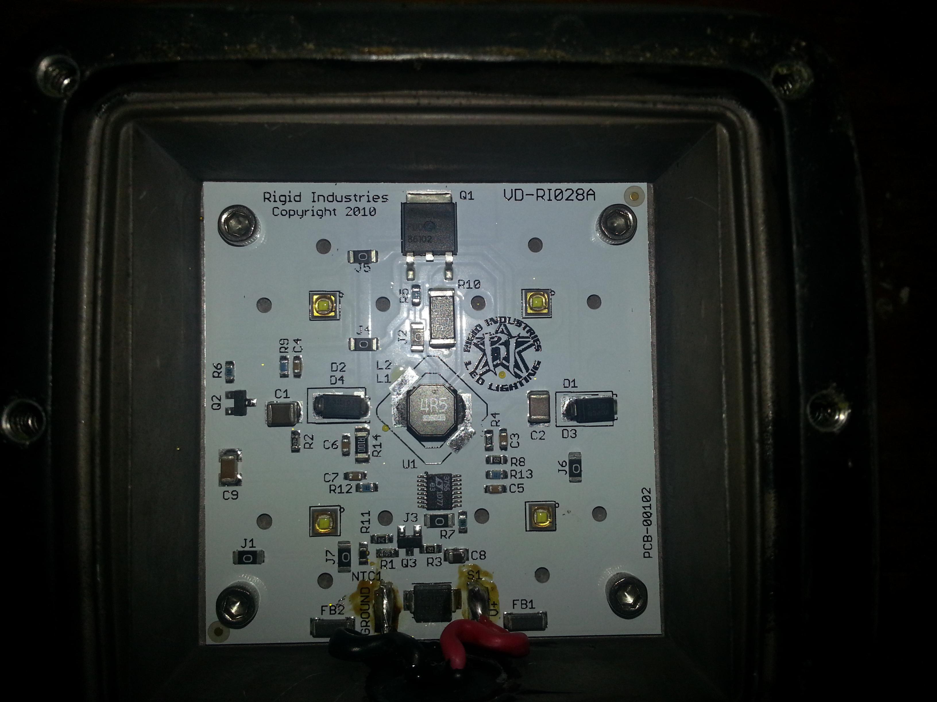

Rigid PCB - View attachment 10860

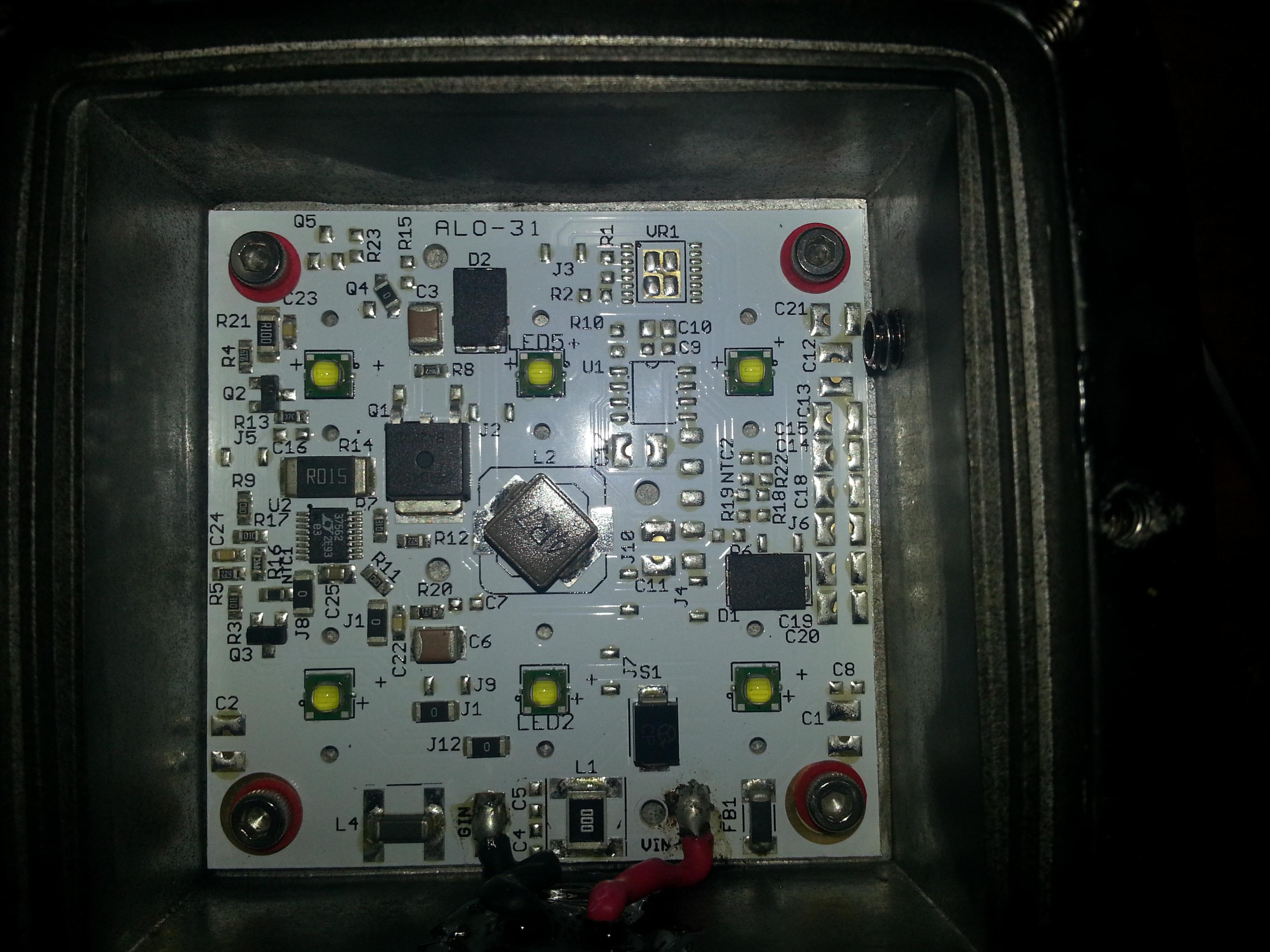

Aurora PCB - View attachment 10861

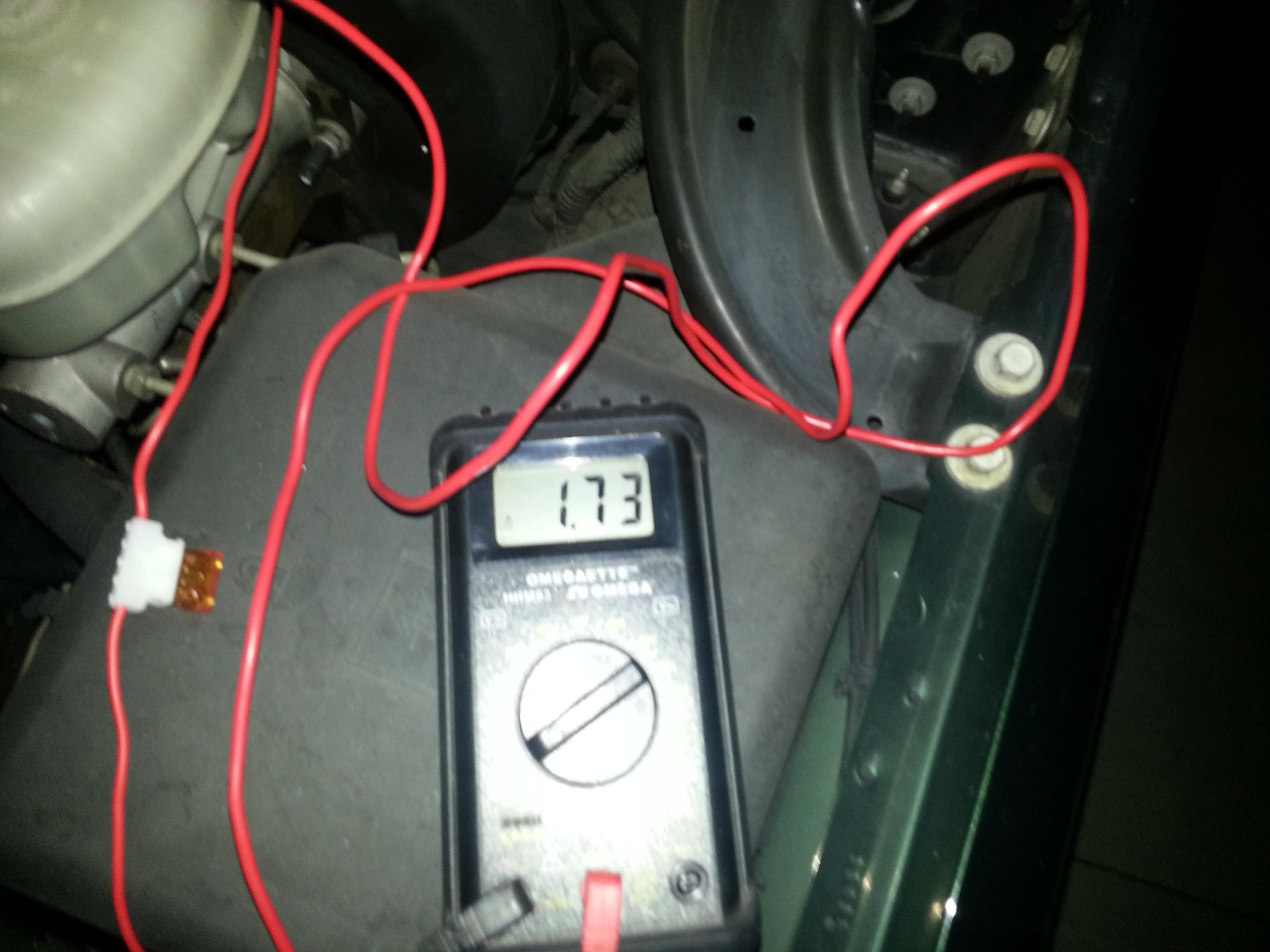

Rigid amp draw - View attachment 10862

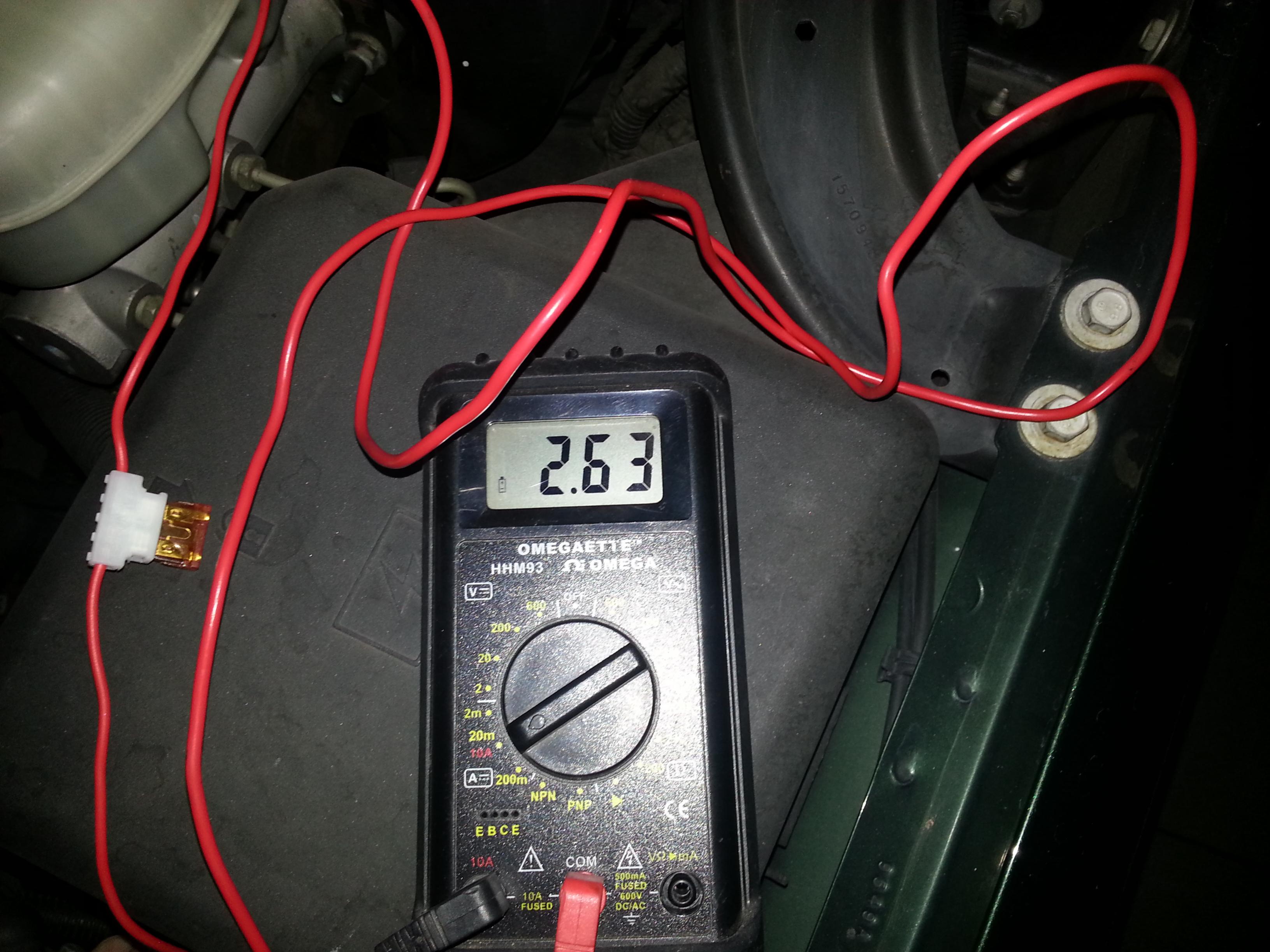

Aurora amp draw - View attachment 10863

I find it funny that even the heat shrink on both lights are the same. What are the odds?
