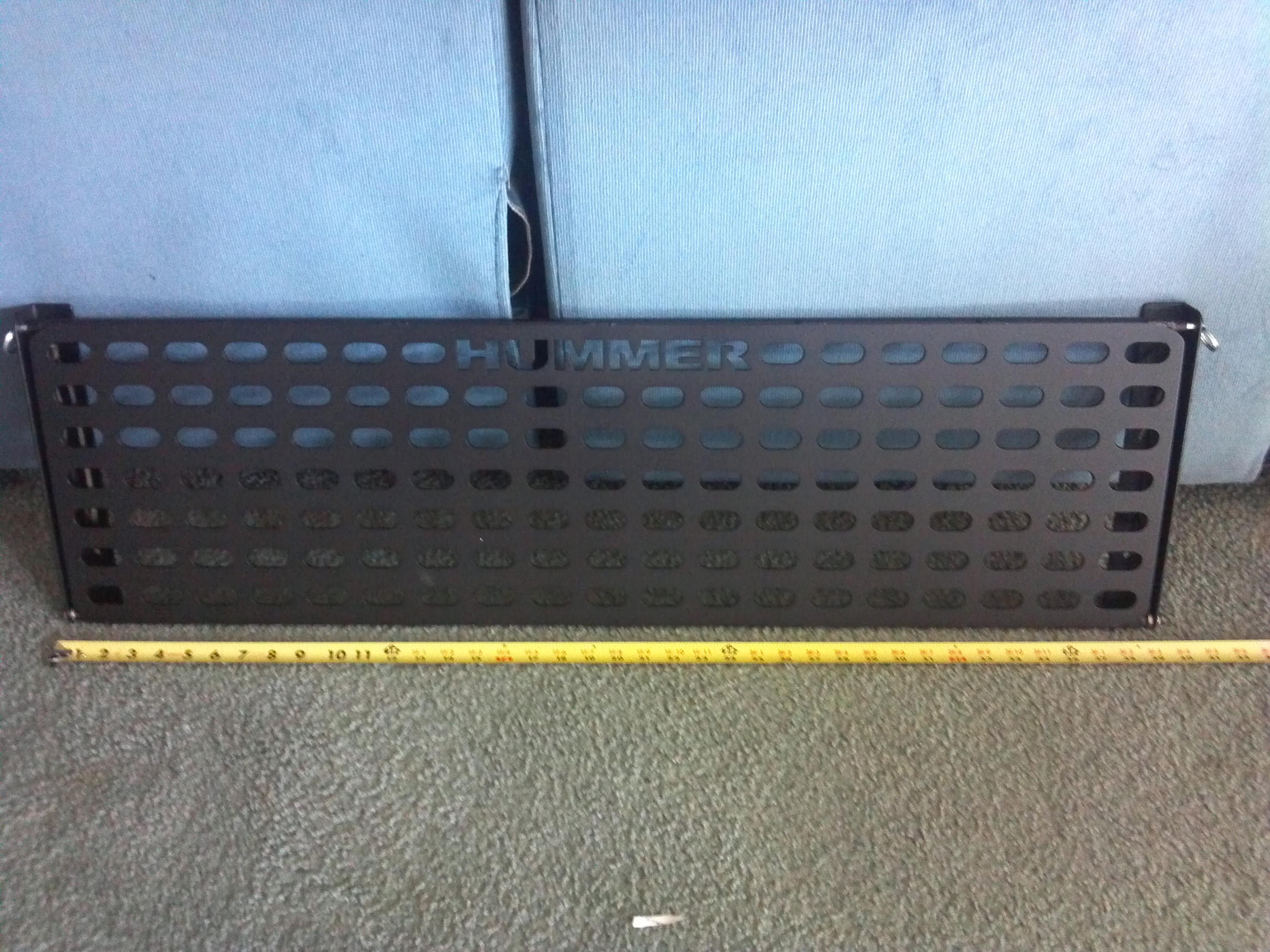

So I purchased a Hummer molle panel from Alan the fabricator. I did have him change the lettering to "alpha" and with the hummer specs. The quality and workmanship is phenomenal. Great guy to deal with.

Did you get the eider one? I have the 38 or 39" one at home but I have been in Australia for a few weeks and have not gotten to see it.

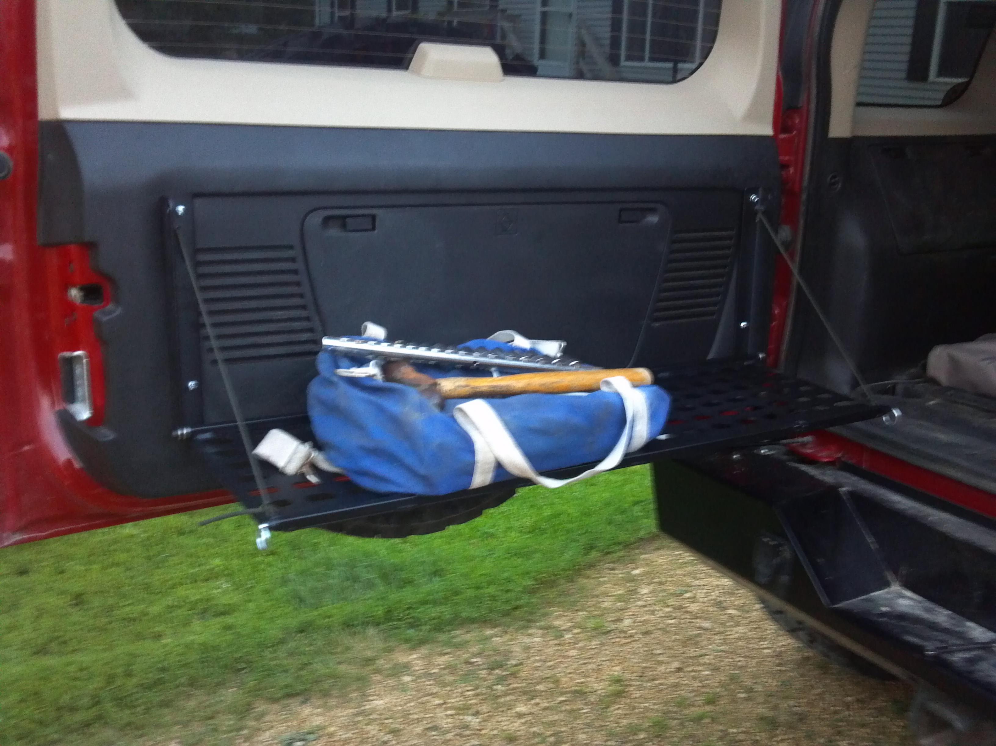

I know im answering my own question but after looking at the pictures a bit closer it should be strong but eventually the weak point becomes what it's mounted to which is plastic. I wonder if there's metal behind the panel to bolt it to that. Either way it should be strong enough to do things like making lunch.

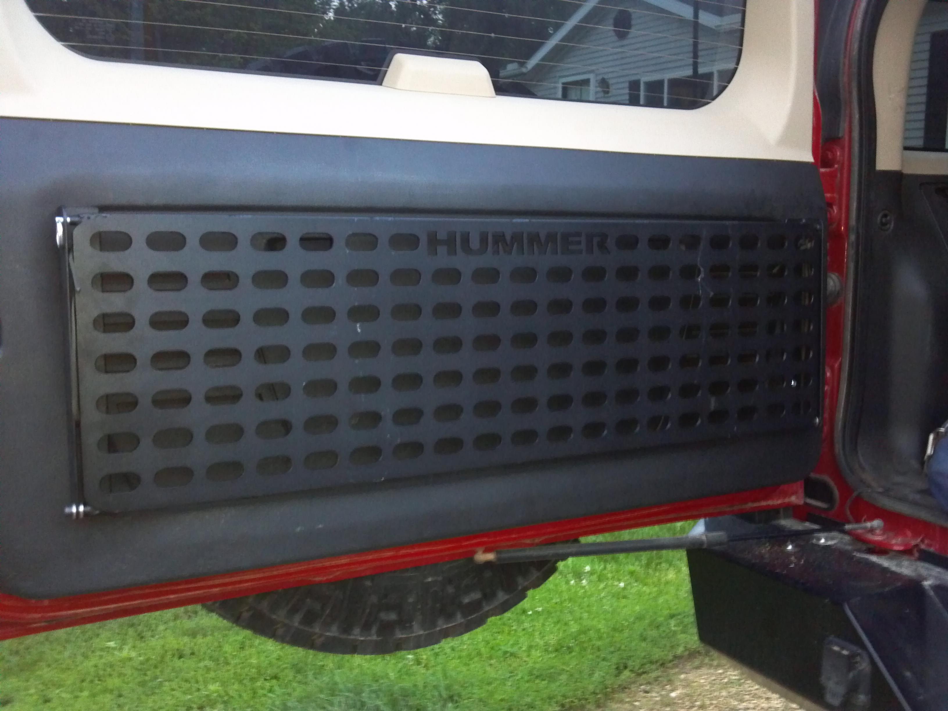

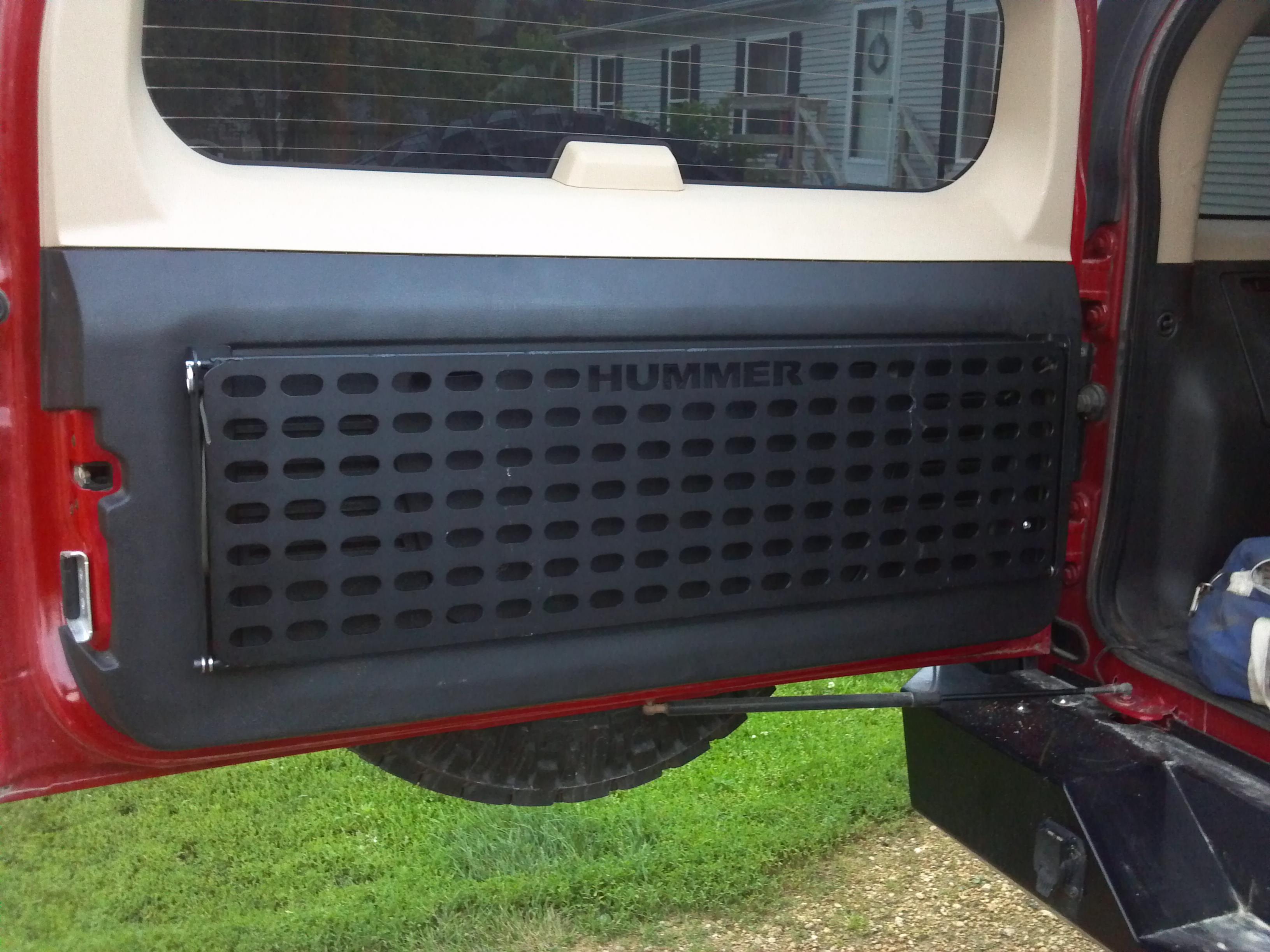

Made it back home last night. Its funny how a week trip takes about three weeks to finish. Here is a pi criteria of the panel will have it mounted this weekend.
jakesz28
1,056
Cabool MO
Got it mounted. There is about 40lbs of tools in that duffle bag. Its not coming off.

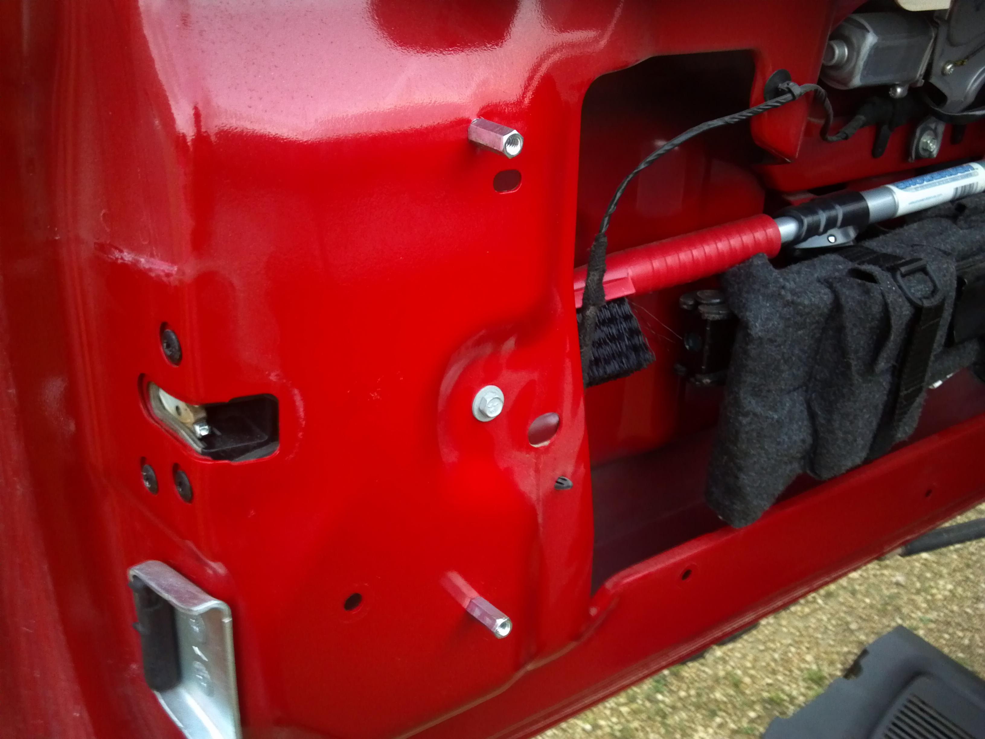

I used the threaded hex stock that is sold at most hardware stores. It is usually sold with the steel and threaded rod. Then some 1/4" all thread. I used what I had on hand but may replace the upper piece so it matches then lower one. Then used pan head bolts to go thru the plastic panel.

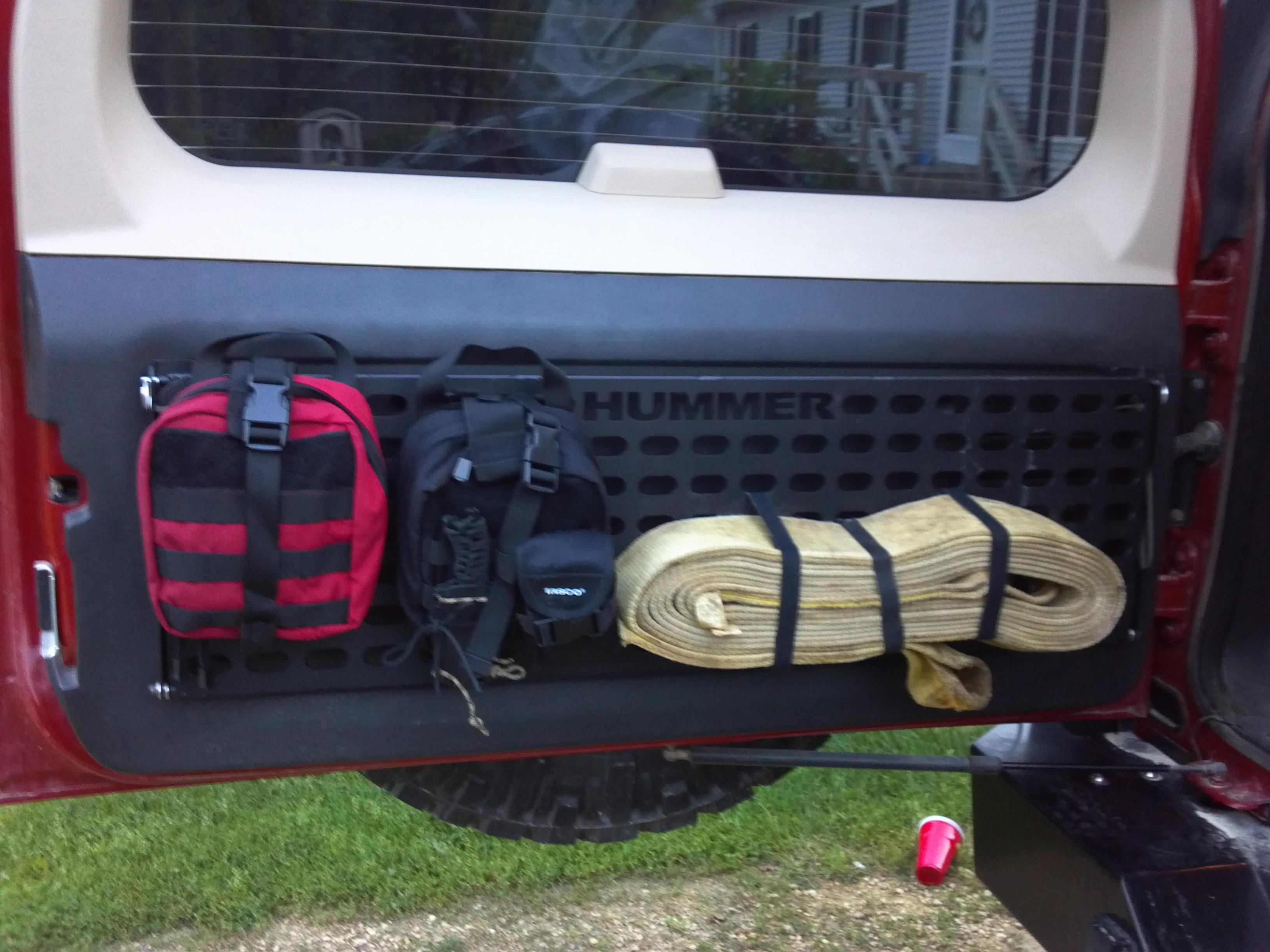

I have the first aid kit filled and mounted, have fire starting and signal kit, then stainless drinking cup, UV pen, some survival rations.

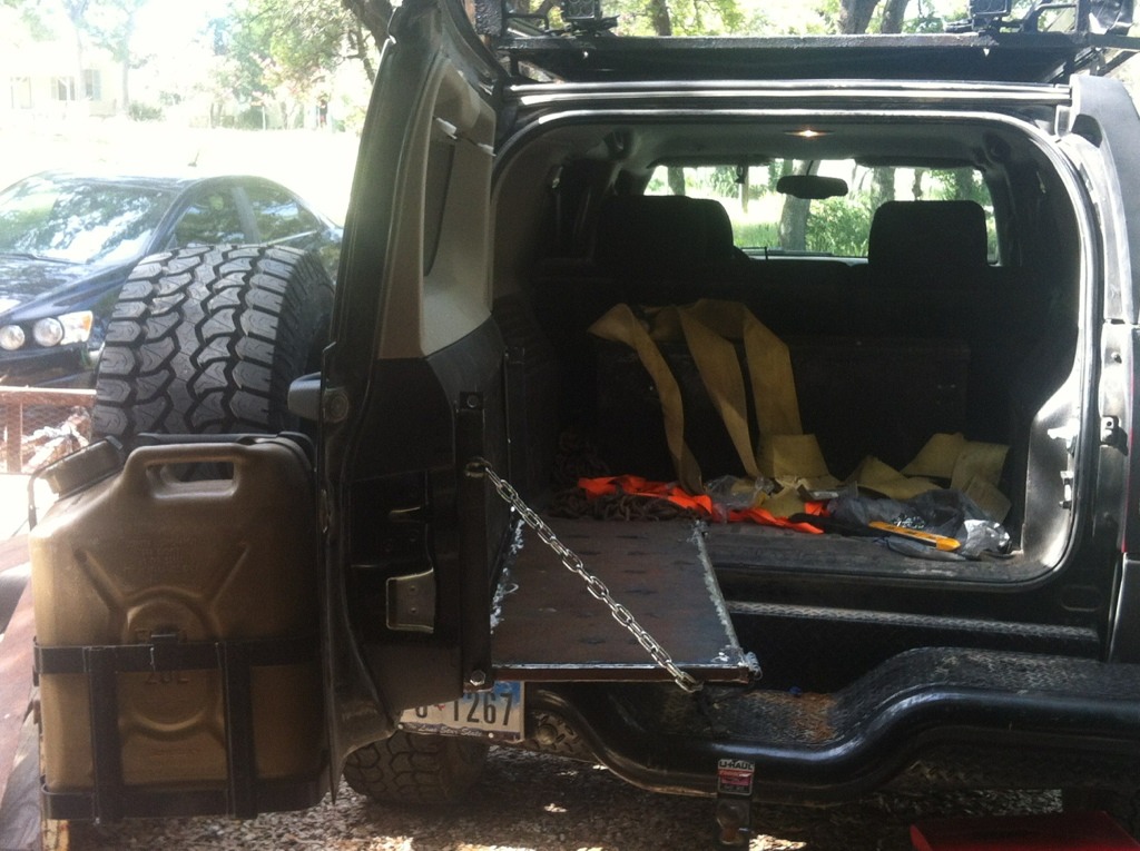

too bad we dont have a perfect spot for one like the 3's do!
I know! I told FRU I was going to build one in the bed of my truck and it was going to slide out and drop to a 45 degree angle on to the ground and nothing but pistols rifles machine guns and bazookas would be on it...

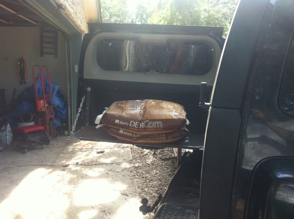

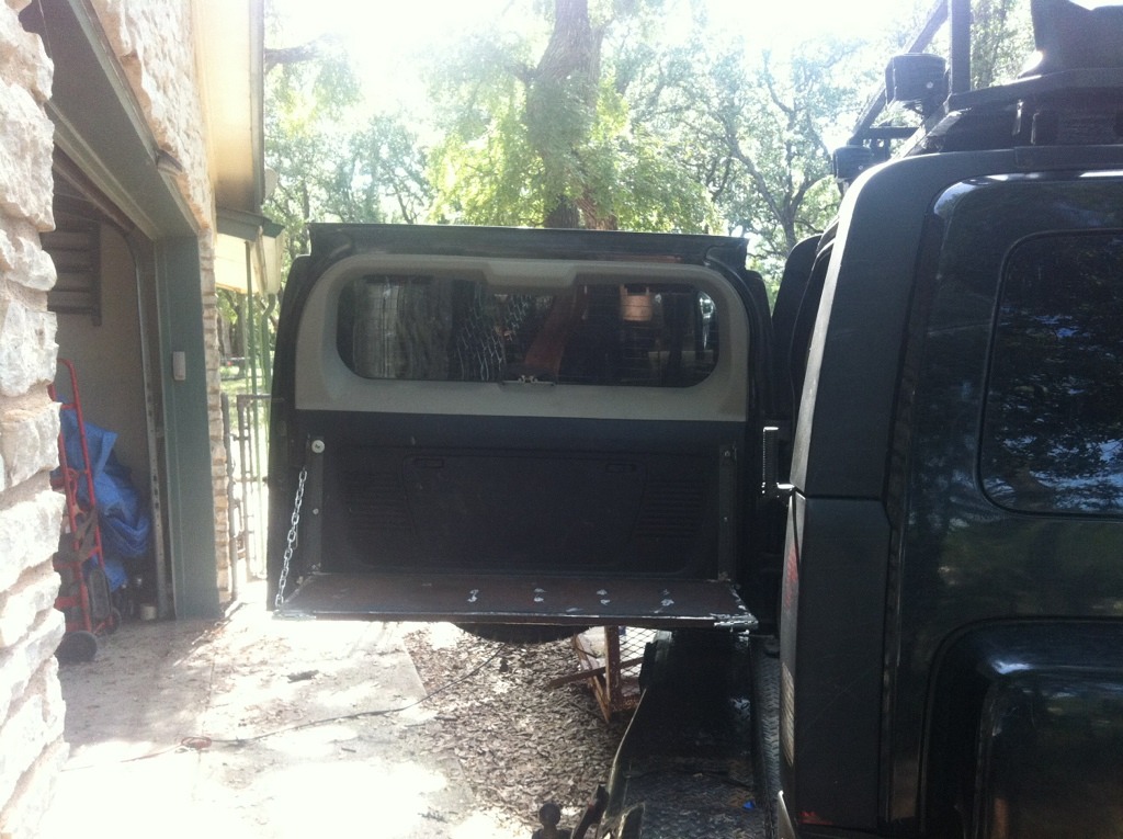

Finally finished mine. The pic is with 80 pounds of deer corn on it. I put most of my weight in it too, 230 pounds, and no budge. Thanks jakesz28 for the heads on how to mount it.ImageUploadedByTapatalk1375570542.957563.jpgImageUploadedByTapatalk1375570557.867201.jpgImageUploadedByTapatalk1375570572.715168.jpg
FRU
