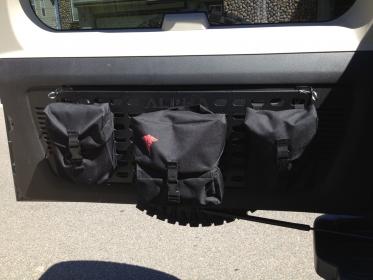

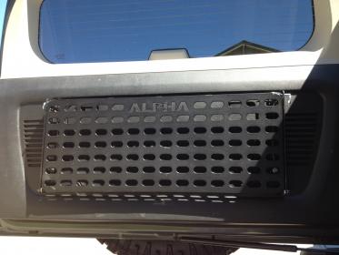

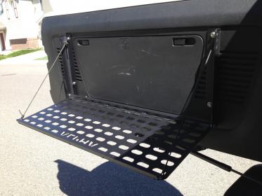

I purchased one for my alpha and went to my local army surplus store and bought 3 molle packs for it. Great storage, first aid kit, water, high calorie bars and "stuff". Great addition and a quality product. And it looks great and functional when used as a table/ work area. Holds wine or beer phenomenally when sitting on a 13,000 pass looking at Colorado vistas......

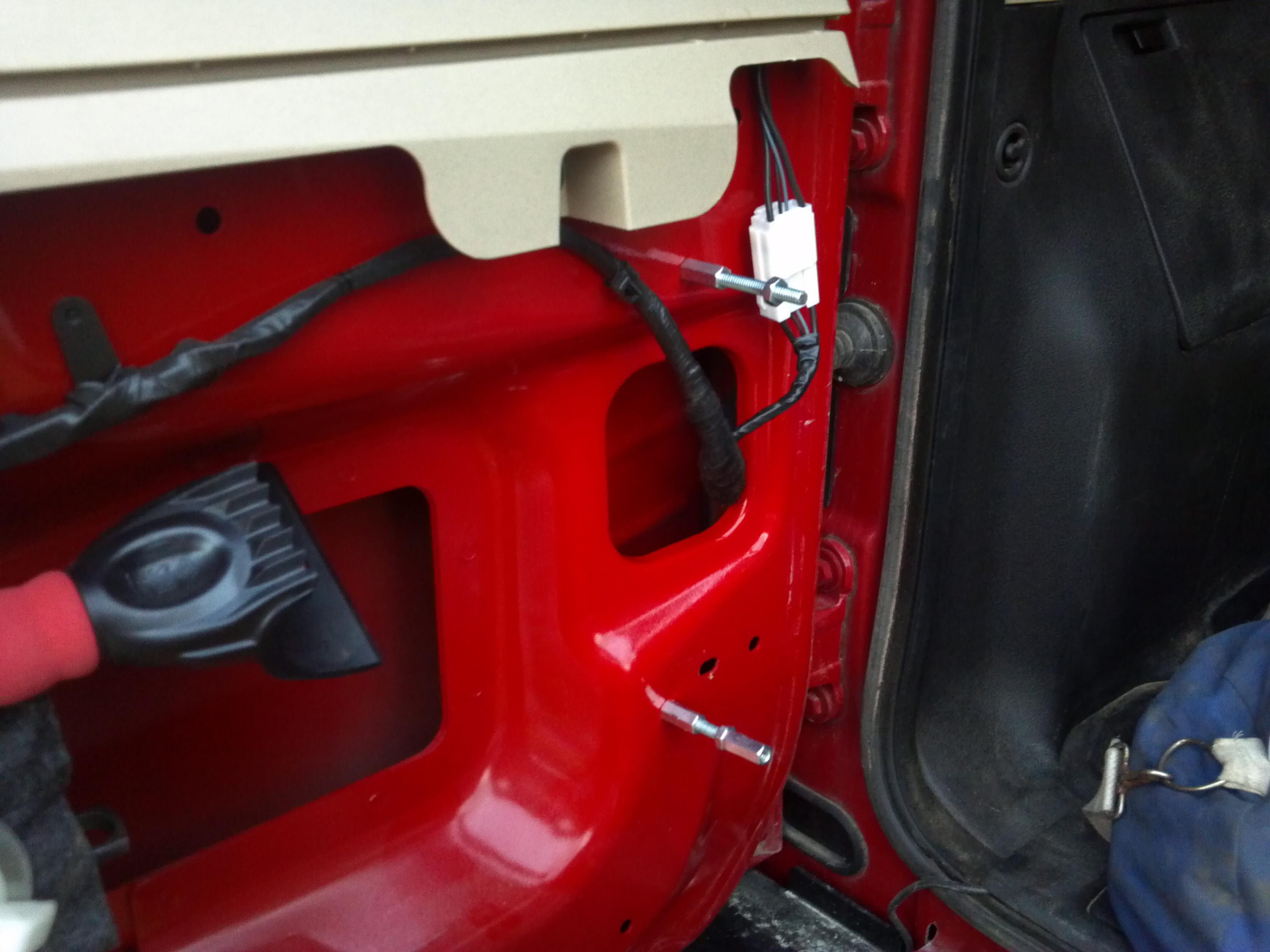

I used the threaded hex stock that is sold at most hardware stores. It is usually sold with the steel and threaded rod. Then some 1/4" all thread. I used what I had on hand but may replace the upper piece so it matches then lower one. Then used pan head bolts to go thru the plastic panel.

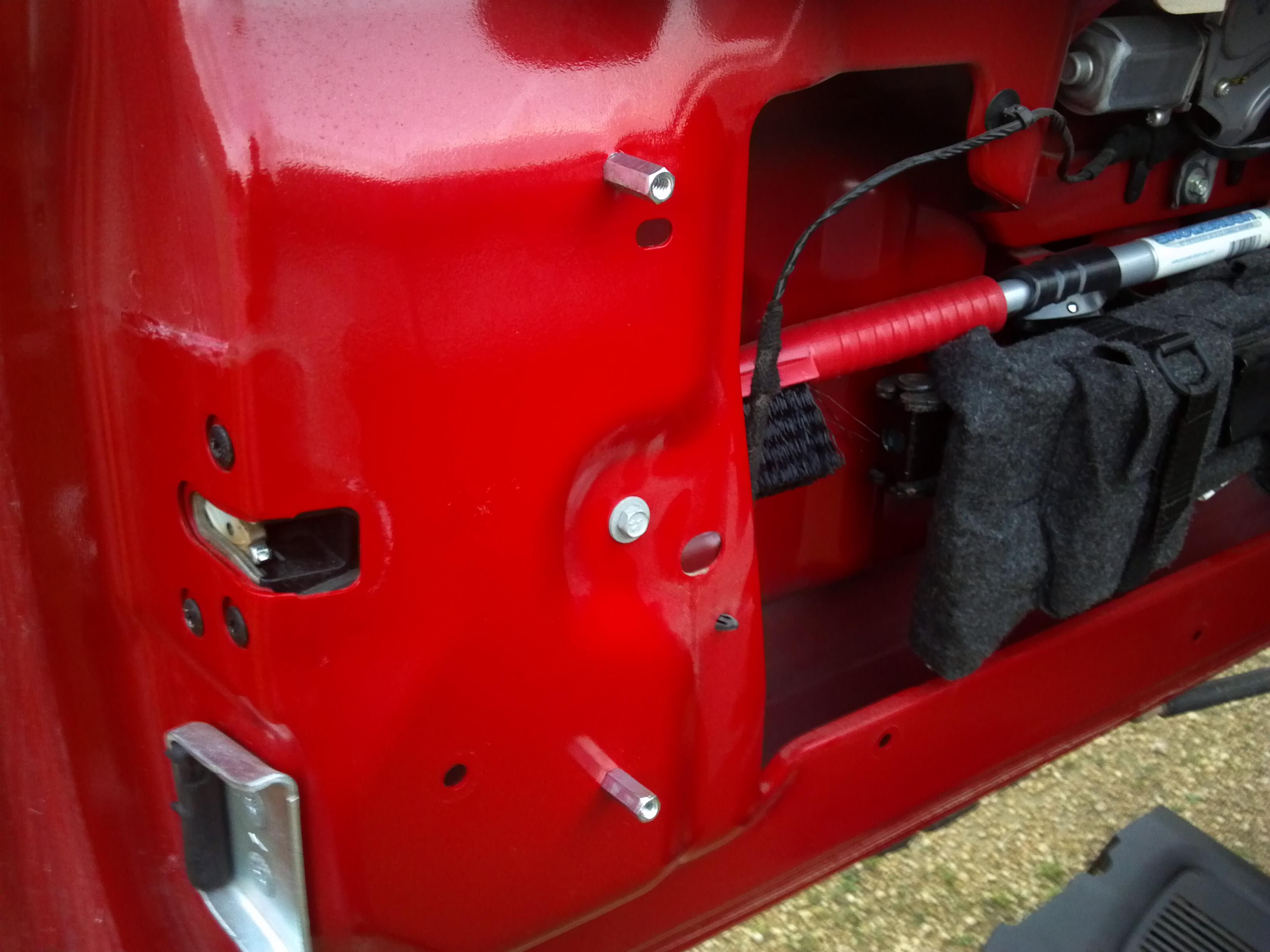

Finally installed my MOLLE fold down panel.
I started by first marking and drilling the holes in the plastic molding. Then with a caliper measured the distance of each hole to the sheet metal of the tailgate. My plan is to tie into the metal structure of the tailgate since it will hold much more weight then just attaching to plastic molding.
I then made some threaded extensions to match the distance from the plastic molding to the sheet metal. Each corner was different since the sheet metal is not flat.
I reinstalled the plastic molding and installed the panel. Everything lined up perfectly. The time taken up measuring and marking everything was worthwhile.
Attached some MOLLE pouches for storage of recovery gear and first aid kit.
Tying into the sheet metal of the tailgate really makes the shelf extremely sturdy. It's worth the extra work and effort. Thanks to jakesz28 for coming up with the original idea.
