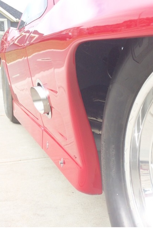

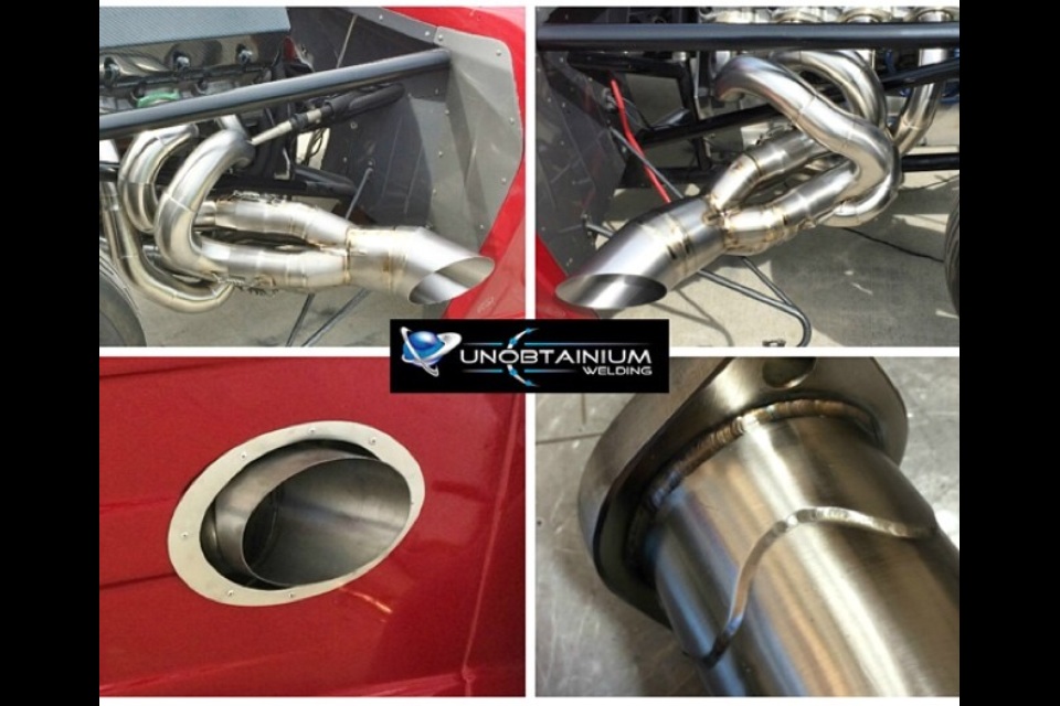

I could picture this:
SuperBuickGuy
3,403
Woodinville, WA
there's a guy on Corvette Forum who did that with his turbo'd C3... I think it looks really funny because the pipe has to come out in the middle of the vent since the frame covers the lower 1/3 of that hole..... with that said, the has been some pointed comments from friends about turbo'ing the next motor going into this car. I'm considering, though, doing that type of exhaust on my H3 and a squared exhaust using the same idea on my 50 Buick
