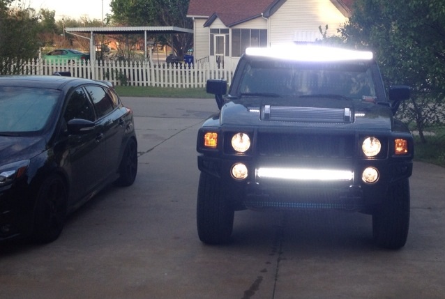

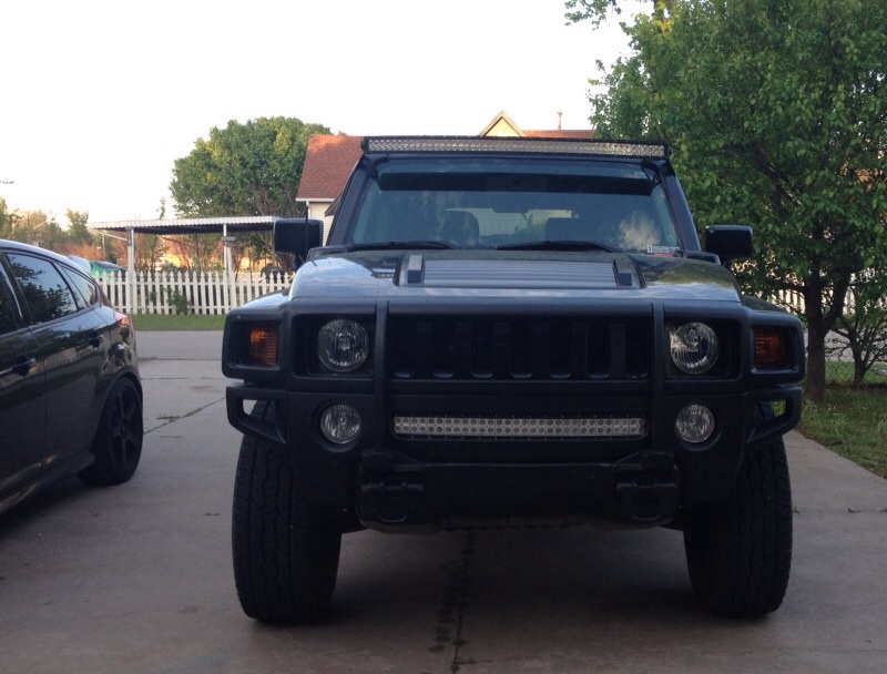

the bar is too close to the windshield, thus the wipers get stuck under them. I haven't decided which route I'm going to take to fix it, so for now it has funny looking brackets on it with no light bar. Part of me is considering doing away with the bar altogether and putting more lights on the brush guard.... we'll see.
Im thinking the same you can put a 30 inch in the grill.
