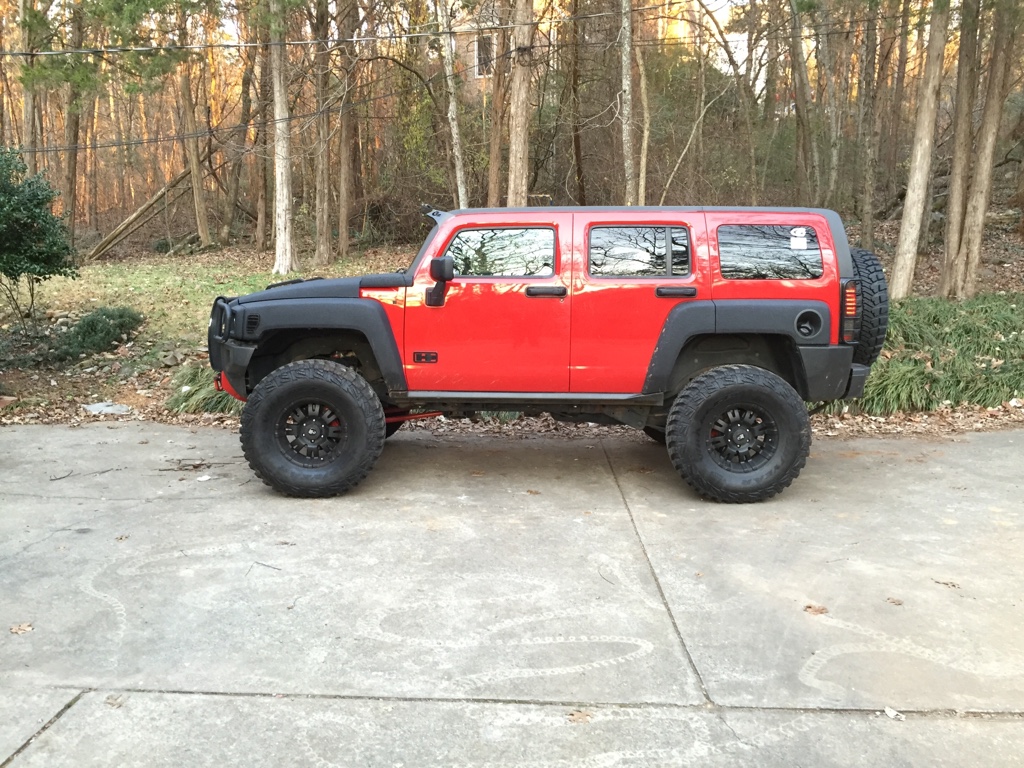

Pics ImageUploadedByTapatalk1418343997.154259.jpgImageUploadedByTapatalk1418344010.441708.jpgImageUploadedByTapatalk1418344034.071544.jpg

I like man great job...I'm still undecided weather going with a 1 inch or a 2 inch...but seems like I'm leaning more towards the 1 inch body lift...just because H3on40's said that he had to mod something with his transmission (like a cable or so). Did you get any fender Rubin with the 37's when at full flex...and if so did the body lift has help with such rubbing ?
Torres
W/O bodylift:
A bit of rubbing with 4.5" backspacing, but only one side when fully turned. With spacers I rubbed alot.
With bodylift:
Without spacers no rubbing at all, havent checked articulated.
With spacers a bit of rubbing

My body lift save me from totally losing my front inner fenders while running 35" KM2s. Fully locked and articulated, my tires ripped out a portion of both my inner fenders.
Yeah, it definitely has my steering linkage stretched a bit. I also rotated the shroud so the fan would not hit. There are some other gotchyas, like the "shoud" in front of the radiator needs to be trimmed or just removed. Also, my body bolts keep loosening up so they require a check every so often (Blue LocTite has proven to be ineffective).
The bolt aren't loosening up...the biscuits are shrinking.
After the first time you rip the inner fenders...the problem is cured. Can't rip what's no longer there.
Not quite . . .
The bolts are torqued down to the sleeve. This part should not loosen up otherwise all H3s would be experiencing this problem. As far as the inner fenders, I still have them. A portion has broken off the front, but they are still there and I plan on keeping them.
