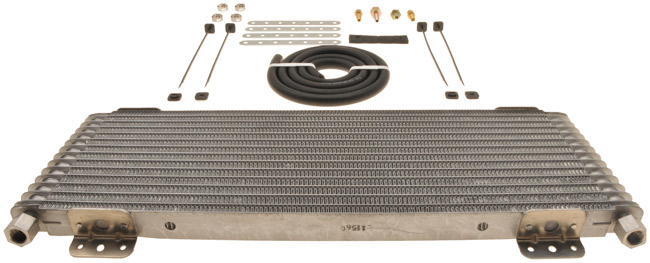

Hi guys, the new tranny will be shipped tomorrow. I'm going to get a new tru-cool 40k cooler to replace my current one to avoid contamination.

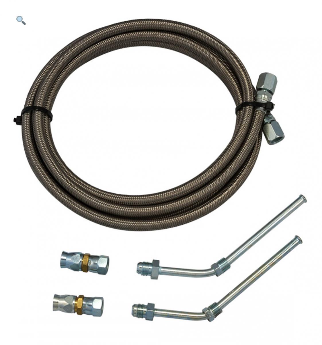

I'm also looking for braided lines that go from the tranny, my current cooler line situation includes hose clamps and, pretty sweaty and messy.
Has anyone bought a 6' hose kit that they're happy with? Any help would be greatly appreciated.

What's wrong with the factory hard lines? Seems going with braided hose could be a pain since you'd have to add anchoring for it and make sure to route it away from the nice hot catalytic converter.
I currently have the i5 lines on the new V8 setup, the alpha lines have different part numbers and are routed slightly differently (to clear the bell housing & alpha downpipes). At the moment my lines pass close to the cat converter and I can’t bend them or reroute them.
Also can’t get the alpha lines because my downpipes & cat are not routed stock either.
I’ll take pictures when its on the ramp and post them soon.
