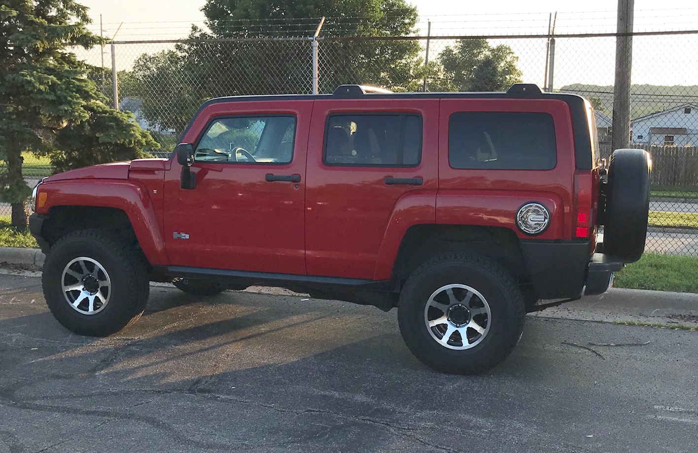

Replaced upper control arms/ball joints, lower ball joints, and installed new camber kit on both sides then had an alignment done. All that combined with new hubs, CVs, and axle seals that I did last fall and now she drives like a new one. Next up, steering rack reinforcement kit and diff bushing replacement.

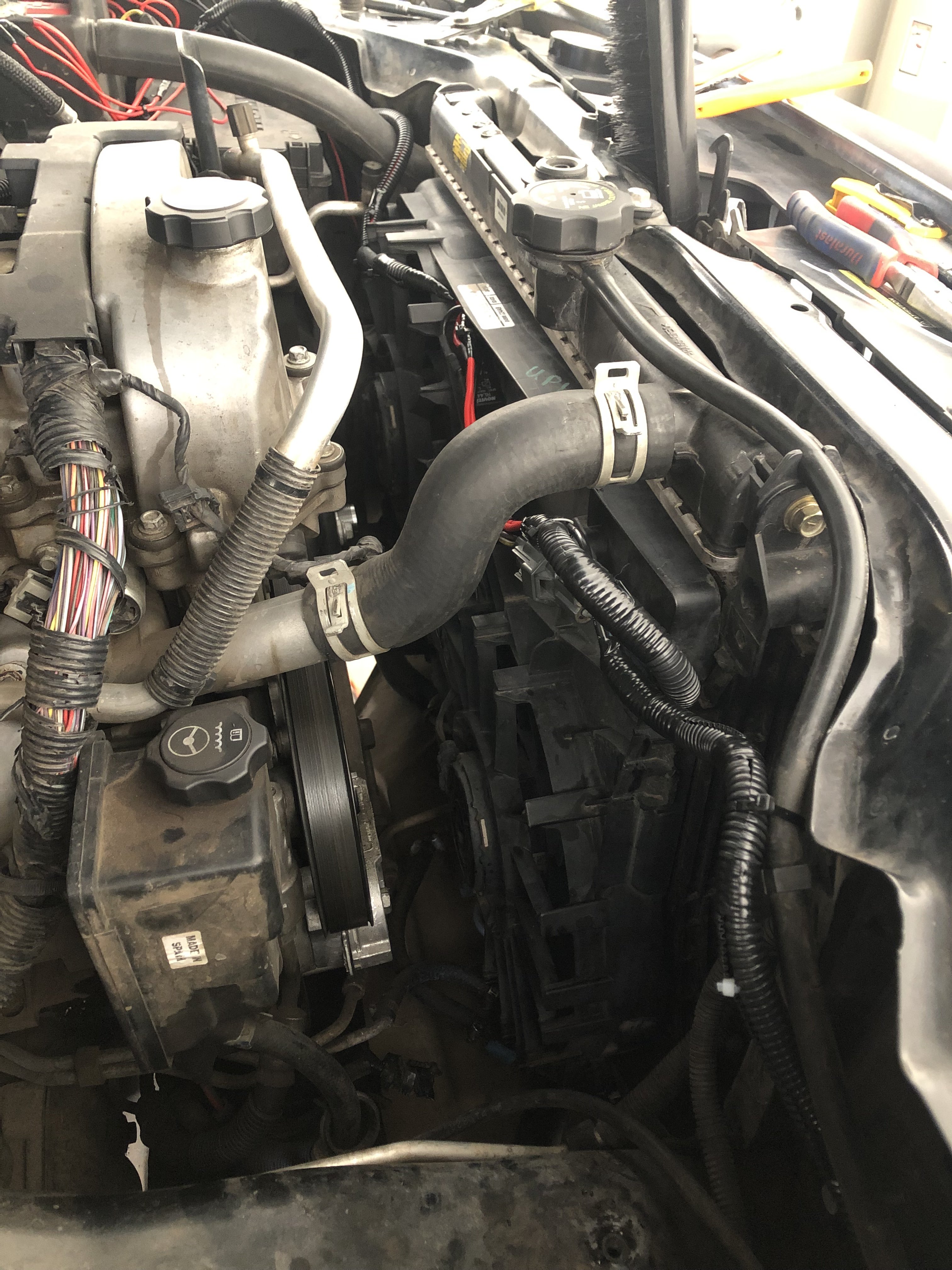

I pulled this assembly off a 2005 Chrysler 300c from a junkyard. It has standard and heavy duty cooling. To get that it needs to have the 5.7L hemi or bigger. I figured if this fan can cool down a motor that big, it can cool my I-5 well.
Still testing highway and Phx summer heat. I’ll make a thread on this when I found out more about the fans capability and reliability with the truck

keep us posted

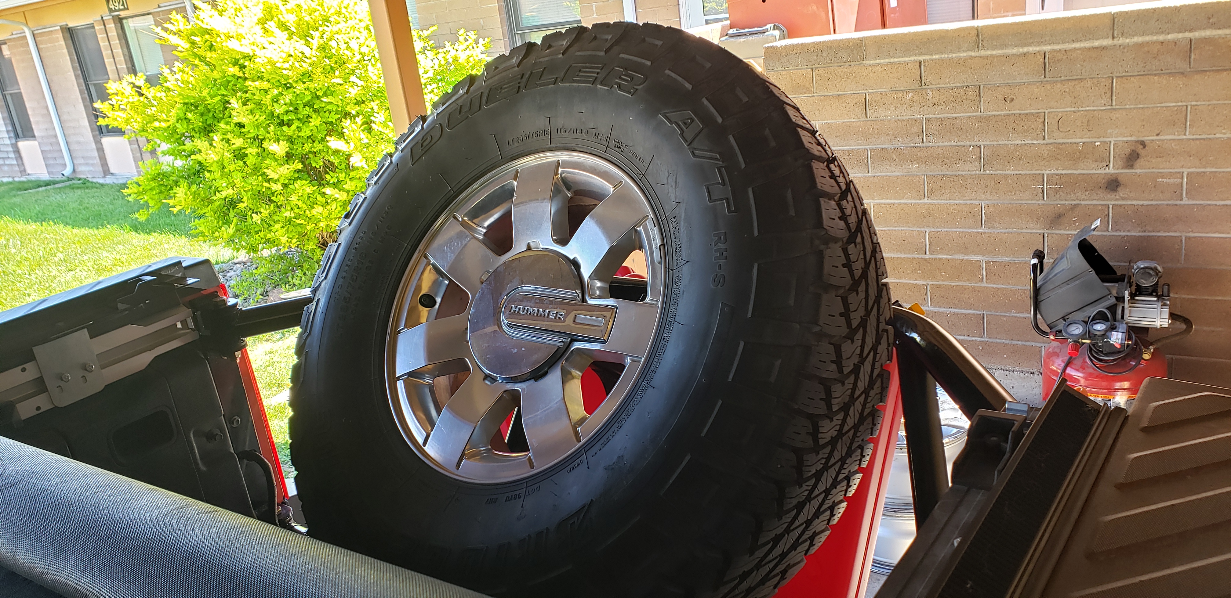

Scored 5 wheels and one with a tire on it yesterday for a slamming deal. Wheels on the T are falling apart after living in Oregon, this deal came just in time!

New wheels with 285s.:) Also had just replaced the upper control arms/ball joints, lower ball joints, camber kits and a fresh alignment.

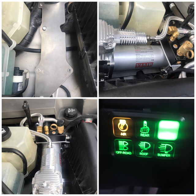

Outfitter Design mounting bracket.
Installed VIAIR 450 compressor using Outfitter Design mounting bracket. Great product!! Have ports open for eventual tank install. At this point, the blowoff valve kind of sounds like an old popcorn wagon but am satisfied with the result
