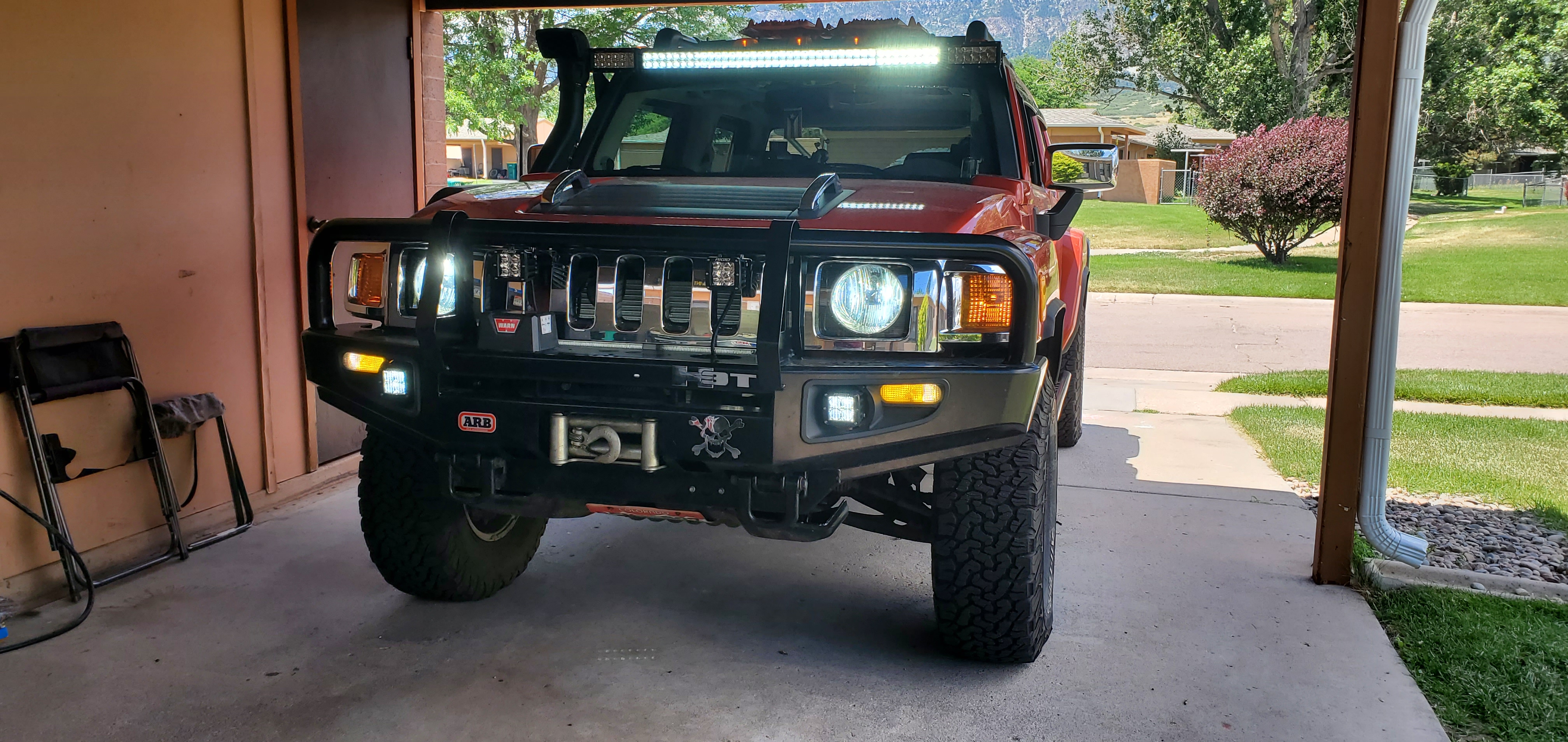

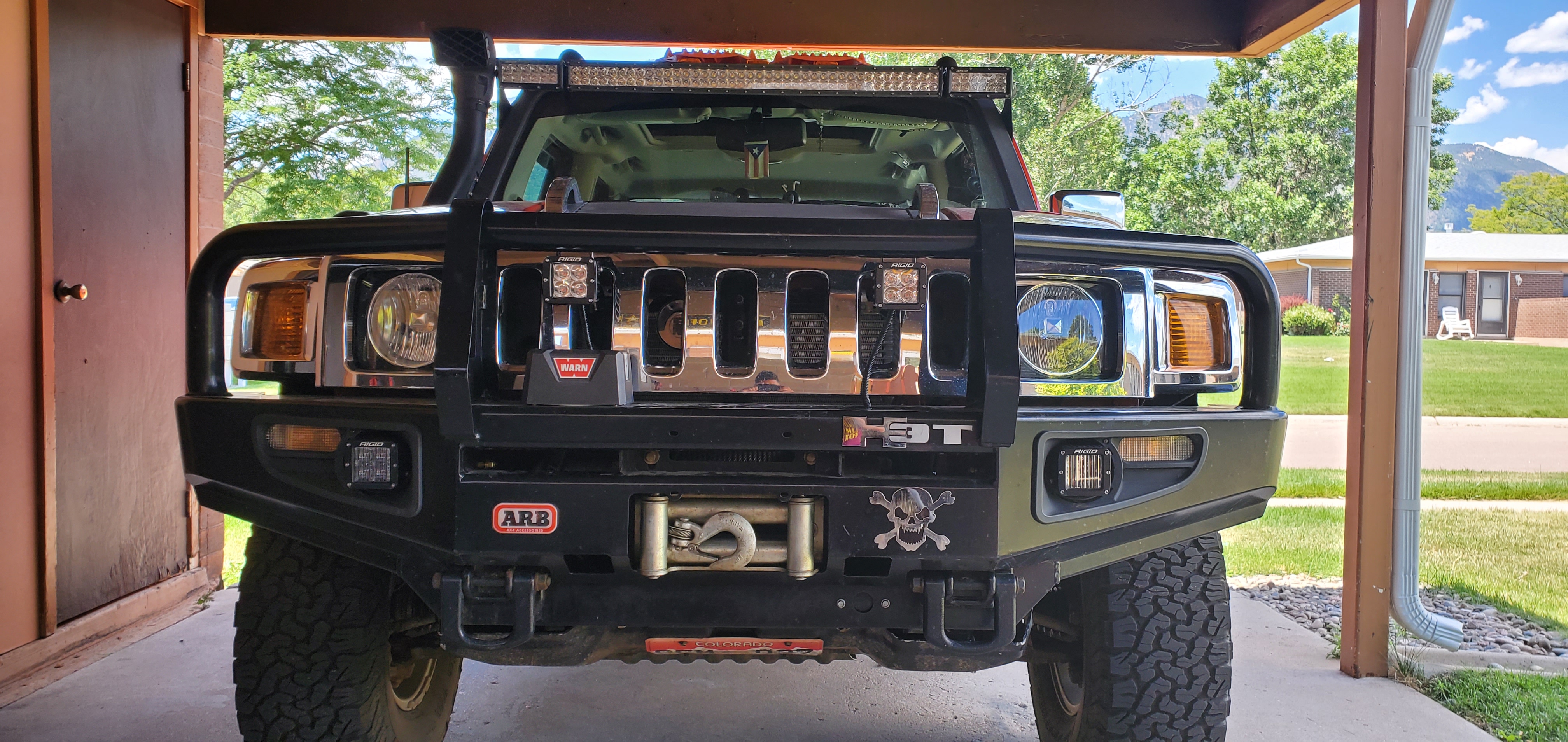

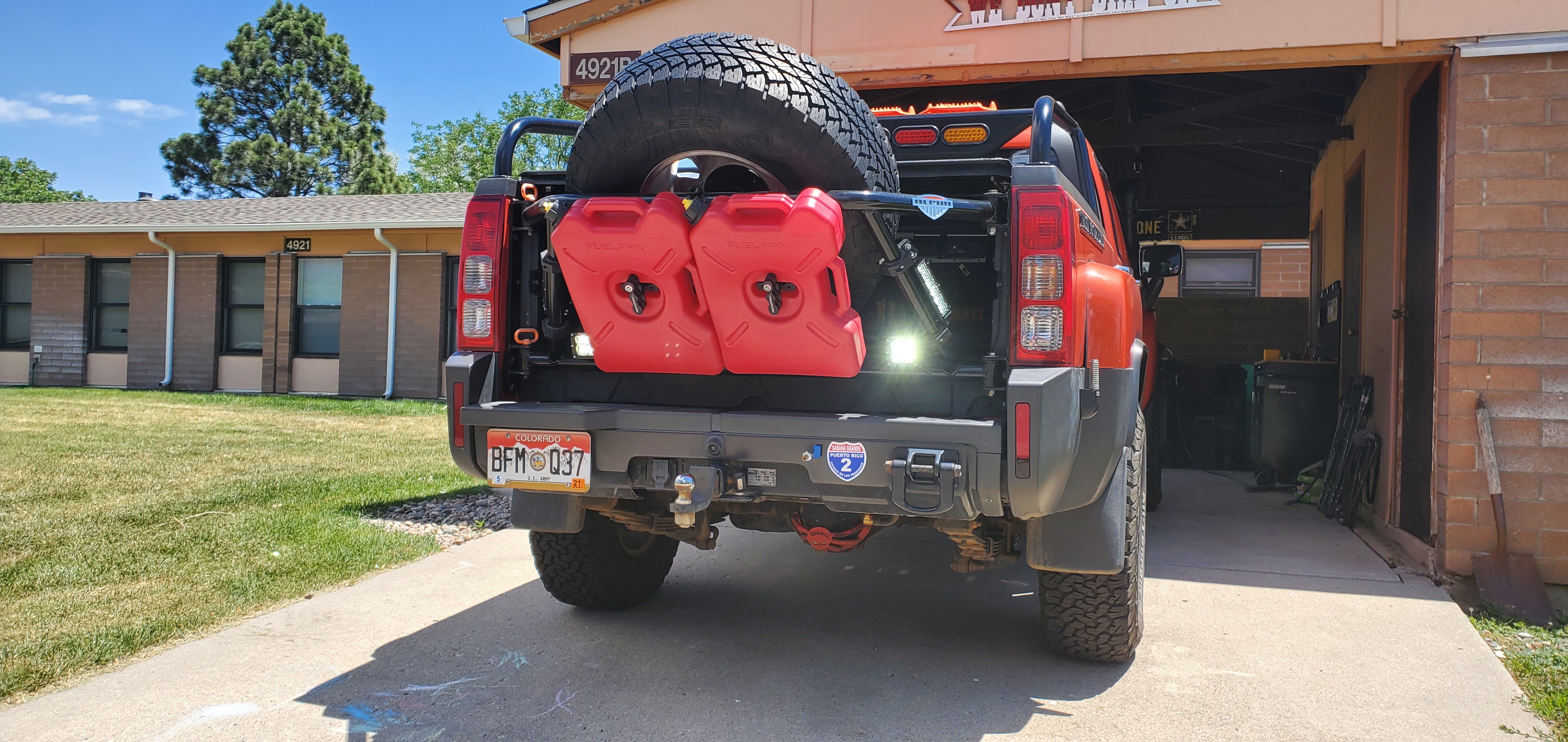

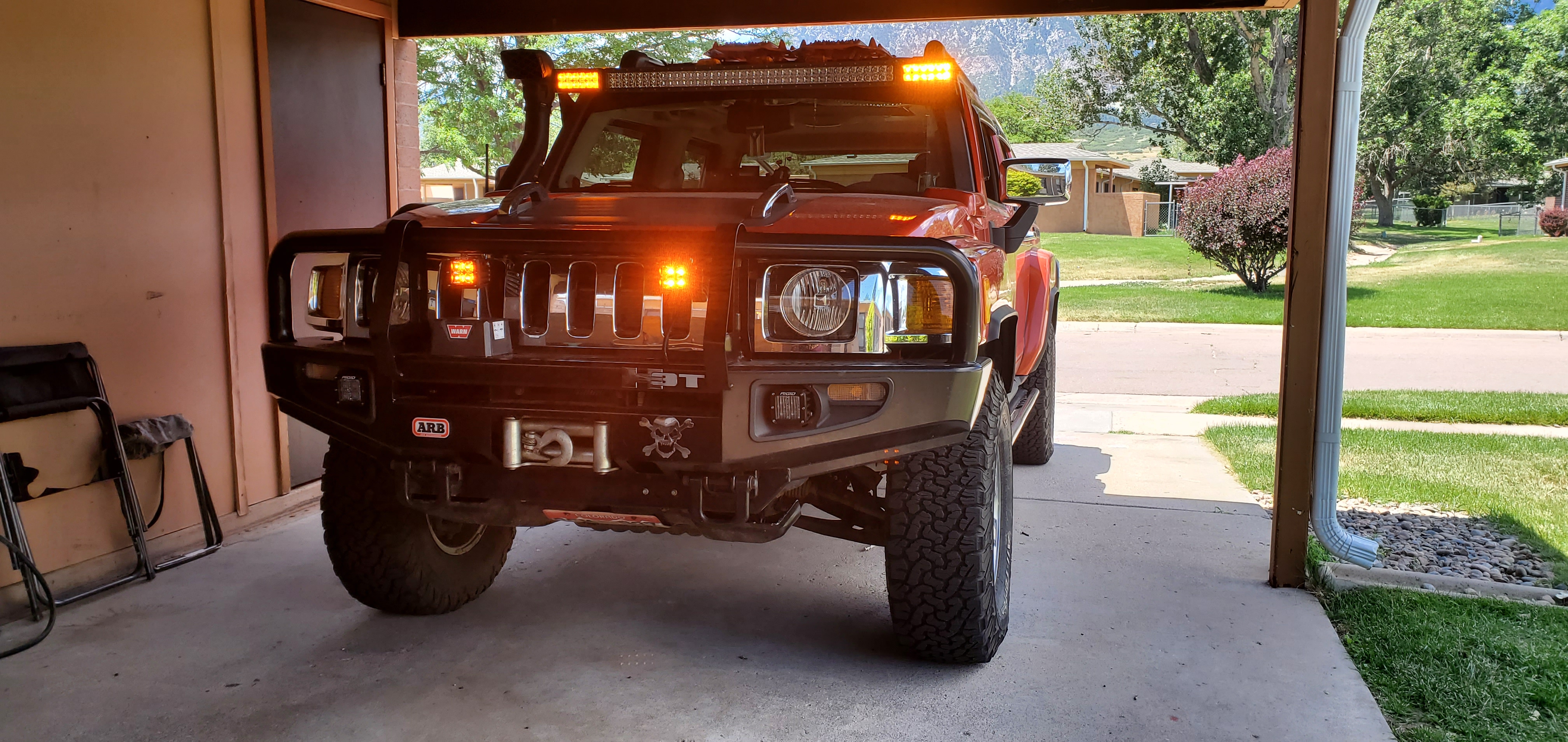

Alright... I'm done with making my truck into a moving light tower lol.
All the lights are rigid industries products:
40" spot/flood bar
DOT fogs
6" amber spots
Amber flood pods
The rear:
Flood pods
6" diffuse bars

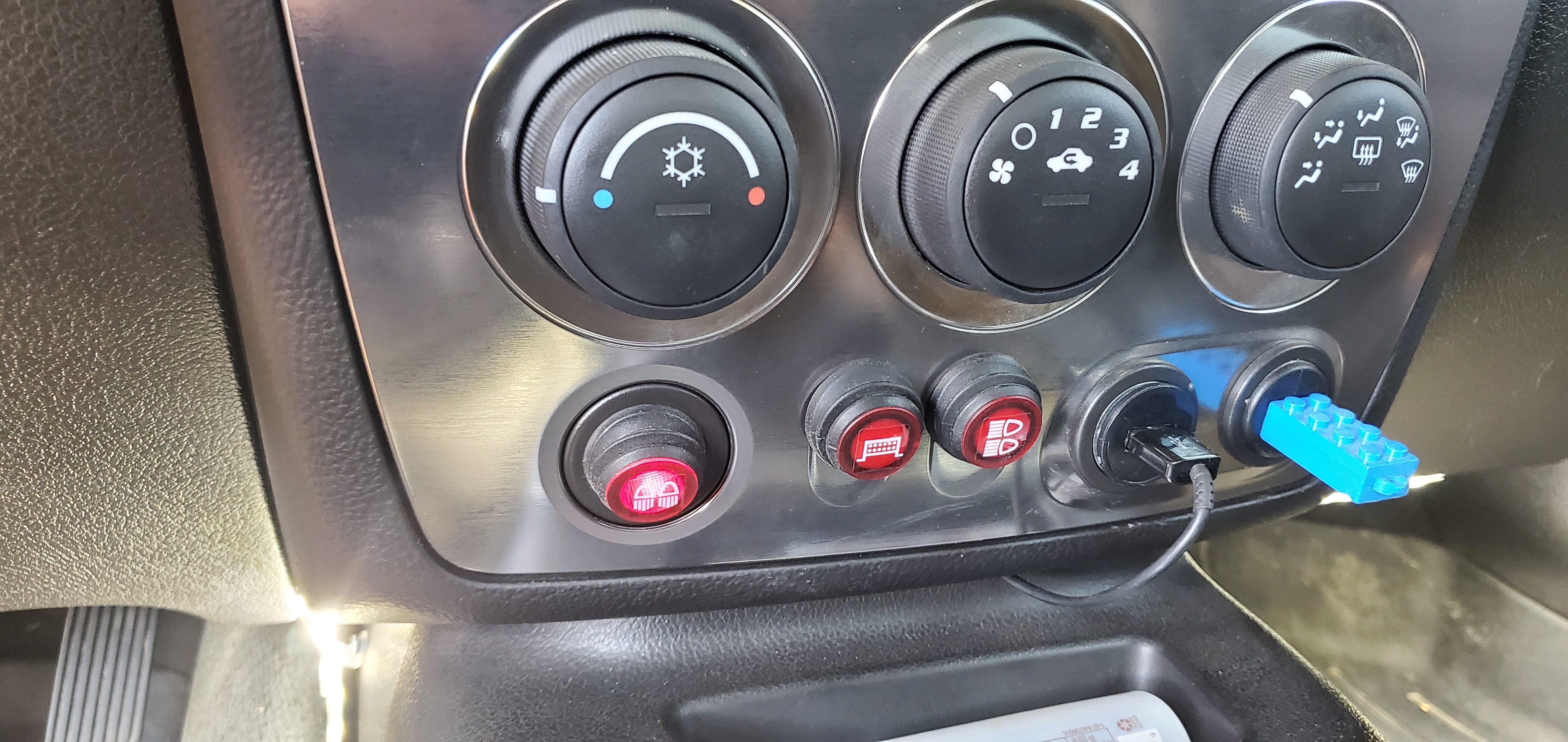

If anyone cares, here's the switches:
Left- back up, also connected to reverse signal
Middle- main light bar
Right- ambers

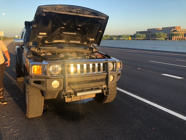

Another day with transmission fluid on the ground. Luckily it started smoking BAD, so I had an indicator to pull over. It’s not the section of line that popped off earlier in the week but closer to the transmission. :gaah:
I’m just going to have a couple beers and call it a night. I’ll see what I find in the morning.

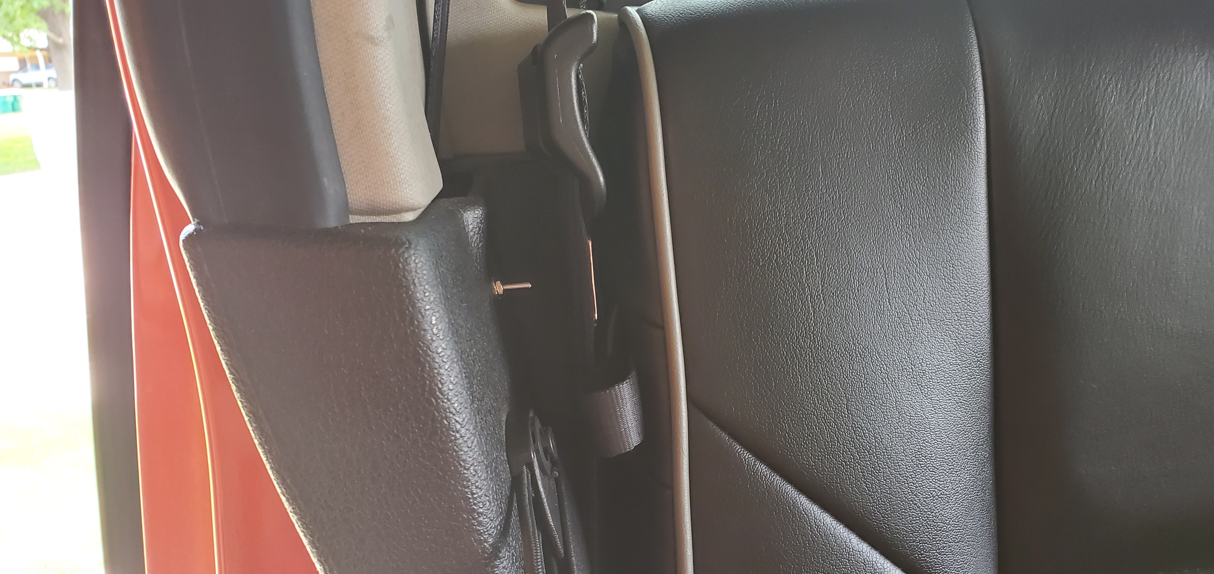

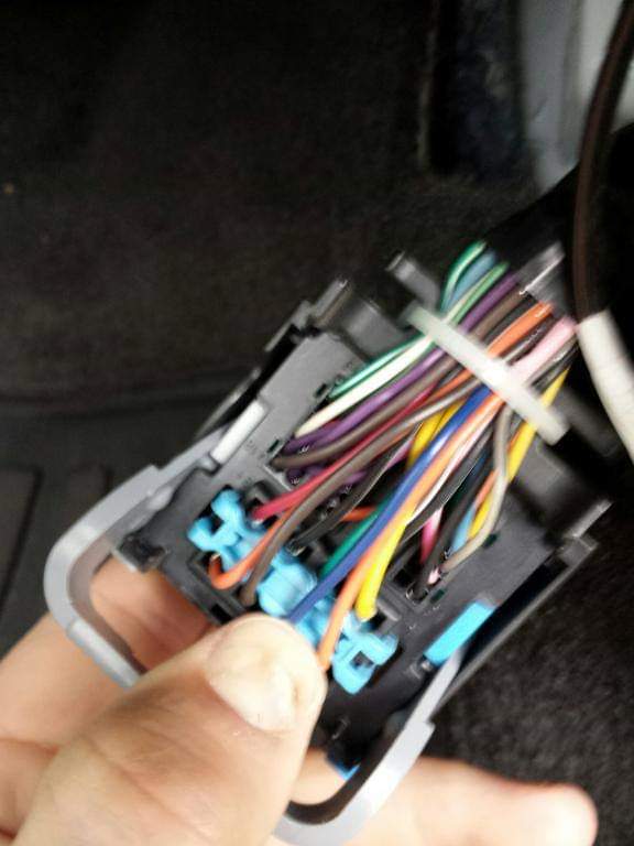

Another mod done... And I'm half dead as always lol.
What does this lil guy do?
I'll give ya a hint, the switch is in line with a very important wire going to the BCM.
Still not sure? How about this?
First one to get it, you'll have my respect on this whole mess lol.

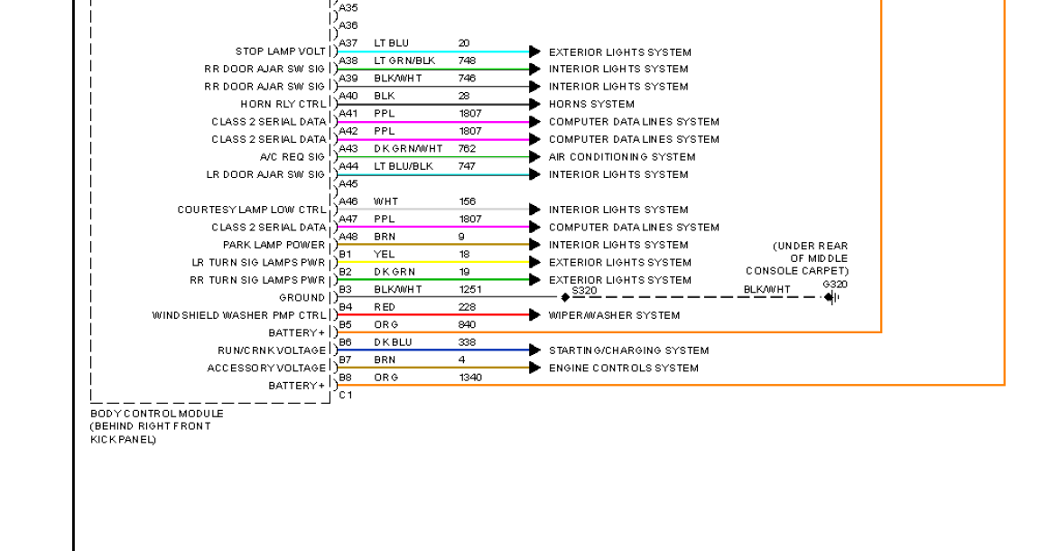

Does it go to the light blue wire for the exterior lights? Kill switch?
SolidusJ
2,028
FT. Carson, CO
Dark blue B6, this kills the truck lol. Pretty much interrupts the signal from the ignition to the BCM, the truck does nothing when you rotate the key.
I have a 3 position switch in line, thinking of using the 3rd wire and run it to a horn inside the cab. Not sure if I want to clean crap off my seat if someone does want to try and take her lol.

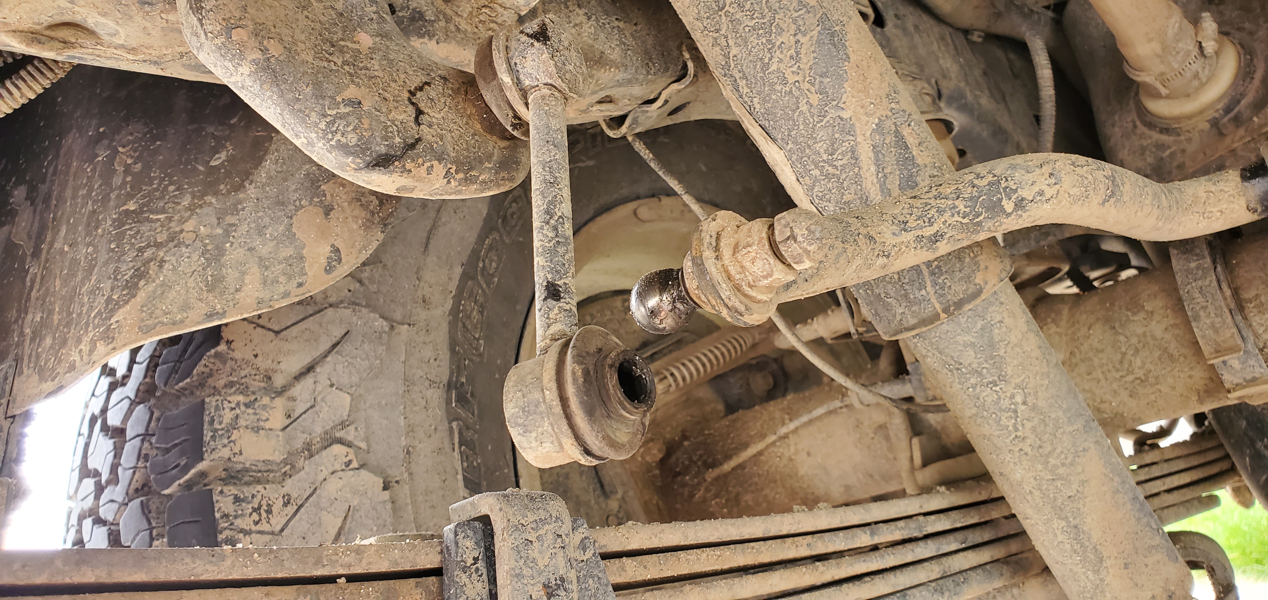

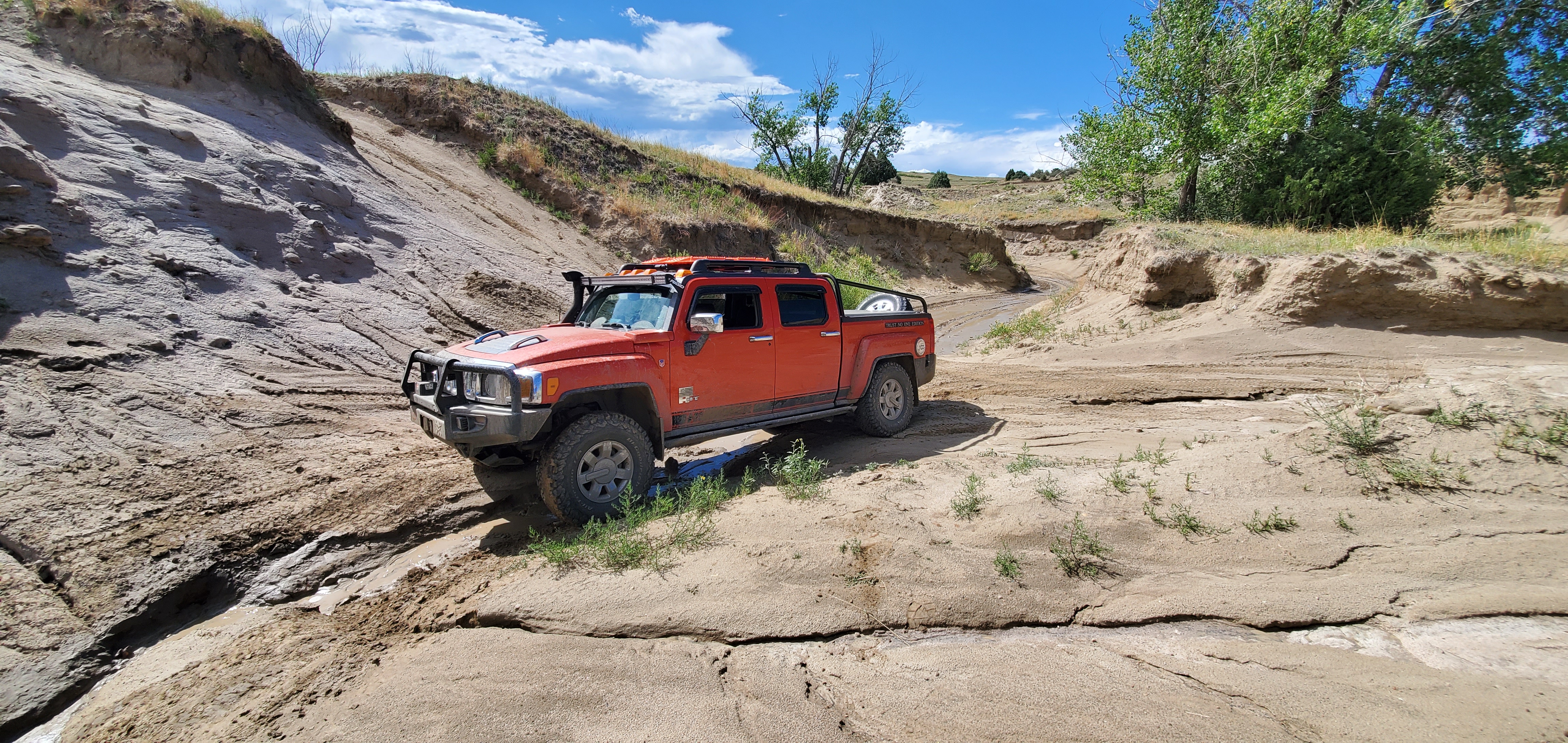

Hit up Ram offroad park here in the springs.
20200705_153619.jpg20200705_155450.jpgreceived_2714542625459101.jpeg20200705_160828.jpg
Transmission was happy the whole trip, highest temp was 172. Engine stayed at 199, but hit 212 once or twice. Only busted part was a sway bar link.

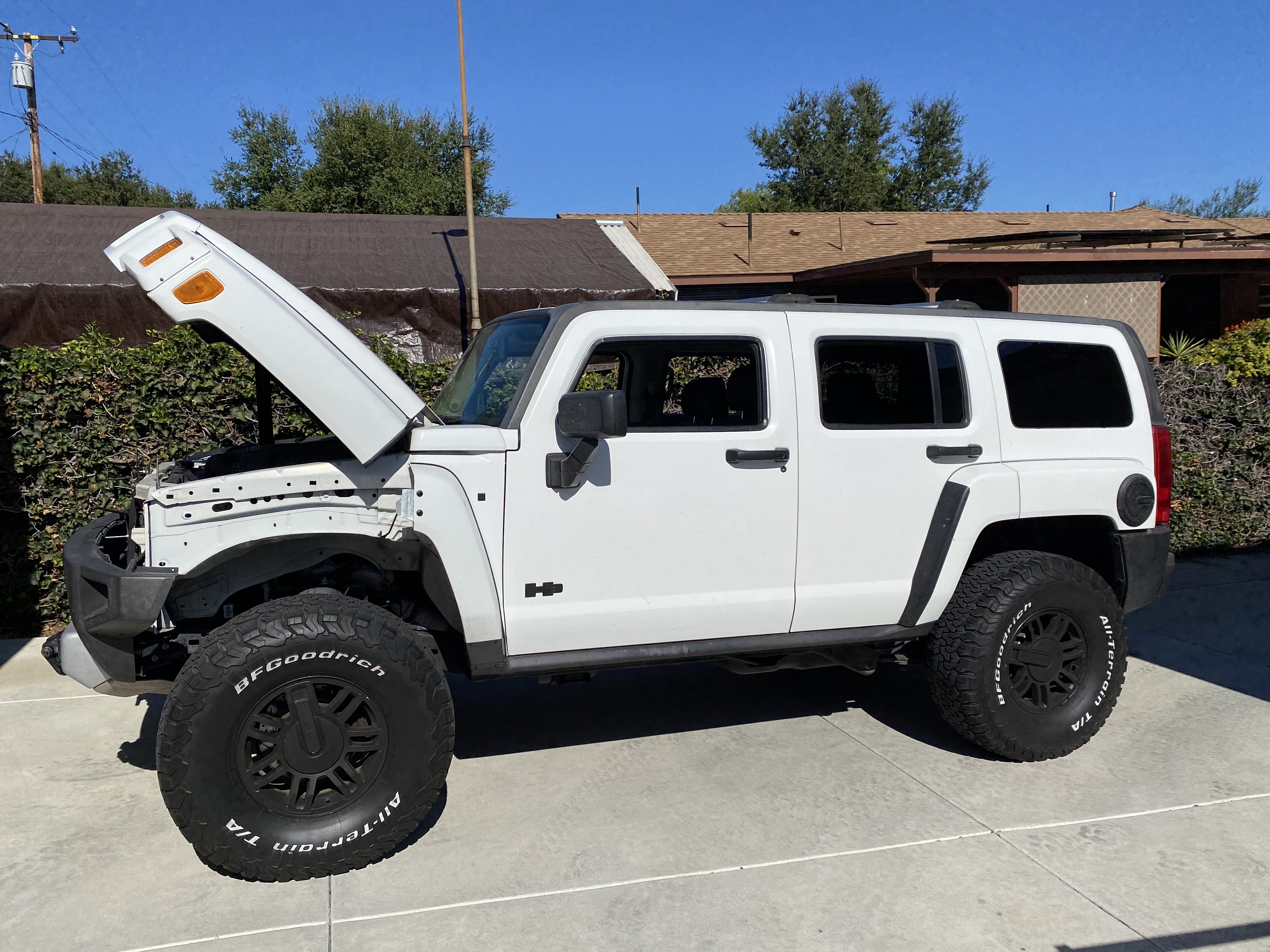

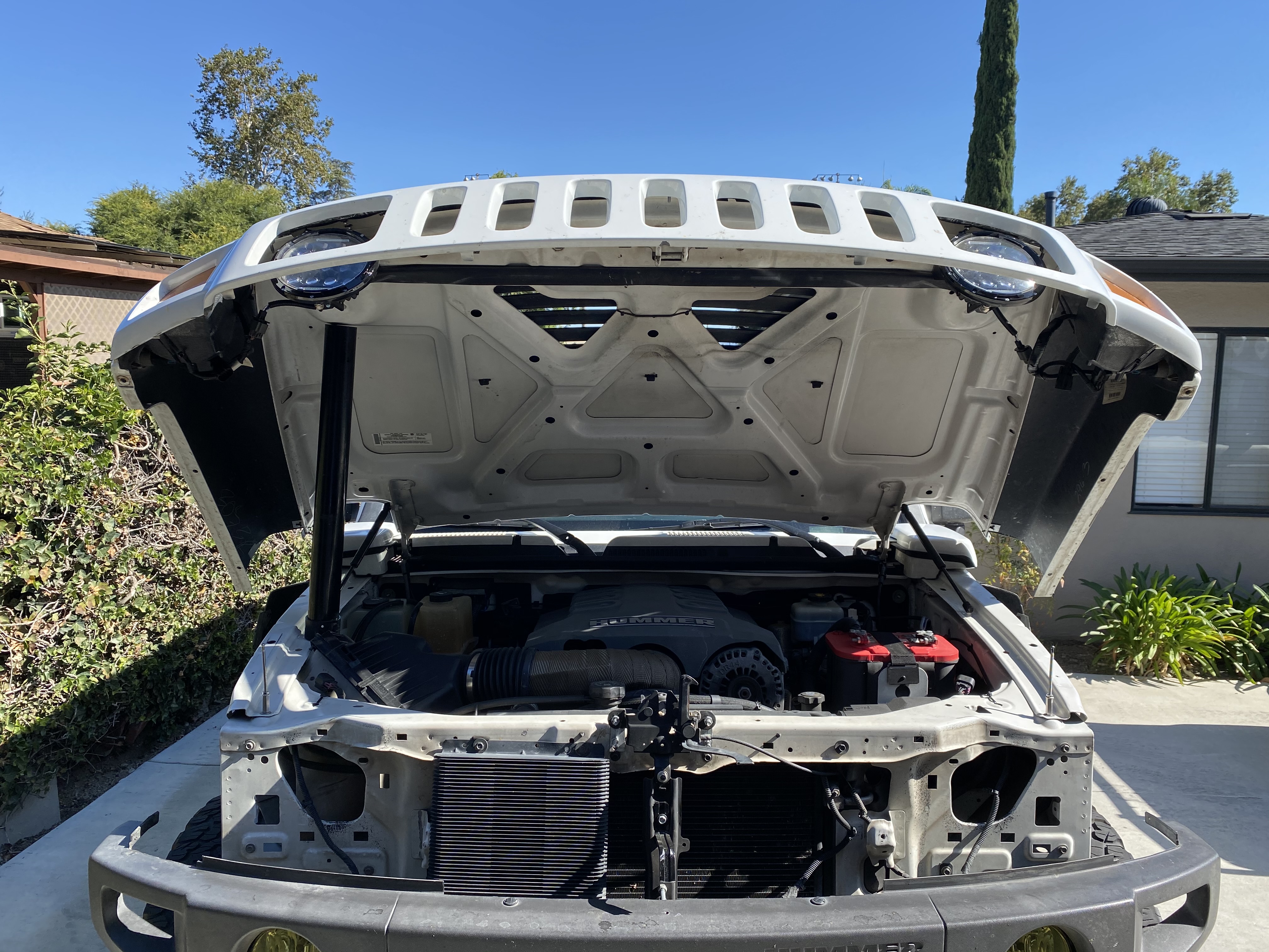

This is what happens when I have too much time on my hands.
All of the front end work is in preparation for new 37" tires while retaining stock height, eventual dual-pass radiator replacement up front, and ease of maintenance for the future:thumbs:

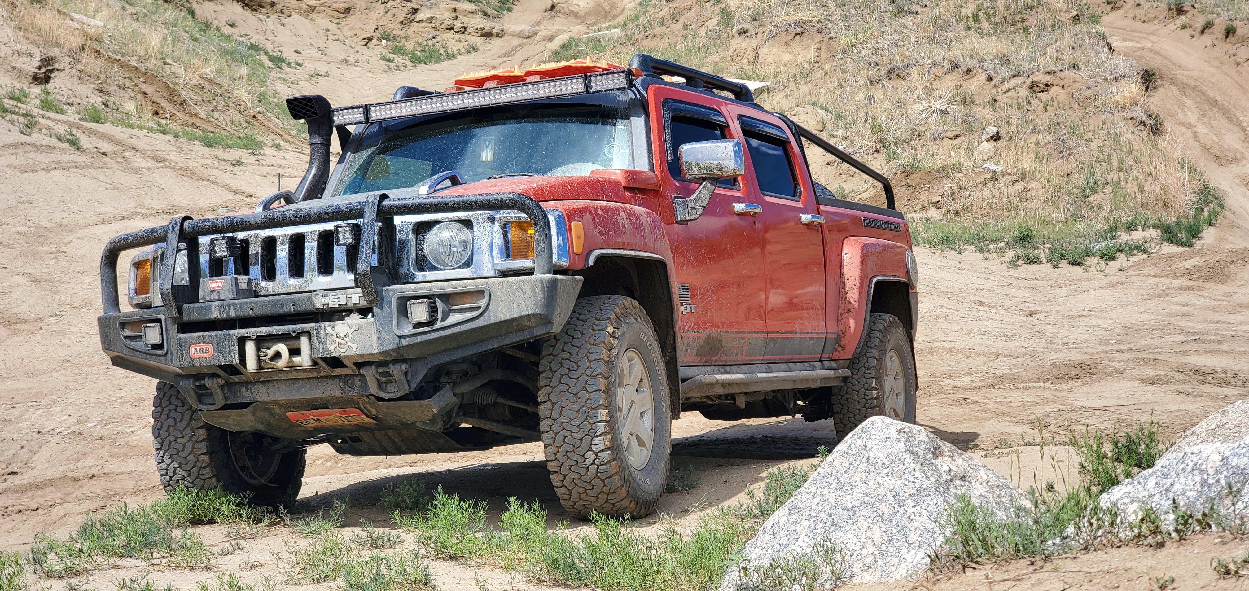

I finally made time to take it on a real trail since the SAS. Forest Lake Road.
I wasn’t disappointed (actually used my sliders for something other than a step finally). I can’t thank 4speedfunk and people like him enough. Without his detailed thread on CGAlphas, I wouldn’t have attempted the project. I’m absolute crap at taking the time to document details and sharing like so many on here do. Lots of awesome people on an awesome forum.

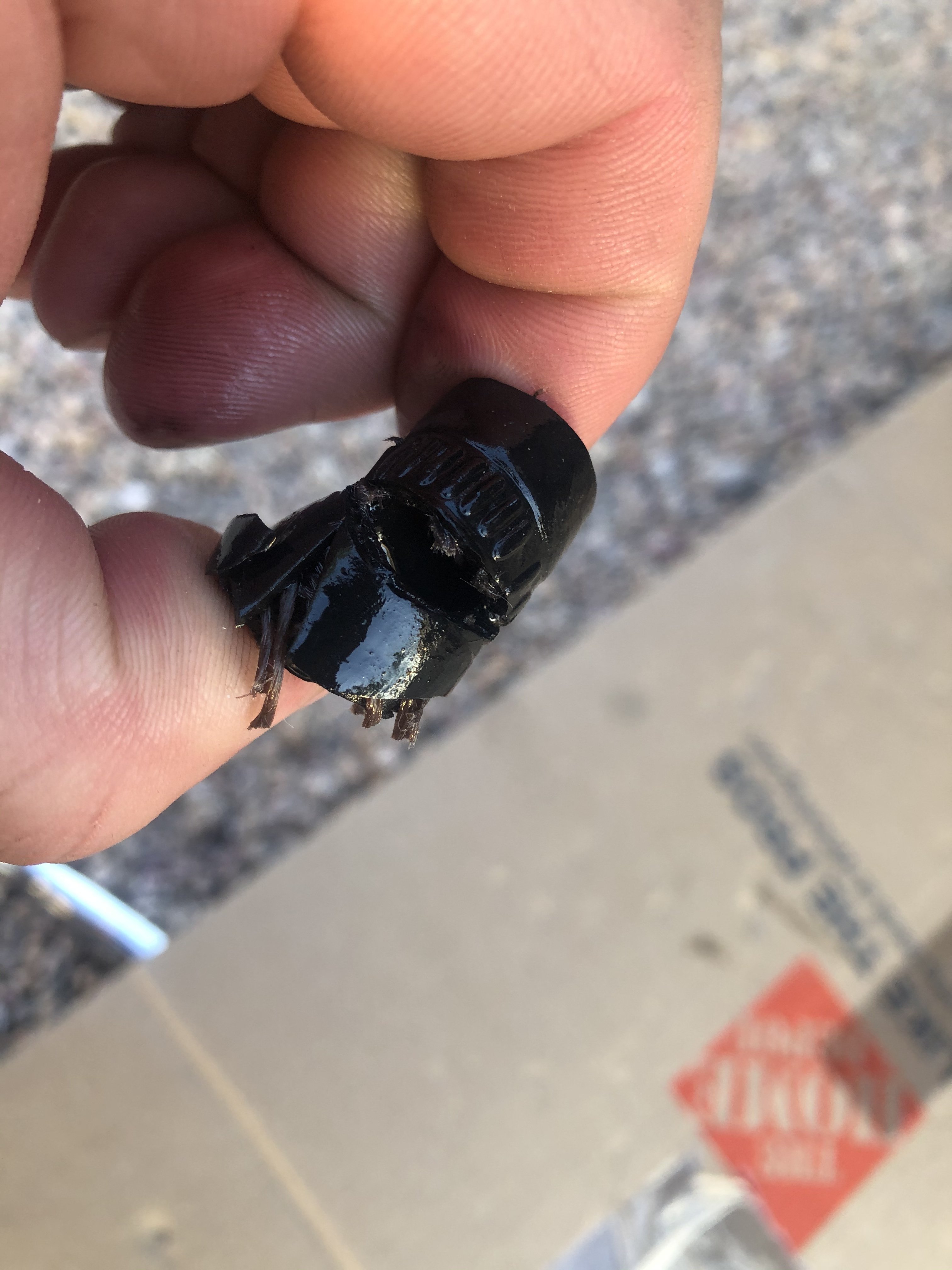

Wow, it’s already been a couple weeks? This move is taking up too much time :giggle:. I got under it and it seems like I either tightened the hose clamp right on the flare, causing it to crack and open up. Hose seemed it was dry rotted but was just made in March? I’m going AN fittings to the factory hardline, I can’t have this happening when work starts up next month.

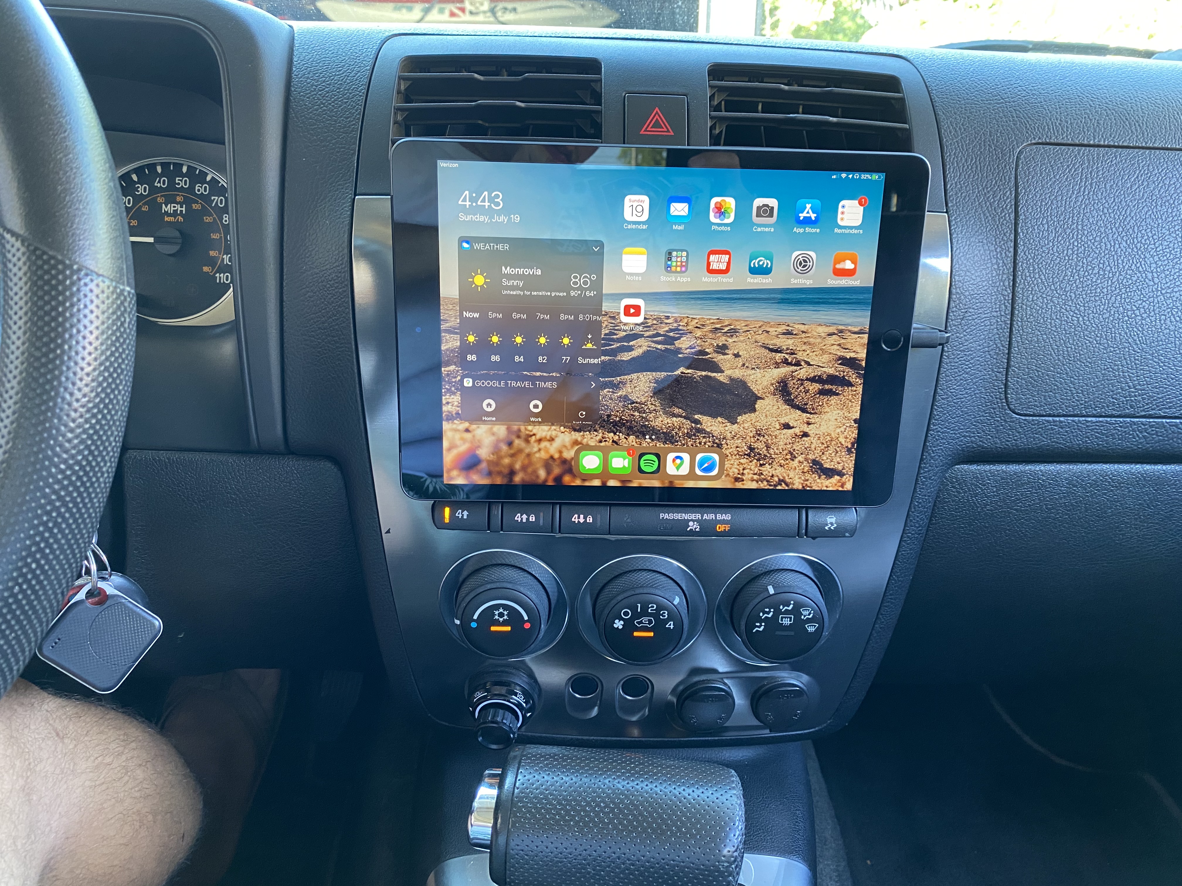

Did you still retain your original radio unit? Is the tablet tied into your stereo?
Chris Laun
78
Los Angeles, CA
I have been utilizing tablets and a small SXS bluetooth head unit for the past 2 years or so, and just recently installed the iPad for the larger screen and ease of use with my iPhone. If you take a close look at where my rear wiper switch would be, you'll see the tiny SXS head unit

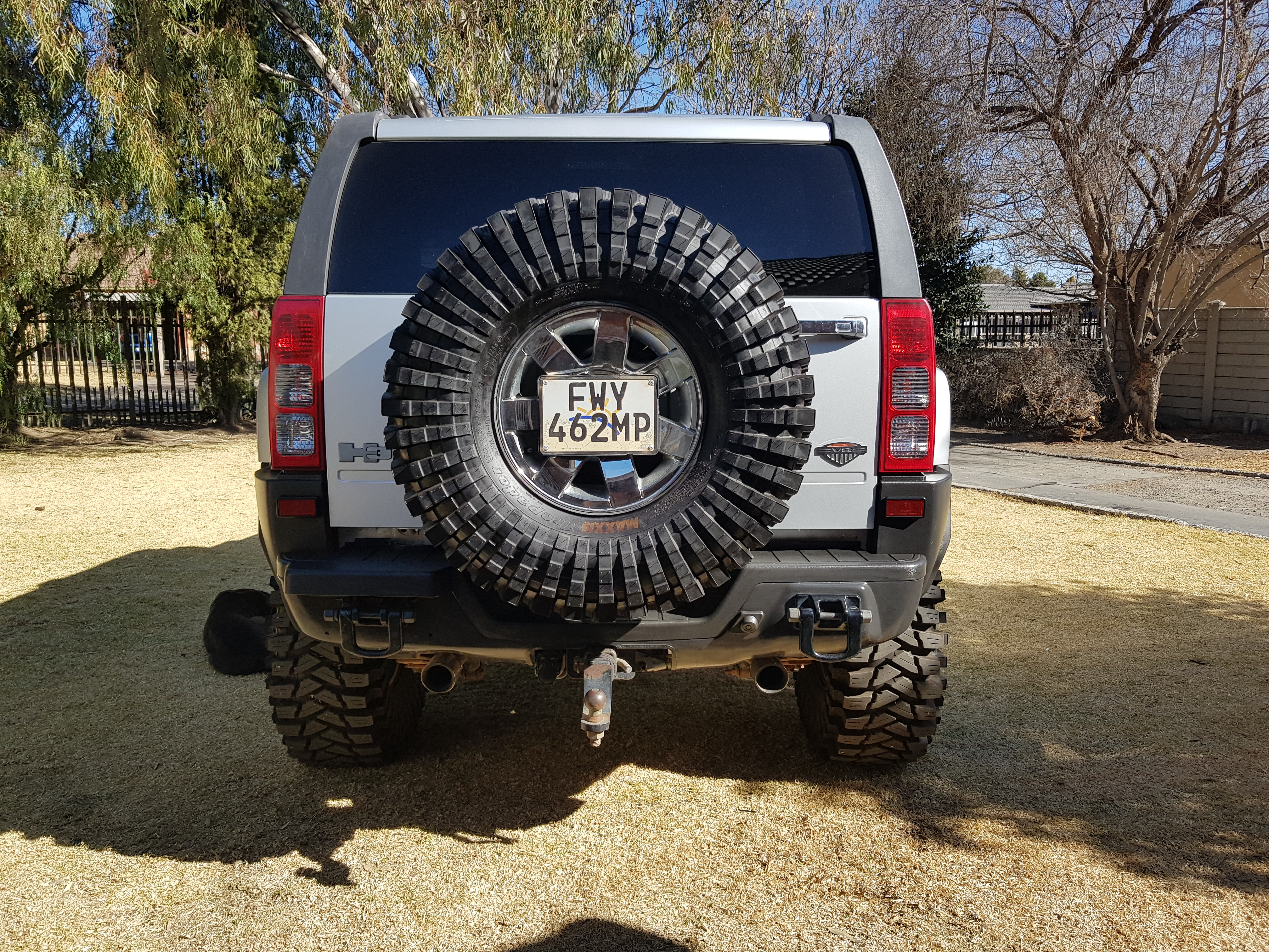

Any photos of what you did under the bumper to mount the second D ring?
Unfortunately not, but I went the chain route, so I just drilled holes in the bumper, spray painted them to prevent rust, then bolted the D-shackle onto the bumper. the Bolts are long, so I then took a piece of chain and put it over the one bolt, then took it underneath the frame and over the bottom lobe of the T (you will see the frame makes a T there) and onto the other D-shackle bolt from there i took it across the top of the frame over the Top Piece of the T to the first bolt. Then you just tighten the nuts until the chain is taught(and install lock tight or lock nuts if you want), thus having no rattles from the chain.
it should work fine as a recovery point, but i will still primarily use the hitch receiver D shackle
