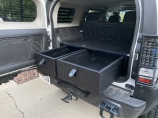

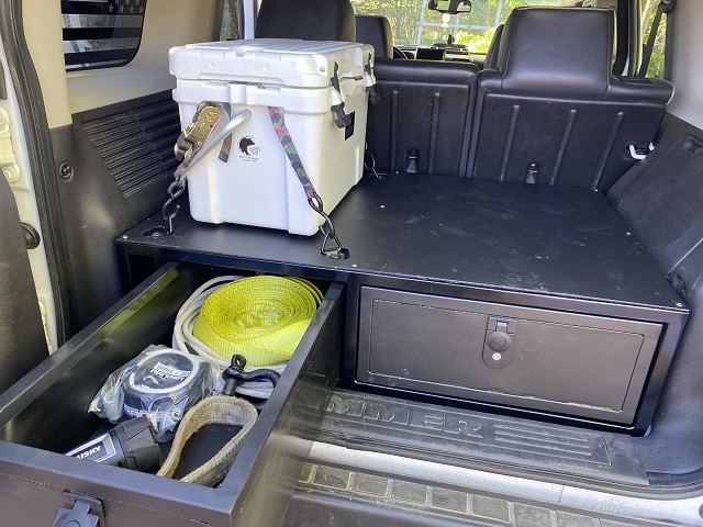

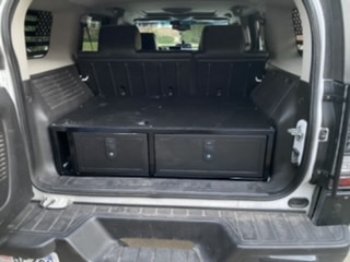

I made the frame and drawer frame out of 1" square tubing. Drawers are 1/16" steel sheet and top is 1/8" aluminum. I used to have 2 tool bags and a cooler strapped down for trail rides and id have to unstrap everything to get in the cooler or to get to tools. Everything is much more accessible. I'm excited to put it to good use. Here's a link to the build album for more pictures.
https://www.hummer4x4offroad.com/forum/album.php?albumid=469

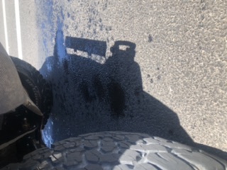

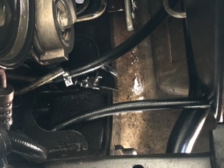

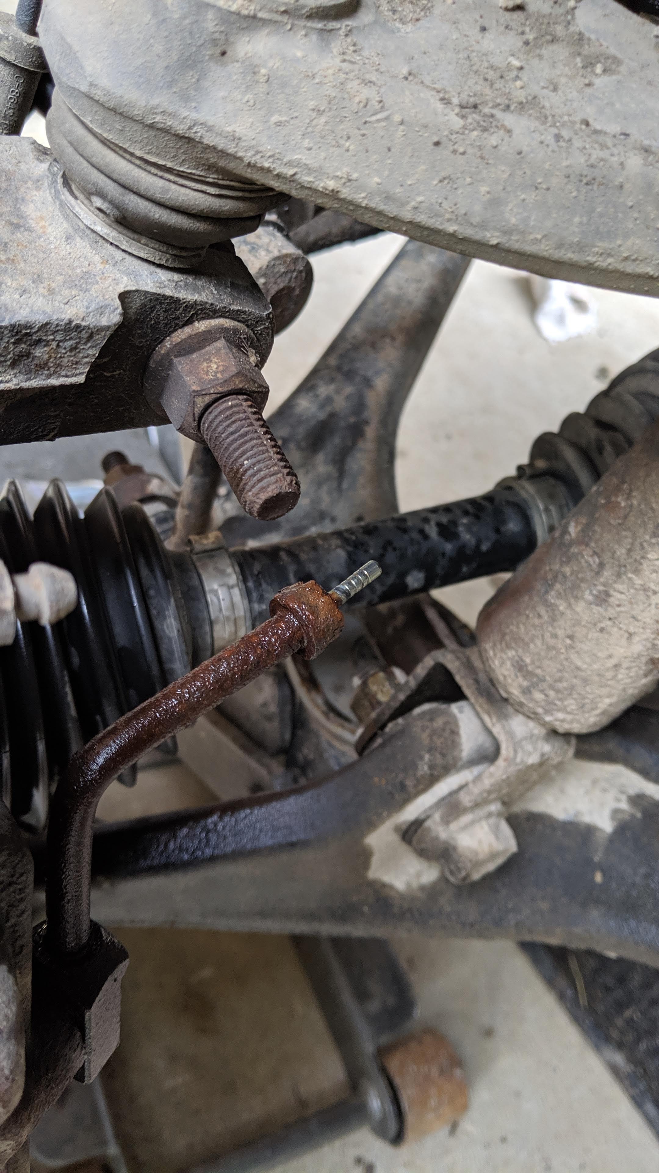

Gotta love the rubber trans hose popping off the hardline, all I wanted was a damn McDonald’s Mcgrittle. Hopefully no damage was done, as soon as I felt it slip I shut it off and rolled it back to the side of the road. There is fluid EVERYWHERE under the truck.

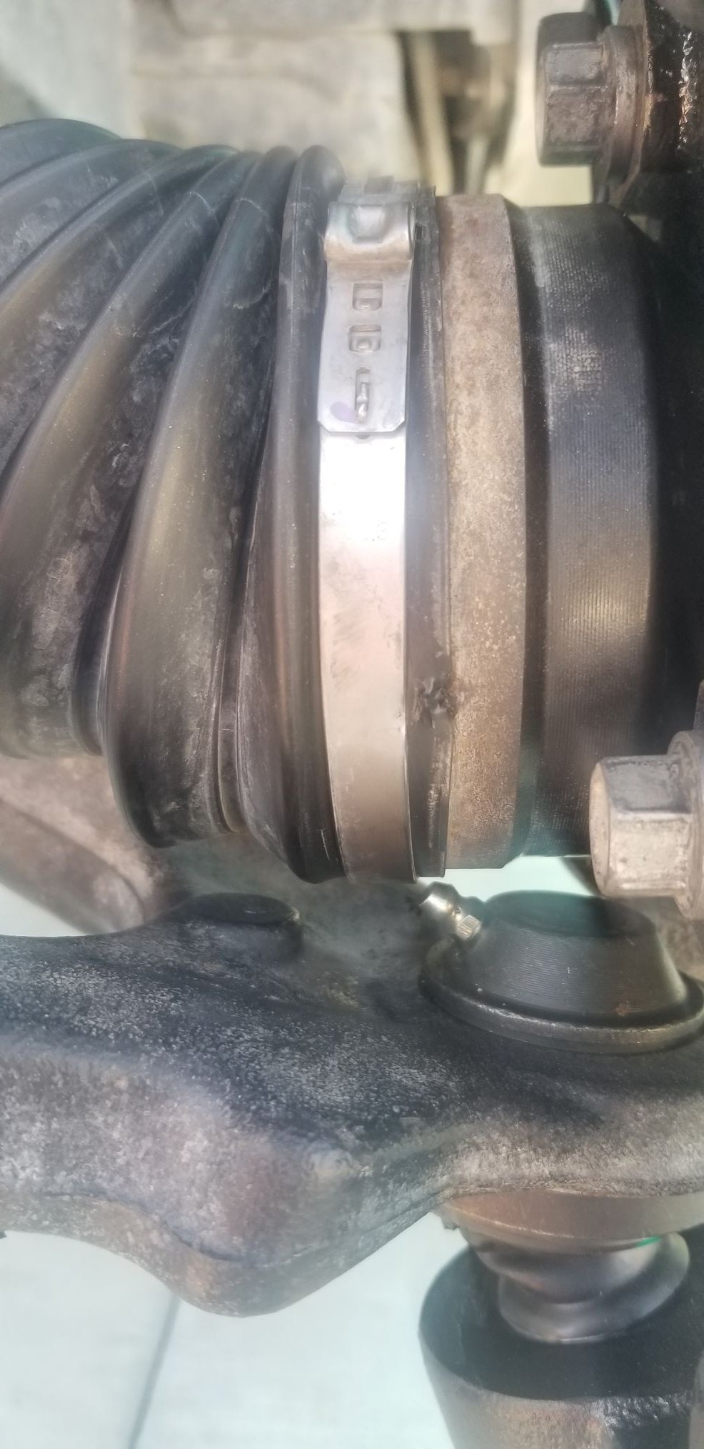

After nearly completing my summer repairs and upgrades I ran into an issue the necessitated a few days away from the H3. I installed new Moog ball joints on the lower control arms and faced the grease zerk fitting towards the inside to facilitate easier access to grease them. WRONG, after everything was reassembled and I was installing the tires I noticed the tire was turning really hard. To my suprise the outer CV was hitting the zerk. I changed from AC Delco because they hit the zerk too. So I was in a really bad mood for a few days ready to get a new ZR2 but cooler heads prevailed, disassembled the front end again, took the arms to the shop and he had a good laugh at my expense and he installed them facing the front for the cost of a case of Corona. You can see where the CV hit the zerk in the pic.
