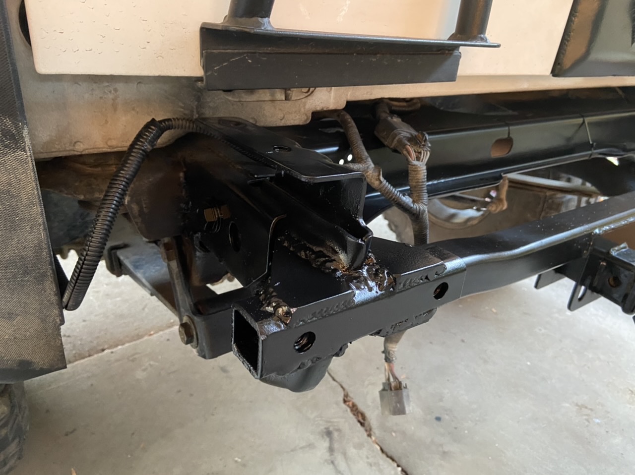

Bracket is 1/4” wall 2” square tubing bolted to the bumper before installing the bumper and then tacked in place with 1/4” gussets, unbolted and removed bumper for full weld. Should be stronger than the passenger side.
I love how cleanly Thorparts stuff installs. So well engineered.
Thank you so much! You definitely saved me a lot of time trying to figure this out myself. My original idea was try to see if I could find the passenger side of the bracket with the d ring mount (15794061) and cut it up to fit it on the driver side, but this should be far easier! Thanks! I'm glad you did well in Cardano. I am invested in it as well!

I might mention something for DIY welders: ALWAYS disconnect the battery cables before welding on your rig. It is possible to backfeed your vehicle’s electrical system with your welder. On occasion I have forgotten to do this, and I’ve had doors lock, dome lights come on, and horns honk. Can’t be good for your puters.

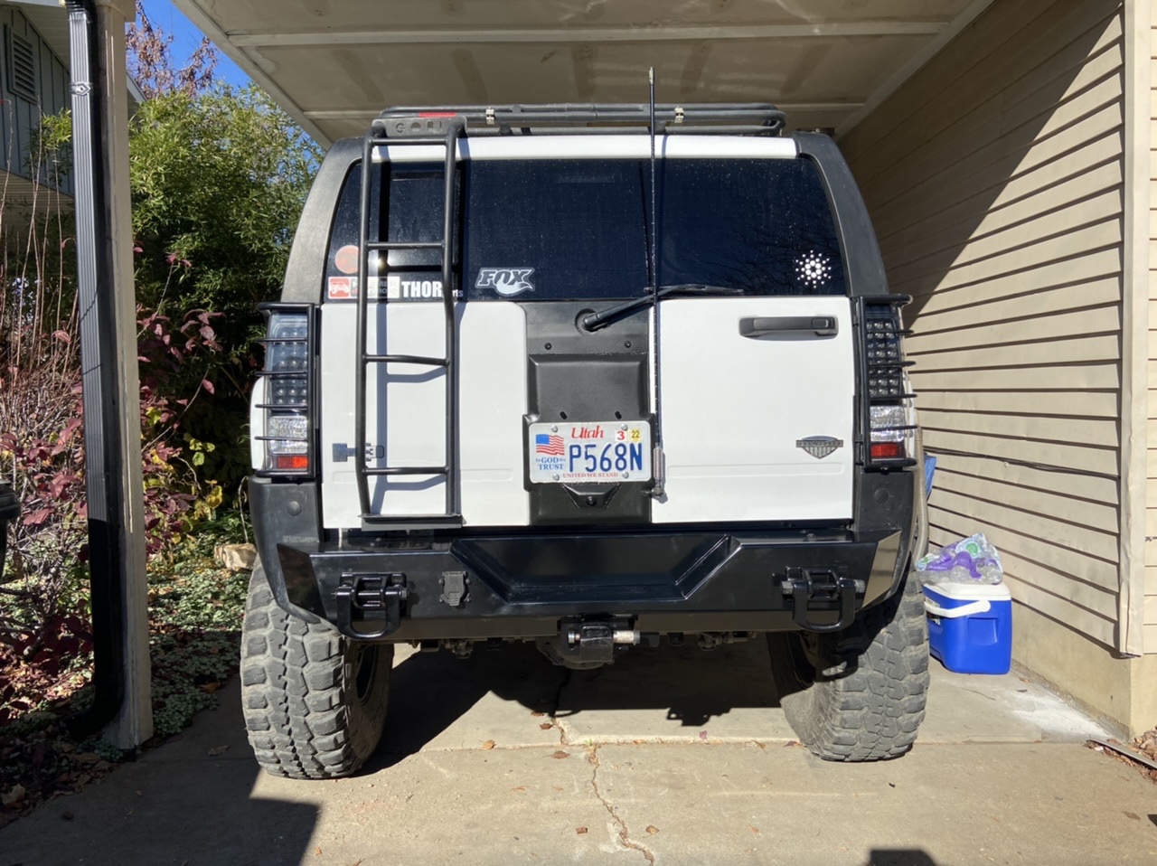

Another Thorparts rear bumper post with a before and after. Was definitely a struggle to get it on with the frame being slightly off, but well worth it! Used an 18 inch chain for the other rear D ring as seen on some other rigs here. Now to find some time to get the front bumper on... :)
:thumbs:
looks damn good

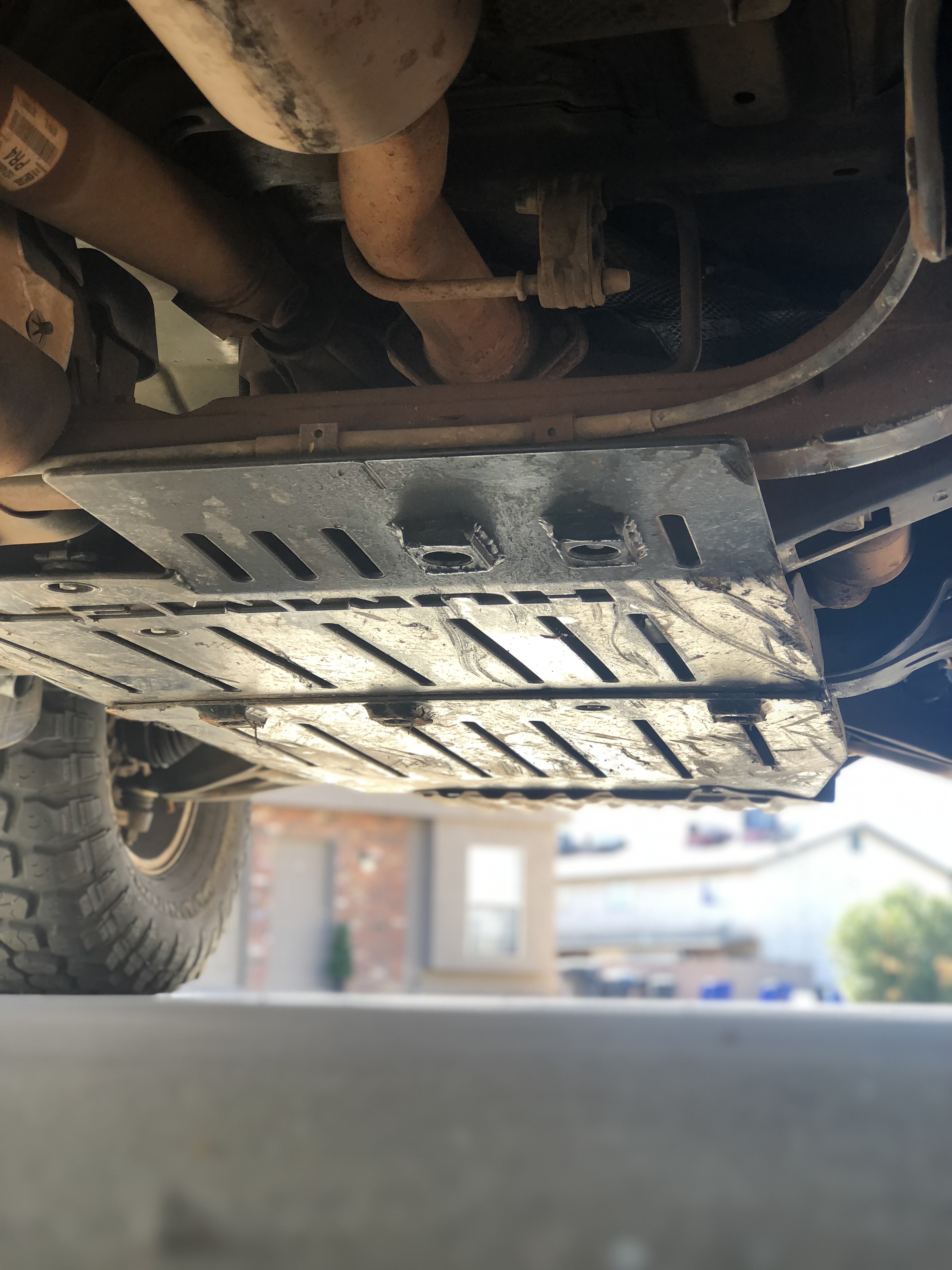

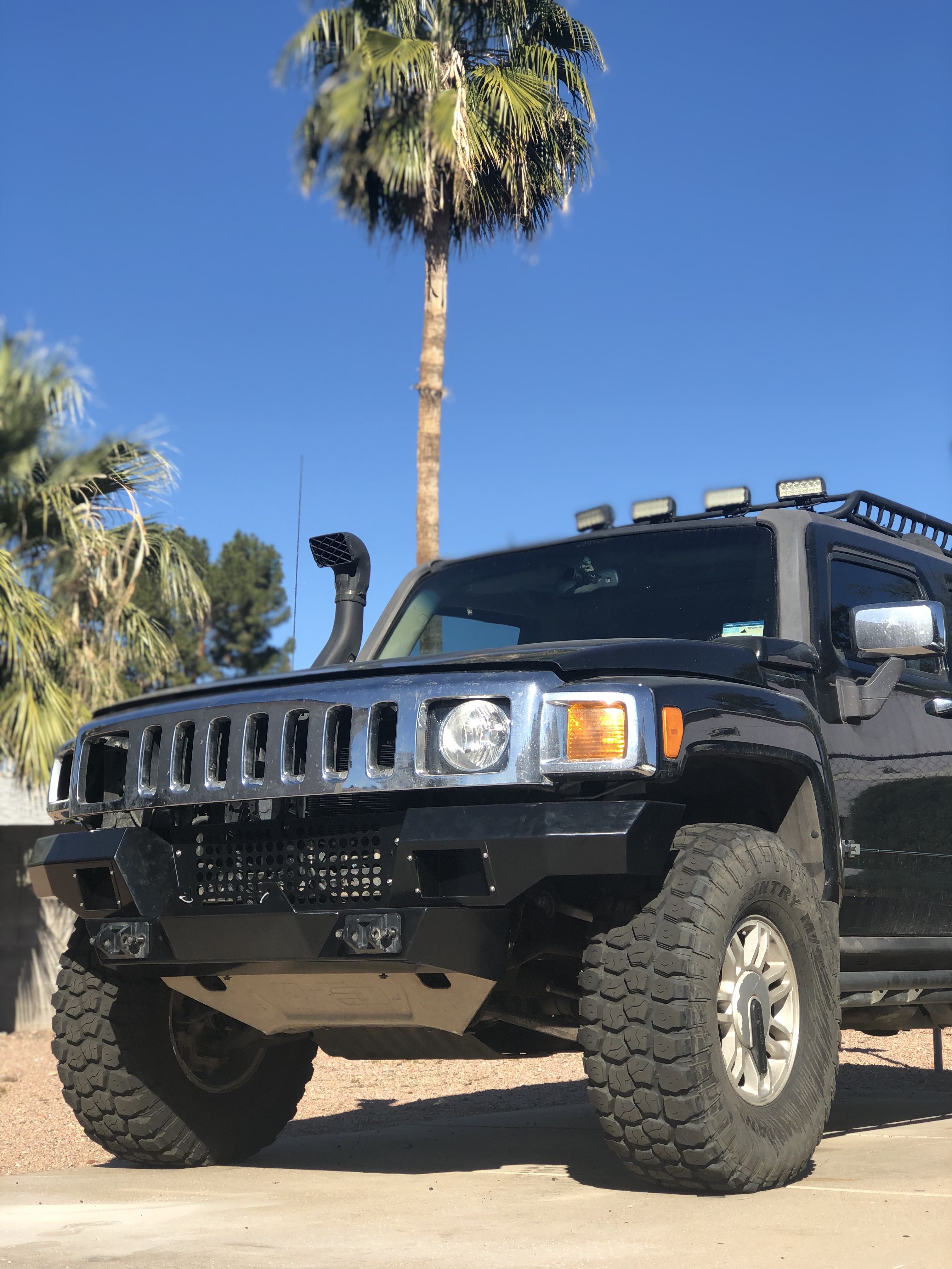

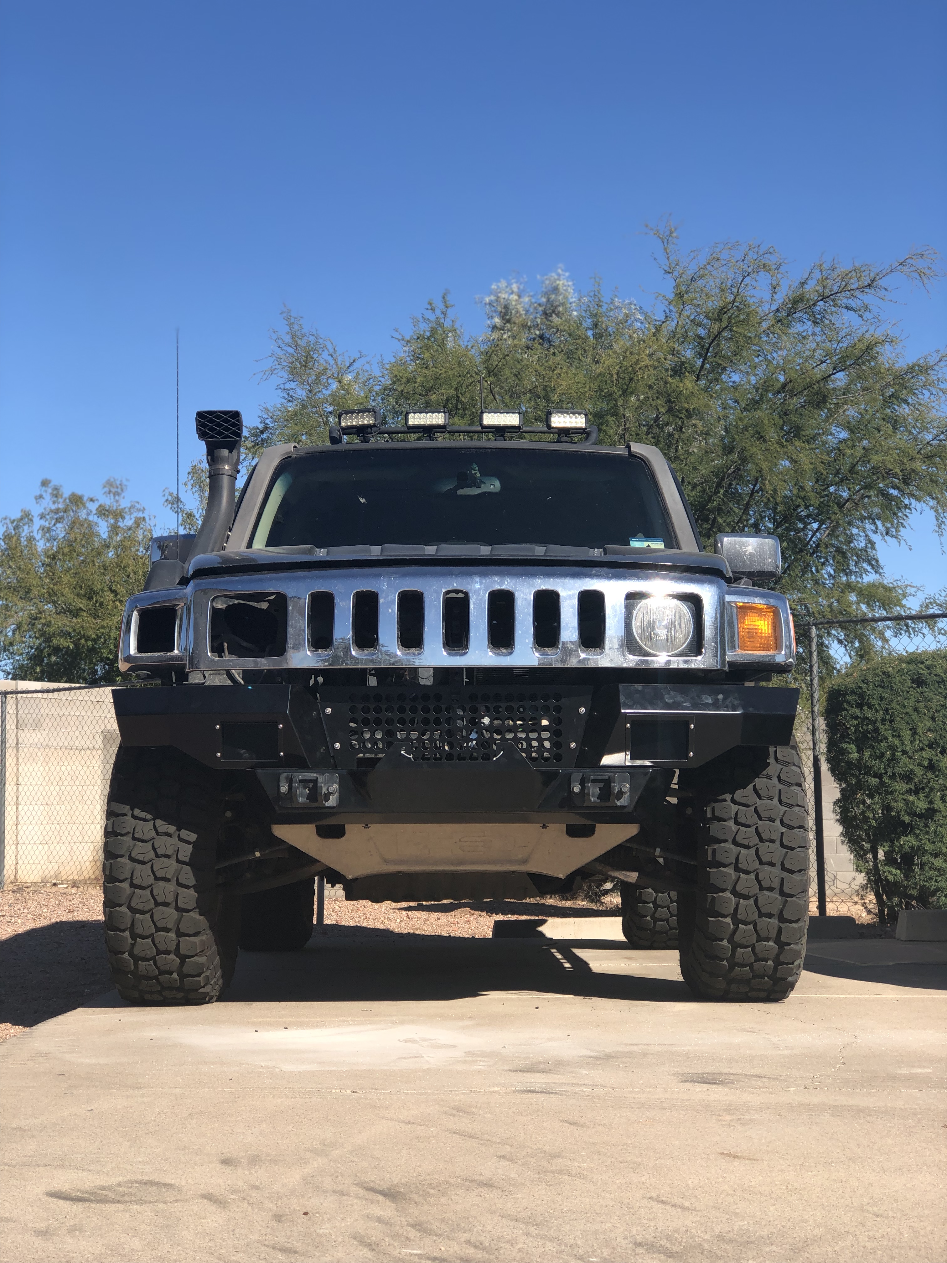

Last bit of protection added to the truck. In total: Thor front and rear bumpers, factory RPP, KMW skids, and Tomp low profile spring hanger mounts.

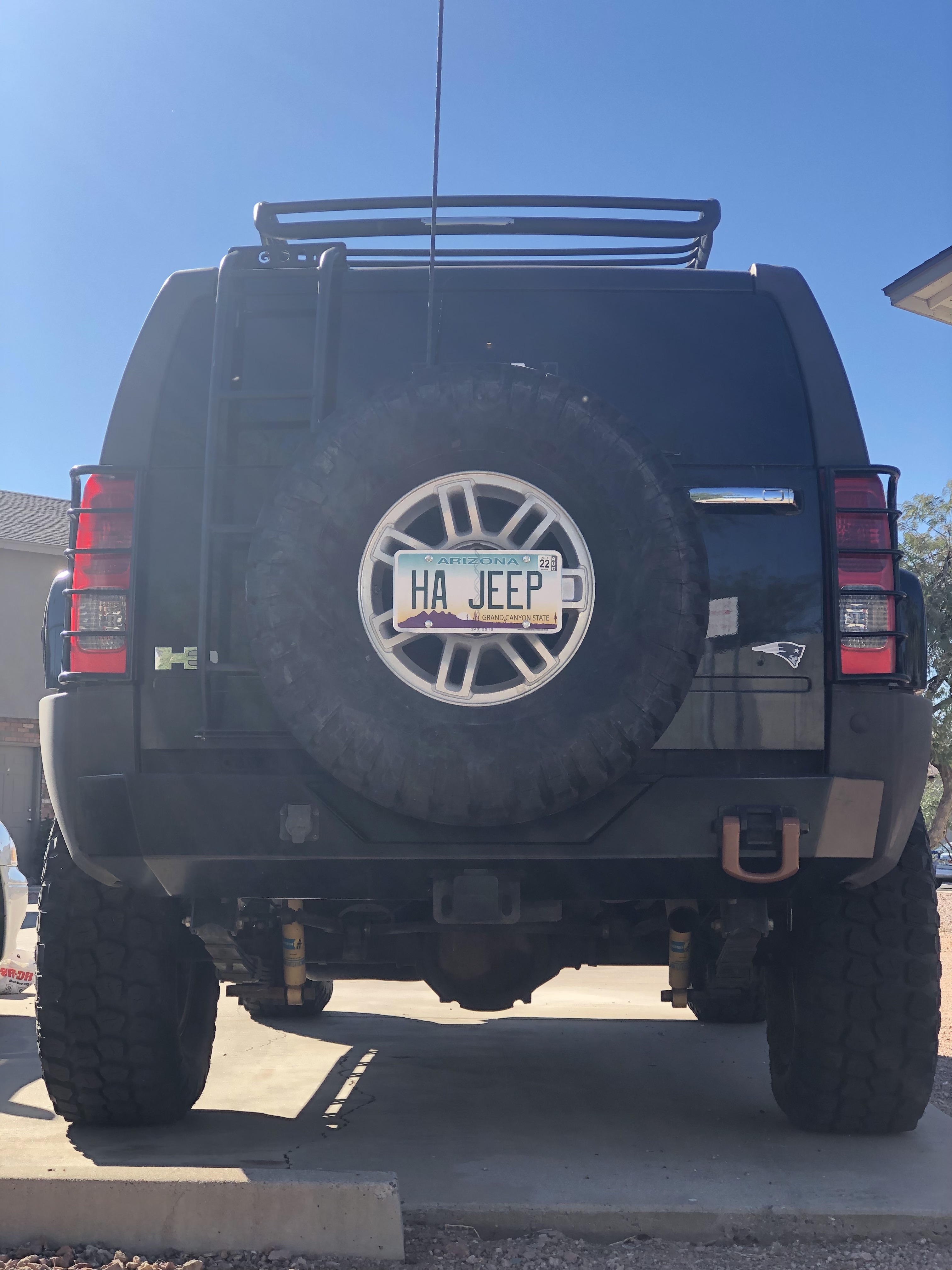

Haha thanks. I agree. It came with them, 5 new wheels and 5 new tires. All more pricey than I’d pay haha and they aren’t too ghetto/flashy

Standard ones you find when you search on eBay. I need to adjust or bend the driver side though. It rests on the rear hatch and I have to push it out when opening the gate so I don’t chip paint. Pisses me off haha
