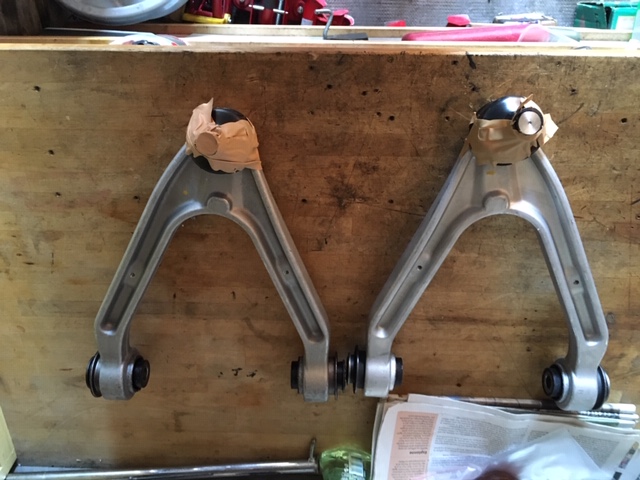

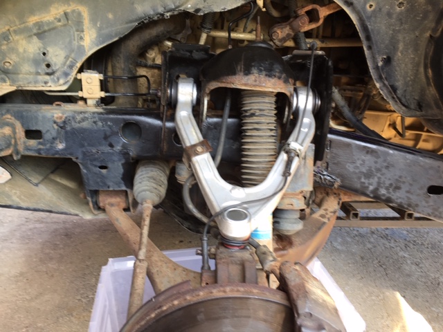

Go for the Delphi's, have them on mine when i change them. Found them on the Rockauto web site
08H3
1,370
Just stay away from Dorman. I made that mistake once. I would probably go with the Delphi as well. They were recently acquired by Borg Warner, and I think they are probably one of the best aftermarket parts manufacturers.
Do NOT go with the Moog. As nice as Moog can be, the upper arms have a problem from them. Instead of a cast inner bushing flange like OEM, they use a mild/mid hardness sheet steel (more or less). The problem with that is if you look at the OEM flange it has a number of dimples that serve the purpose of helping make sure that once you set the alignment and tighten down the bolts, it will not move from that position. Since the Moog flange isn't thick cast steel but instead much thinner sheet steel, as well as having fewer and less pronounced dimples, it cannot properly handle the clamping forces and will deform to the point that the dimples do pretty much nothing. Eventually you'll get out of alignment and start damaging the upper arm mounting bracket on the frame.
For the longest time I was hearing a knocking sound from my front end while on the trails or when I would back up from a parking spot and start moving forward. Finally, after wearing my front tires horribly enough due to misalignment to get me to really start looking at everything going on with my front end (and thinking it was because of dropping my nose on very large shelves, twice, once on each frame horn) that I finally discovered my upper control arm as shifting in the frame bracket. It didn't matter how much I tightened the bolts, I could still get it to move. That's when I realized the Moog control arms I installed were the source of the problem due to their cheap design.
I ended up replacing them with Mevotech from Rockauto, which have the correct OEM design. So whichever ones you go with, make sure the inner bushing flange is made from cast steel and not stamped steel.
