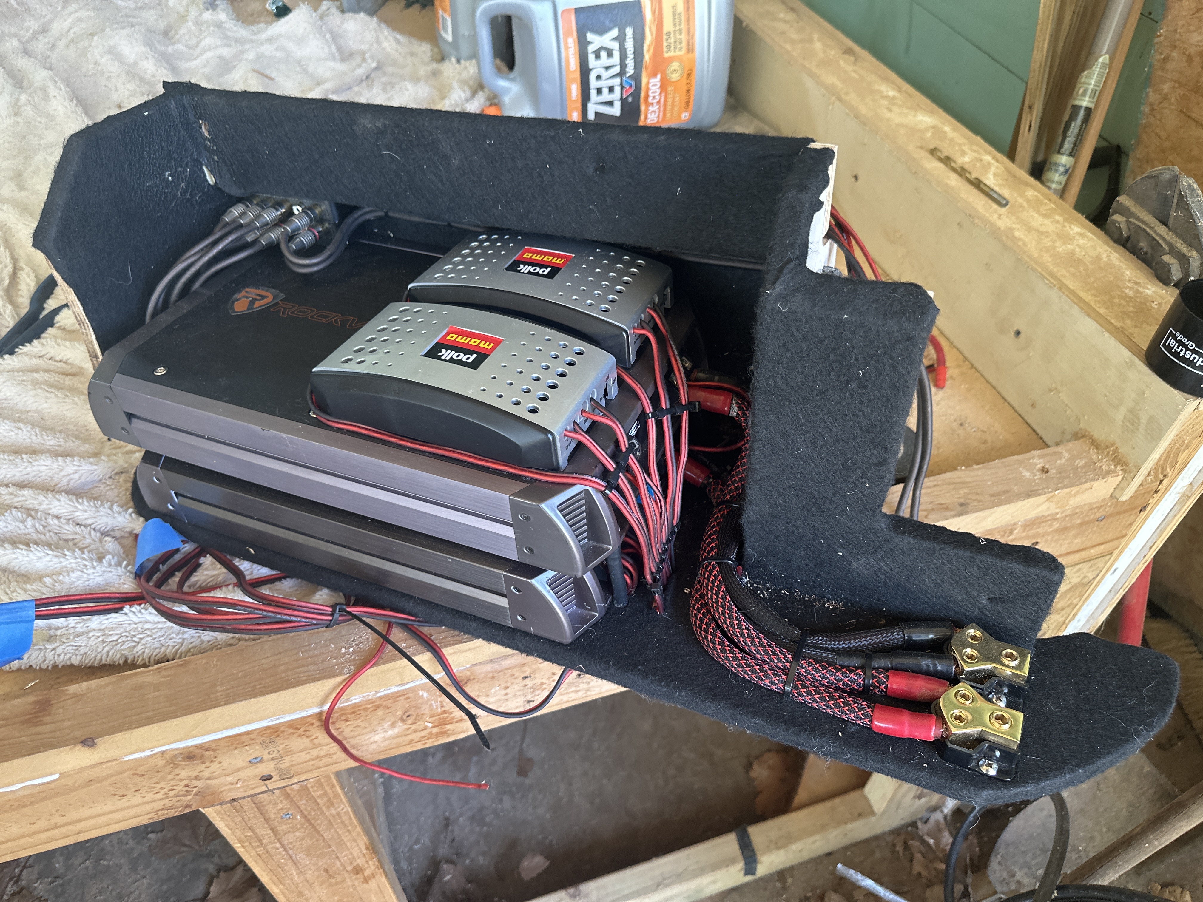

Stereo is still in process currently, box and amp rack are finished up and ready for carpeting & trim, door speakers are installed on driver side with sound deadening to match.

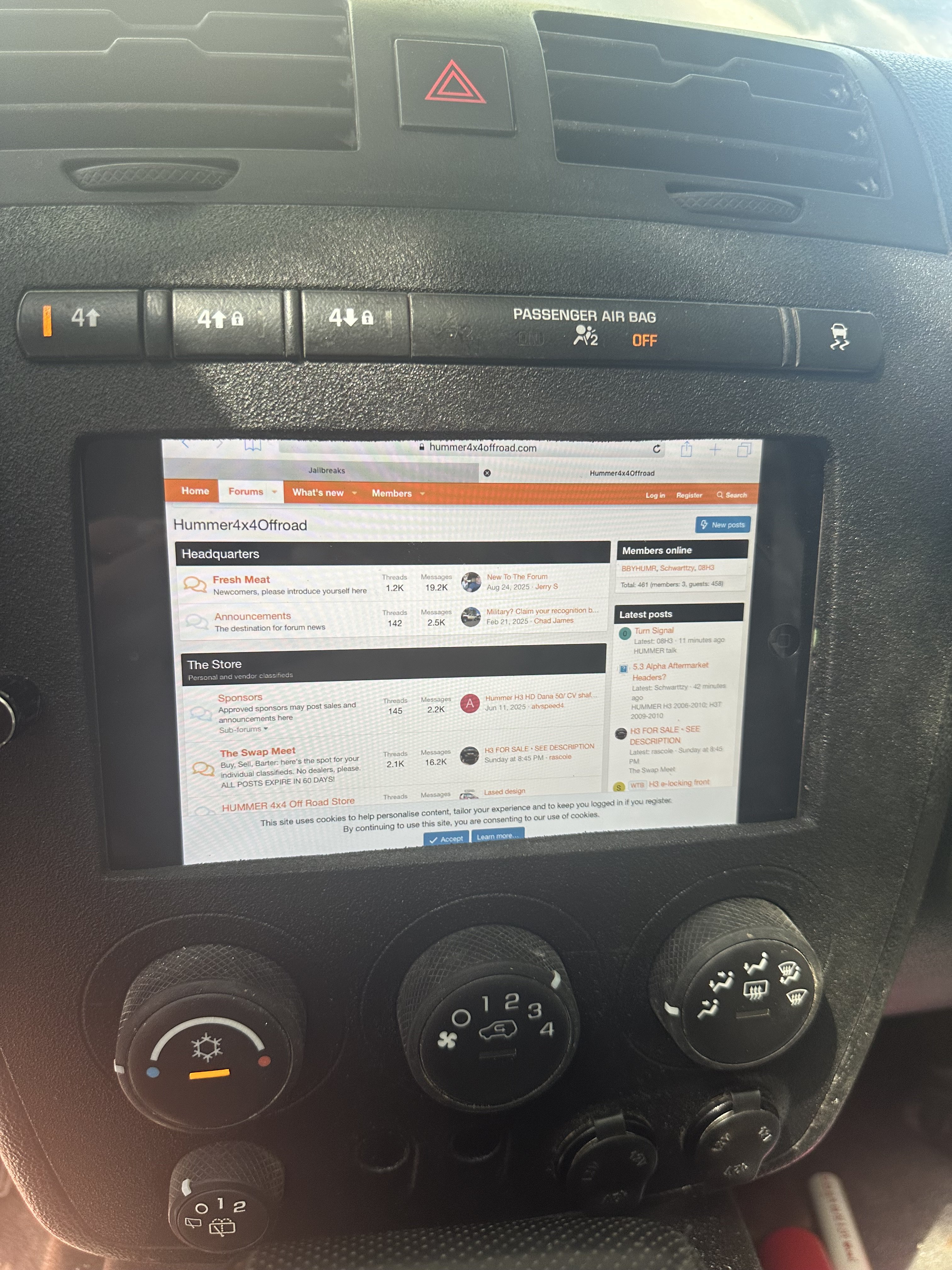

Small update. Tinkered with the radio bezel a bit today. Not extremely happy with how it came out so likely will be revising the bracket into something my ocd can tolerate but it’s in and powers up with a quick test.
iPad is jailbroken so when it sees voltage it wakes up & unlocks, when it sees no voltage it goes into sleep mode
Still need to run some 0 gauge wiring to the amp location and finish up the wiring adapter from the factory amplifier (on order). Carpet and padding should arrive tomorrow and Wednesday so hopefully can get the box and amp rack carpeted later this week.

Still need to run wiring for the rear amps but those are assembled and ready for power, ground, and signal on the amp rack.
Stiiiiiiiiil waiting (nearly a month now) on the connector to arrive to allow direct plug & play into the Monsoon wiring harness to prevent cutting wires.
Also got the subwoofer enclosure carpeted & padded but ran out of spray adhesive to finish off the edges. The two ports still need finishing trim installed as well but like I said, ran out of spray adhesive soooo….

Stereo is in and making some good noise. Components speakers installed in all doors and a-pillars. Still need to finish up the port beauty panel but otherwise everything is installed and tuned. All doors and the rear floor have been sound deadened, I will likely pull the seats and carpet out eventually and do the floor and possibly the ceiling.

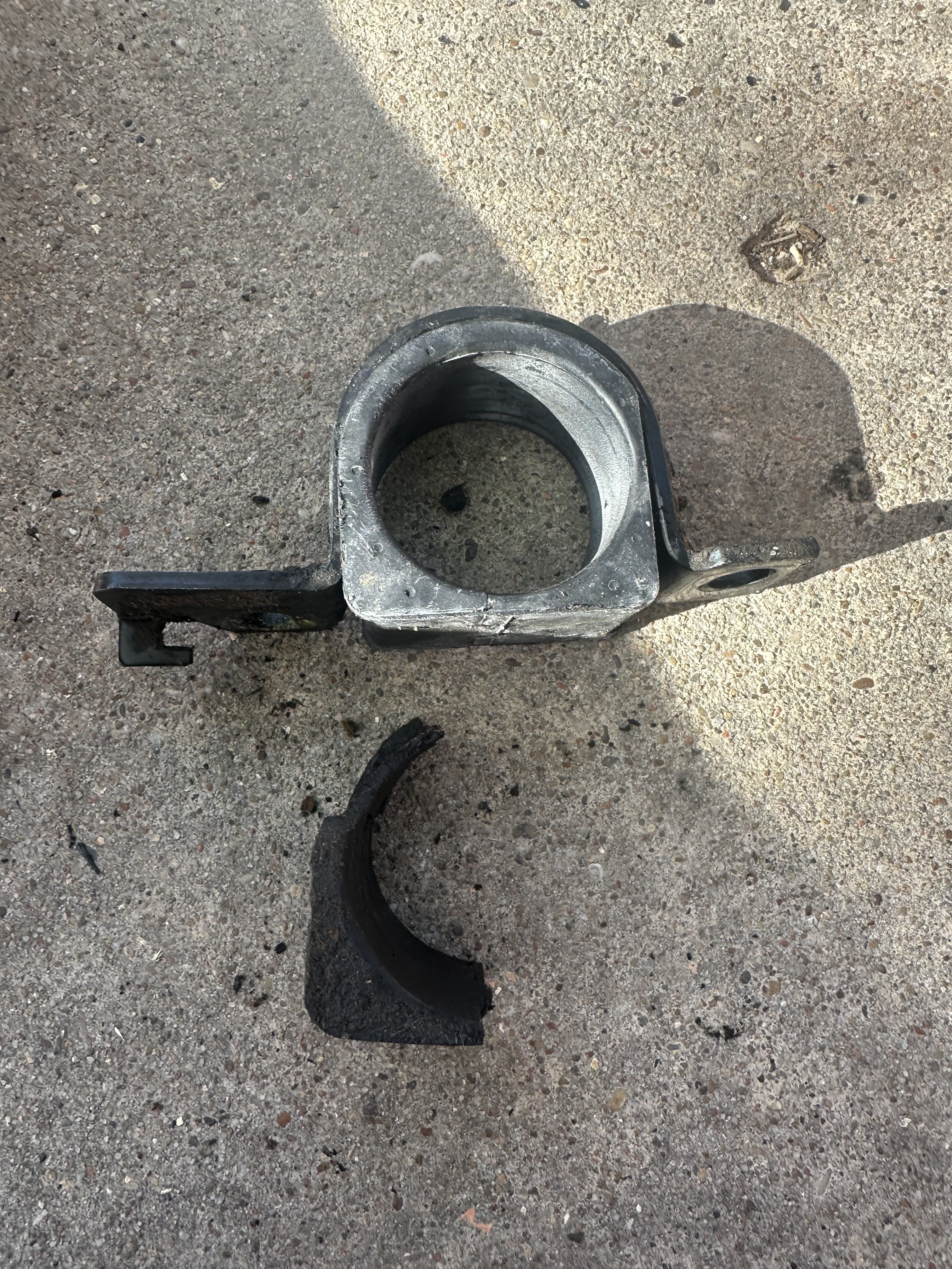

I had ordered a steering rack clamp bushing a while back and had just never gotten around to doing it. While “listening” to training modules I decided I would throw it in and what a huge difference it made. The alignment is still off but at least now the Hummer doesn’t wander while driving straight.
Clamp bushing was certainly needed. I know I should probably replace the other steering rack bushings and I will, however I also found a torn inner tie rod boot while doing the clamp so I will likely do everything at once.

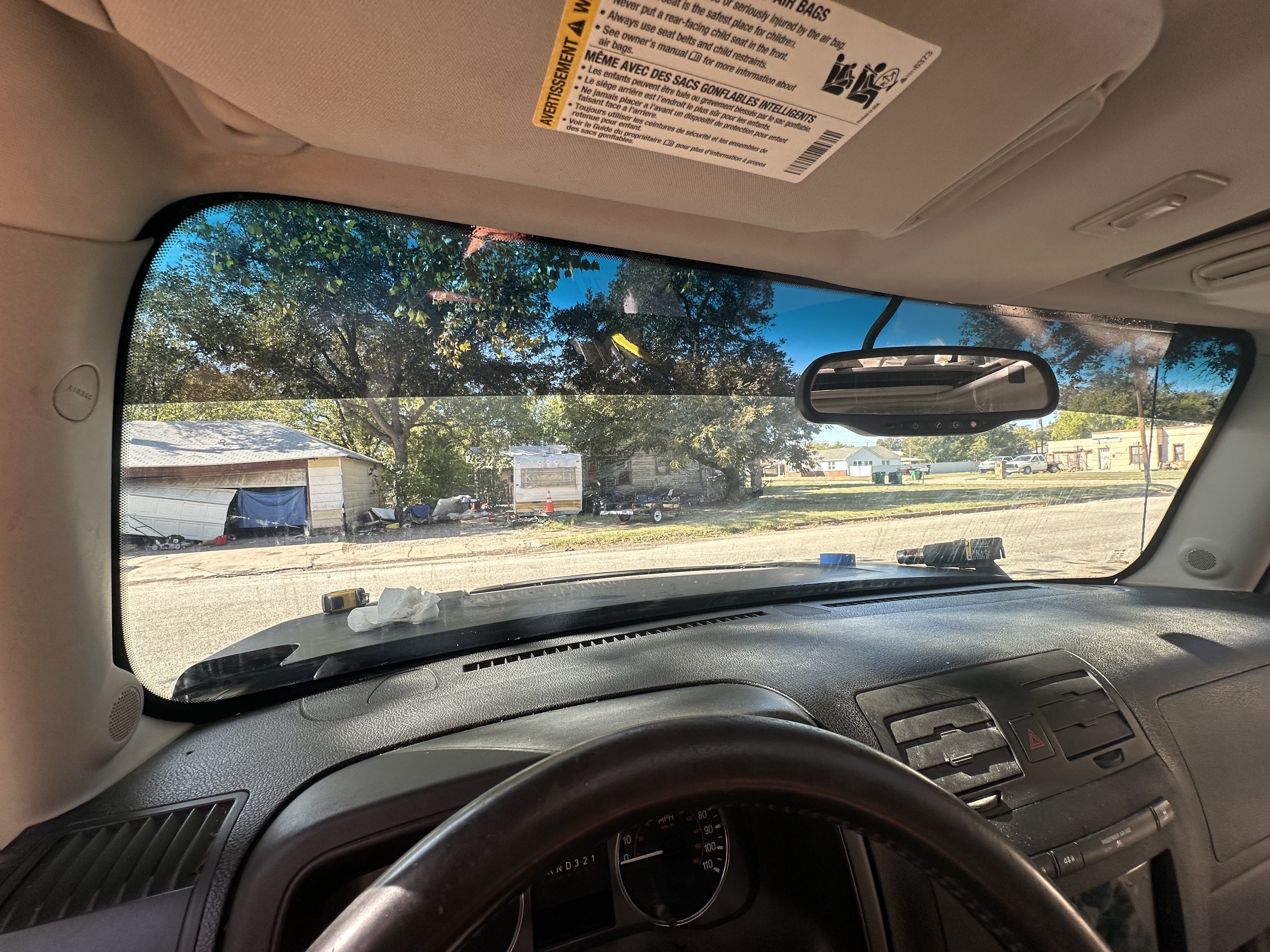

Had safelite come out to replace the windshield which was very needed but since the truck wasn’t registered it was kind of on the back burner as far as priorities go. Amazing how one little thing like that made such a huge difference.
Unfortunately in the process the technician broke the re-glued tabs on both windshield moldings so now I am looking for either a replacement set or I may just finagle some in a 3d print. He also had to take off the wiper cowl to do the windshield which was broken in a previous hail storm so also looking for a new cowl panel as well.
After the windshield replacement I threw some 50% over the entire windshield and some 20% as a visor strip
Chose to do 50% since technically windshield tint is frowned upon by the law enforcement, but 50% is difficult to tell it’s even there from the outside but it makes a huge difference on the inside.

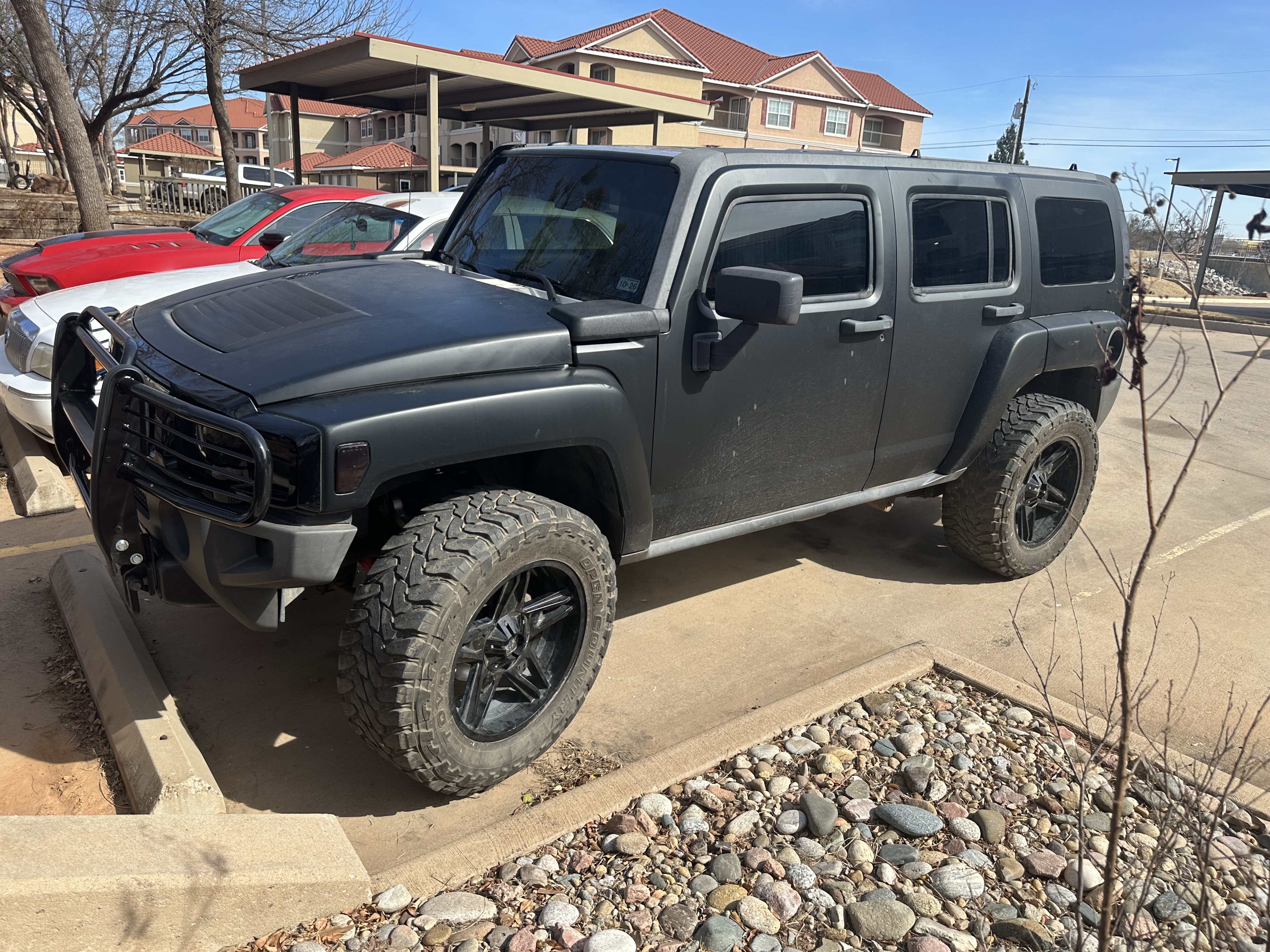

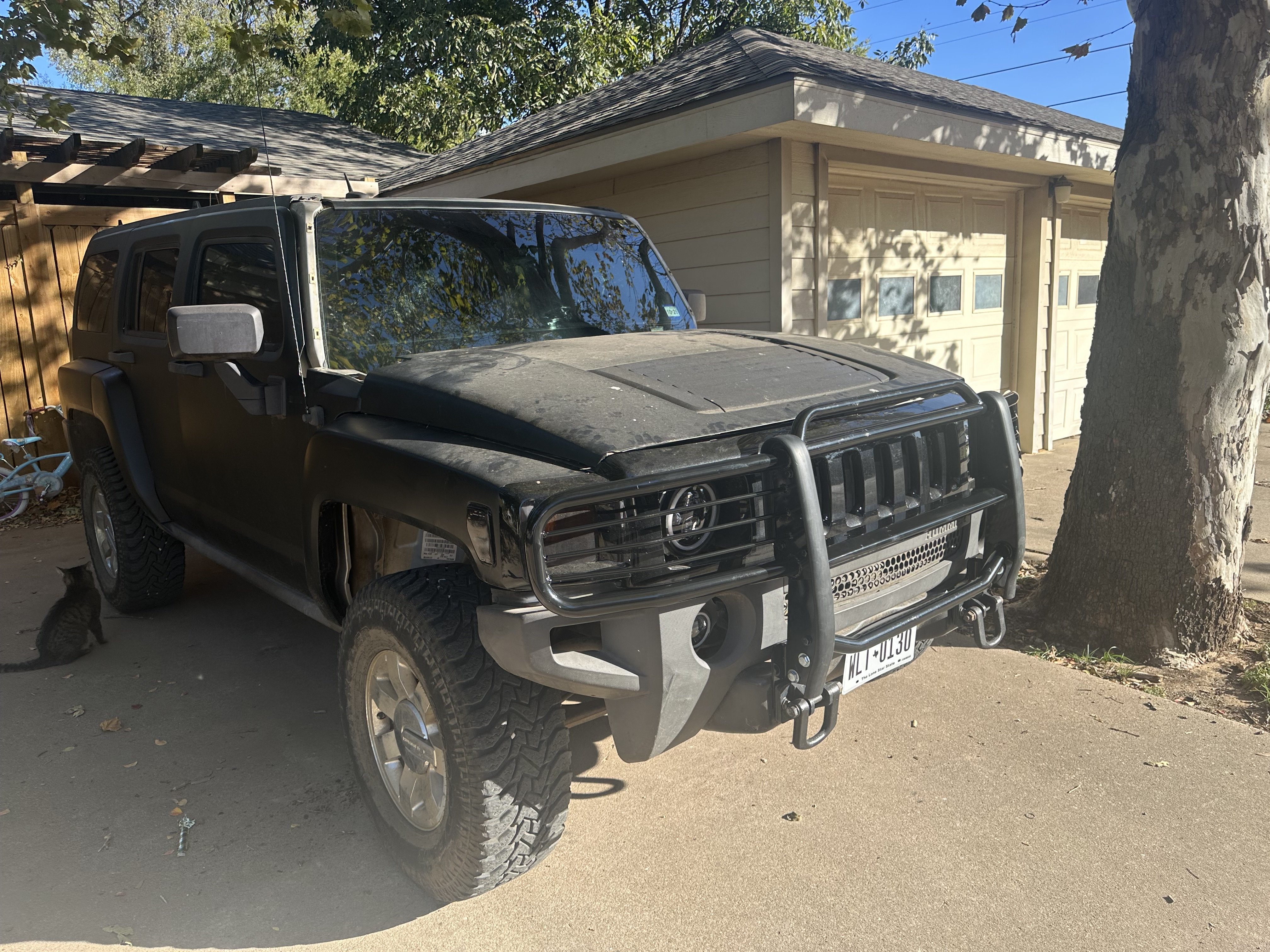

Brush guard came in today, and honestly, not bad. It got a bit scratched up in shipping but no worse than what it will eventually deal with.
No instructions included with the dozen or so pieces, but I mean…it’s a grill guard…. Its not neurosurgery. After roughly 45 minutes I had it all assembled and installed with hand tools. The girl’s nose job is all but complete!
I will eventually buy a light bar for the middle bar (already pre-drilled) for a bit extra light when driving our back rods which are flooded with hogs & deer for most of the year.

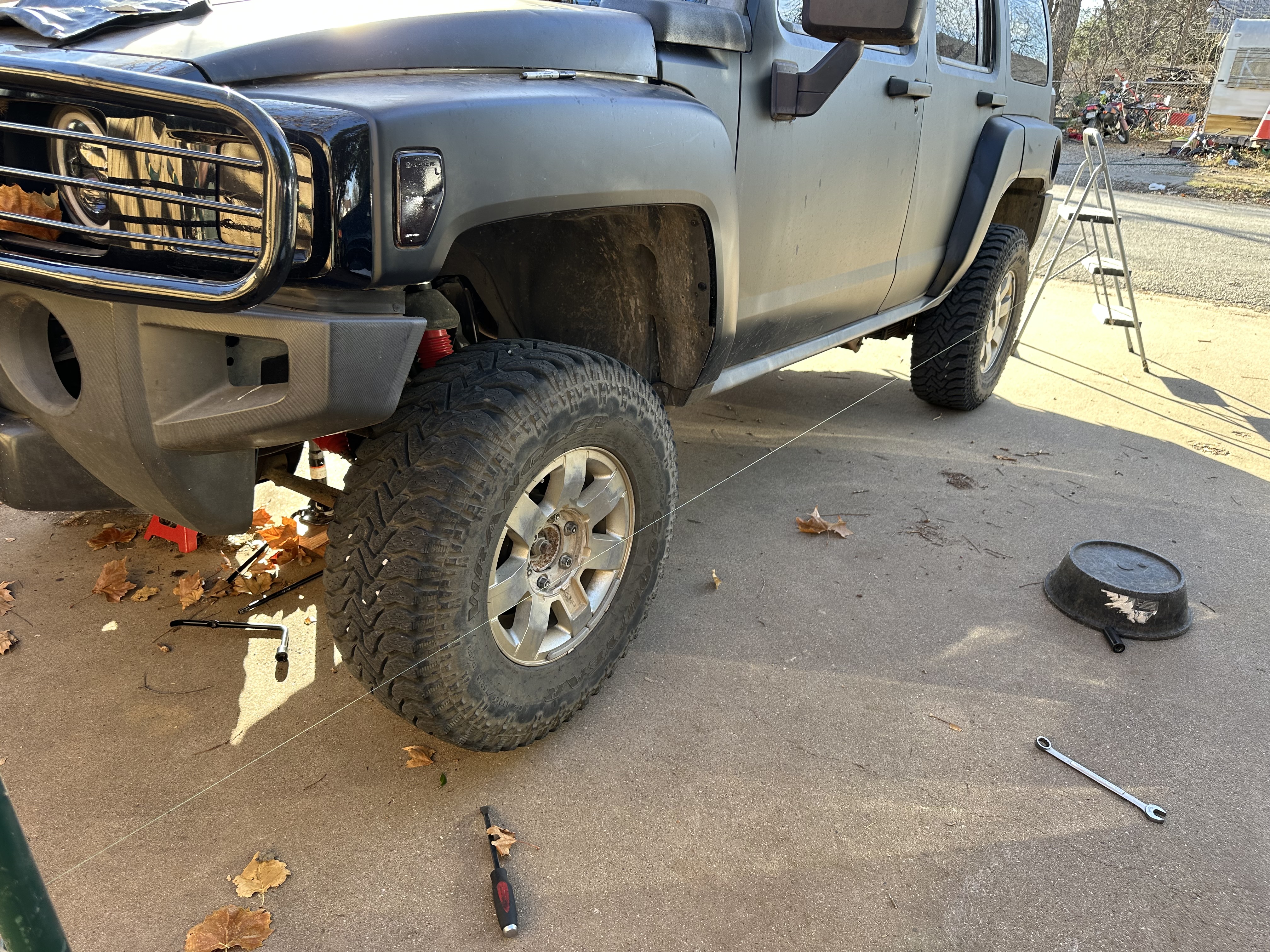

On a previous post I mentioned I had a torn inner tie rod boot, and had some down time this past week on my week off so we got to work. As normal my helper was plugging along with me for most of the process
Yes, I went with red boots, no there was no reasoning behind it, just saw them at the right price and clicked add to cart.
Also did a “driveway alignment” after replacing the boots. No it’s not perfect by any means and I’m sure once it gets to the alignment shop there will be other adjustments needed but for now, it tracks straight and I pulled the 1/4 turn of the steering wheel out of it. Ended up adjusting both sides 3/4” (measuring from outer lip of wheel) to straighten up the steering wheel.

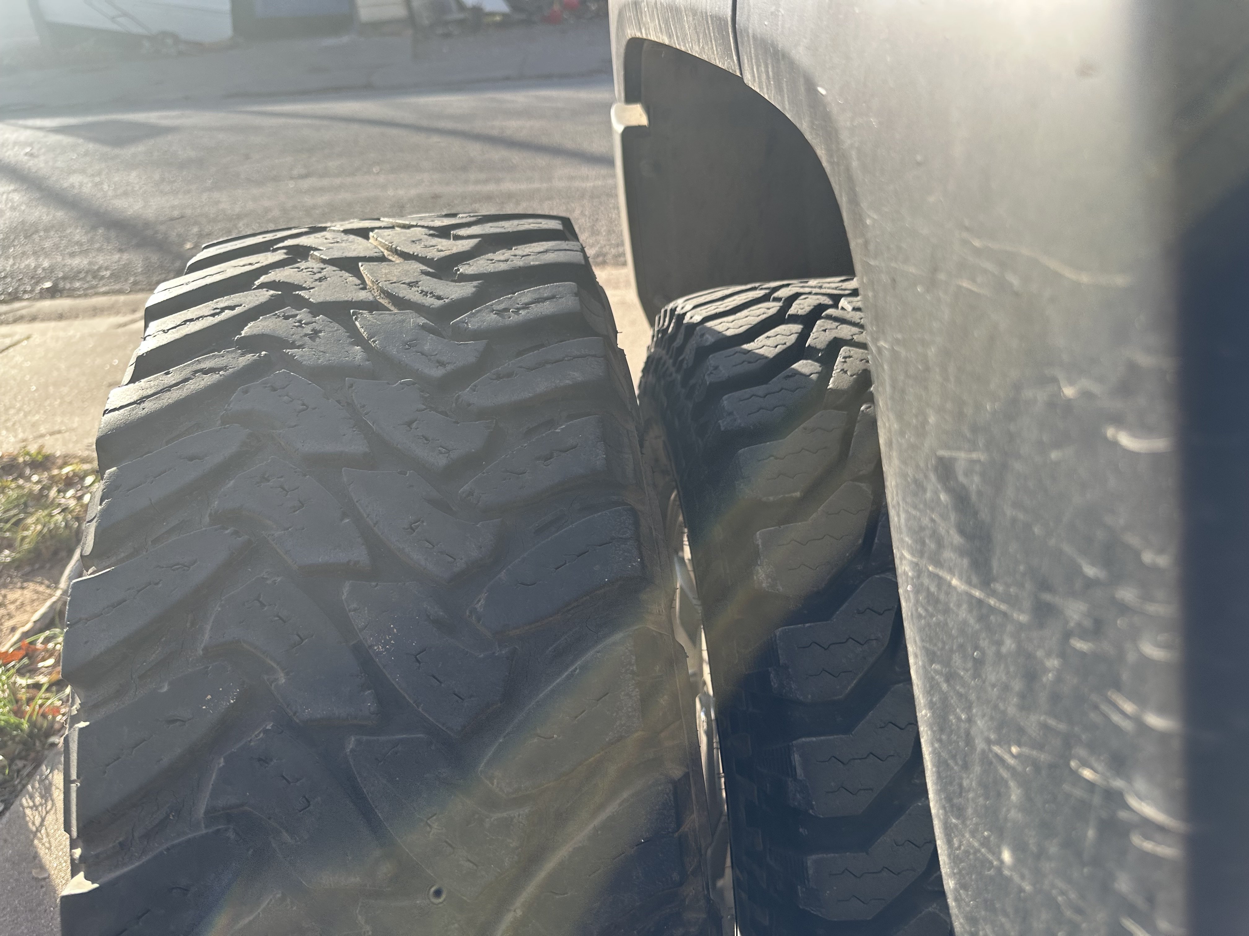

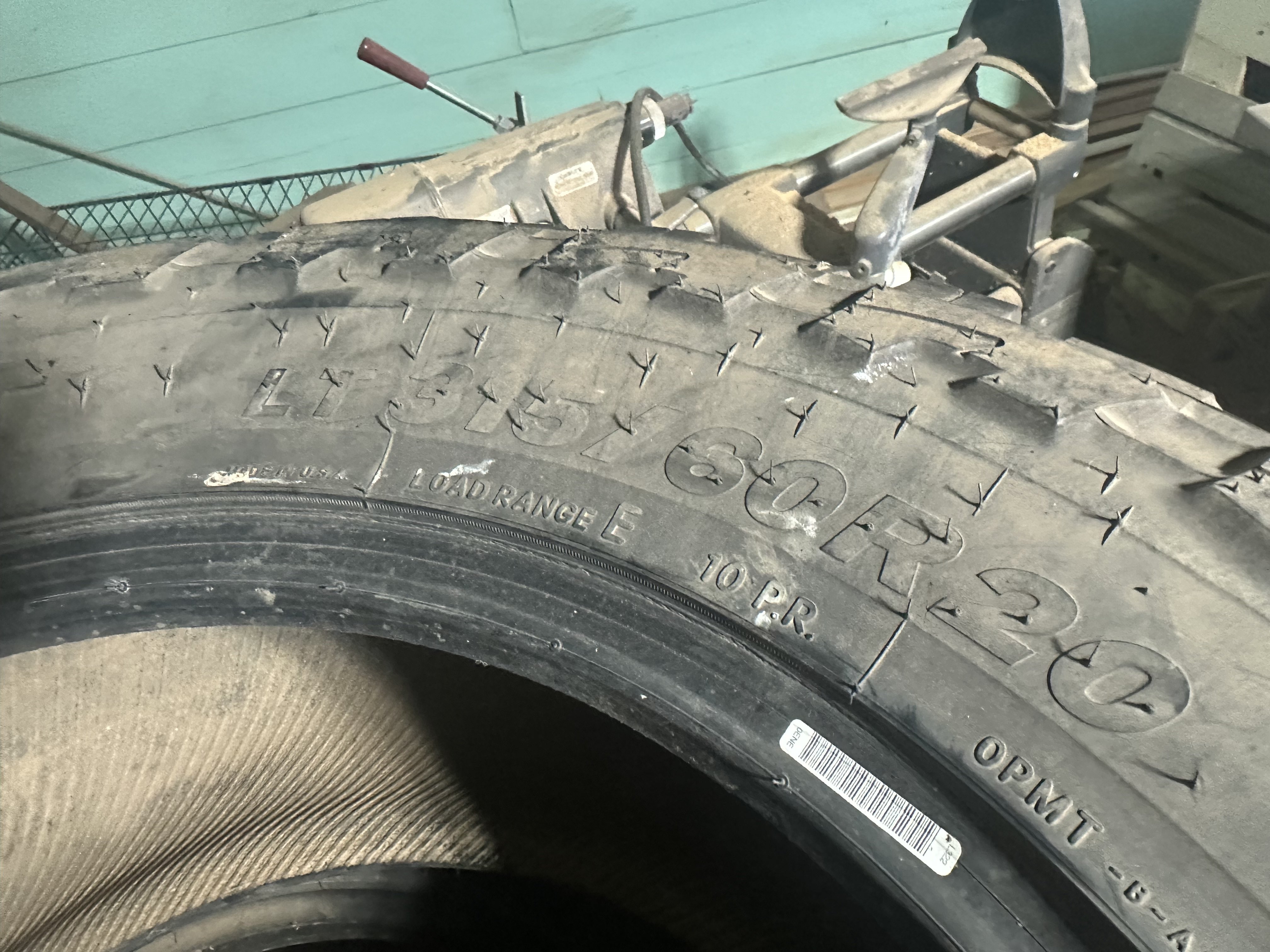

I have been looking for a set of 35” tires off and on for a year or so. They’re not high on the priority list though as my current wheels still hold air and rotate in the right direction however I found a deal I couldn’t pass up.
Got 7 of these Toyo Open Country 315/60R20 for a grand total of $200. Pictures don’t do them justice but they all measure out around 9/32 which is a little under half life on them. They all have the caliche cancer tires get around here but overall they’ll do just fine. I’ll use 5 for the Hummer once I find a set of wheels and sell off the other two and make back some of my money.

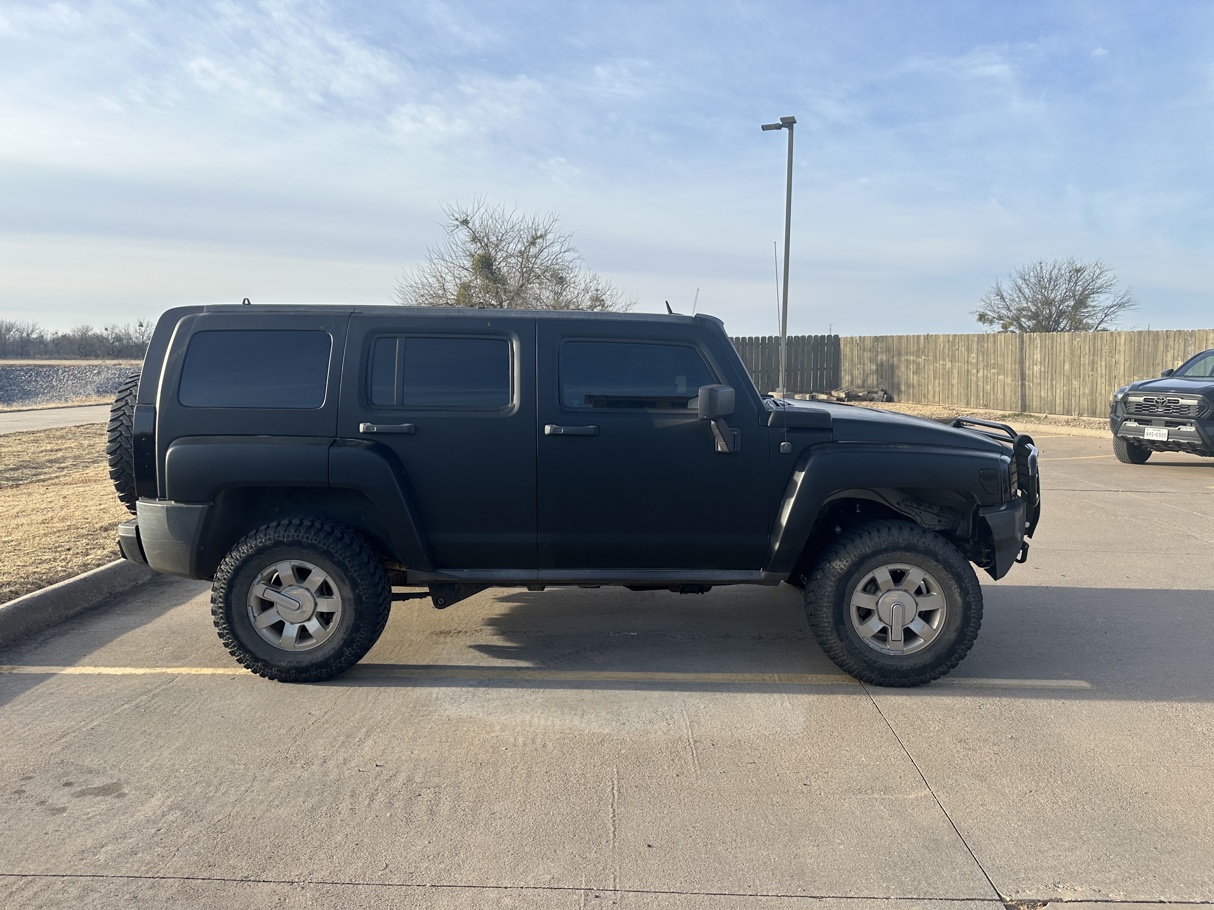

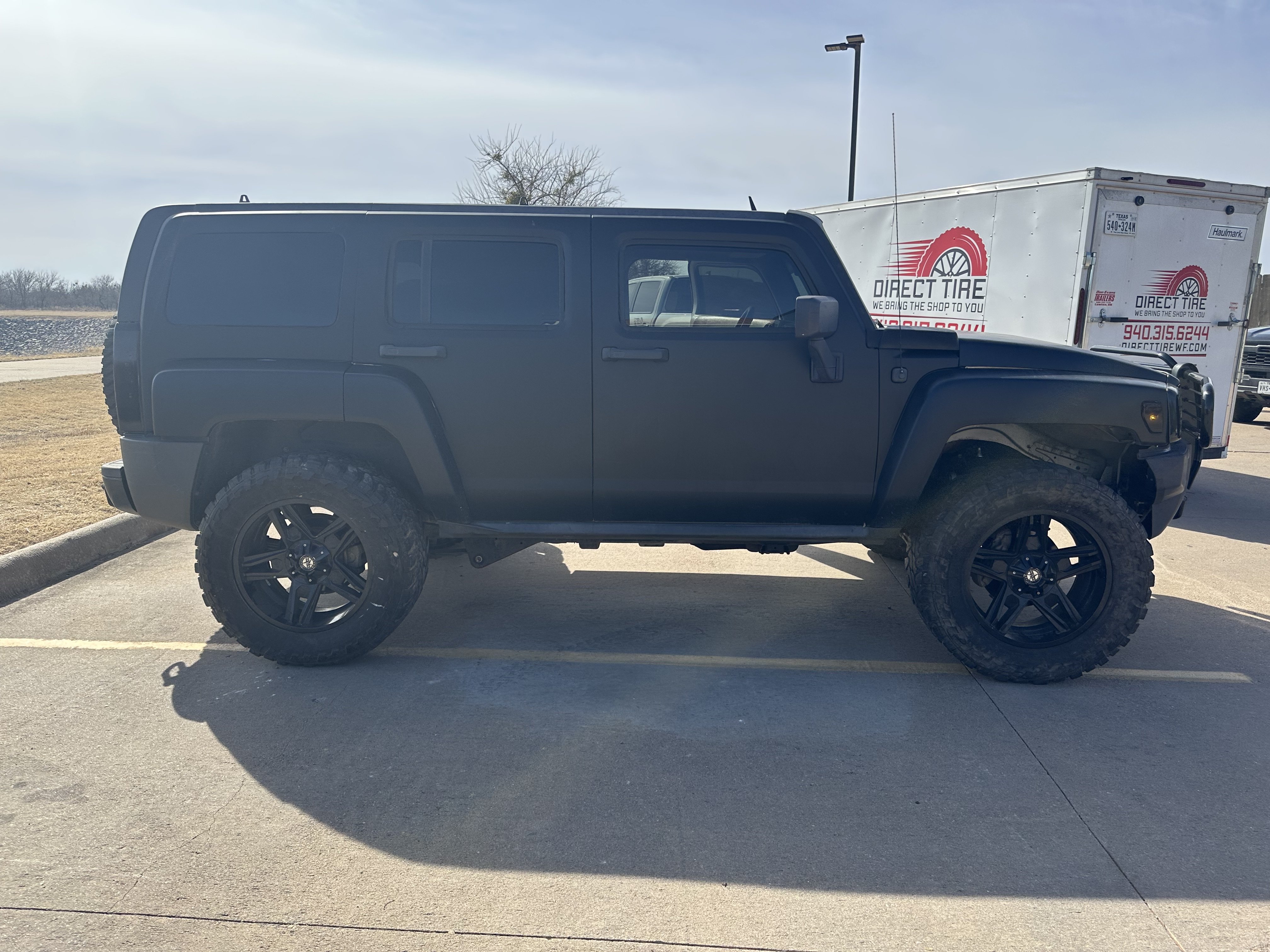

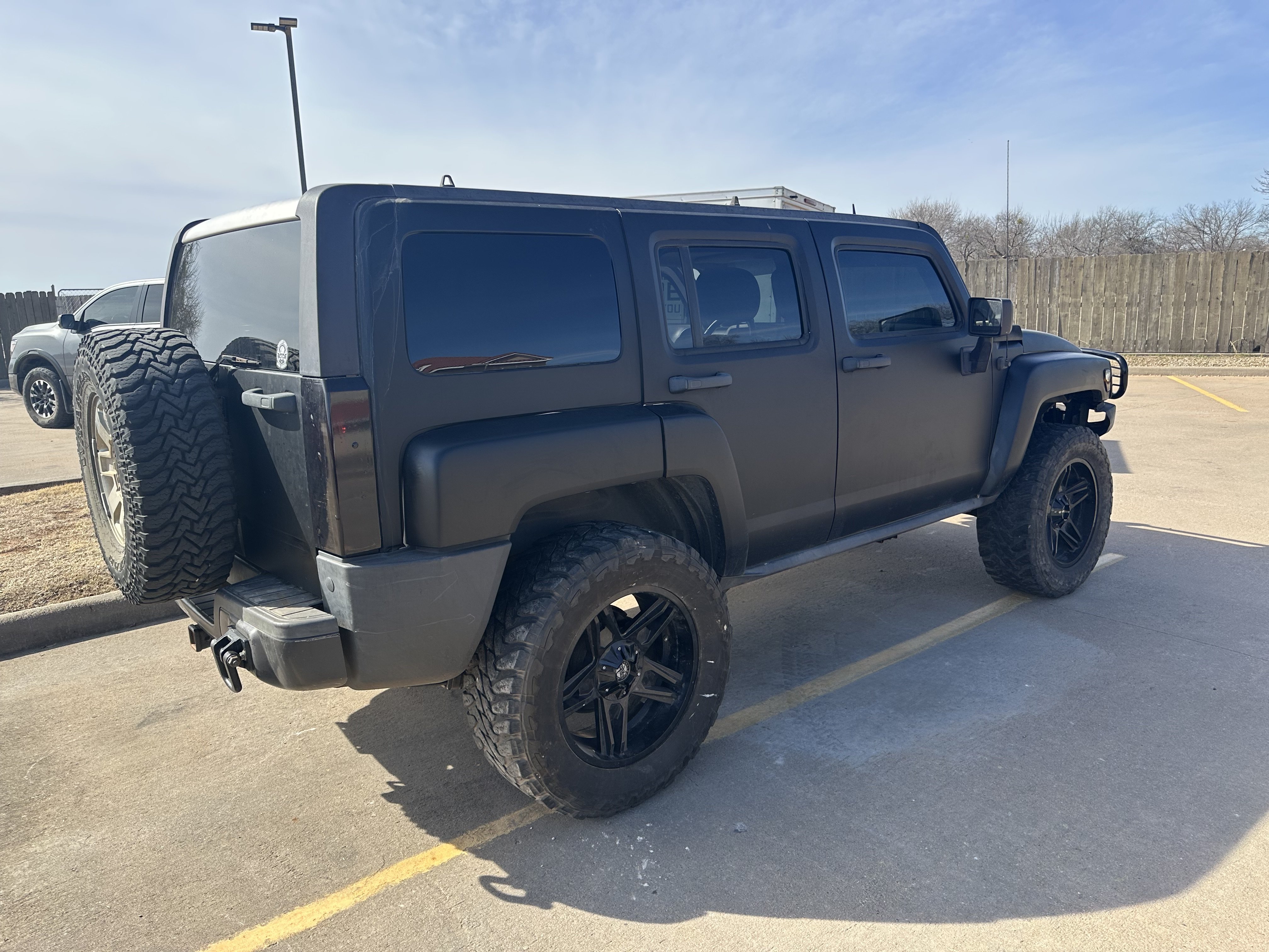

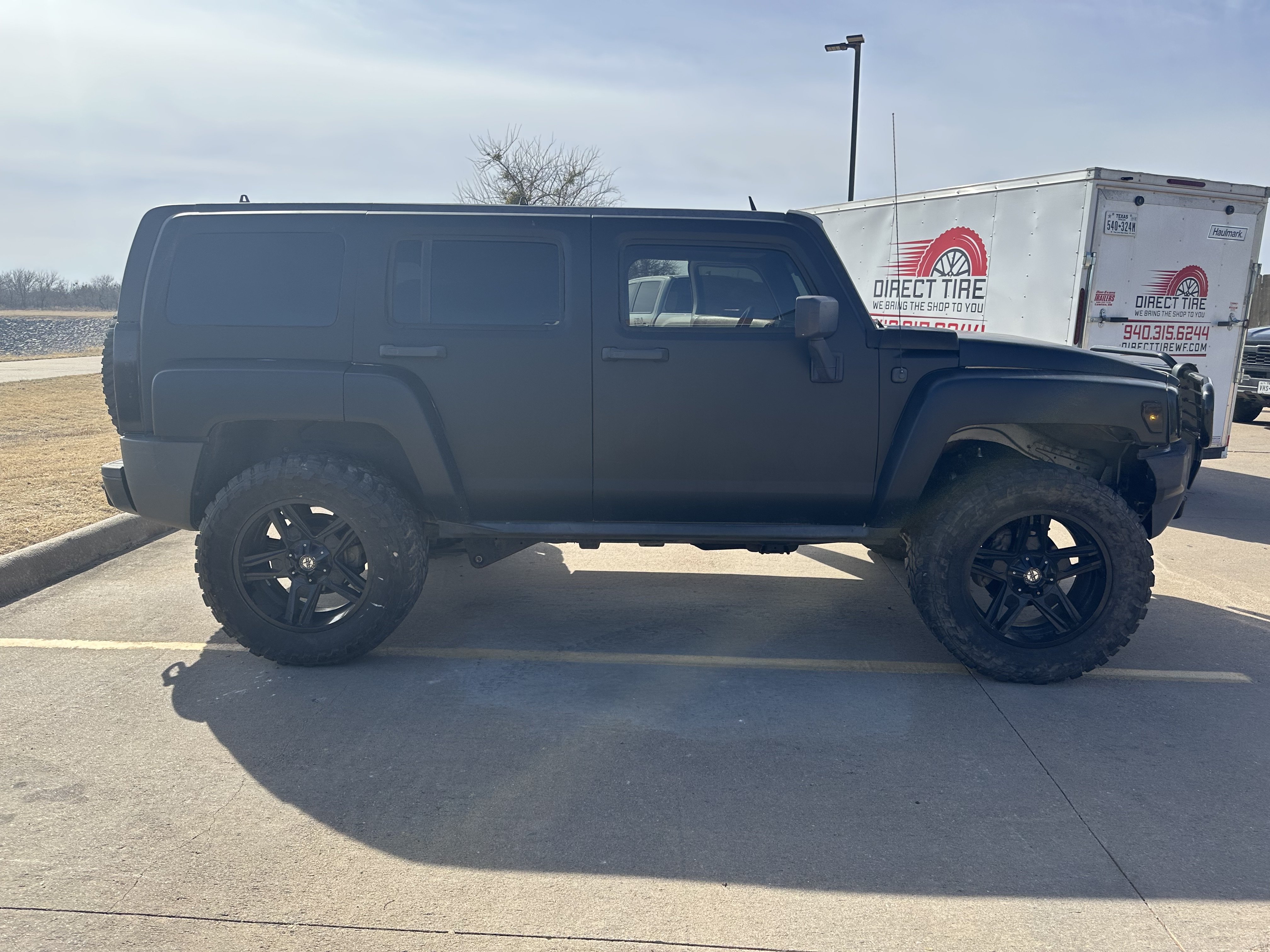

Well finally after some delay I got the wheels and tires put on. Makes a world of difference in appearance with the 35’s filling the wheel well a bit better. Although I still think 18’s would be a better wheel fit I’m happy with the outcome.
Before
After

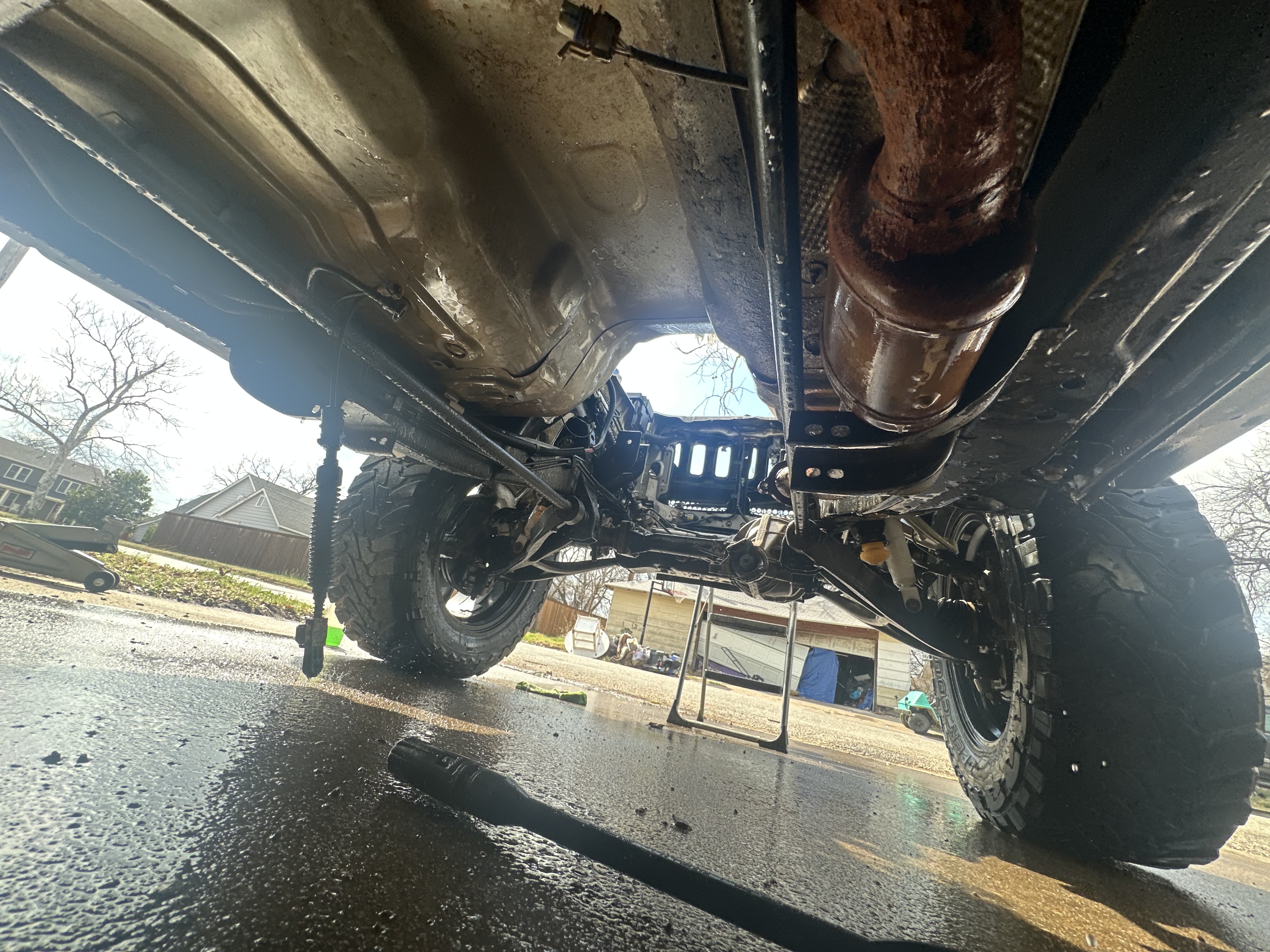

Changed a bunch of fluids over the weekend, engine oil came out with some clumps but better than the original oil change. However after draining the oil I only got about 3 quarts out of the pan and filter, which means in the roughly 2000 miles I’ve driven since I did the first oil change I lost almost 3 quarts of oil without a drop underneath. Sounds like valve seals are shot or possibly the rings.
Also found a heavy seep coming from the front diff driveshaft seal, just one more thing to add to the list of repairs necessary, but for now I’ll just keep an eye on the fluid levels and continue topping off as necessary. Once the motor comes out this summer I’ll be doing a reseal job on the front diff

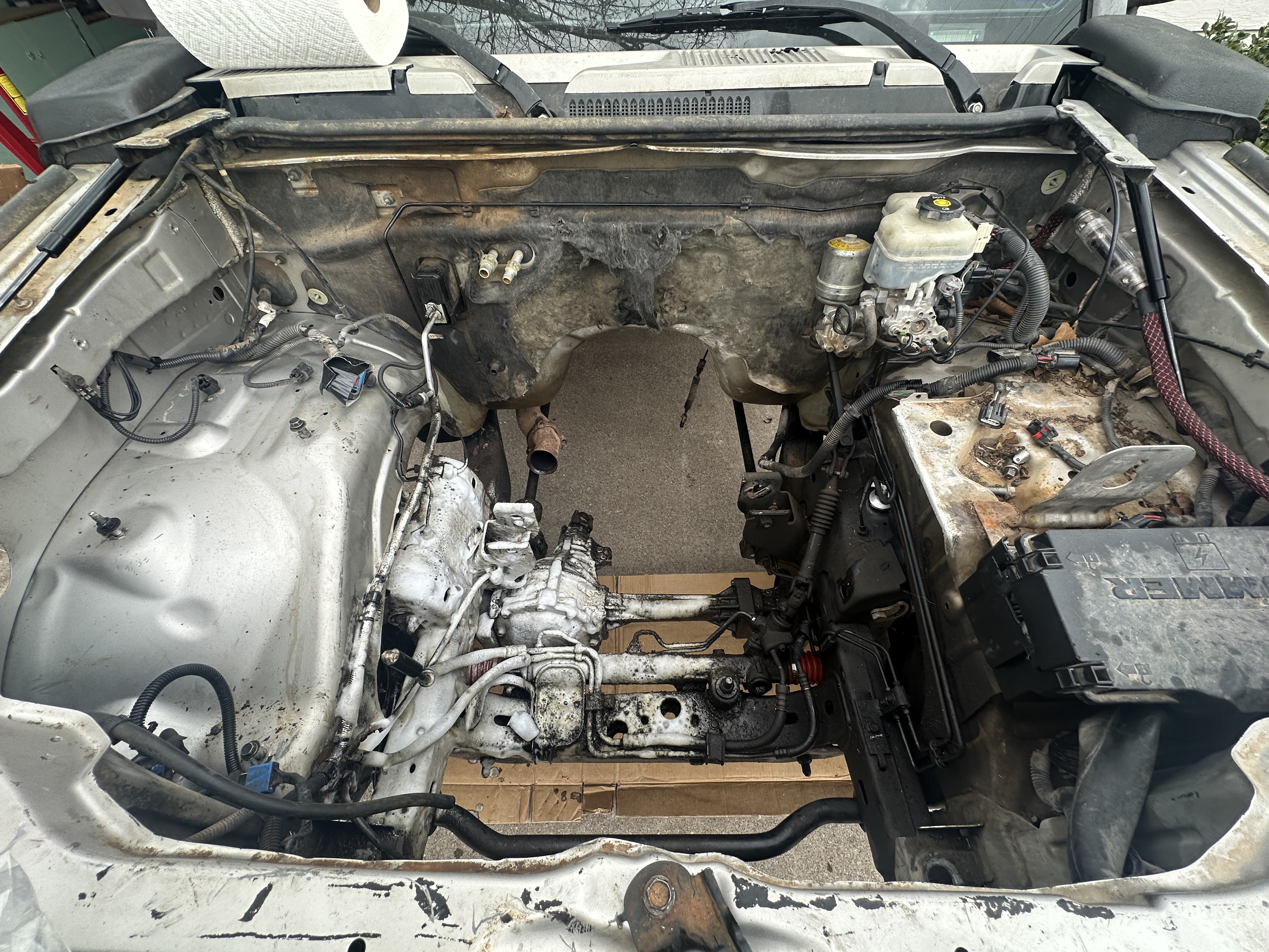

Productive day overall. Got the engine and transmission cracked apart and everything disconnected. Just waiting on the engine hoist to arrive tomorrow to pull the engine and transmission/transfer case out then comes the long fun process of cleaning all the oil from the frame rails and underside of the truck. I’m sure I forgot a ground strap or bolt somewhere but I need to be able to move the engine around a bit to confirm what all is still connected.
Decided to pull the radiator and condenser as well to make the pull out easier, condenser has a leak anyways so I’ll be using the Alpha condenser but I didn’t want to damage the new radiator I just put in.
Also, not to be that guy but who’s looking for an undamaged i5 power steering reservoir. No low ballers I kNoW wHaT I gOt lol
Let’s start the bidding at one million dollars lol. Seriously though, if someone is looking I’ll be glad to ship.

Spent a few hours working on getting things cleaned up between the foam, simple green, a pressure washer, and a couple bristle brushes. Came out much better!
The differential was pitch black and the steering rack was completely covered in about 3/4” of grease and dirt. Front crossmember required some scraping with a paint scraper to get the caked on gunk off before hitting it with the degreaser and pressure washer.
All in all it was a productive roughly half day (only got to work for about a total of 3 hours.
Got the girl to fit in the garage with the engine, trans, hoist and misc other stuff while still leaving room in the other side of the garage for the 4Runner.
