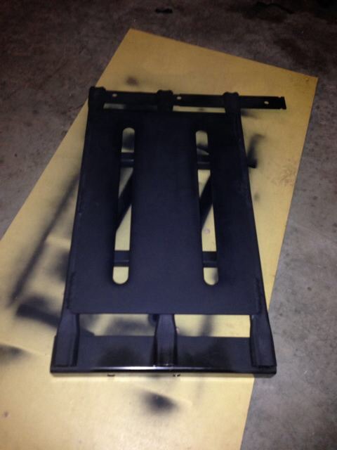

Painting the sliders and Thor Parts skid/UCP this weekend and then hopefully bolting them both on for the last time!
Not too bad if welds considering I used my 110V Flux core setup...
A little tip for the welding with flux core. If you spray the surface that you're laying the weld on with soapy water, you will get less and even no spatter balls.
FRU
Thanks for the tip! I'll try that out when I go to weld up the trans skid!
Thanks!

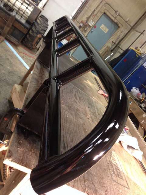

So I figured I'd post up some more progress pics from the weekend:
Going to bolt all this up right after the SuperBowl finishes up
