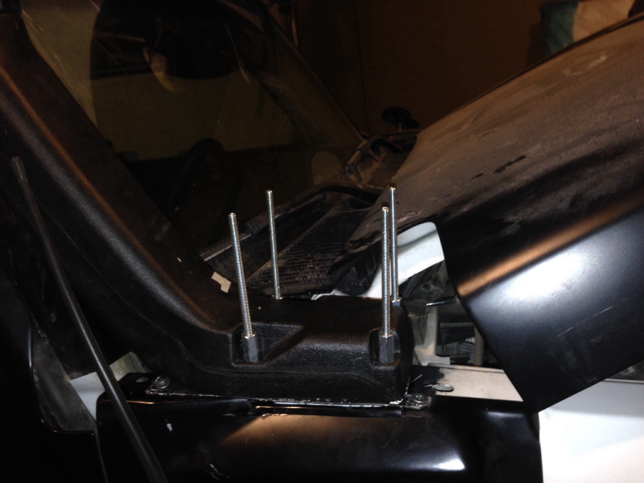

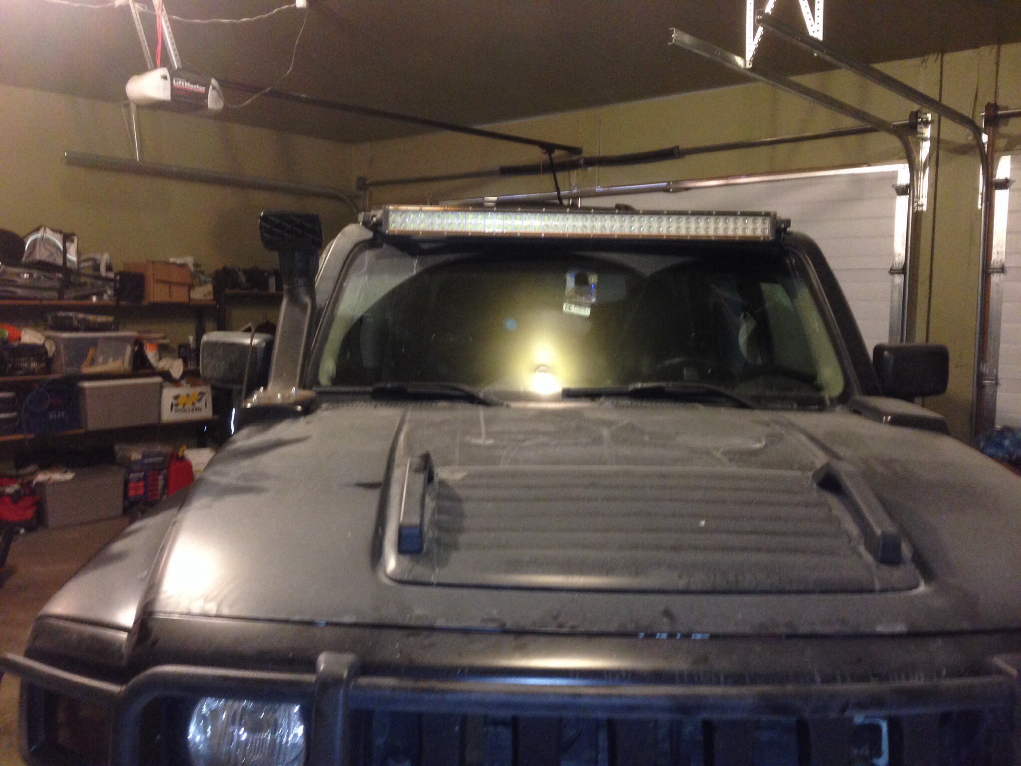

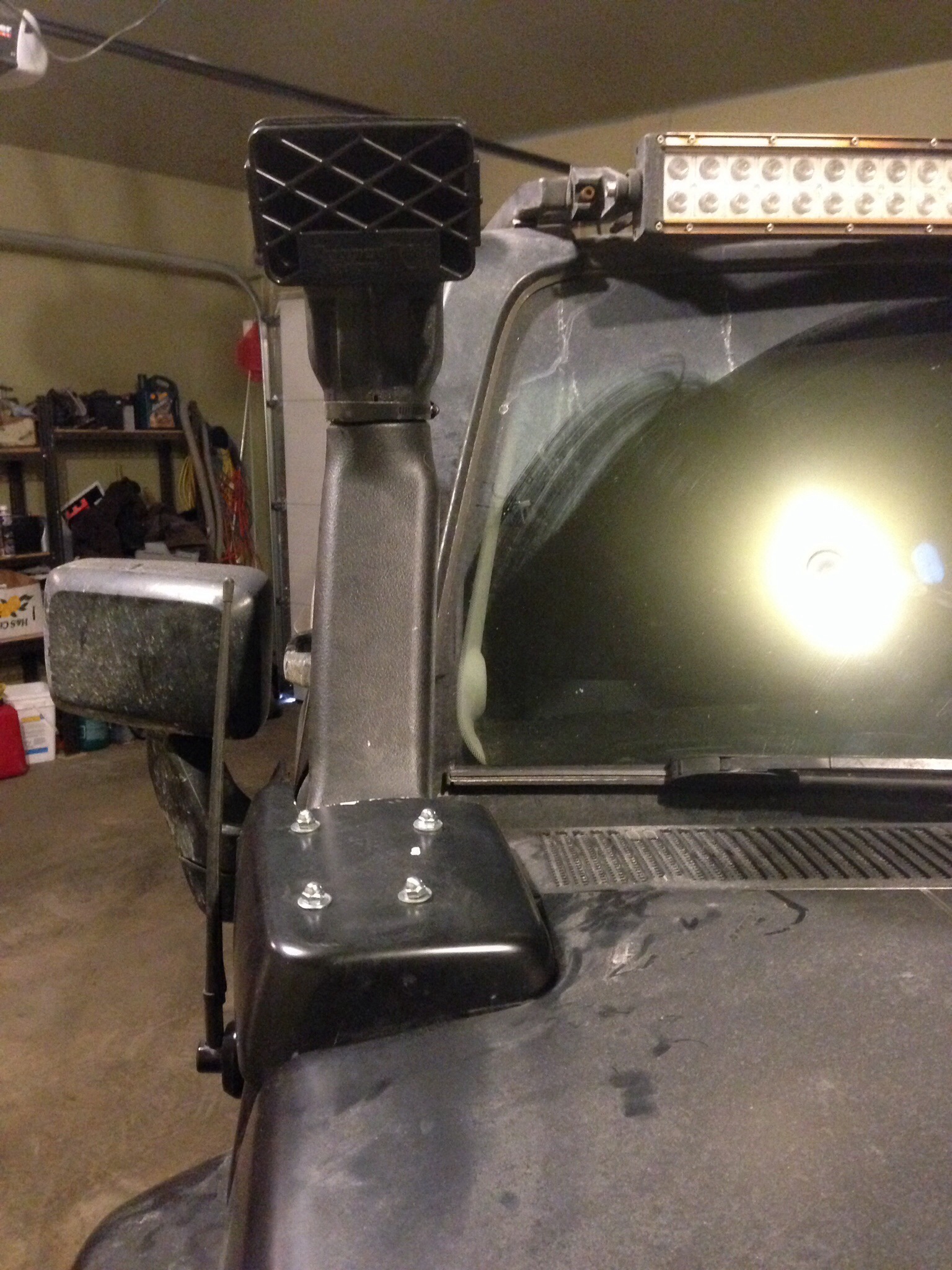

Haha well, I had it on for about a month and I was not satisfied with the setup so I took it off and took some time to think how I wanted to mount it up in a way that I would be happy and not touch it again.... In the mean time it started to focus on mods that will protect me on the trail..
It just so happen that I had a heated garage to work in this weekend so I decided to try and mount the snorkel again: here are the results, it is much more solid and I am way more happy with this setup even though it has some bolts exposed, I'll be painting them black shortly or maybe use those bolts to mount a small LED ditch light
Here are some pics:
