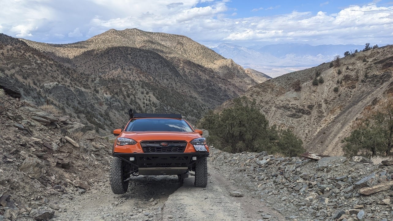

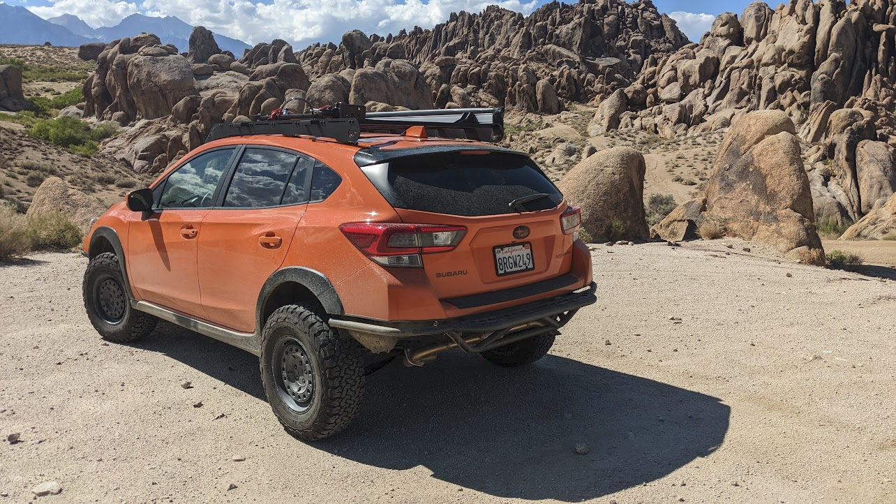

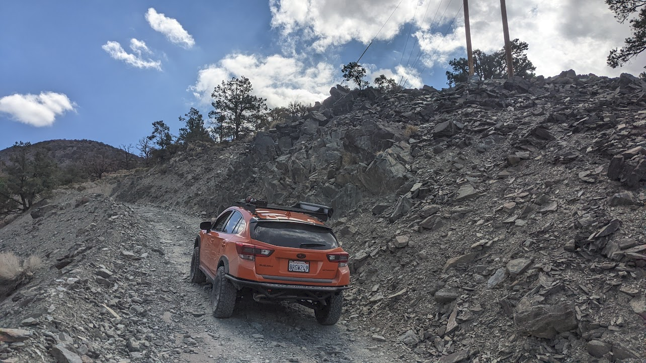

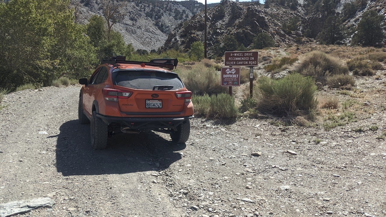

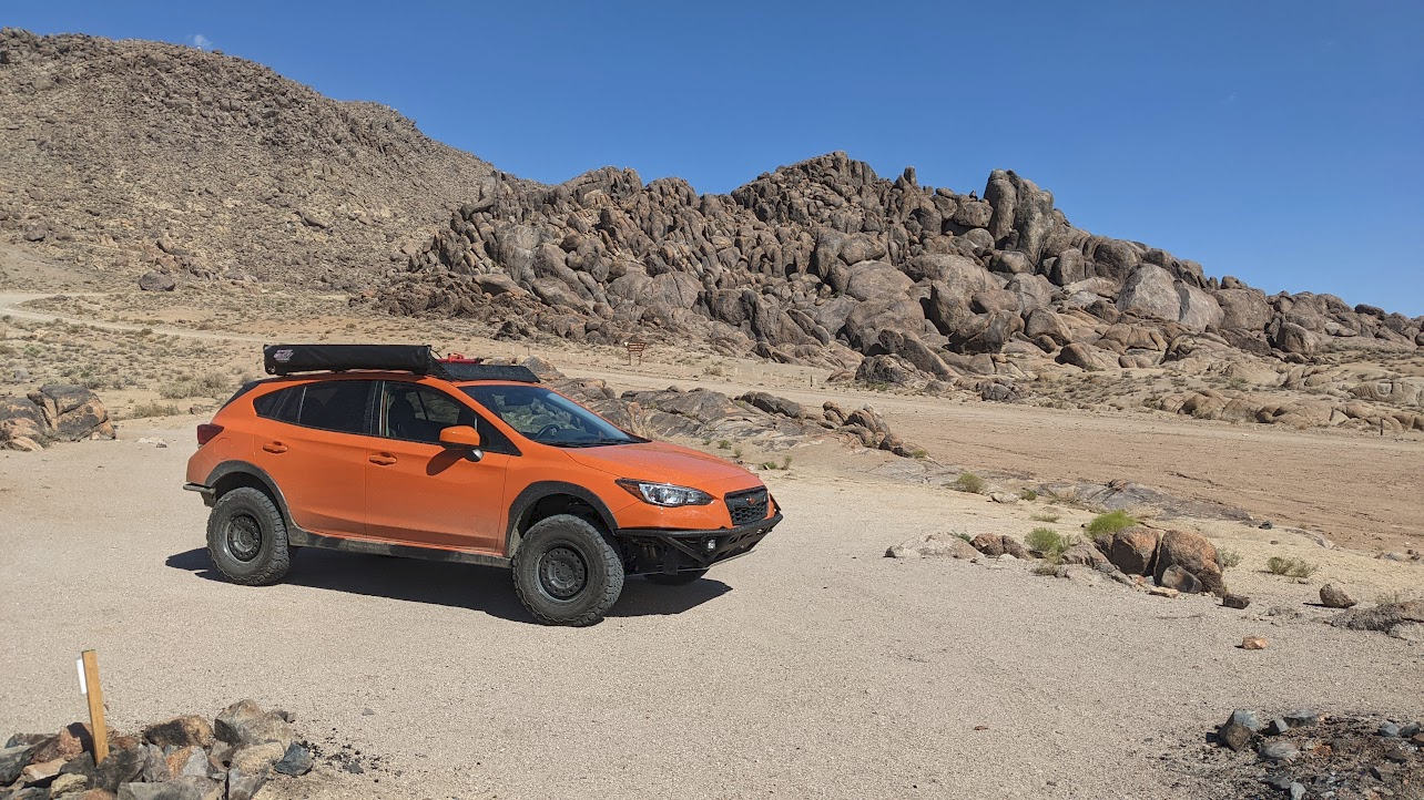

I finally got a chance to take the Battlewagon off road! For what it is, it performed well. The altitude really clobbered my power. I was able to make it up the switchbacks at Silver Canyon (Bishop, CA) a short distance before the engine ran out of OOMPF to climb the mountain.
Here is where I got stuck.

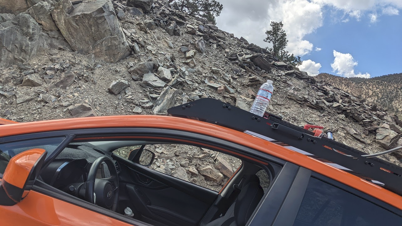

The water bottle shows how steep it was.

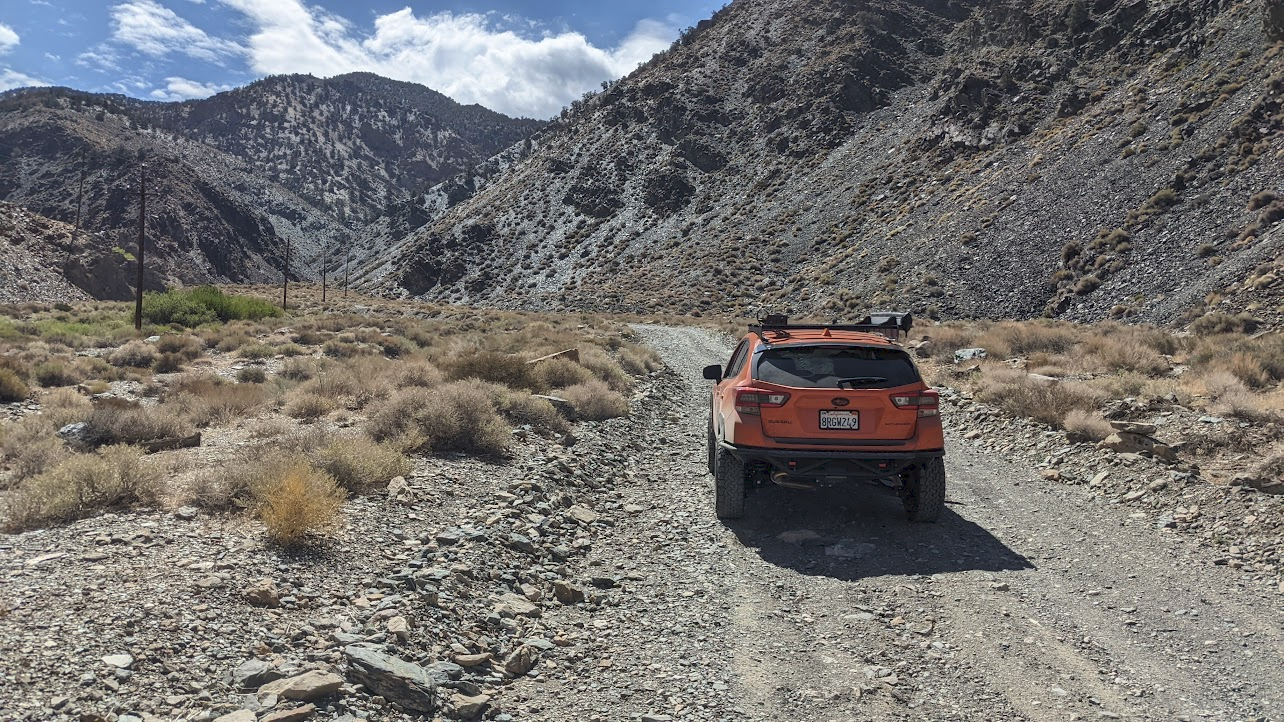

Got some tripod action on the way down.

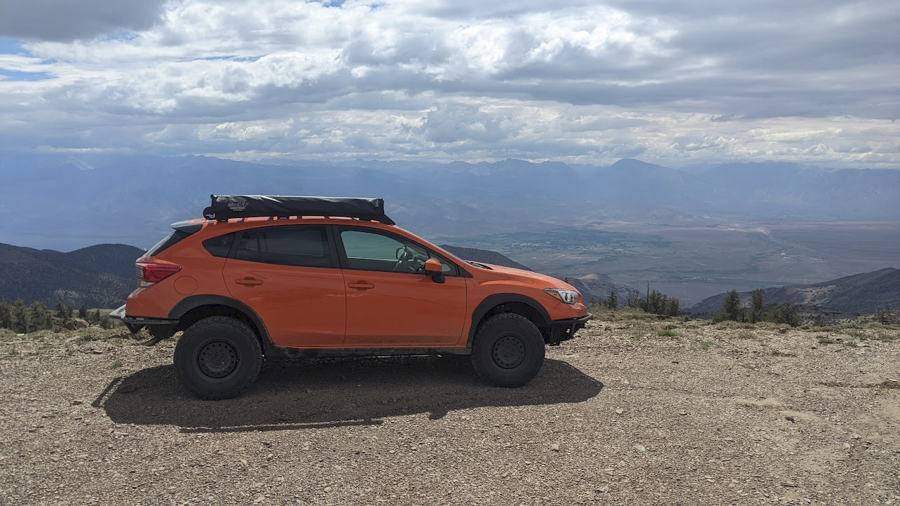

I cheated and drove up White Mountain Road so I could take a picture at the top.

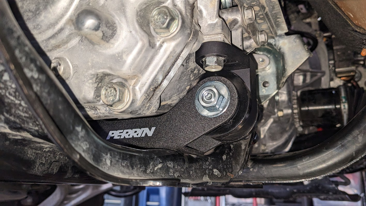

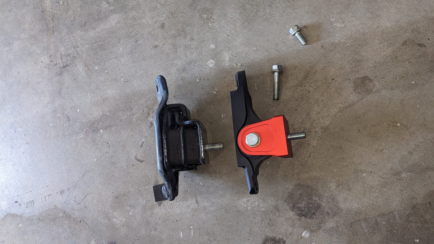

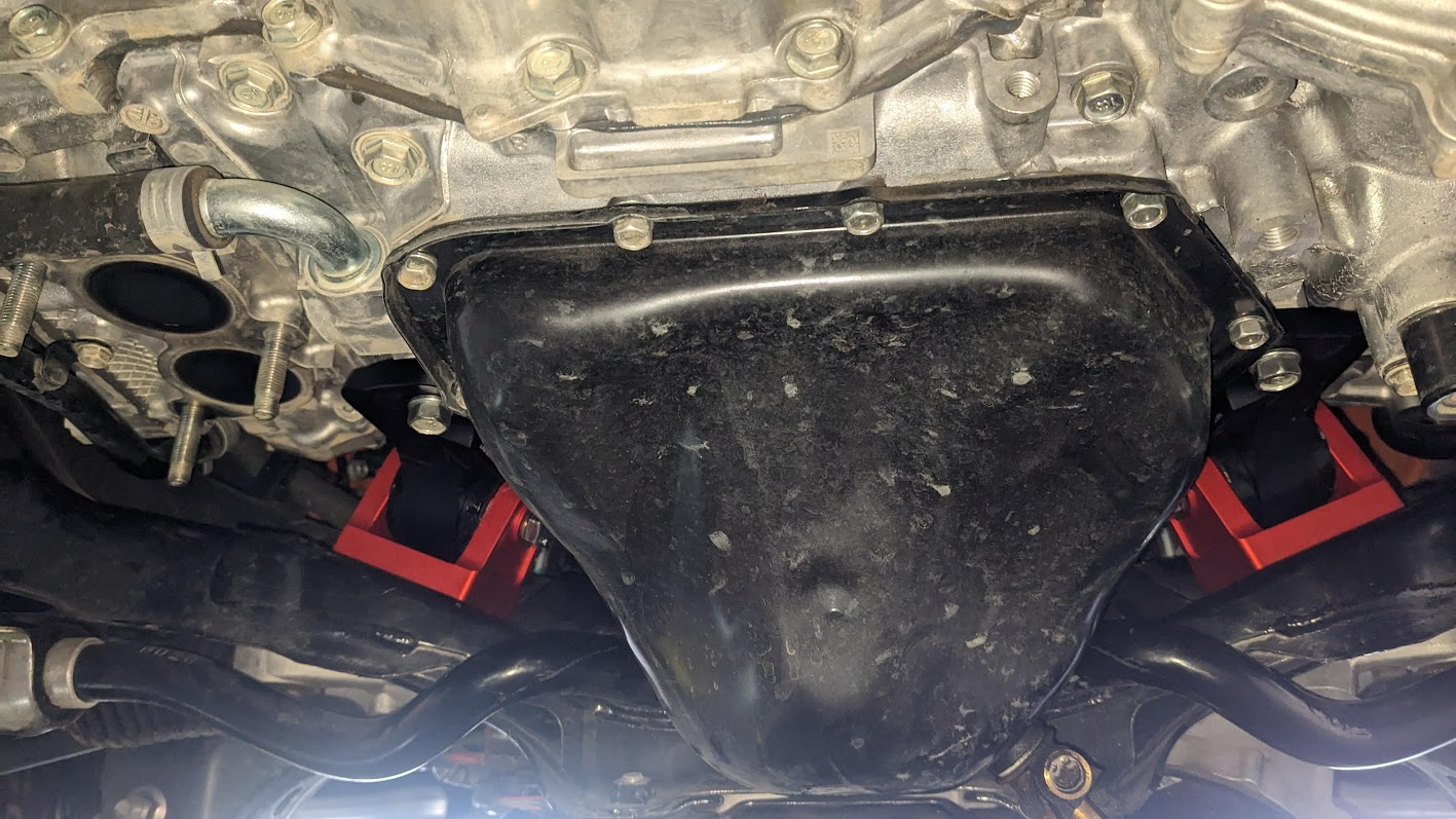

I have done a few more mods on the ol' Battlewagon . . . The engine was flopping around quite a bit with the factory mounts so I replaced them all with units from Perrin.

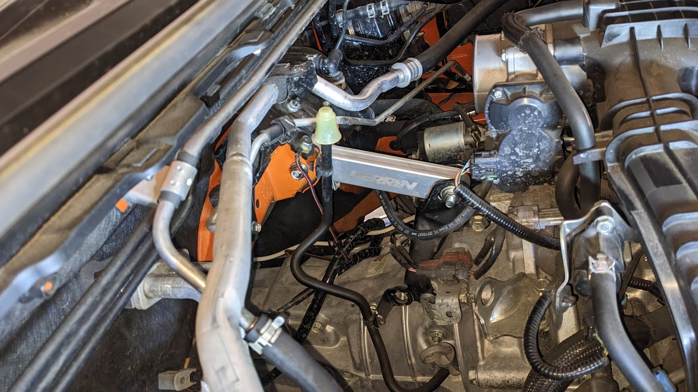

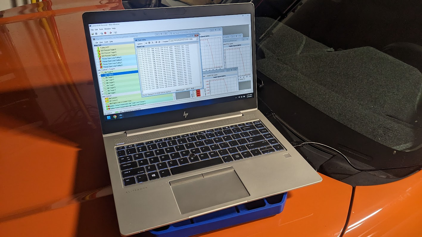

I also started to hack at the computer a bit. I was able to delete the obnoxious rev-hang and lowered the engine cold idle speed. I am still dinking around with other maps as I learn.

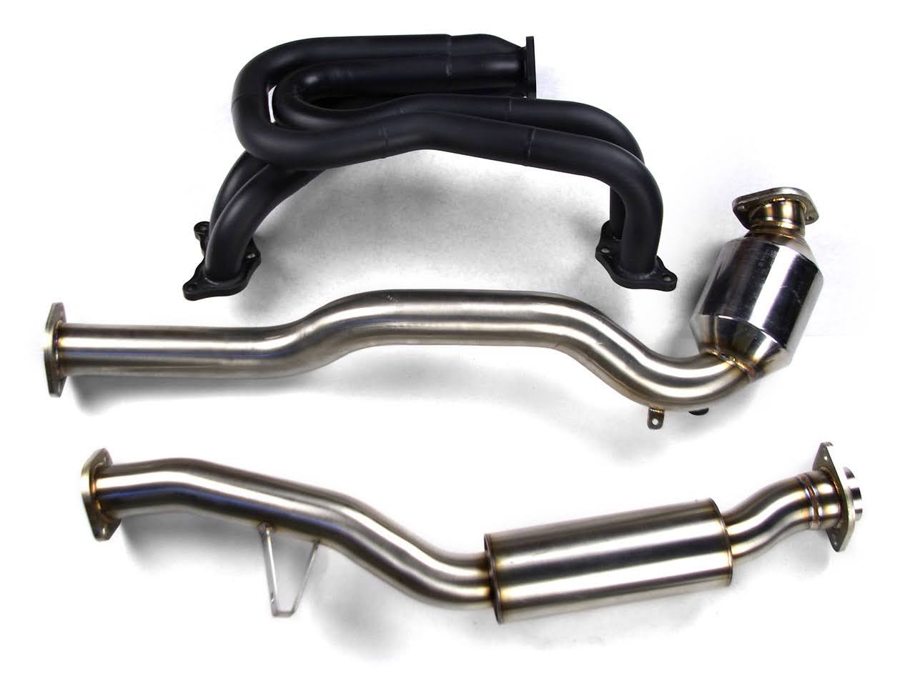

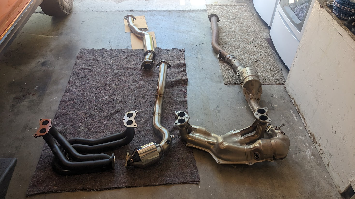

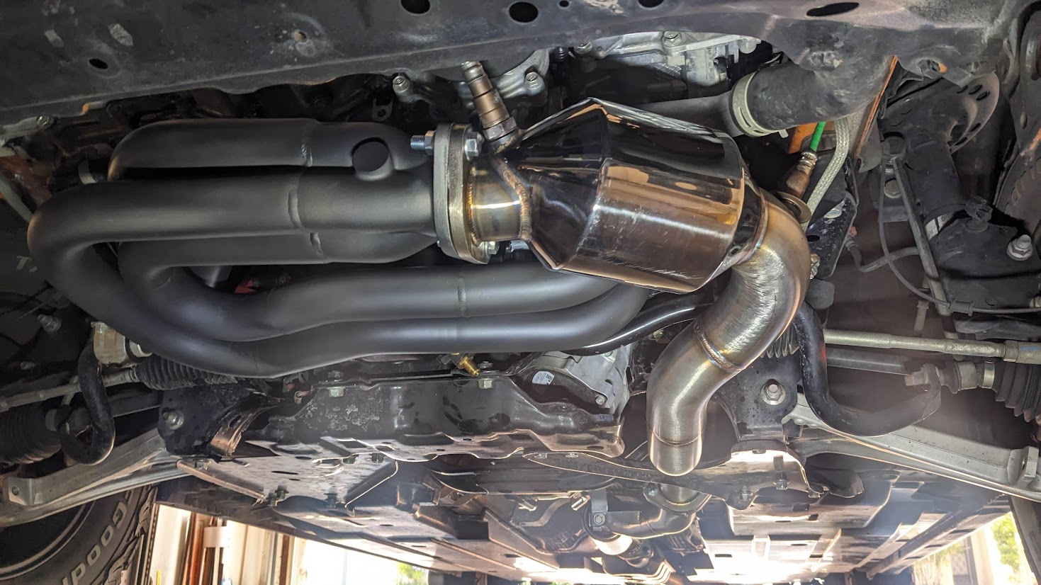

The next project has been ordered. I found an unequal length header to get that "lumpy" sound that the old boxer engines had.

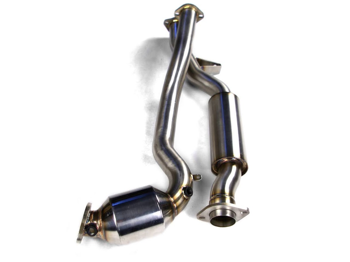

Well, I got the new exhaust installed.
It sounds awesome!
However, it is REALLY loud in the cabin. I put the old exhaust back in for now. Not sure what I want to do yet.
