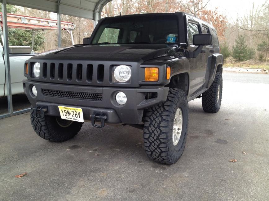

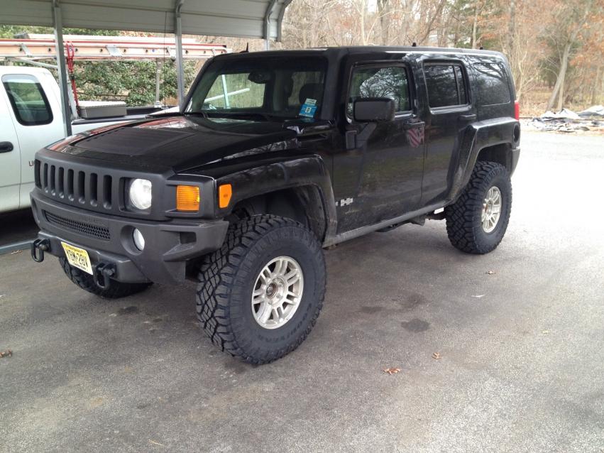

just got some new shoes today. 315/75/16. hope they perform as good as they look.View attachment 3163View attachment 3164View attachment 3165View attachment 3166
What tires did you have before? Do these run fairly quite compatibly or were you others the original?
Give us a report in 10,000 miles or so. I have not seen any higher mileage reports on these on the forum.
I want something a little less aggressive this next time if I can find something. I do Off-road a lot but still hwy driving on long trips is where I notice the roar. The Cooper STT armor tech 3 ply sidewall carcass has been a great tire but as they wear seem to get louder. Not generally a problem but a consideration.
That tread pattern looks good.
Sorry for all the question but you actually have a set.
Are yours E rated and do you think the sidewalls are soft?
I guess that might be answered by airing down.
I'm just wanting to know.
Been a big fan of the Duratracs for a couple years now. Went from 265's to 285's and read exactly .8 mph off with the cruise at 70. The 315's are actually a 34.6 and my estimation is not much change on the I5. I have a GM performance intake and it hauls as long as the tranny can downshift into 2. Just got done running trails in Northern MI last weekend with 33" Duratracs and 25,000 miles and they had plenty of bite as long as I didn't get hung up on ice climbing hills. Burnt some rubber and smoked some brake pads on a couple prolonged climbs where ice became the traction medium. TPM'd to get up but there was no mistaking the burnt rubber smell nor the steam coming off the rotors. A couple times got buried and needed a strap - but overall I am really happy with these tires - and the 3.5 I5. Lots of torque and traction and speed when dialed in. 4hi lock in 2 or 4lo lock in 3 will scream up a hill. Plenty of power and speed if the ground will hold. The weight difference between the 315's and 285's isn't much and can be compensated for by a little trail weight adjustment. The advantage of the larger radius of the 315 over rocks is becoming appealing to me.
