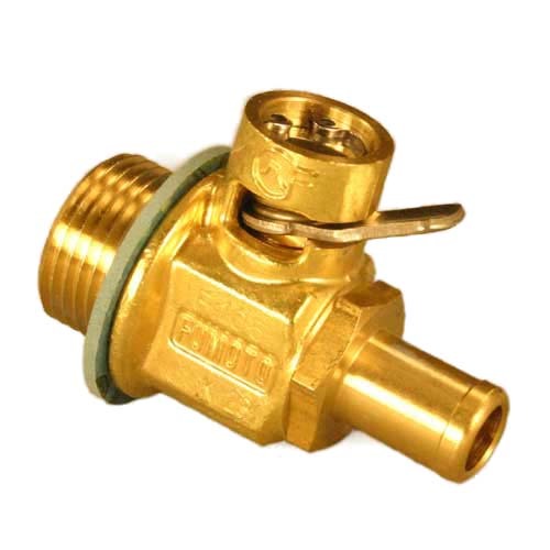

Since we all know the oil change on the H3, 3.5 and 3.7L 1-5 engines suck big time, has anyone installed one of these? It is the model with the nipple, so you could install a tube over the nipple and direct it down to the pan or container before opening the valve?

With the hose attached to the nipple, there is no mess when doing an oil change. The filter side has never been a problem, its always been when you pull the drain plug, the oil splashes down on the crossmember and then it goes all over.

I don't have one on the H3 but only because I haven't thought about ordering one when I was needing to do an oil change (I do need to do one now). I had a similar valve sold by Fram cost me an engine. The Fram valve had a hose that screwed on and apparently the last time I unscrewed the hose the valve backed out. With the skid plate protecting the plug on the H3 I don't see any problem with using it. The latch on the Fumoto valve is secure while still being able to open it in a tight place. I have friends that have used them on some serious engines without issue.

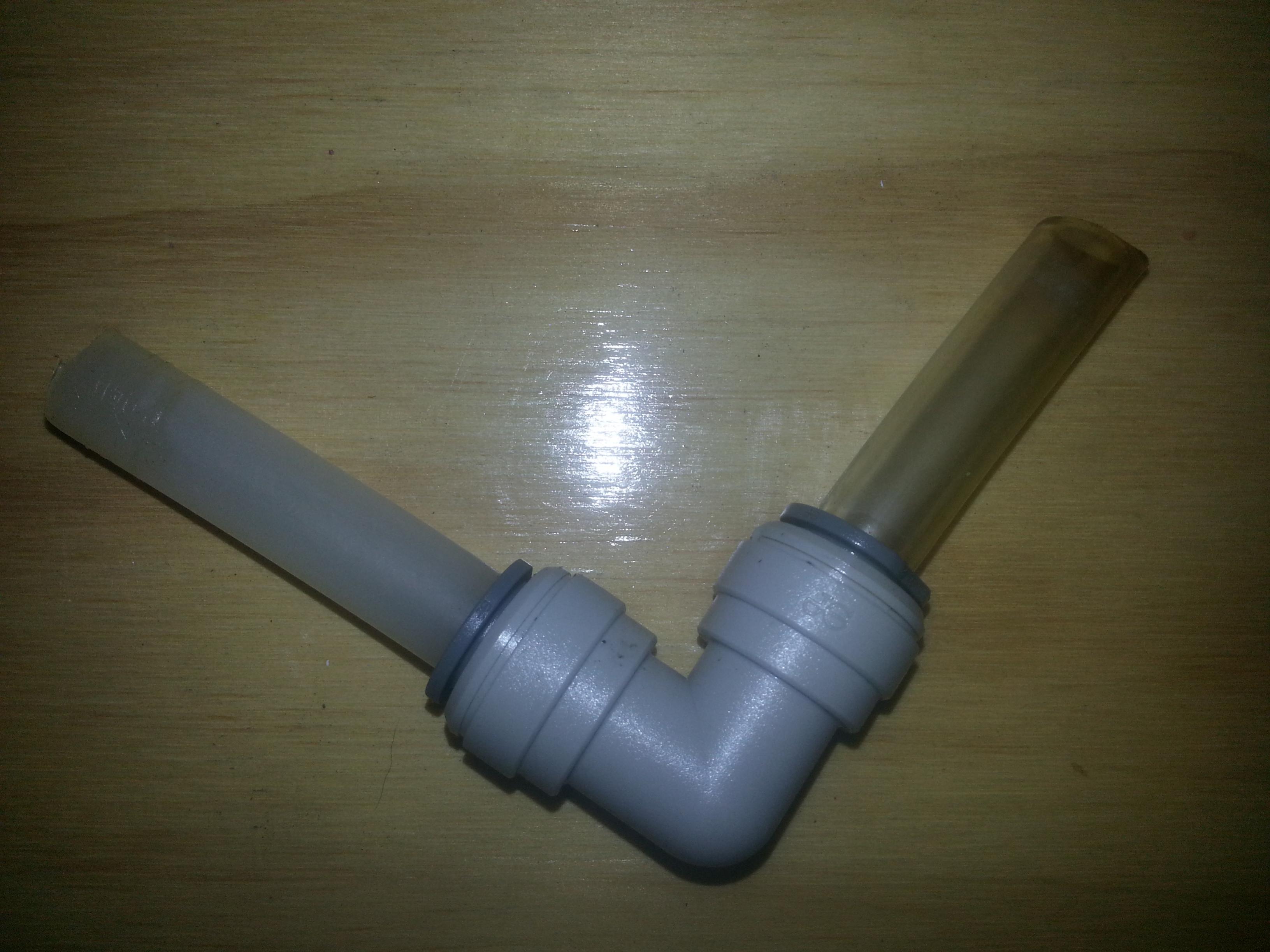

I have one on all my vehicles since I found out about them in the 90's. The H3 is by far the best application to date. Small hose ran to an empty oil jug is really a no mess job. I believe it is a F-107 and I use quick connect tube fittings to angle it down.

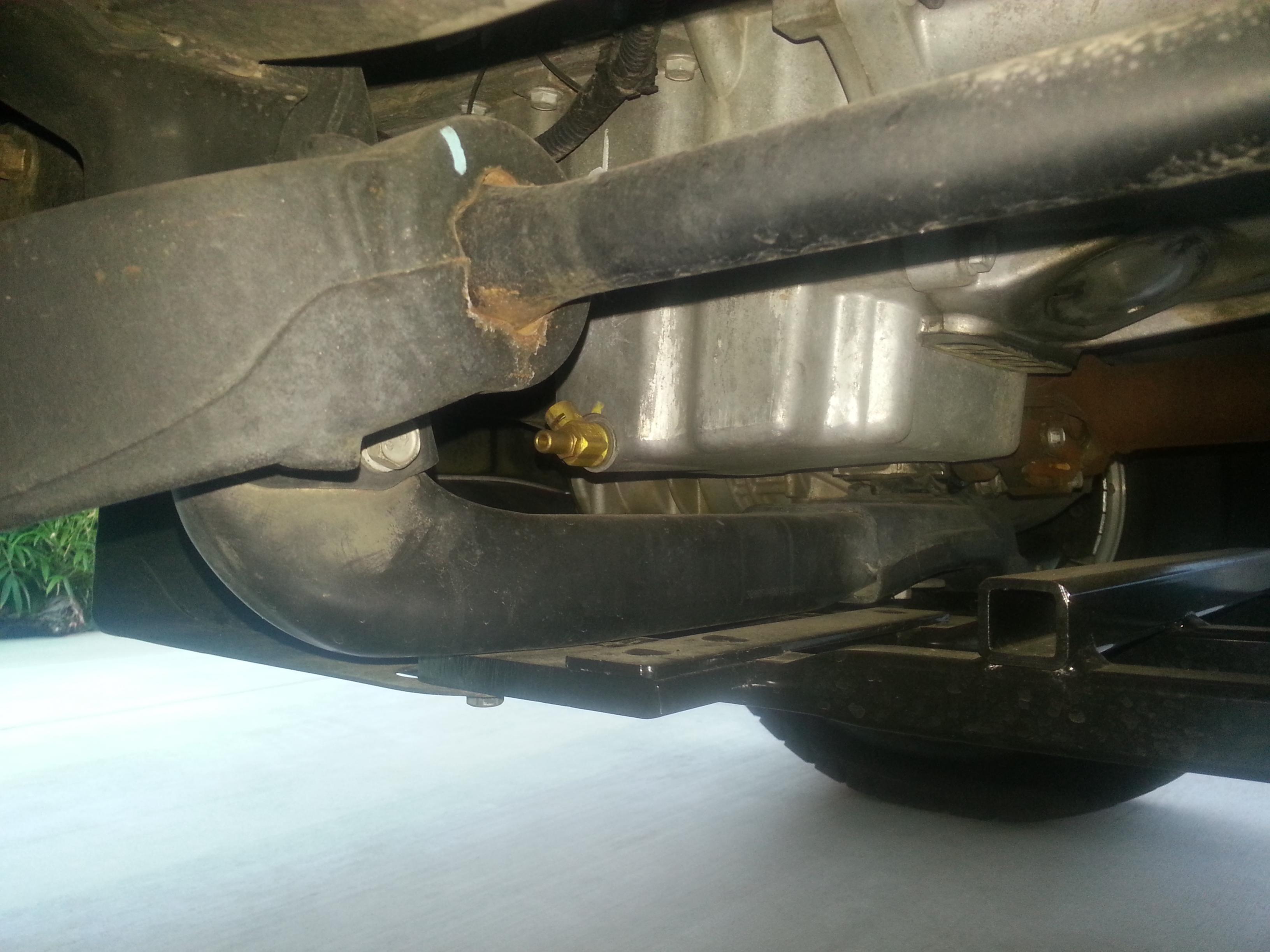

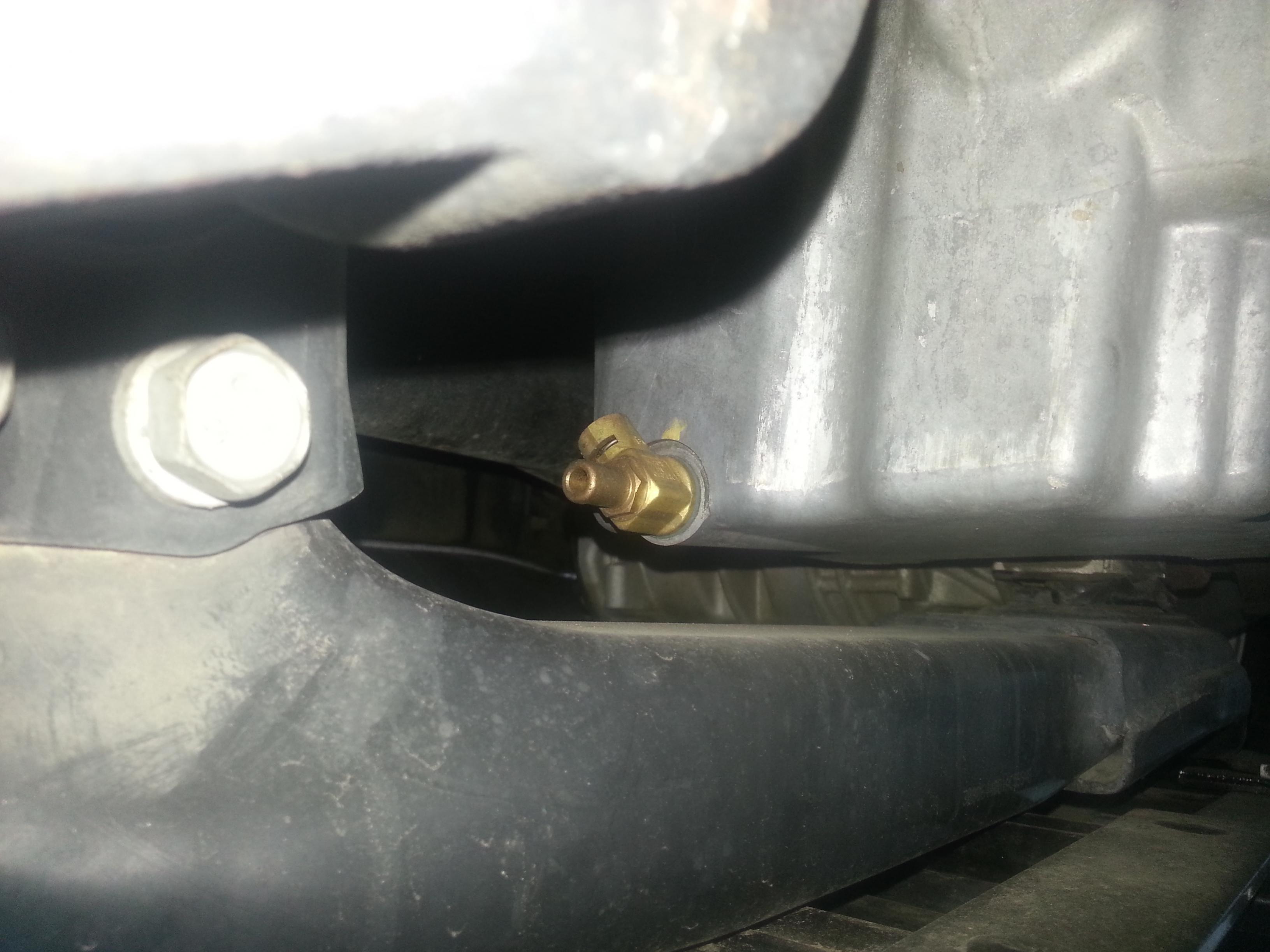

Just a quick follow up. I got my valve a couple days after ordering and installed it a few days ago. Using my lightning fast hands (and a few paper towels) I was able to pull the drain plug out and put the valve in without making much of a mess. Considering the huge chunks of dirt lodged between the oil pan and the UCP, I'm glad I got the cap for the valve I think it was about $1 extra and the sent me two. Skip on their hose clamp lock. There is not enough space to slide it on between the valve and the oil pan. My valve is turned about 45 degrees further than rascole's so I'm not very concerned about anything catching on it but my put a worm clamp on it for good measure. I had about 800' of 3/8" ID Bev Tube left over from when I installed my soda fountain that worked perfect to drain in to my drain pan.
