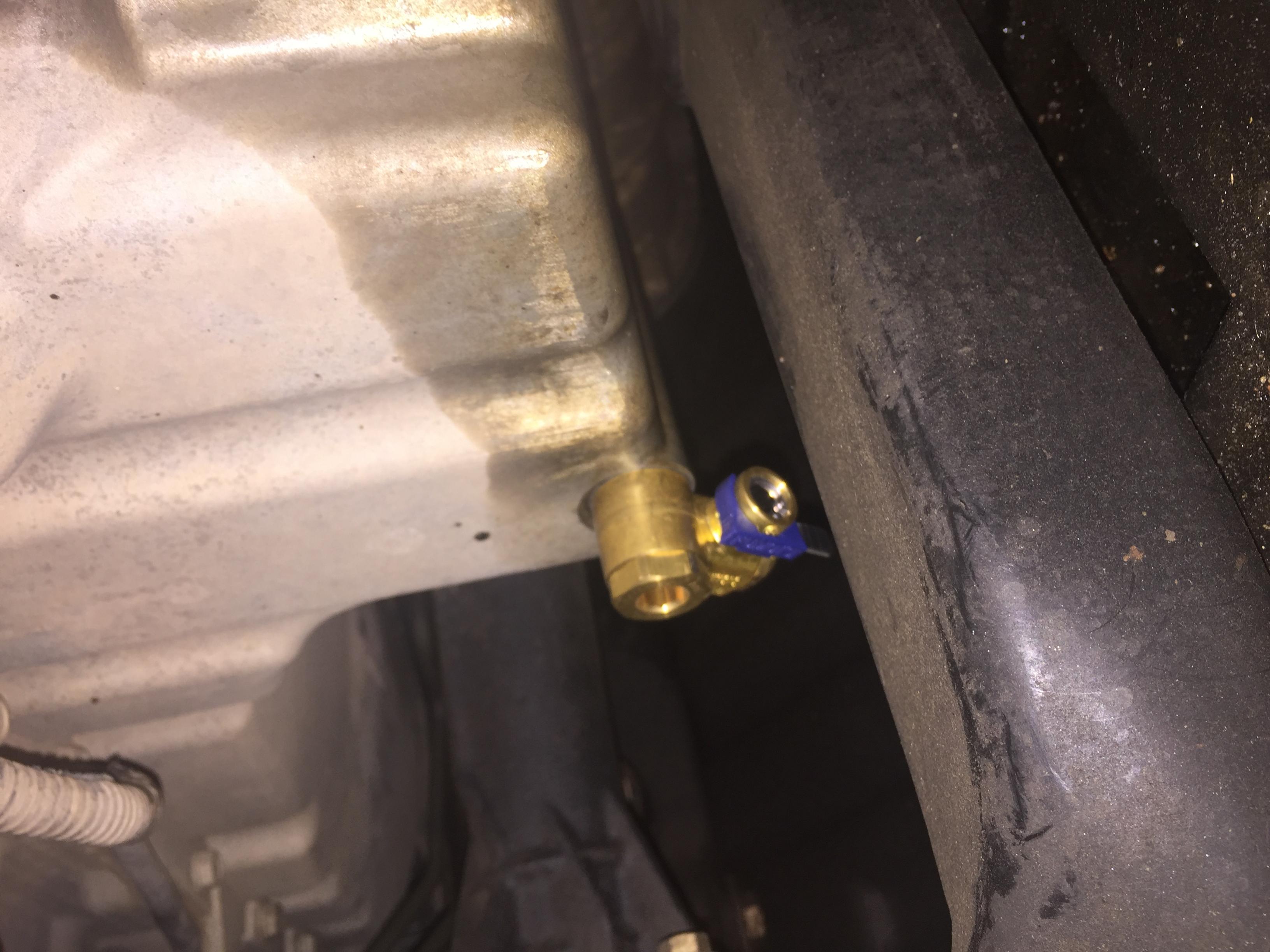

I know this is an old thread. I put one of these on last May. I noticed a lot of oil on the underside. The drive shaft has a nice coating.
I'm going back to the plug. It will take far less time than cleaning the oil from the underside.
Are you sure the oil came from the plug? I have had these on at least 10 car and trucks with no issues. They do make caps to cover the valve.

The oil stain starts at the plug hole and travels back. Look at the photo and tell me what you think. Less than 1000 miles traveled since the installation of the fumoto.

Looks like it is leaking around the gasket area and not the valve. Next oil change replace the gasket, they're cheap at every parts store.

I will have to look at mine, but yours looks clocked differently than what I remember. Sure it doesn't just need tightened or some thread sealer?
2,852
I always apply a small amount of teflon thread sealant. I believe that the drain plug is a straight thread and relies solely on the gasket for sealing. A bad gasket will easily leak no matter how hard you torque it.

I looked at the Fumoto website, looks like you did not install it with the valve in the right direction. Yours is a new style and the instructions are different the the standard 107 like I have. But definitely replace the gasket.

I realized later that you had the new style which was what threw me. I don't know what I was thinking with my earlier post, but the other guys were right-- sealant won't do anything on straight threads. The torque will matter though if it's not tight enough. I still think your on the right track-- get a new gasket. I really love these valves and have never had an issue.
