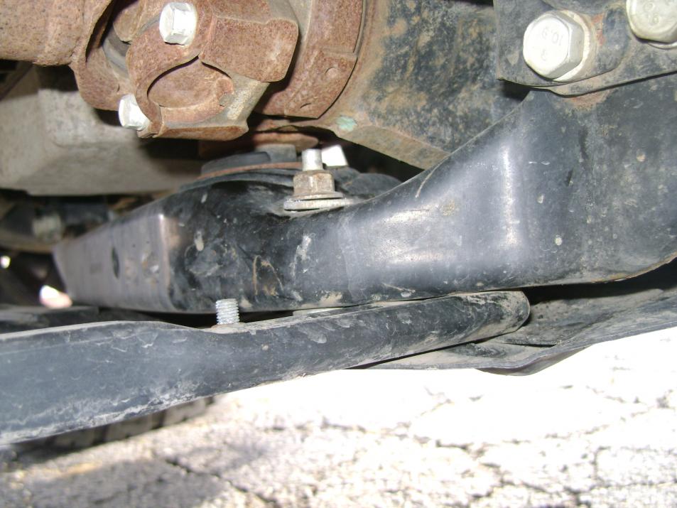

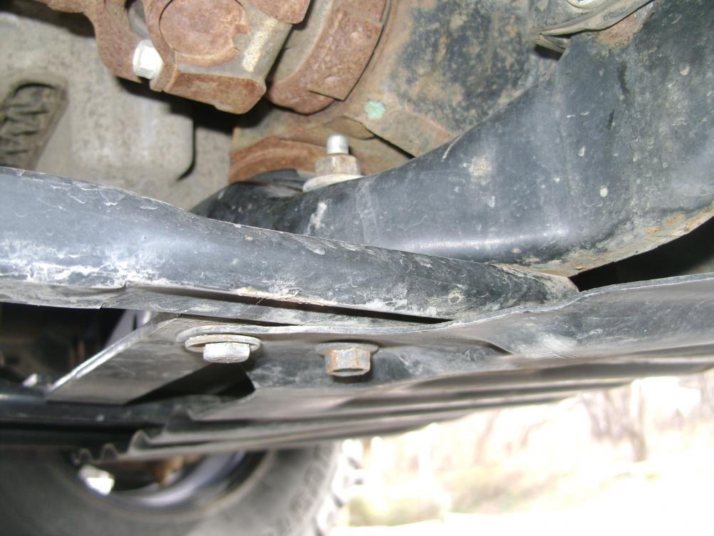

DSC00824.jpgDSC00825.jpgThe dealer did this to my 2010 T with the newer style crossmember. The nut welded in the crossmember broke loose inside the crossmember.... so they drilled through it and bolted it in. Seems to work OK.

Umm...they unbolt the nut and bolt they added?, just has a nut on the top instead of welded inside the crossmember. If you see an issue with it let me know so i can go have em' re-fix it, my T is still under b2b waranty. I have had my oil changed since then and had no issues...also Im going to get an older stlye cross-member redone from Preferred Chassis Fabrication for when this one dies. :corn:

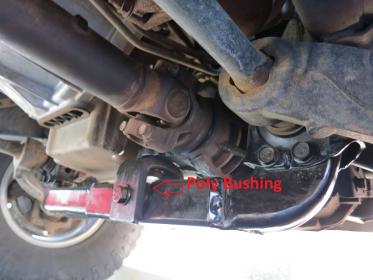

Here's mine. Welded a straight section of square tubing into the cross member and drilled a 1-1/4" Hole sideways, welded a piece of 1-1/4 round tubing into that hole, ground everything flat, press-fit a polyurethane bushing, attached a U-bracket onto the diff and then sent a 5/8" bolt through the crossmember tube on the inside of the bushing. The old design that everyone has been using is basically a thrust bearing/bushing made out of rubber. This method allows the same degrees of freedom and uses the wall of the bushing as a support.
Nice Fab Work!
