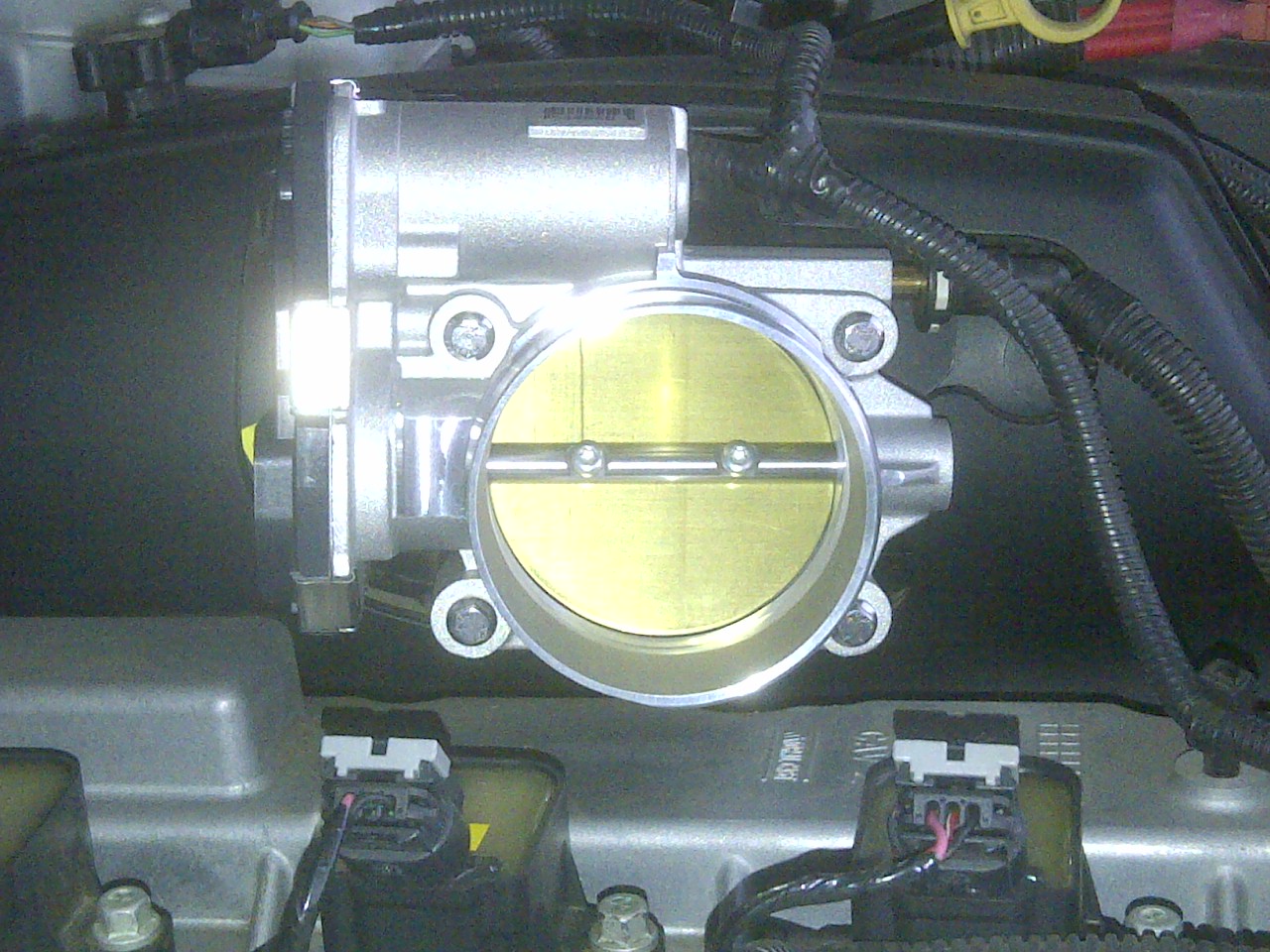

Replacing the throttle body is probably one of the easiest maintenance jobs on these vehicles. You have to watch the white retaining clip on the elec. connector. If it wasn't for the fact that the electronic throttle position sensor is integral to the throttle body the whole unit wouldn't have to be replaced. That's all there is to it.
