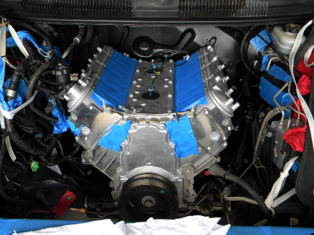

I've got to say this; I'm looking at that engine hanging on the hoist with no intake manifold and all the harness coiled up in the lifter valley and I'm thinking you're just asking for trouble. Some little part will so easily slip in to the cathedral intake port that you never noticed and kill that engine the first time you try to start it up. These LS engines are so UN-like the old cast-iron GM engine blocks it's not funny. I've known too many guys that regretted not stuffing a rag in the top of a manifold when they removed a carb and lost a nut, washer, screw, whatever and had to tear down the top end of an engine to chase some stupid little morsel. Don't let it be you!
Like that....
9,513
I thought about it and didn't do it but your exactly right. Why take any chances...I'll throw tape on it ASAP
