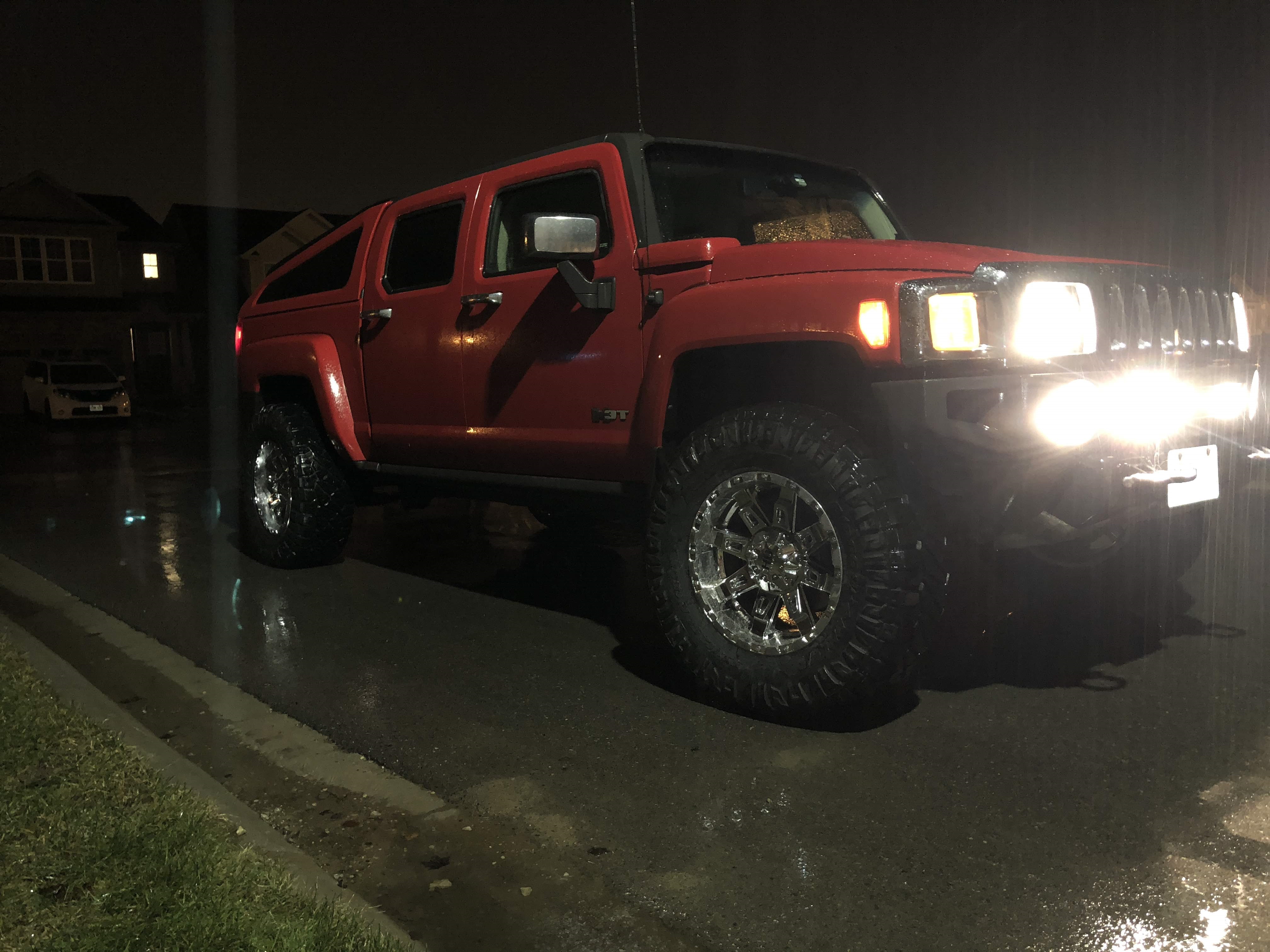

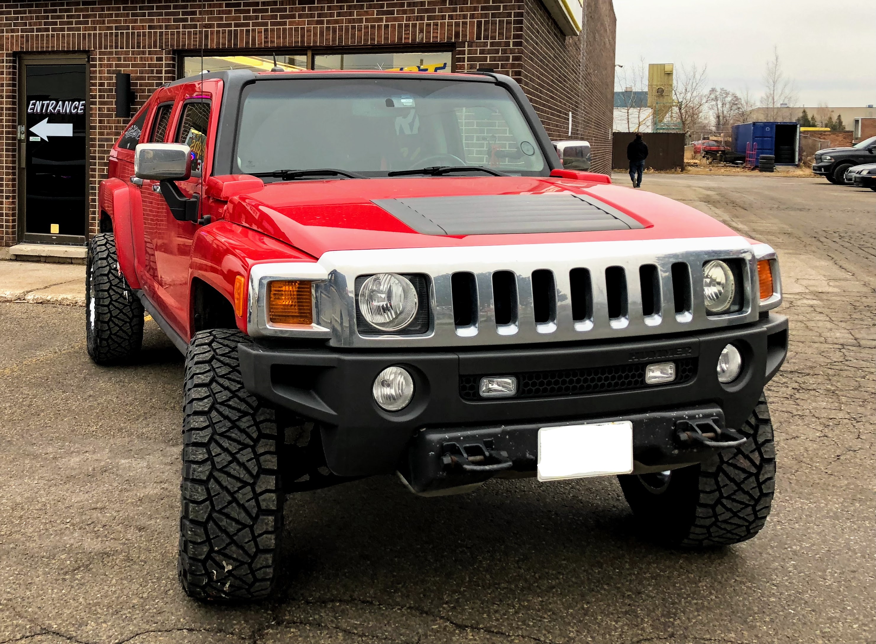

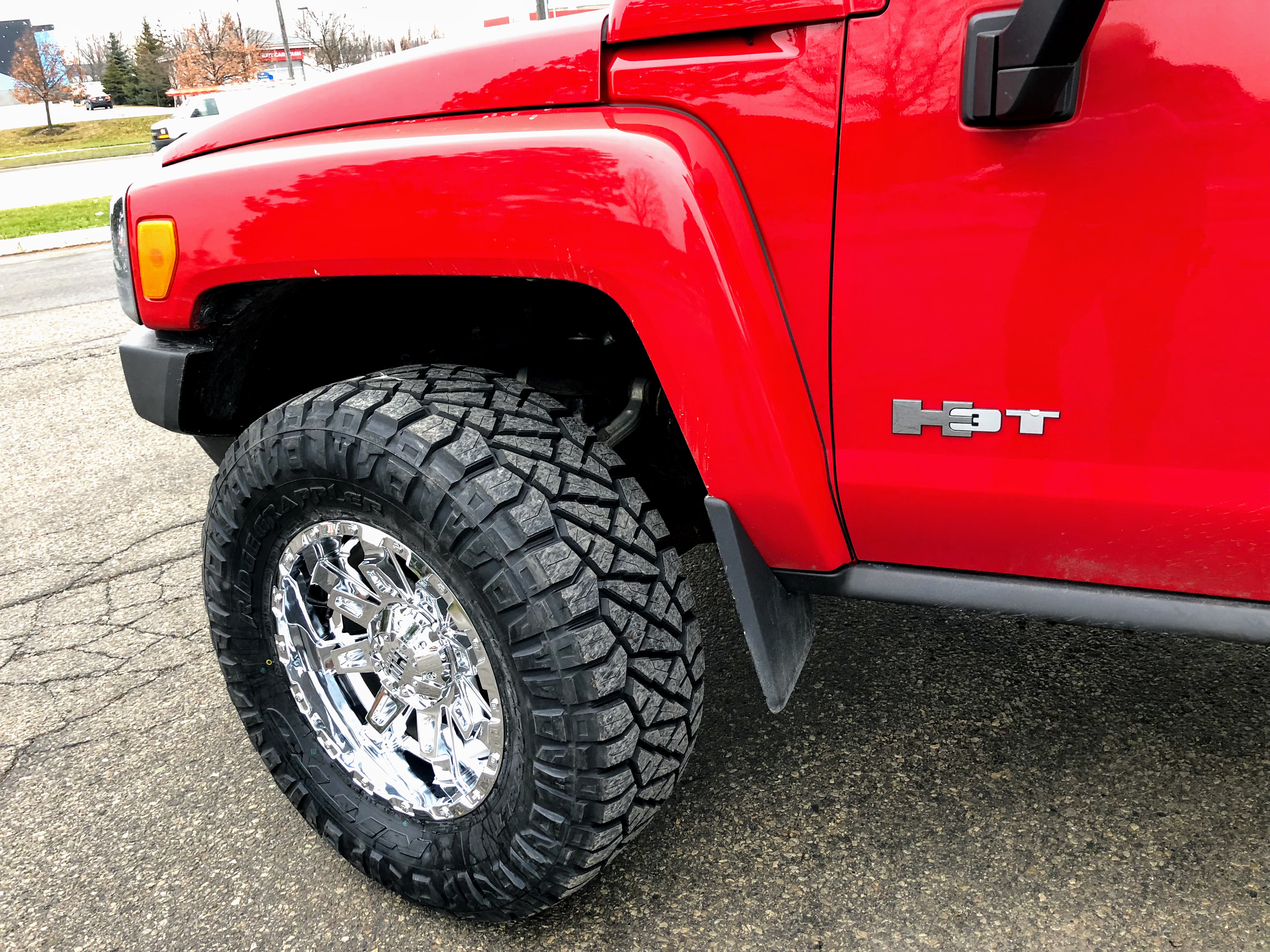

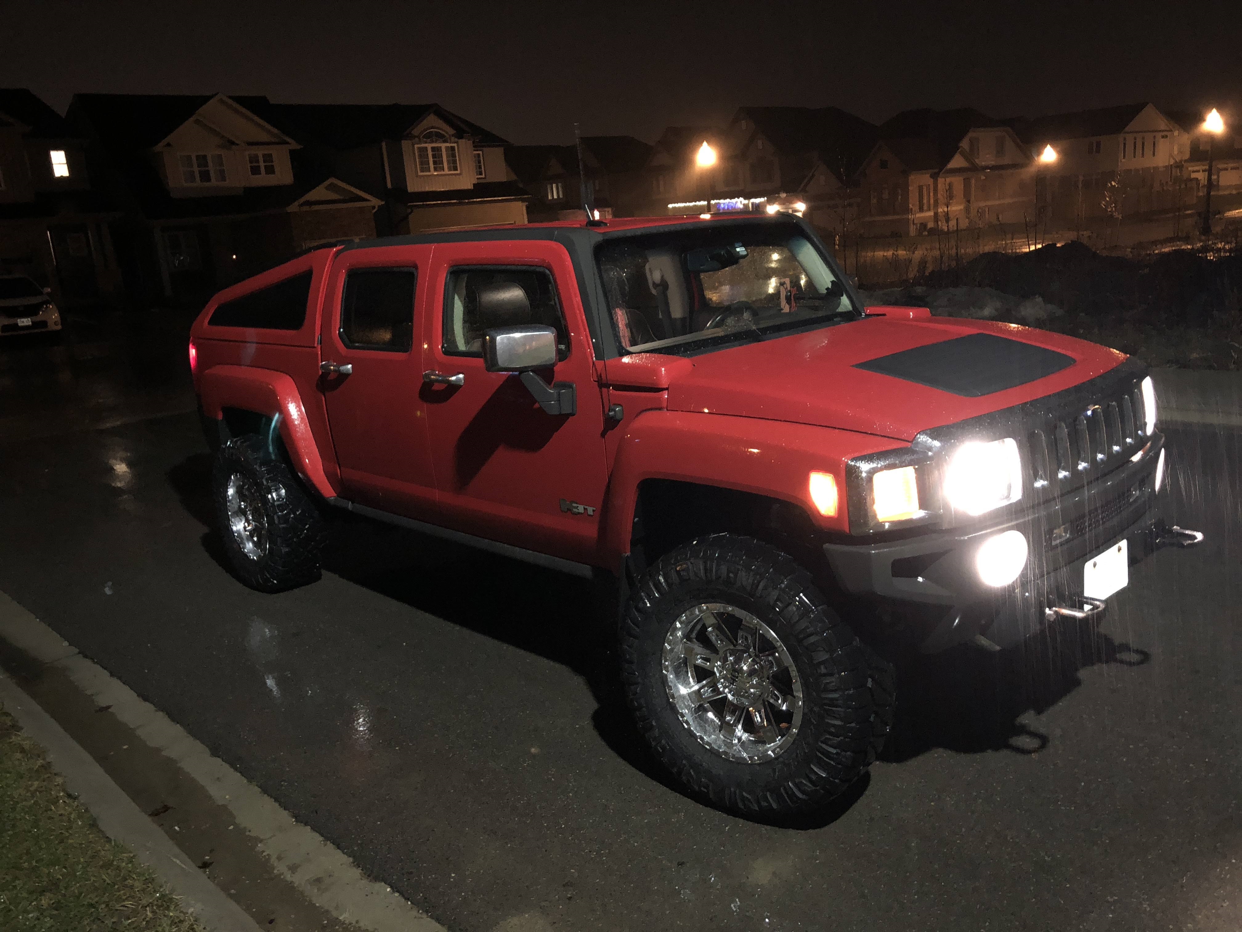

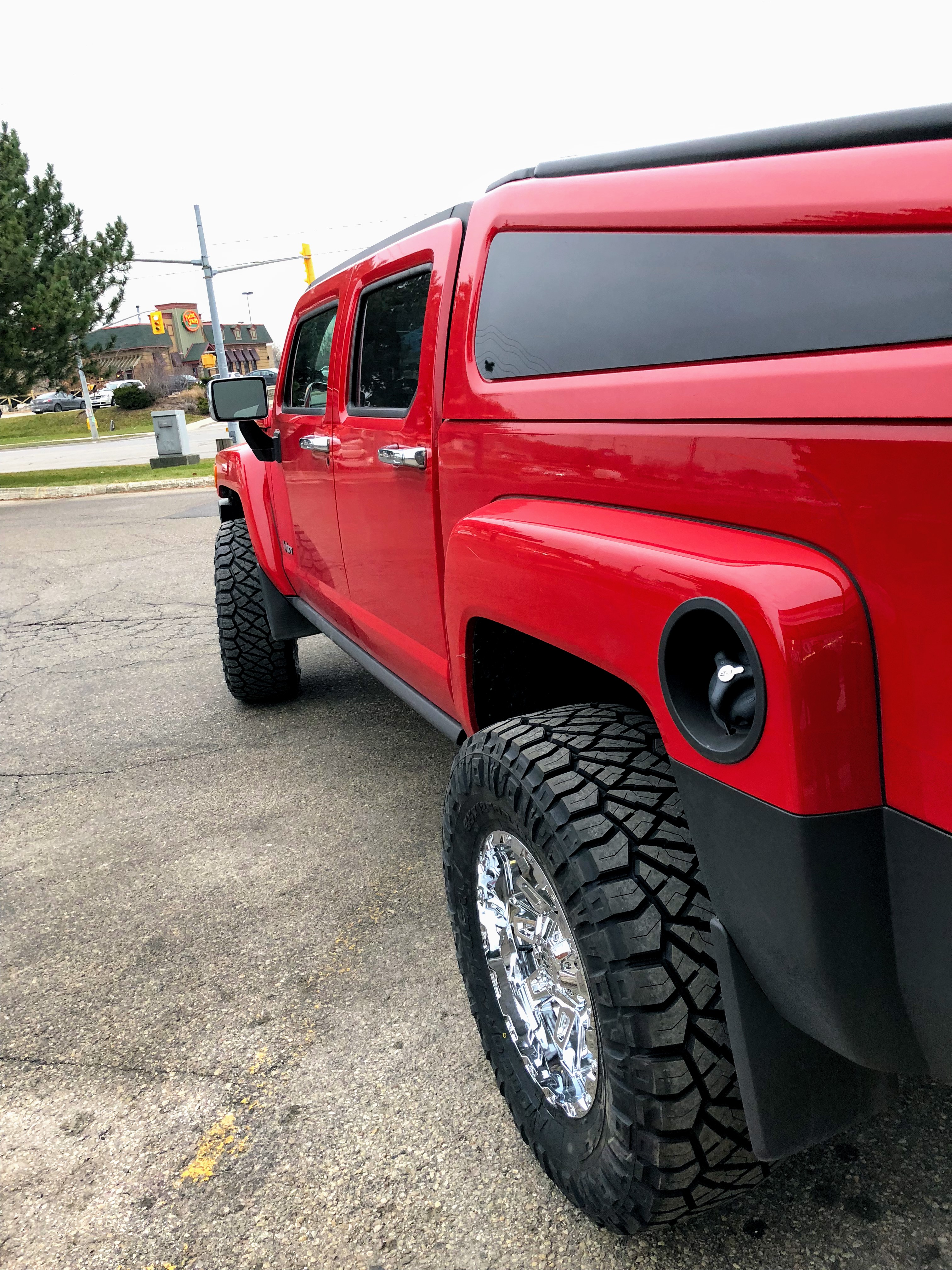

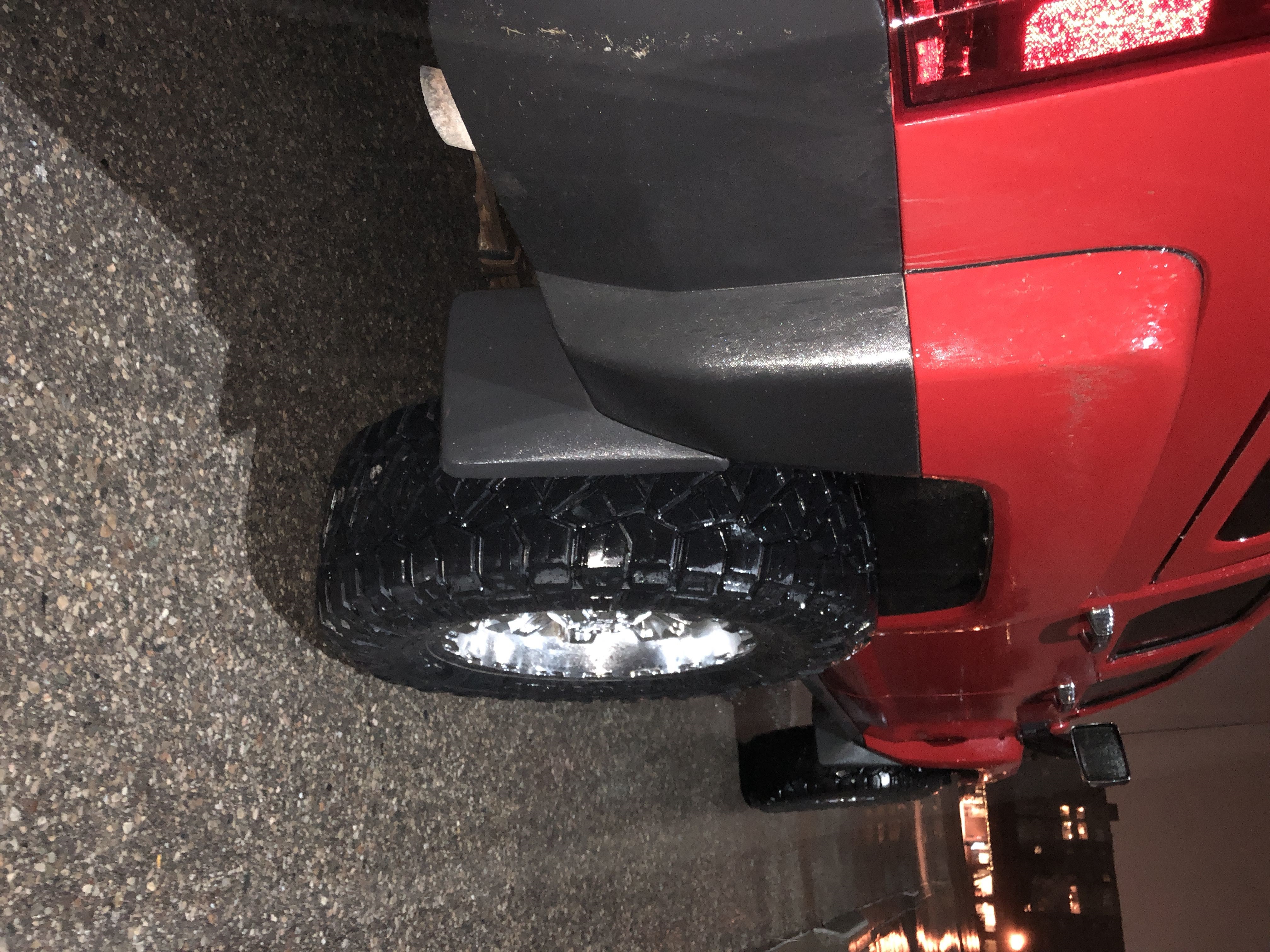

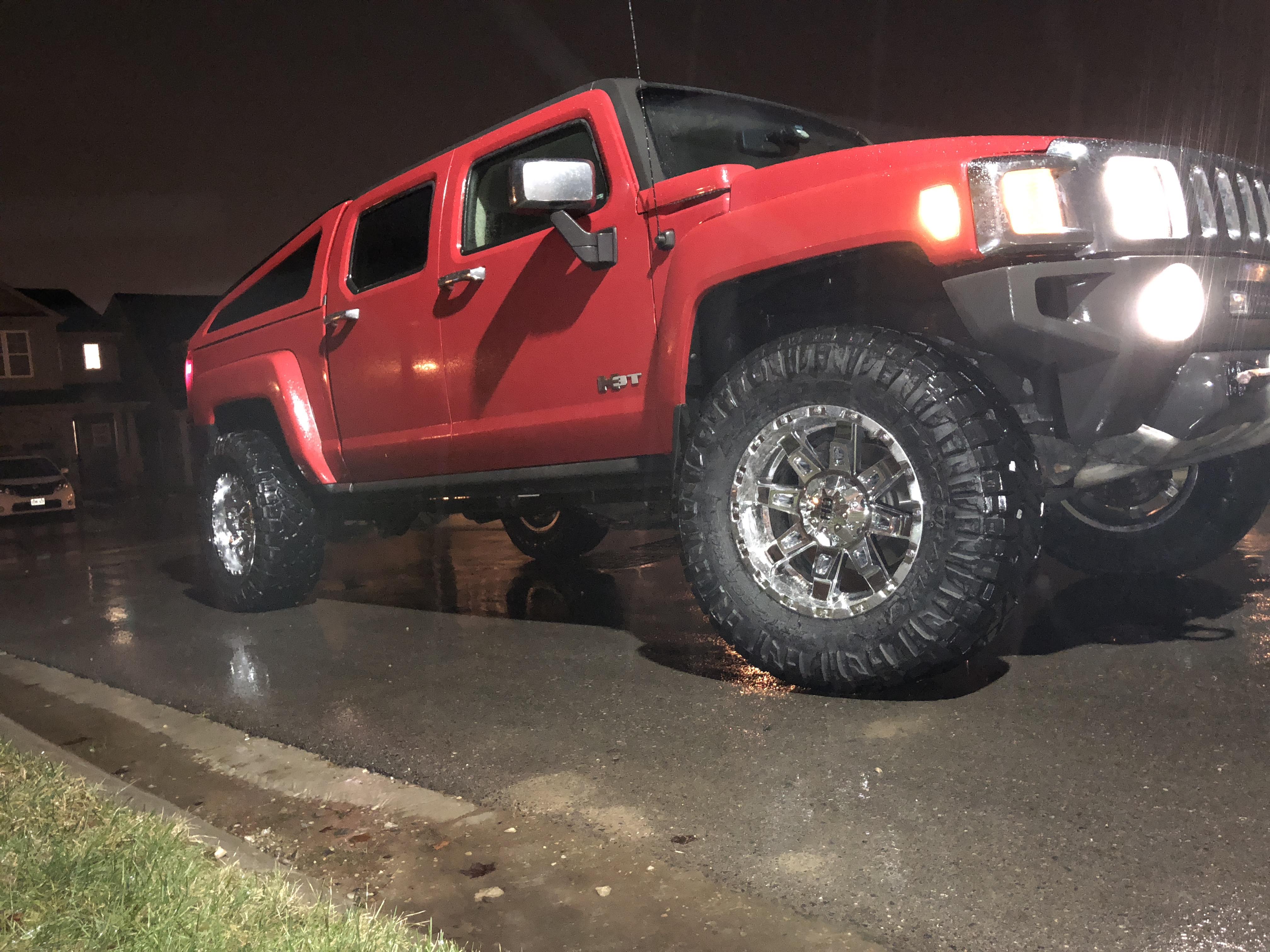

H3T Sure doesn't look like 35s fit...

why not just have them mount wheels that fit properly?
I blame Custom Offsets for their propaganda on 'stance' for that.
After nine years I wanted to shake things up a bit - looked at hundreds of styles - couldn't find one with seven spokes in silver/chrome/machined - got hooked on Nitto Ridge Grapplers and that was the end of looking for 16s: they only have 265 or 285 in that size.
Wanted a more 3D style without sacrificing too much sidewall - these were the best I could find (that I liked) quickly - when we found out they only had a +15 offset...that we might have to move them out a bit...well that brain washing kicked in: "stance".
They're also 'temporary' in the sense they won't last more than two or three seasons with the sort of salt-bath they get subjected to up here.

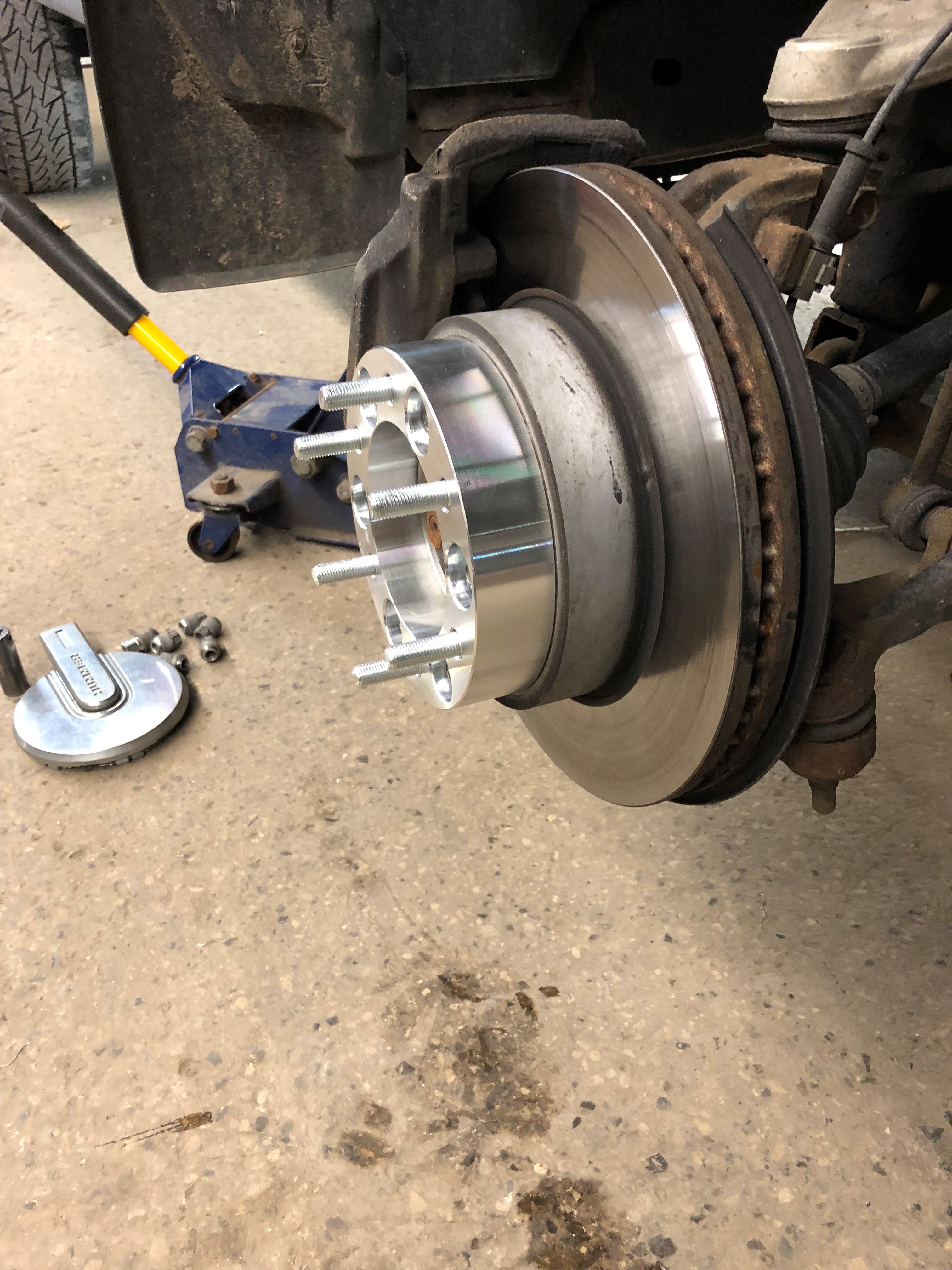

Temporary might be a good term to describe the wheel bearings, half shafts, steering rack, and ball joints too with the added stress. :) Hopefully you used a high quality wheel spacer on a near 3 ton vehicle, lot of shear stress on those lugs.

6061-T6 Aluminum, I believe, from the same Canadian manufacturer as the wheels, Fast co, (branding accessories as Dailyn since 2018) 77339 Thickness: 1.50"/38mm Center Bore: 108.0 Vehicle: 6x139.7 Wheel: 6/139.7mm Thread 12x1.50mm

Now... without further delay (it's only been 9 years...) let's see some H3T tire porn!

That does not look much worse than mine.
Been running that way since I bought the rig in 2010.
However, I did have to replace the front bearings a couple of years ago IRC.
