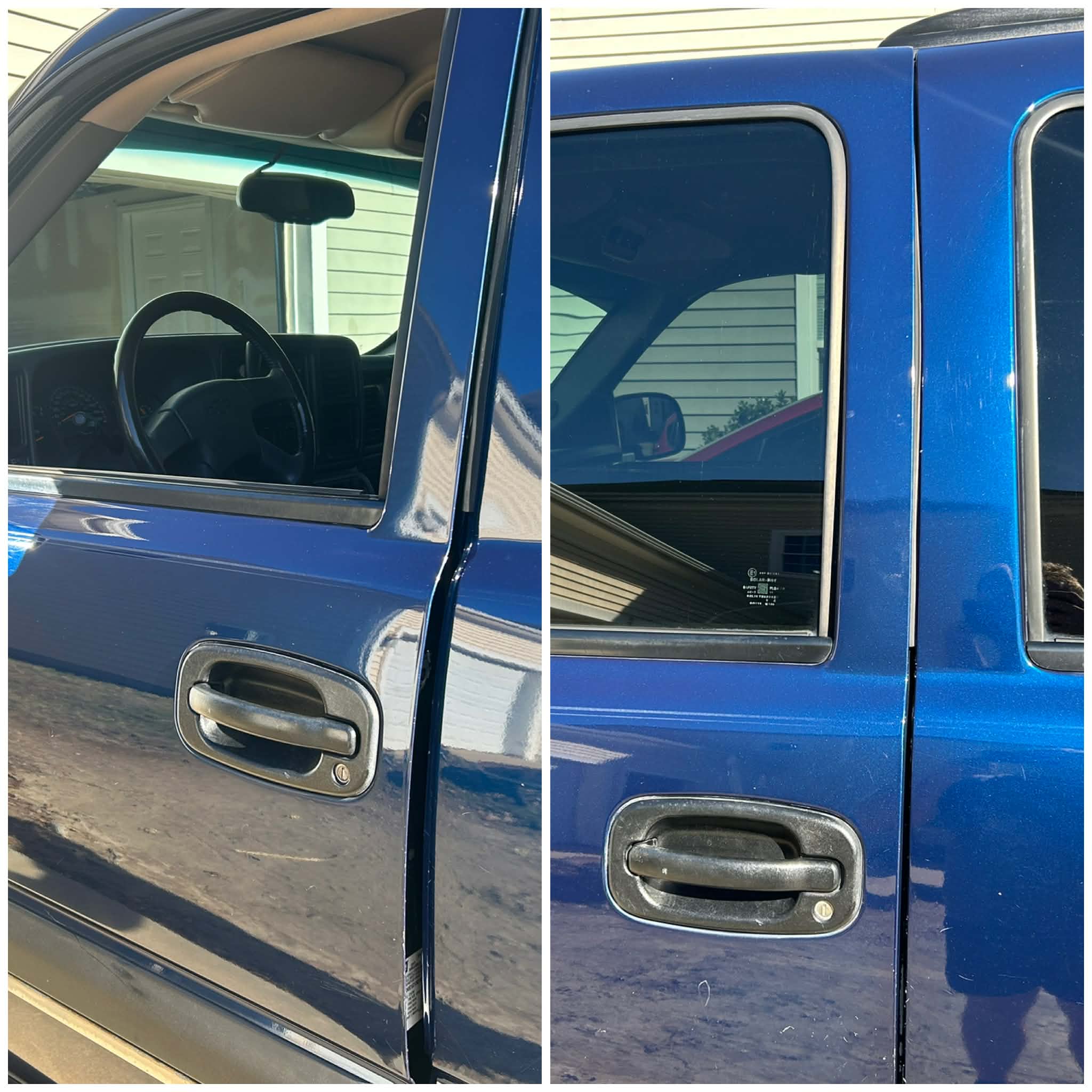

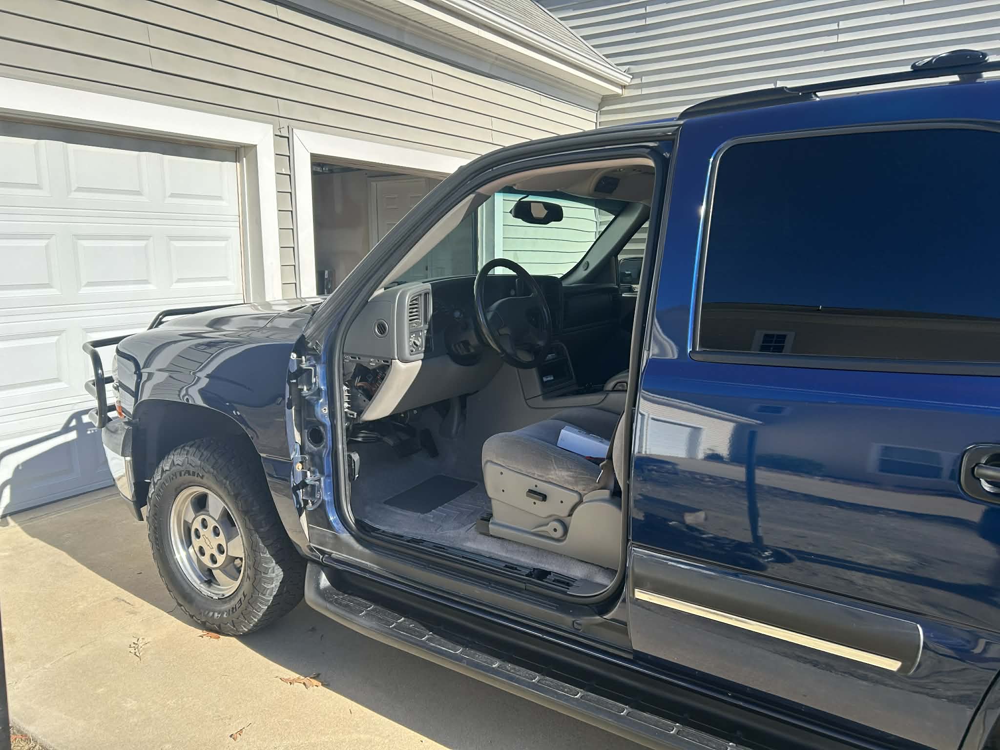

-Replaced driver door hinge pins. After 23 years of use the door was starting to sag a little. Really stood out after I installed the WeatherTech floor mats which overlap on the door sill plate a little. Whatever clearance there was between the bottom of the door panel and the sill plate was now gone due to the floor mat and the aging door pins stood out like a sore thumb. Door sag is now gone and closes like it should! (Endurapin NBS Kit)
new-and-old-pins-jpg.34421

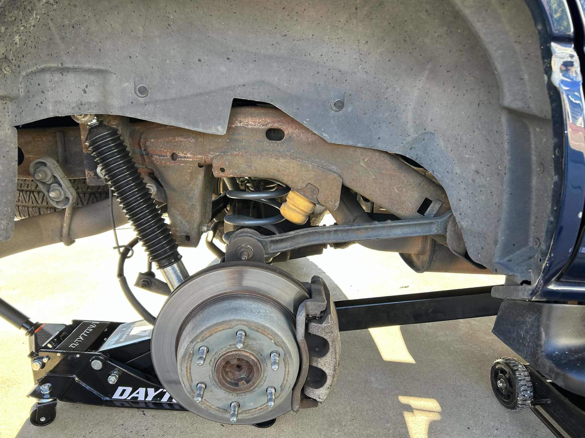

-Upgraded Orielly’s house brand shocks with Bilstein 5100s (BILPN 24-186643 [front] / 24-187237 ([rear]).
-Upgraded OEM rear lower control arms with upgraded Hotchkis fully boxed rear lower control arms (HPN 1305).
I was unhappy with the handling characteristics of the Tahoe. I also plan to replace the panhard bar, rear upper control arms and front/rear sway bars with upgraded units. As of now the shocks and Hotchkis trailing arms have made a huge improvement in body roll and keeping the suspension planted when cornering. I can't wait to see how the future upgrades further improve handling quality!

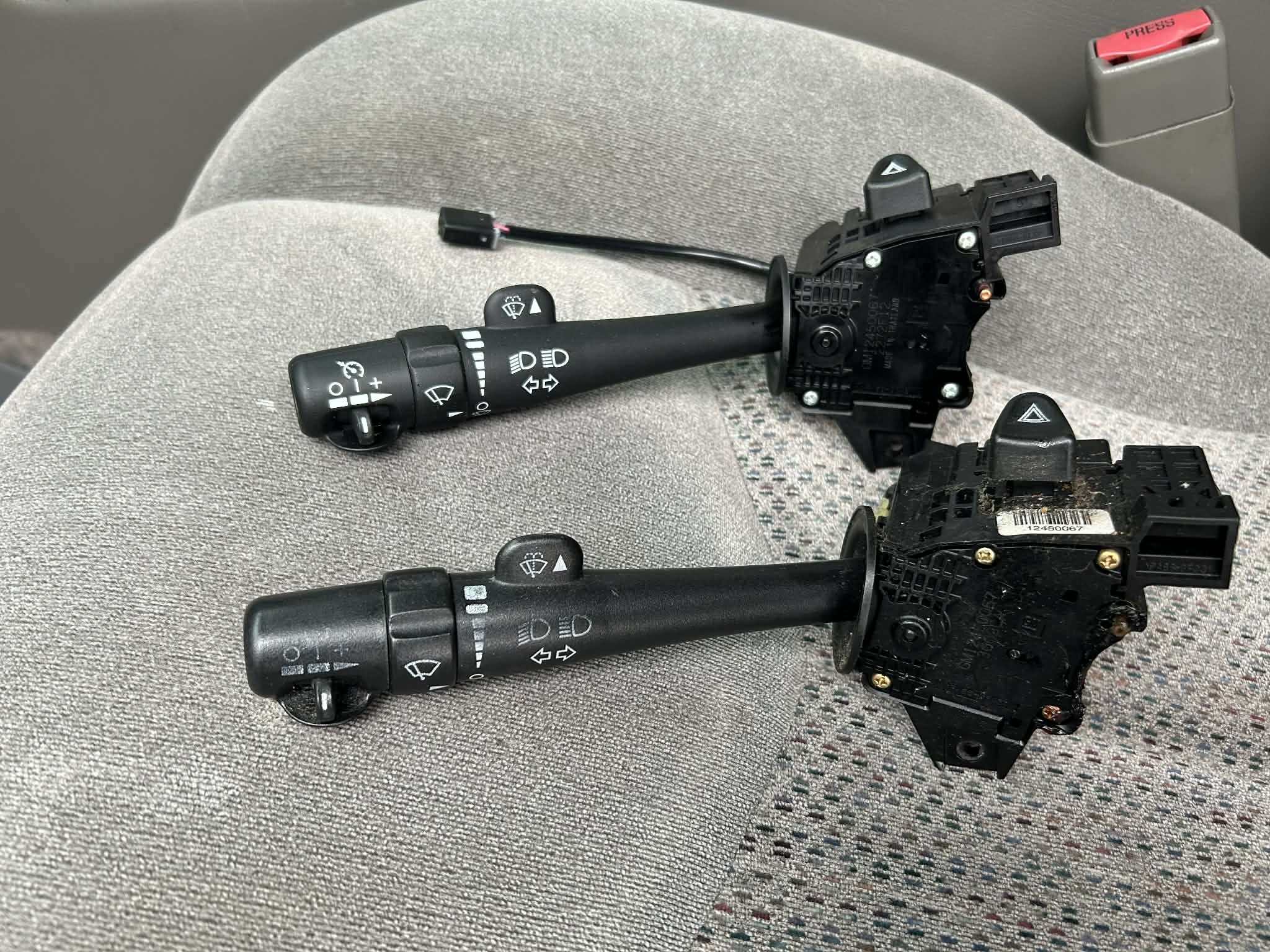

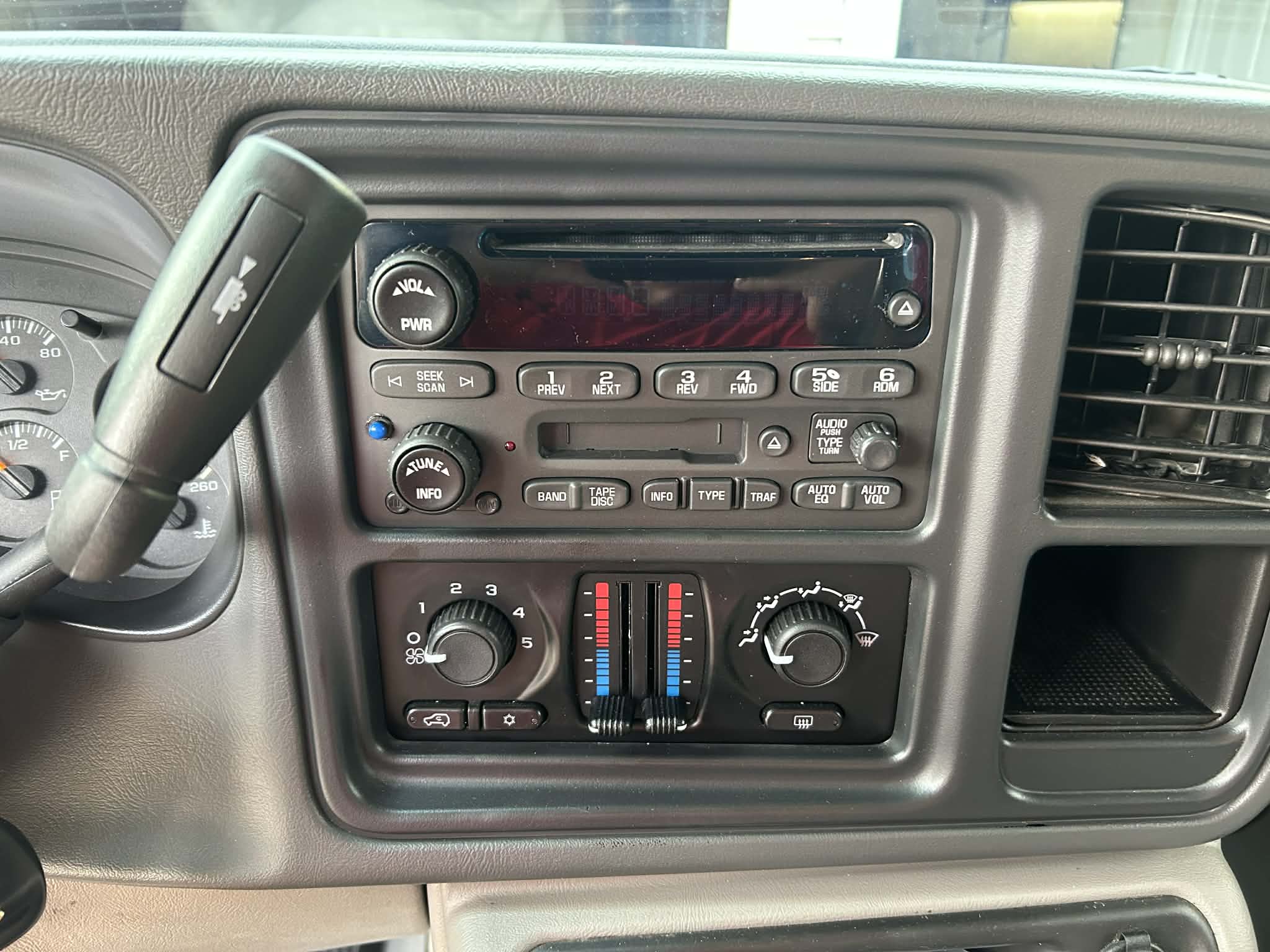

-Replaced gear selector (GM#26075107)-graphics worn-.

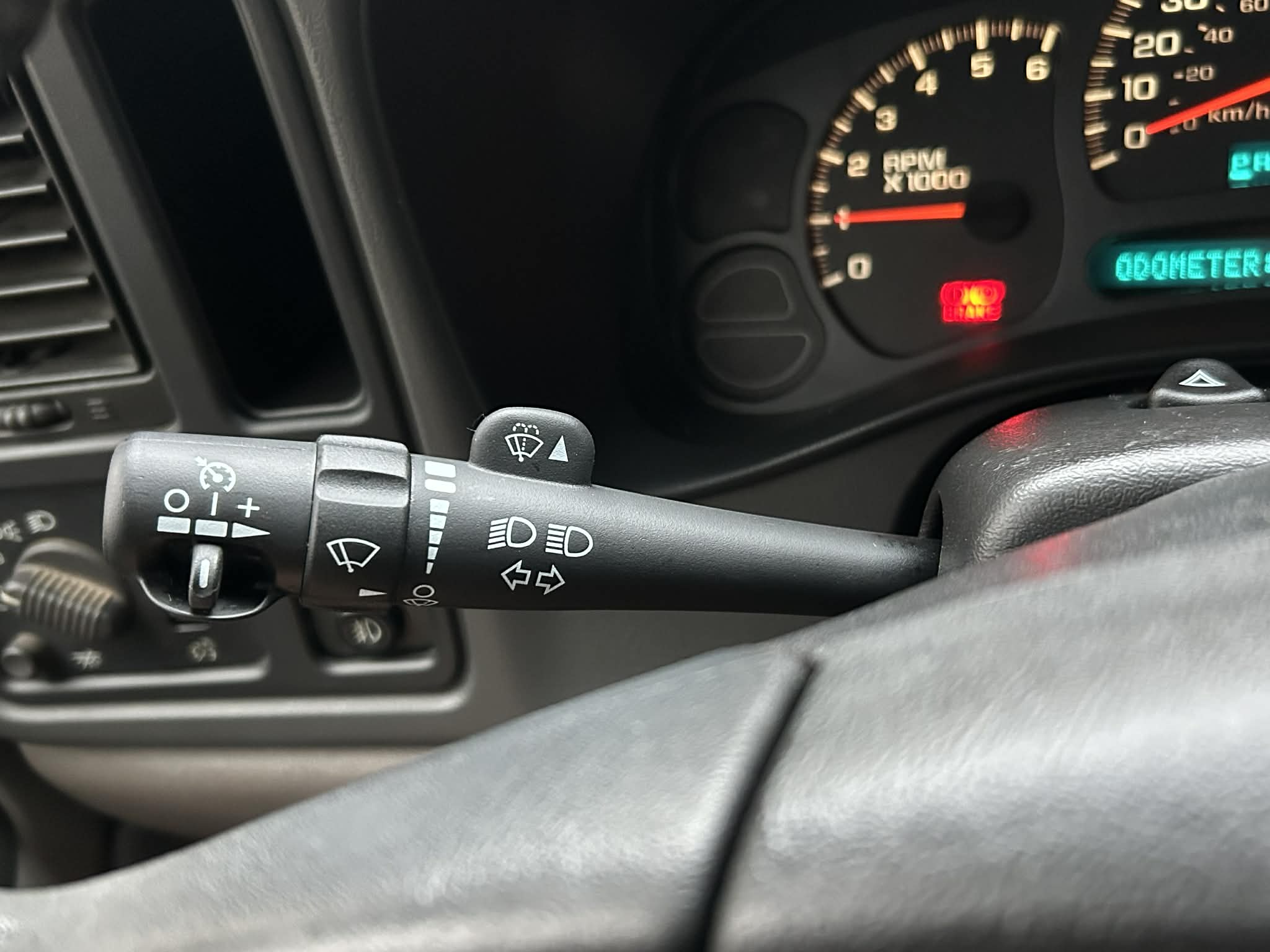

-Replaced multi function switch (GM#12450067)-graphics worn-.
-Replaced park sensor switch (GM#23190137)-intermittently inop-. (had to jiggle the shifter to make the DIC register that the Tahoe was in park electronically)

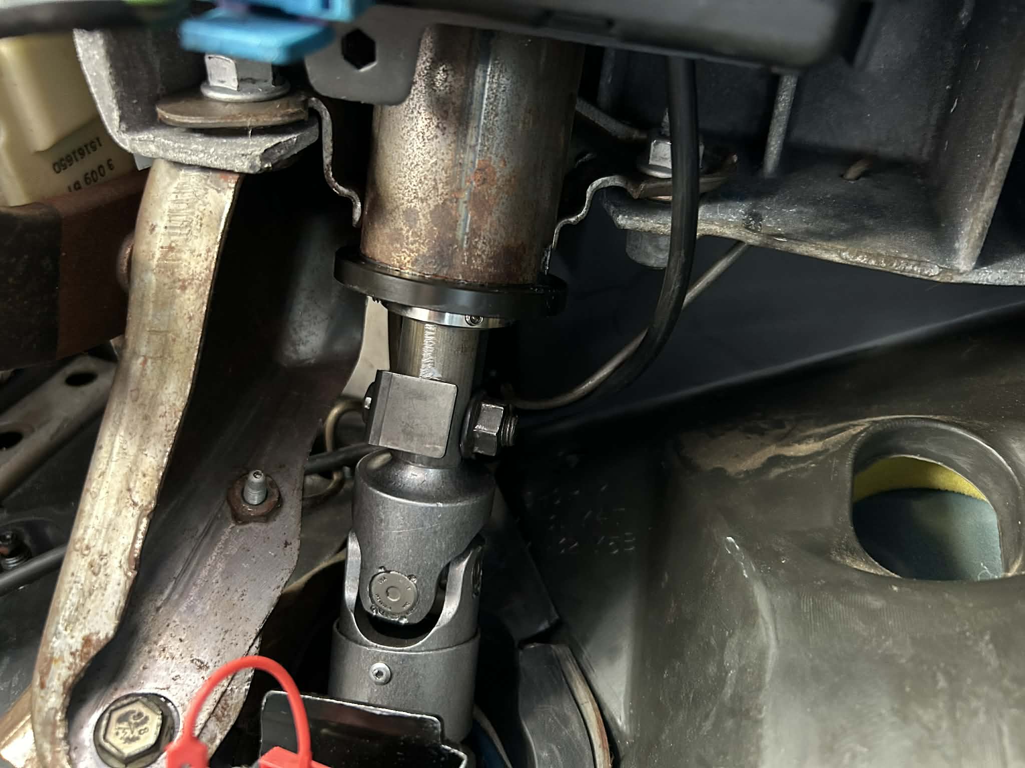

-Replaced lower steering column (GM#85104193)-U Joint was worn-
-Upgraded upper steering column to HD Borgeson unit (B#000937). The Borgeson unit is solid steel and weighs 2x as much as stock. Has a vibration dampener built in. Nice upgrade.

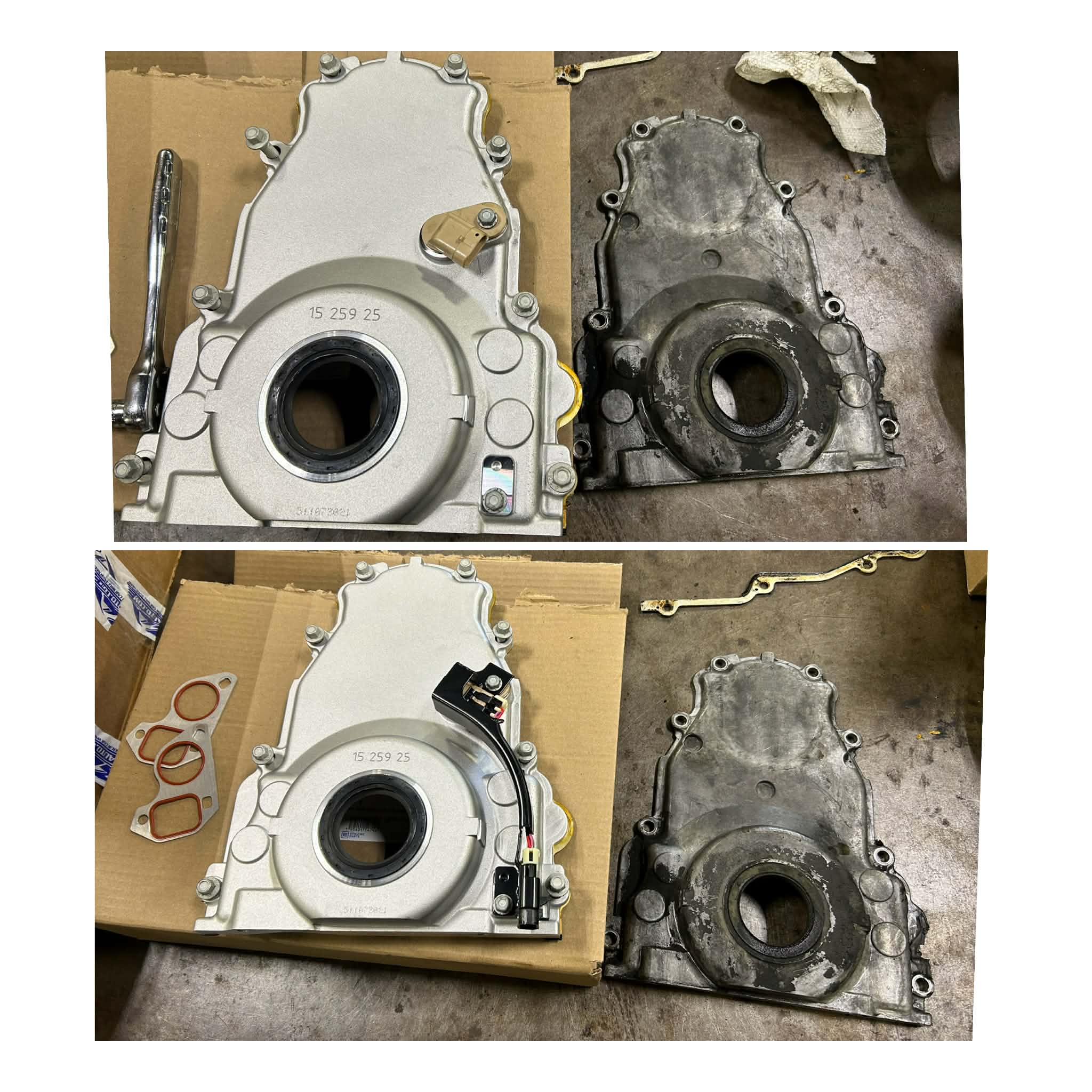

-Replaced timing cover (GM#12633906)-leaking just above oil pan mating point-.
-Replaced harmonic balancer (GM#19300488). .
-Replaced harmonic balancer bolt (GM#12557840)-torque to yield one time use-.
-Replaced water pump gaskets (GM#12559271).
-Replaced coolant (Dex-Cool 50/50 Mix).
*knock on wood* The Tahoe shall stay leak free for a bit.....since I have now replaced every gasket on the engine lol.

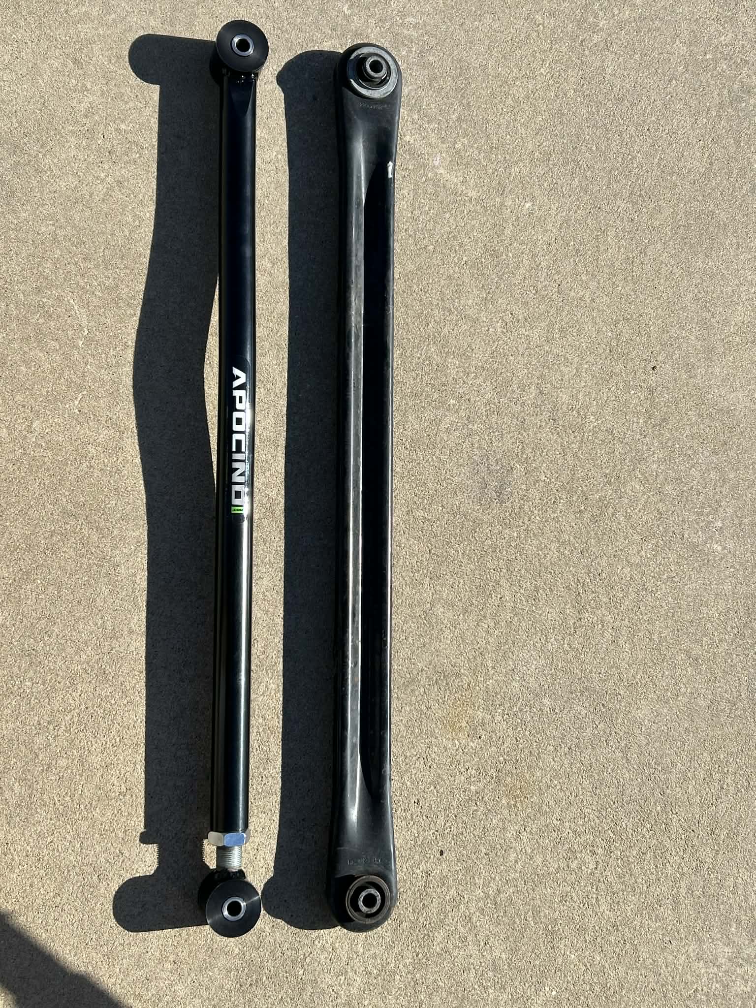

-Replaced OEM panhard bar with upgraded unit that is made from solid steel rod from APOC Industries (A#AP-500-101). The aftermarket unit weighs 10.2lbs more than the OEM equivalent and has helped stiffen up the rear end a little bit. Also added some 90* grease fittings so I can service the panhard bar without having to uninstall it every time. I'll go back and add some 90* fittings to the rear lower control arms soon. Forgot about those.....

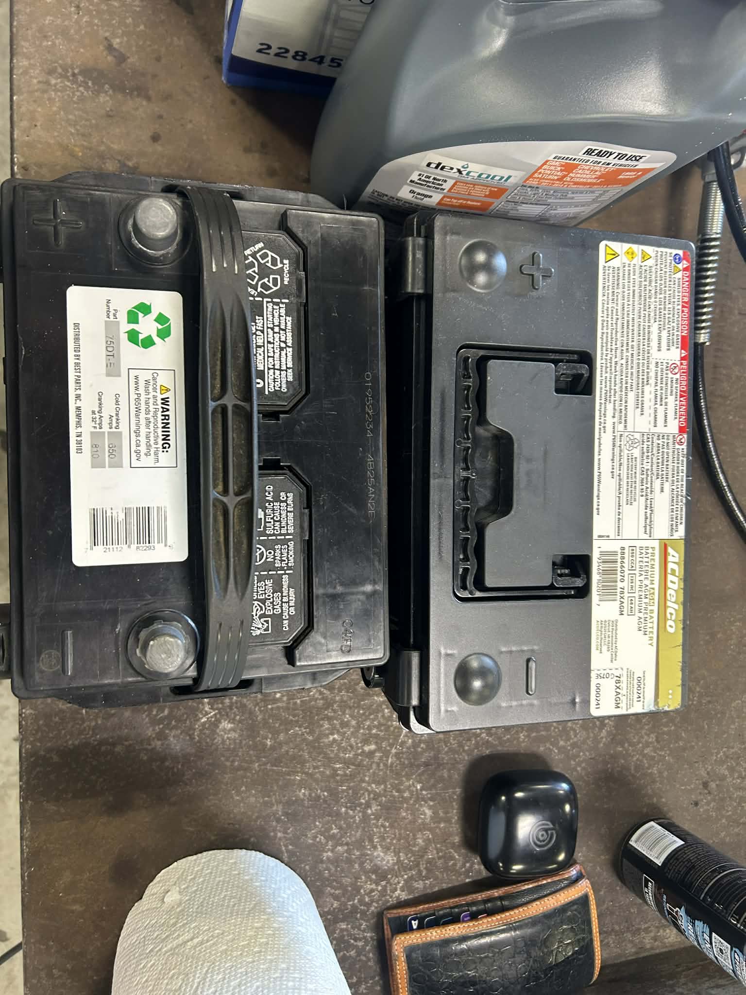

A cold snap caused me to look into the charging system. The Tahoe is very slow to start at sub-20 degree weather. Turns out the previous owner installed a battery that is incorrect for the vehicle. I replaced the alternator too for good measure, and am keeping it as a spare.
-Replaced battery (GM#88866070). Old aftermarket unit was inadequate for the vehicle (old CCA = 650, OEM = 850).

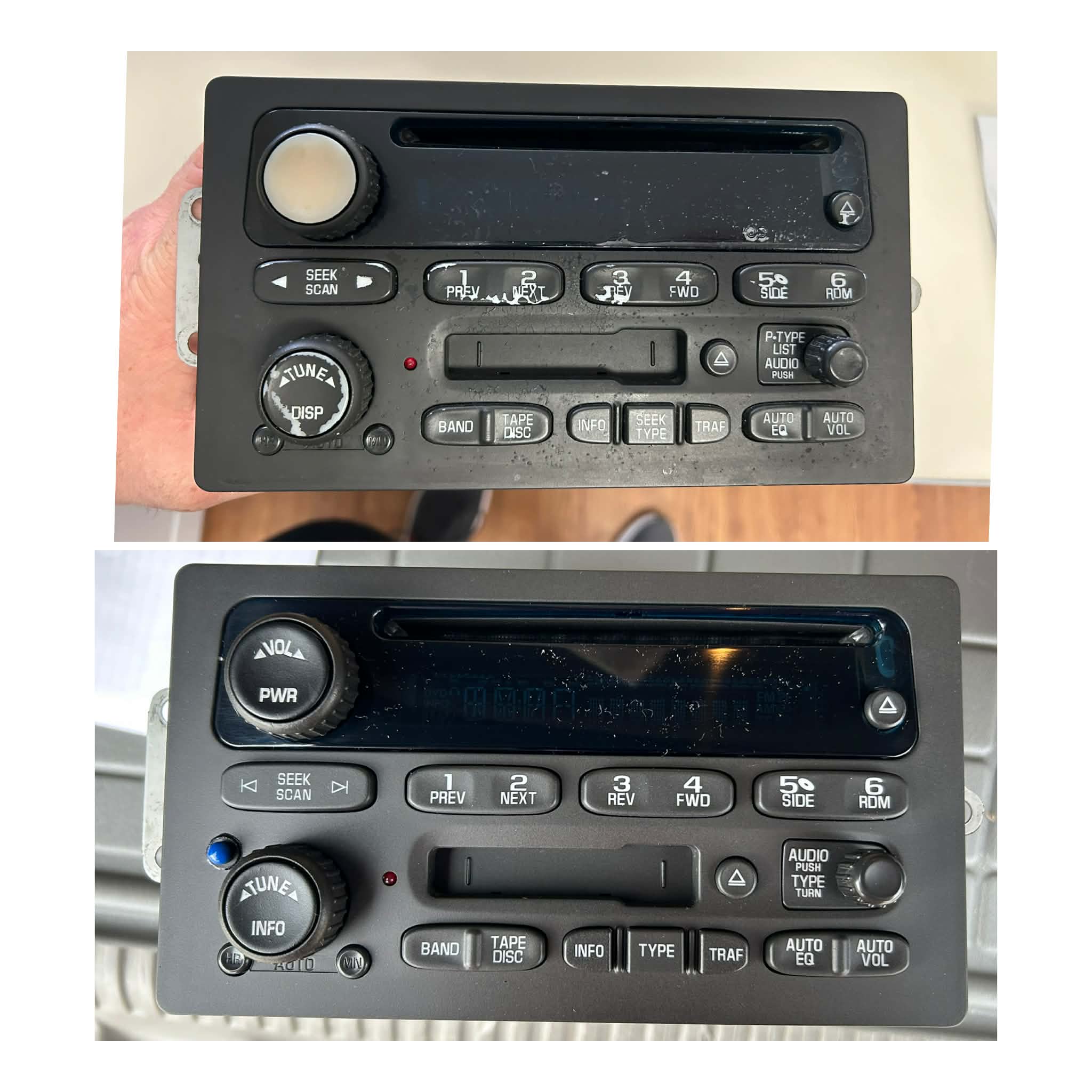

Rebuilt:

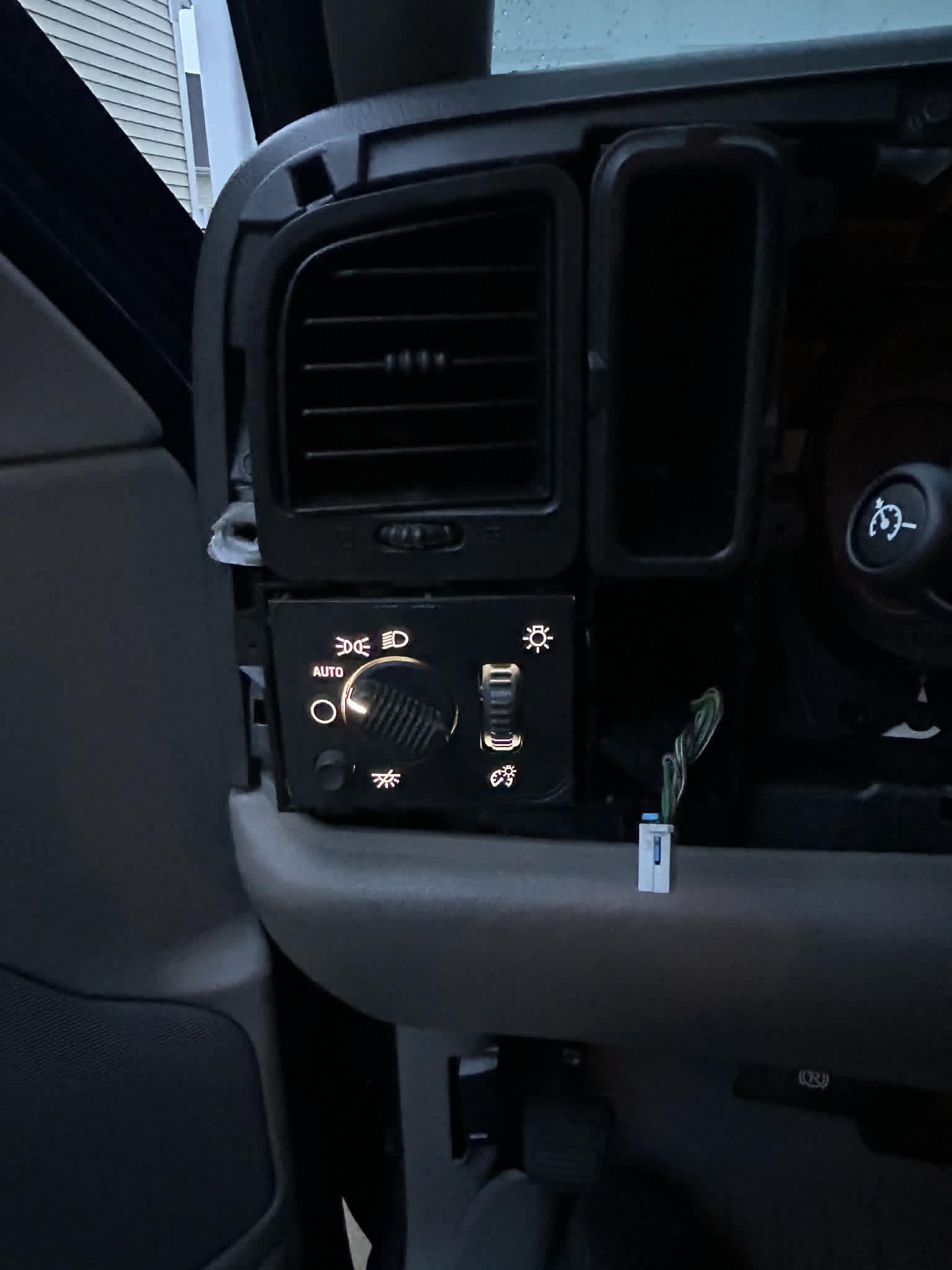

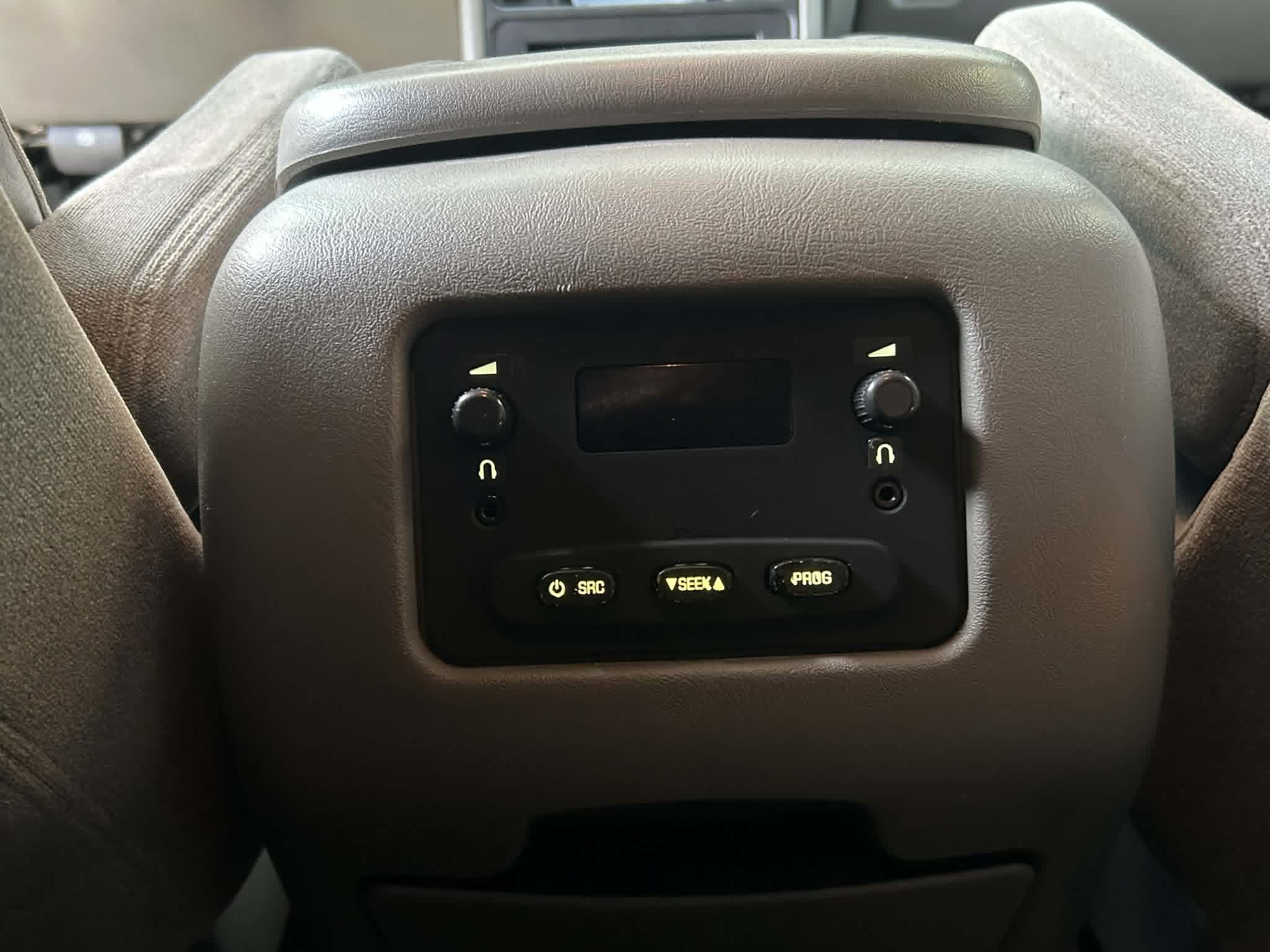

-Dimmer switch (GM#19381535-Fitts Cluster Repair) -burned out bulbs, upgraded to LED and added two extra bulbs for additional lighting-.
-Rear radio control module (GM#10358082-Fitts Cluster Repair)-burned out bulbs-.

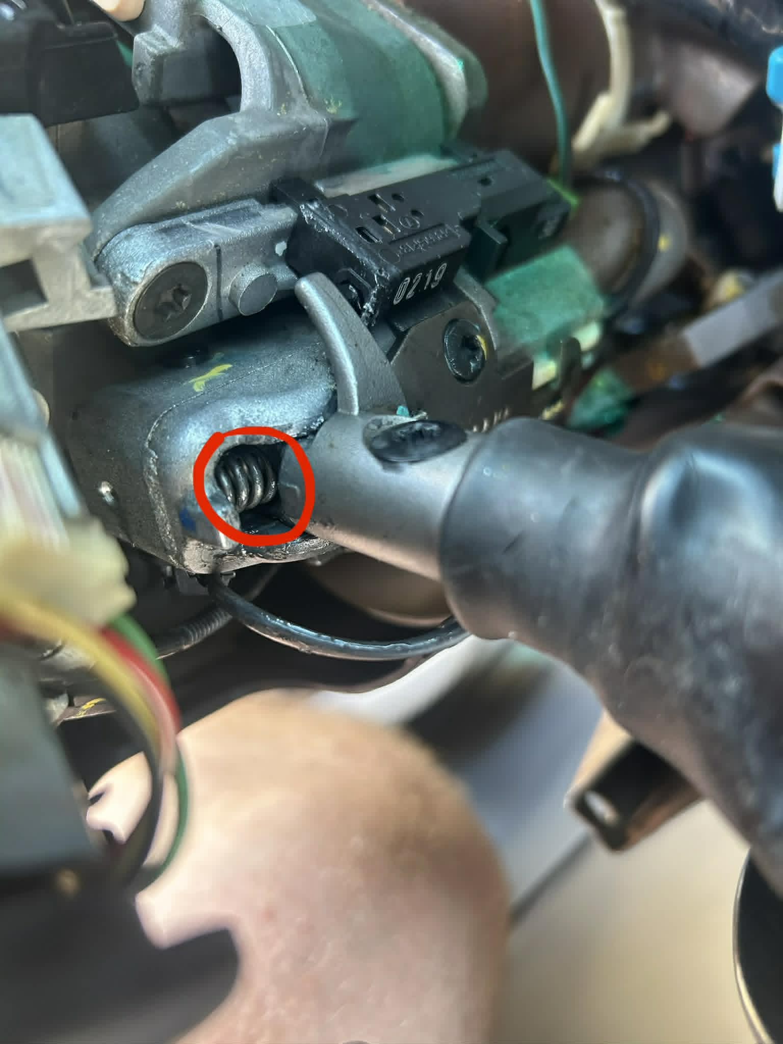

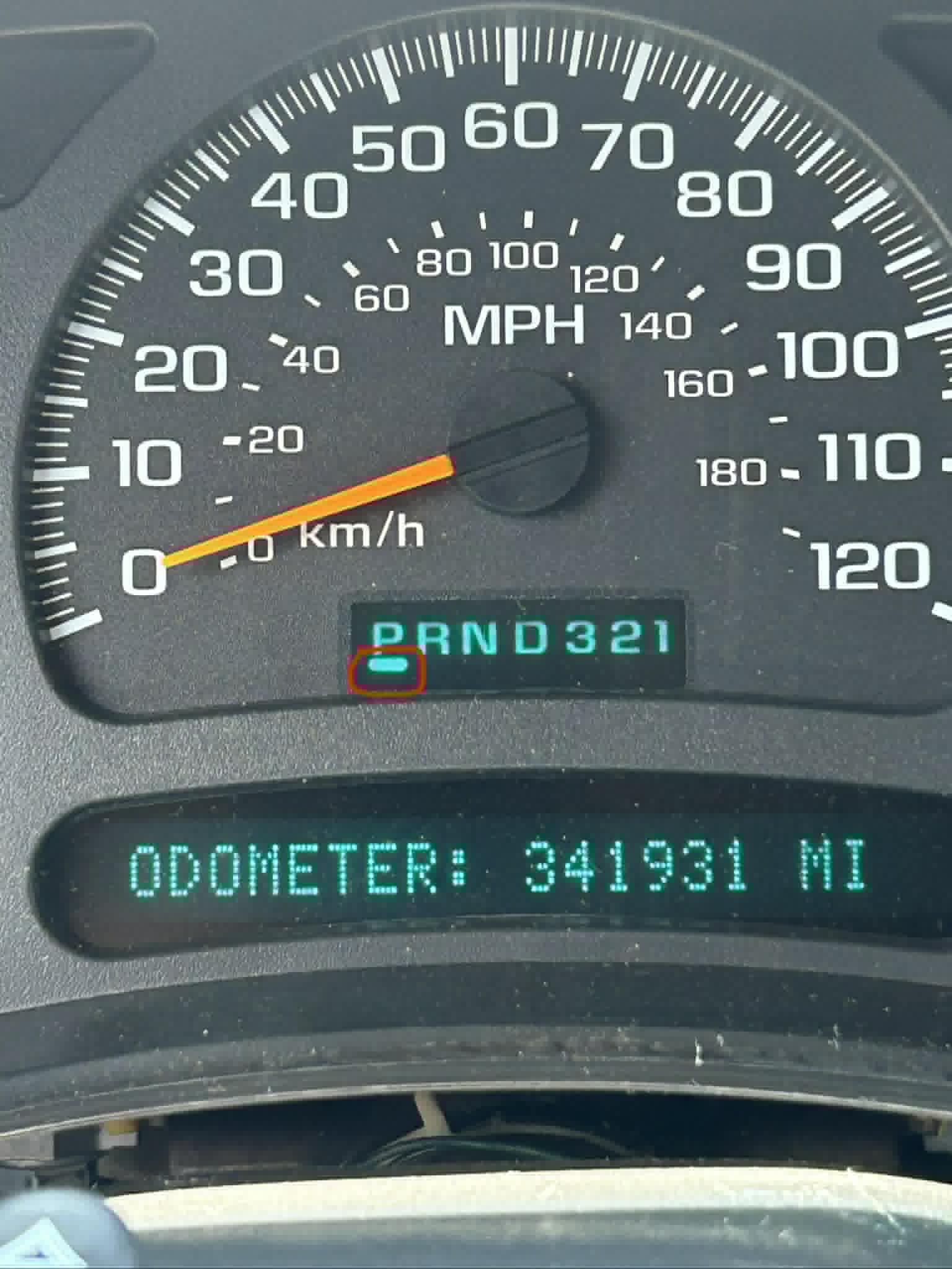

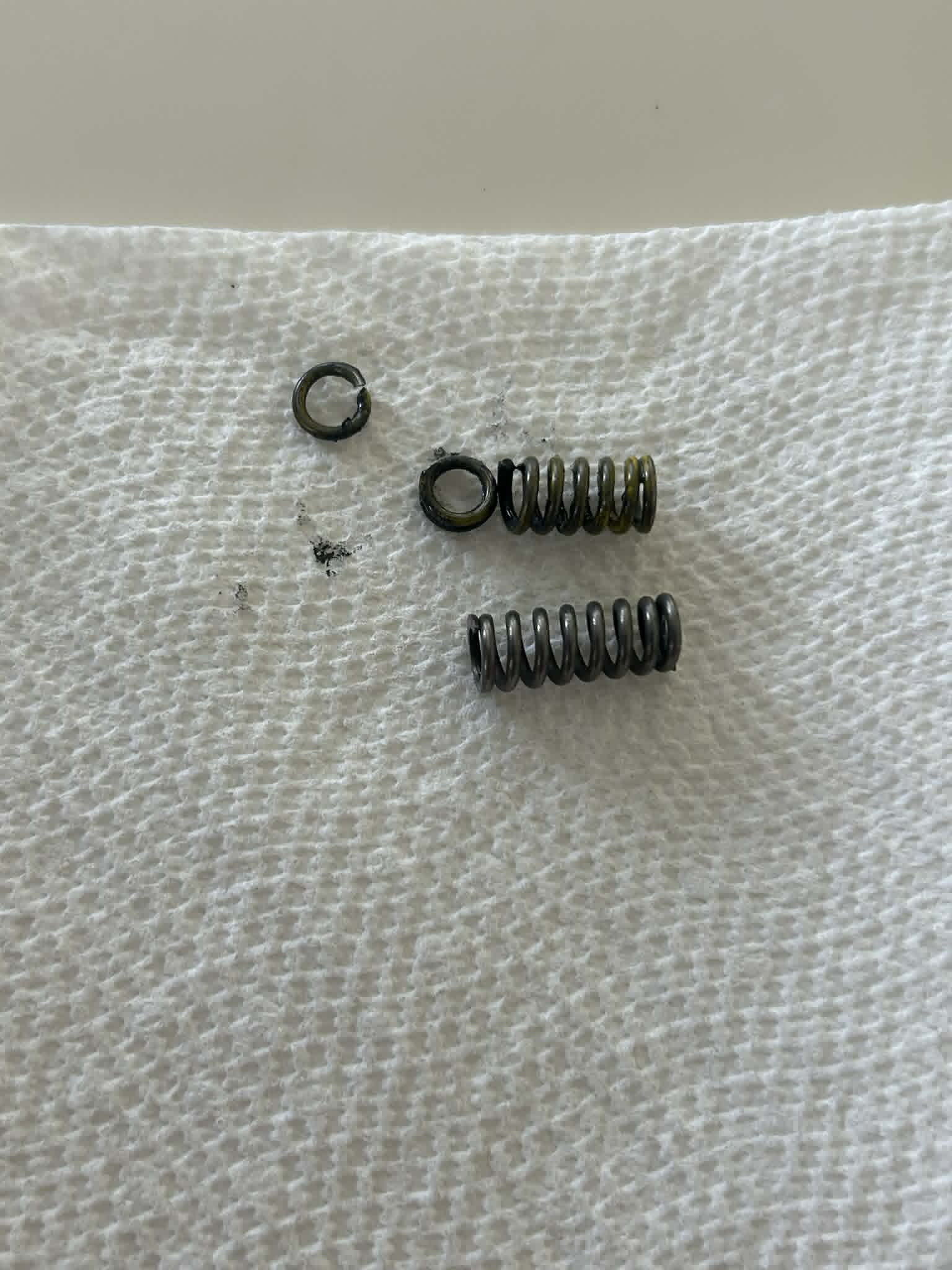

20260605
Current Mileage: 341,931
-Replaced gear selector return spring (GM#22833055). Vehicle was not displaying gear in DIC. As a result, an intermittent no-crank, no-start and unresponsive lock fault would occur.
-Stripped/repainted battery tray and fender supports.

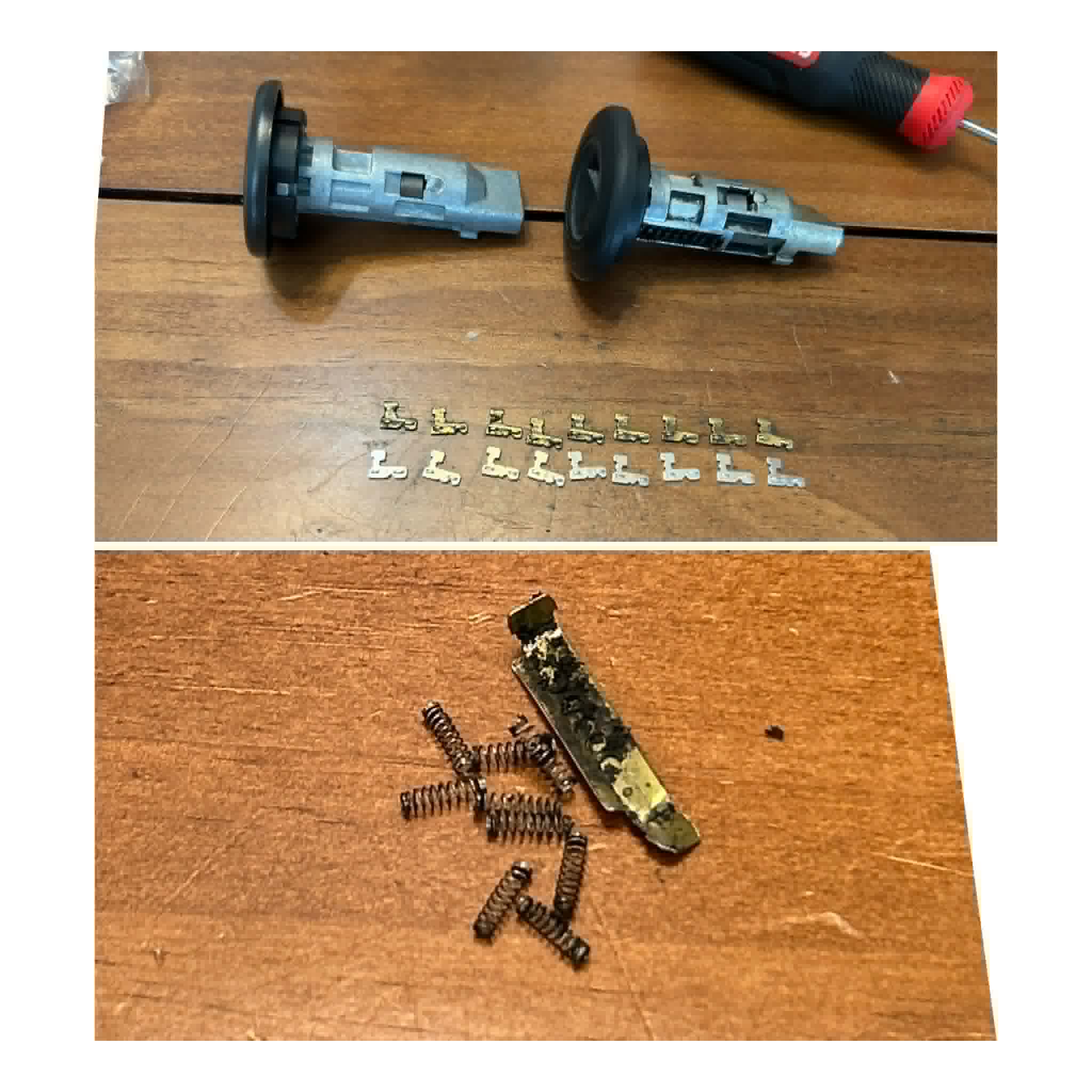

-Ignition lock cylinder (GM#19208680). The keys and springs became so caked with carbon that the ignition lock cylinder was failing to unlock consistently.

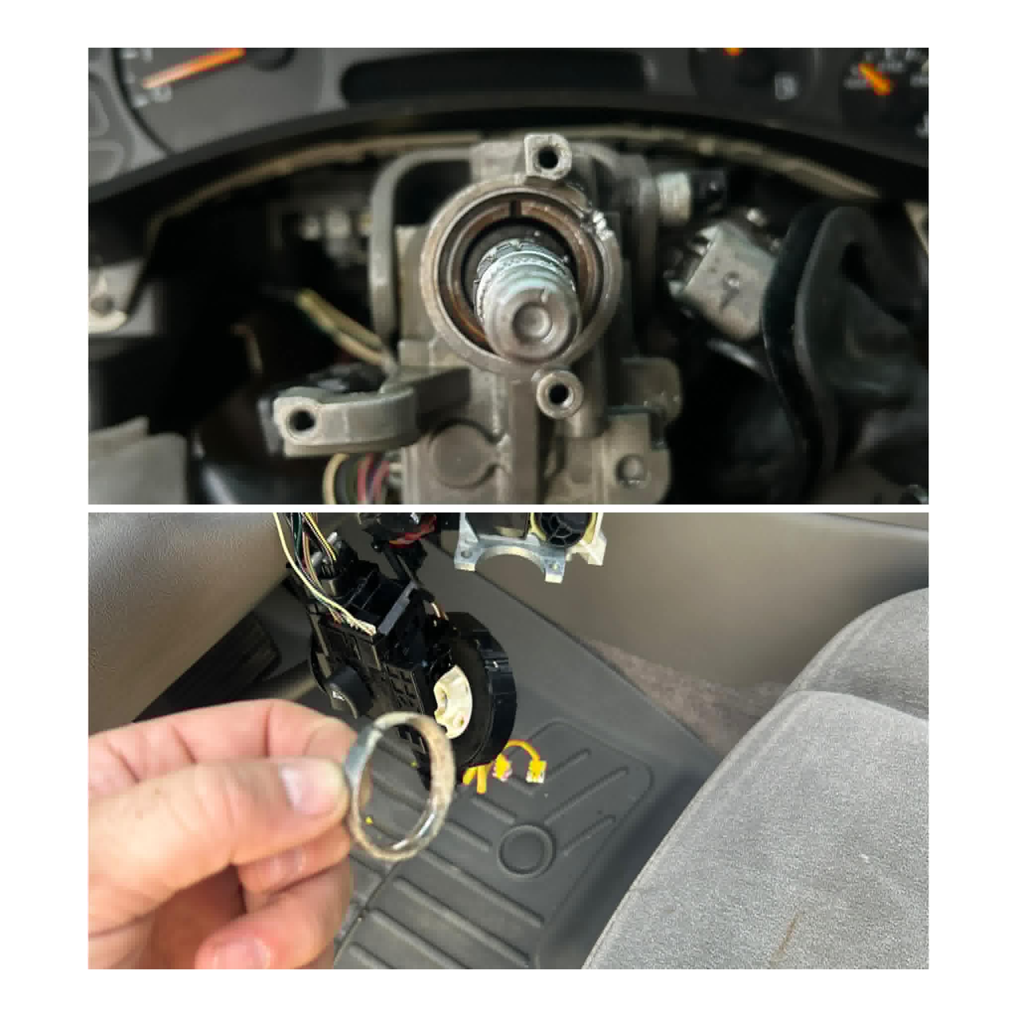

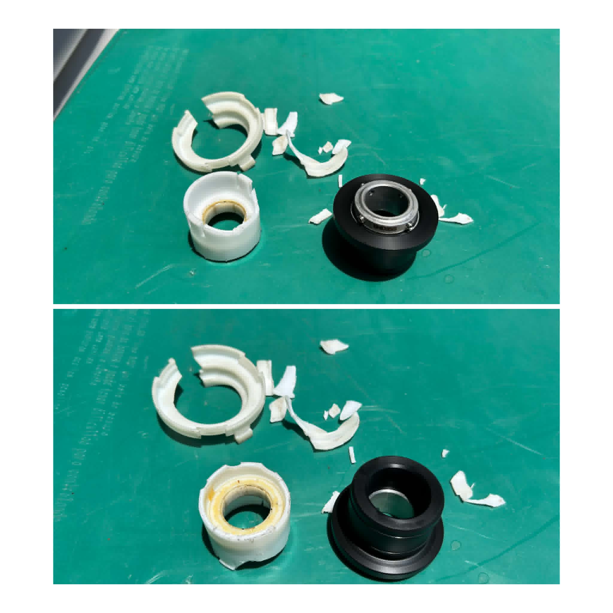

-Upper steering column housing bearing (GM#26001827). Steering wheel would rattle/grumble at low speeds. The old bearing race kicked my ass a little. Ended up using a dremel to cut it out. Thankfully the steering column comes with a notch pre-cut in a perfect spot for this. A blind bearing puller would have been perfect for this job but I was too stubborn to get a special tool.
-Lower steering shaft bearing (WE#GM109SS). Steering wheel would rattle/grumble at low speeds. Installed upgraded Wolff Engineering unit. Whoever thought a bearing race made out of plastic at GM was a good idea should be slapped.

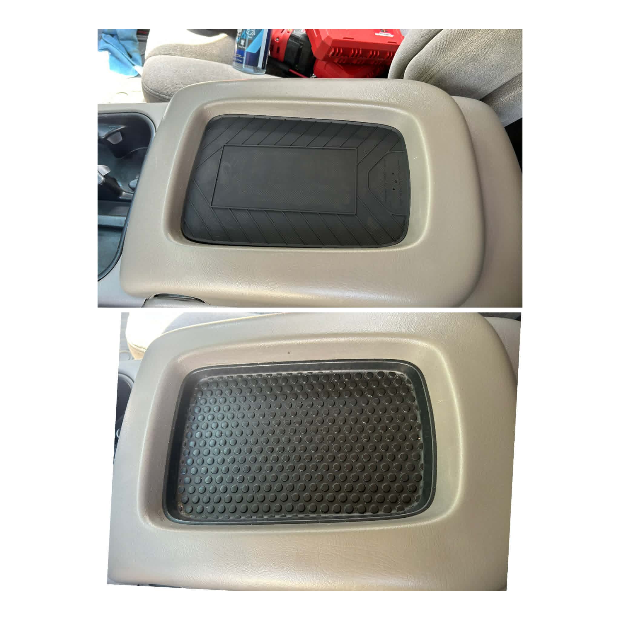

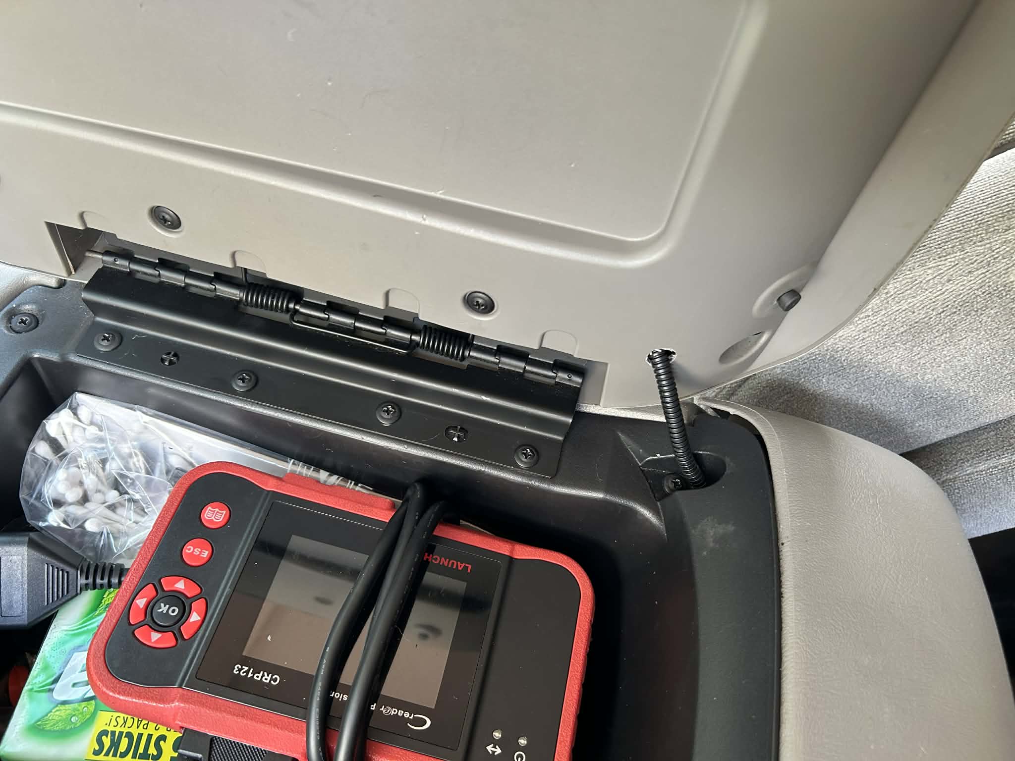

-Boost Audio wireless phone charger (BA#9906KIT). Replaces the OEM center console lid mat (GM#15070483). Pretty cool upgrade....plug and play wire harness, minimal actual modification.
