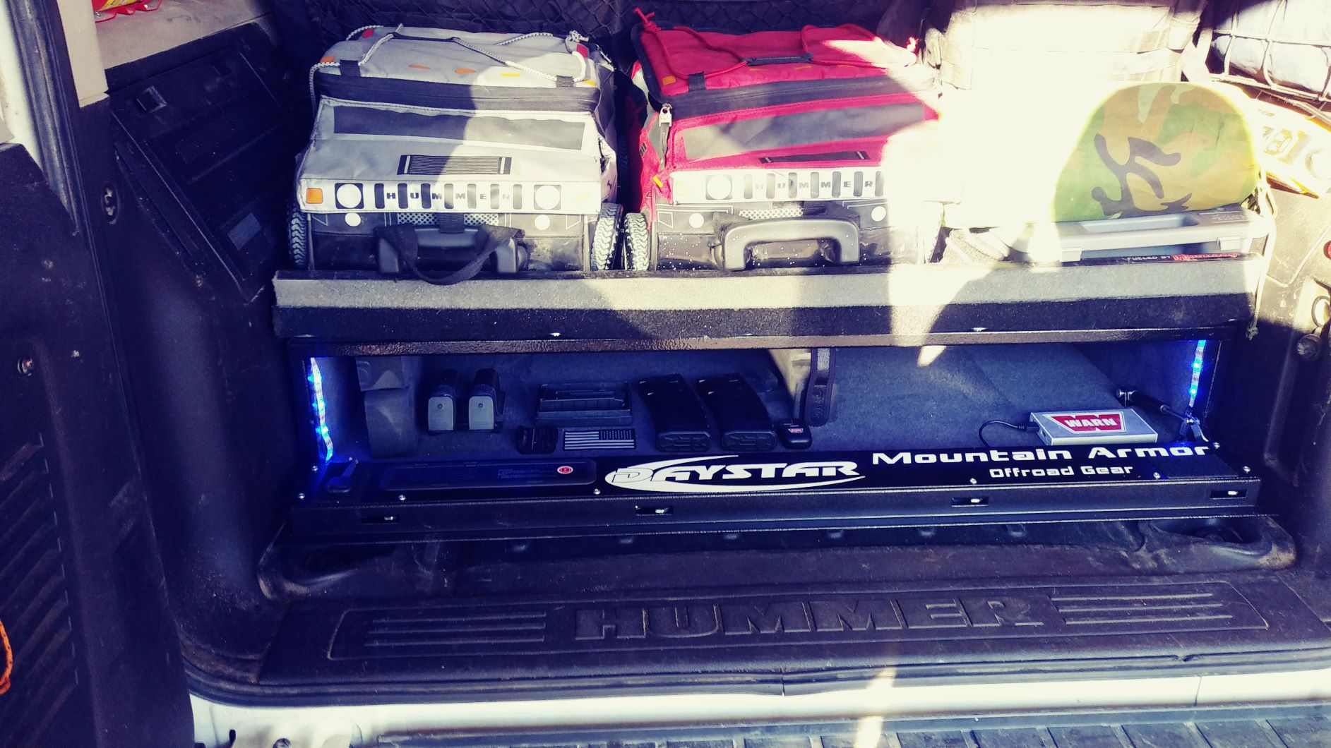

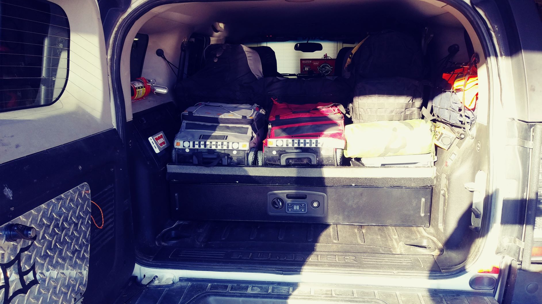

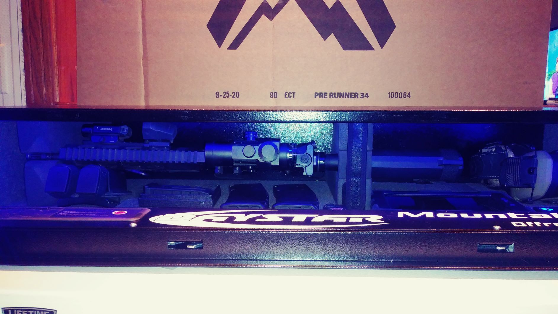

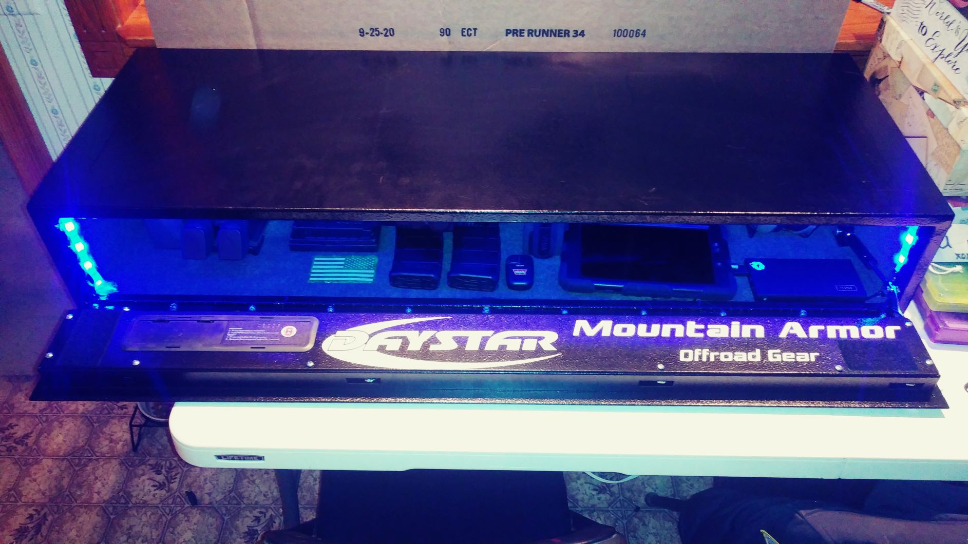

Wasn't sure which topic to post this in, but being used for anything you need to keep secured, figured I would post here. Upgraded my safe in the H3, parking at remote trail heads for extended periods of time, its nice to know your valuables are going to take more than a window break and a run off for a thief to get. My smaller safe was so limited on space, this will be nice. Added some lighting and she fits like a glove in the back of the H3. Will update photos when I get my covering cut to accommodate this one. Hornady large, smaller of the two choices, usually can find on sale for $250.

That looks nice. What's to keep the stuff on the bottom from sliding around though?
Velcro on the bottom of almost everything (very small piece works, sticks to the safe lining), and if its metal I use the gun magnet mounts. Hearing protection and tablet is only thing without a securing point.

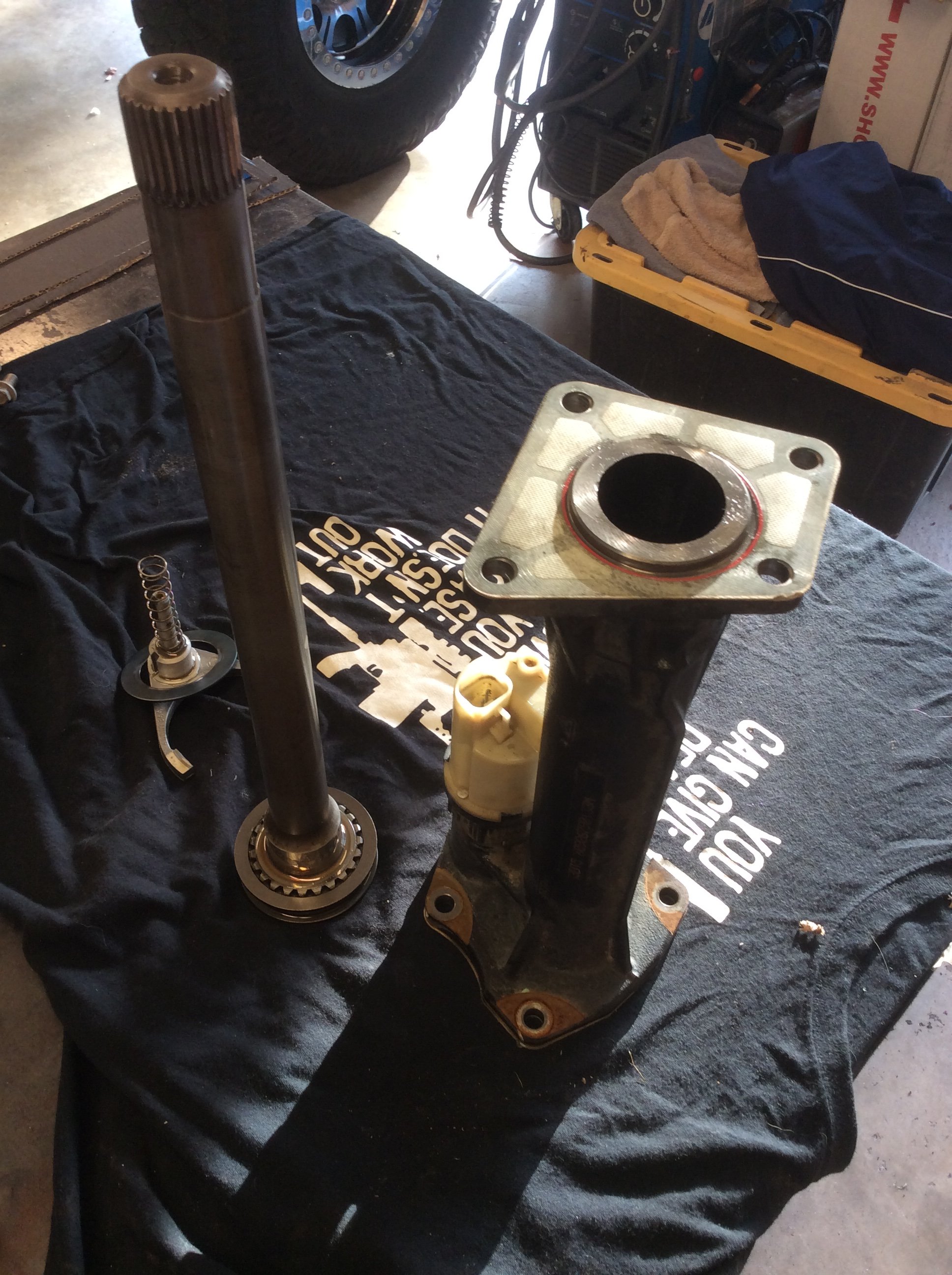

Maybe I am wrong but you would have to run in 4Hi lock right? Wouldn't still send power to the still connected front wheel? Isn't 2wd only achievable with a 2wd TC?
From what I've come up with, something that can be wrong. The actuator unlocks the front diff, yes, the t-case would send power.
But there wouldn't any drag from the front diff b.c its unlocked. Again, I could be all wrong. One of the 355 guys put a Colorado axle tube on a cast iron H3 diff.
Also, the axle tube I pick up is cast iron, so the strength should be the same.

I don't think this will achieve any sucesses, unless another type of transfercase is swapped in there. That front driveshaft will still be spinning. 4Hi unlocked will just burn up the transfer. Won't achieve any easily measureable gasmilage saving.
Is there something I'm missing?

I don't see how the T-case would get burnt out seeing how its only going to spin the front driveshaft just as fast as the rear. This is pretty much going about making it 2WD like the guy that got locking hubs made for his 3.
My T spends more time on the road rather on the trails just because I really don't have a reason to go unless I'm part of a group. If I can pick up a few miles doing this, then why not? Just need a few gaskets, CV seal and a weekend.
