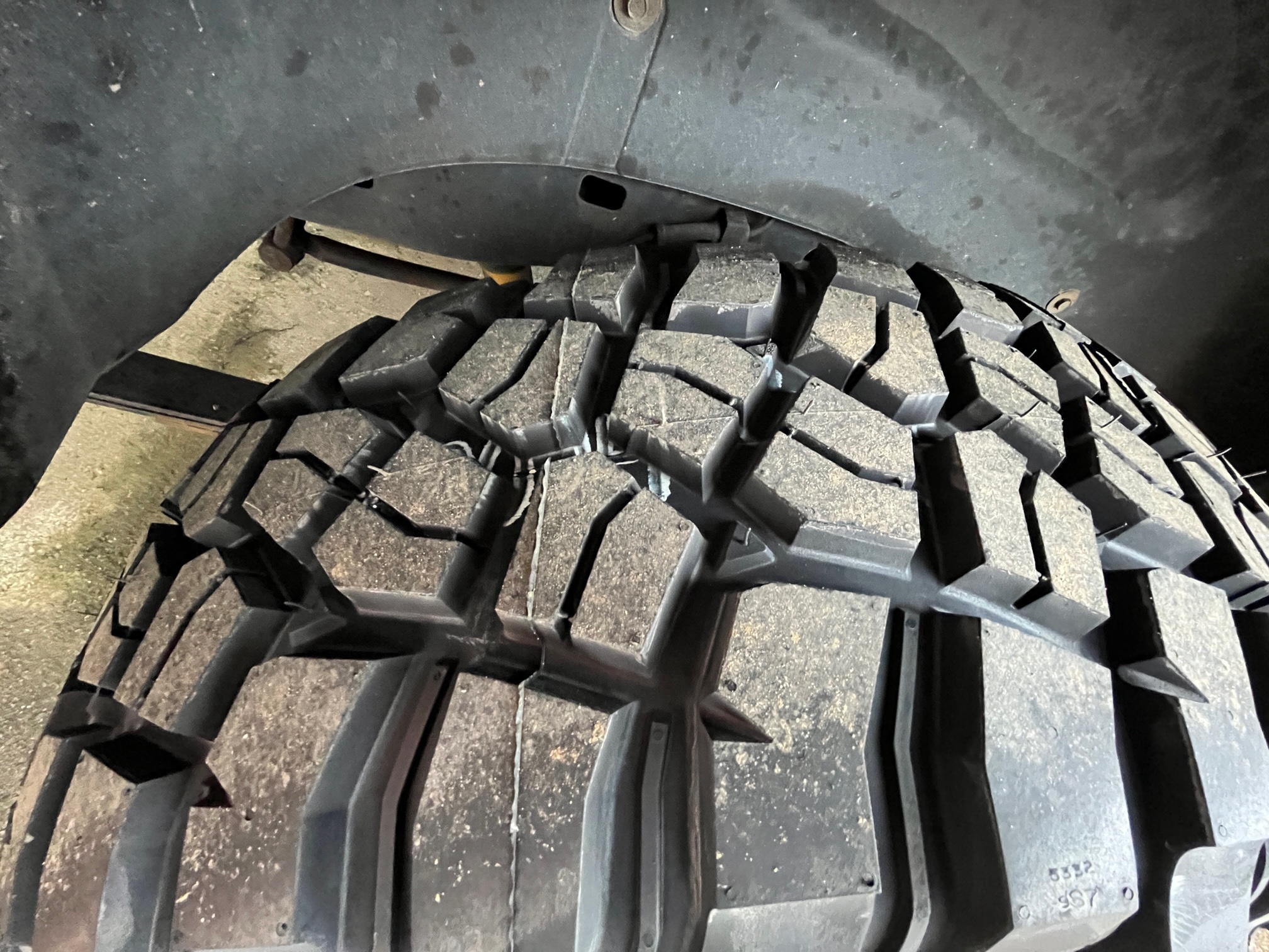

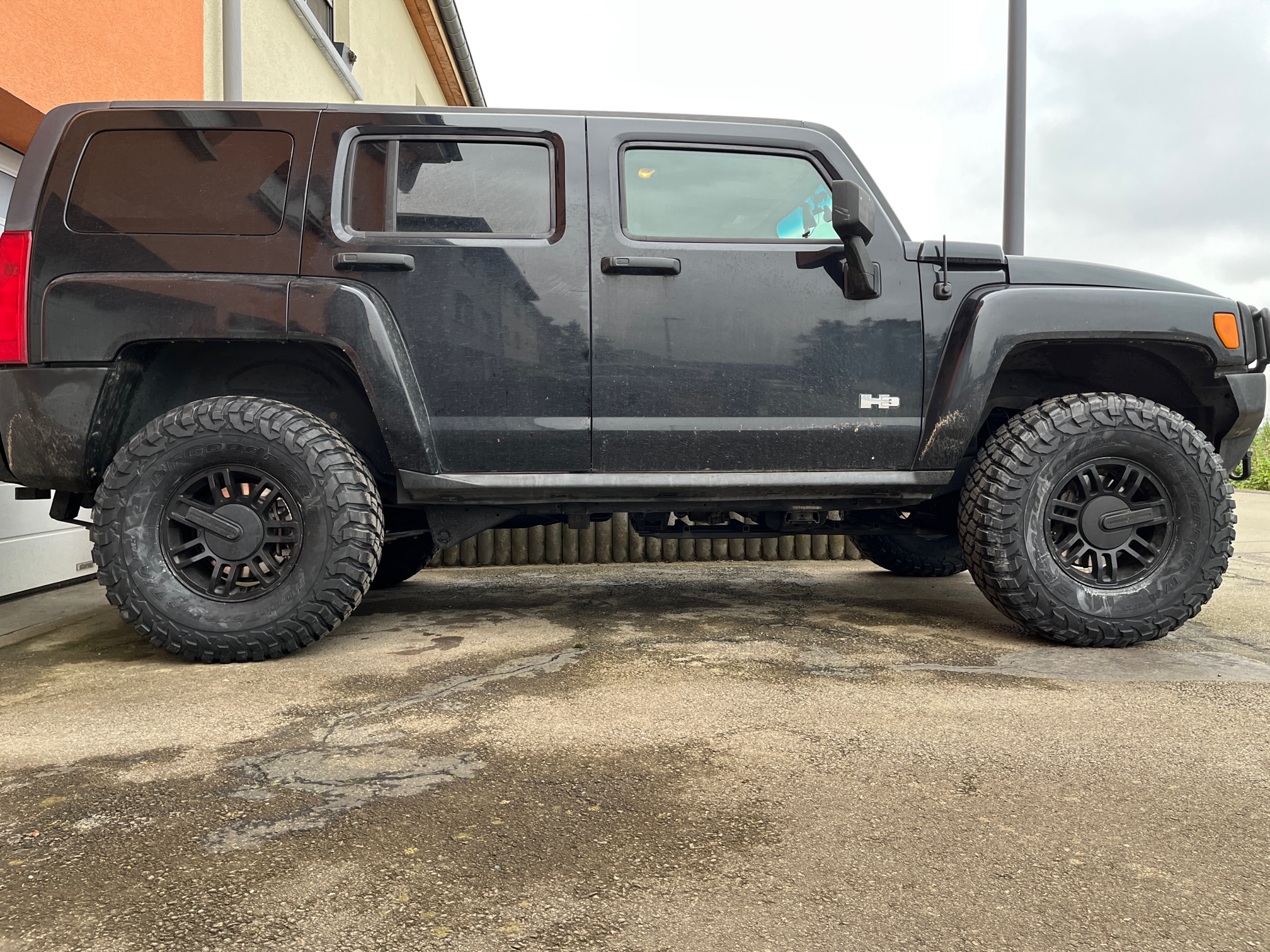

Duuuuude those tires are heavy to get off.....
.... so today was an all new breaks day:
front pads, rotor and caliper, rear pads rotor and caliper, park brake shoes, break liquid flush and ......................... daaaamn, those tires are heavy to remount
Now It breaks like hell :cool:
Still have the rear bearings to do, but.................. on another sunny day

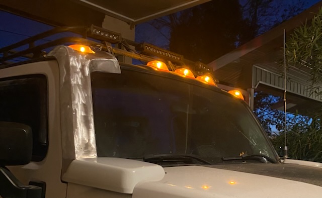

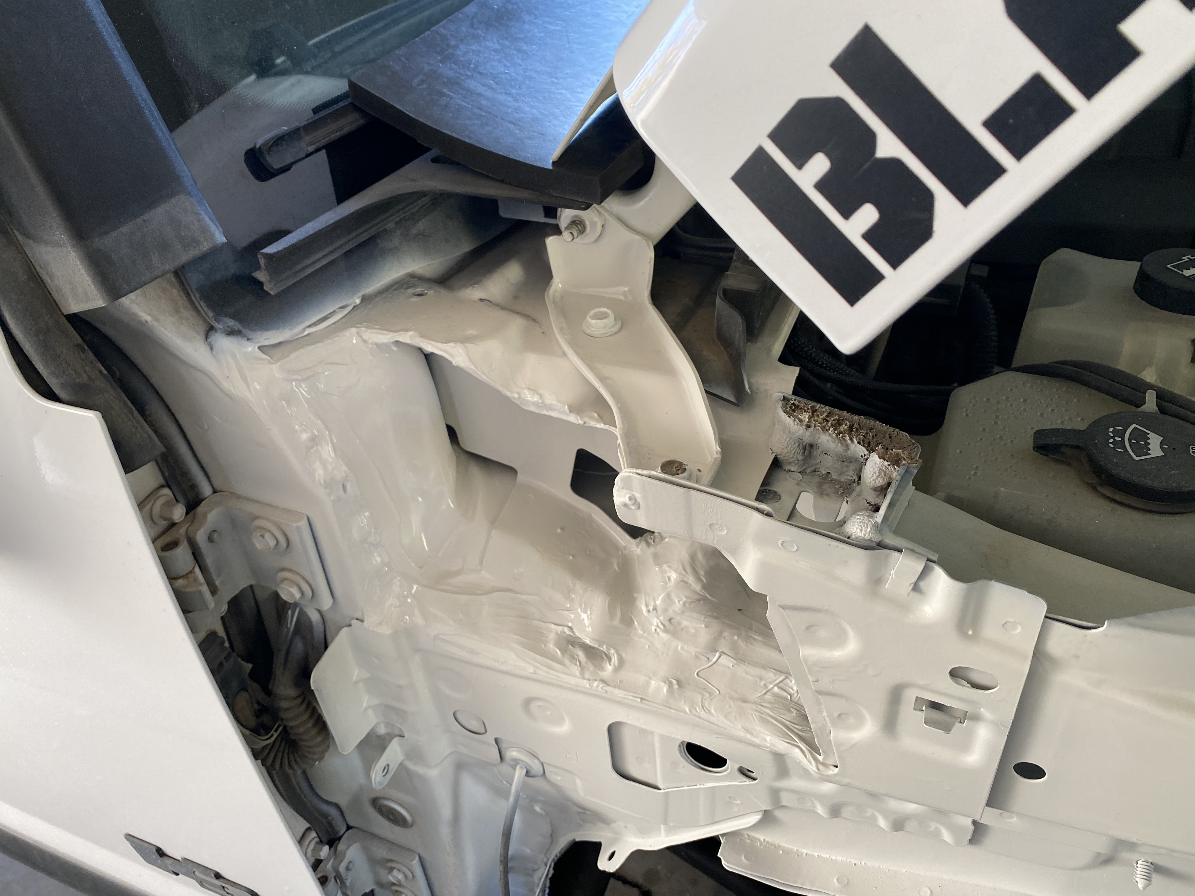

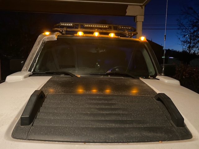

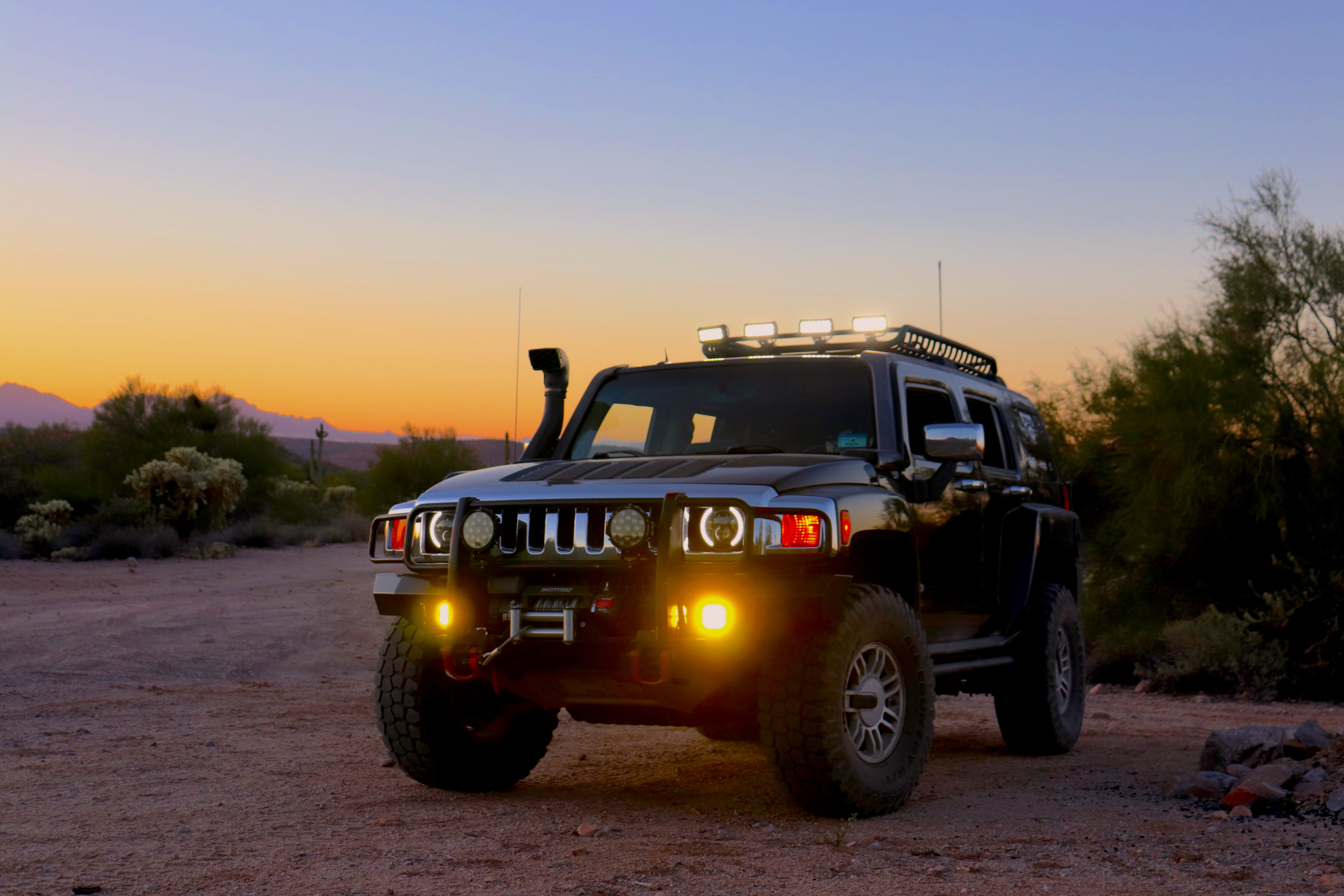

Trying my hand at welding aluminum. A learning curve from mild steel.
Almost finished with a snorkel that replaces the A pillar trim. Frenched in the roof marker light. I’ll spray it with bed liner from an hvlp gun to match the trim texture as close as possible.

LED lights are Rough Country Black Edition 12" center and 6" outers. Could have gone 8" outers.
I used a Millermatic 211 MIG with a Teflon liner, .035 4043 wire and .045 tips.
I had to make a path to rout. Actually, didn't remove much metal from the upper rail. I'll post the installed piece without the fender when work slows down and I can spray the bedliner on it.

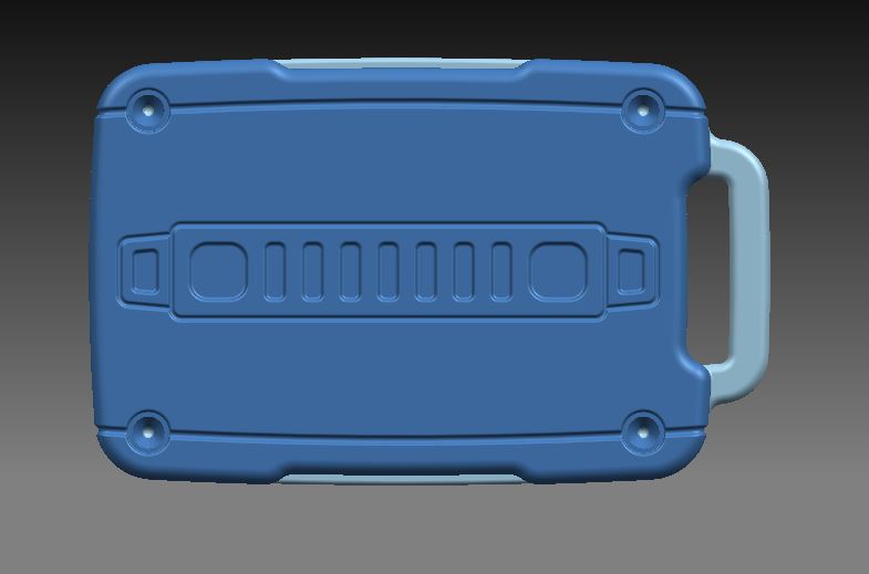

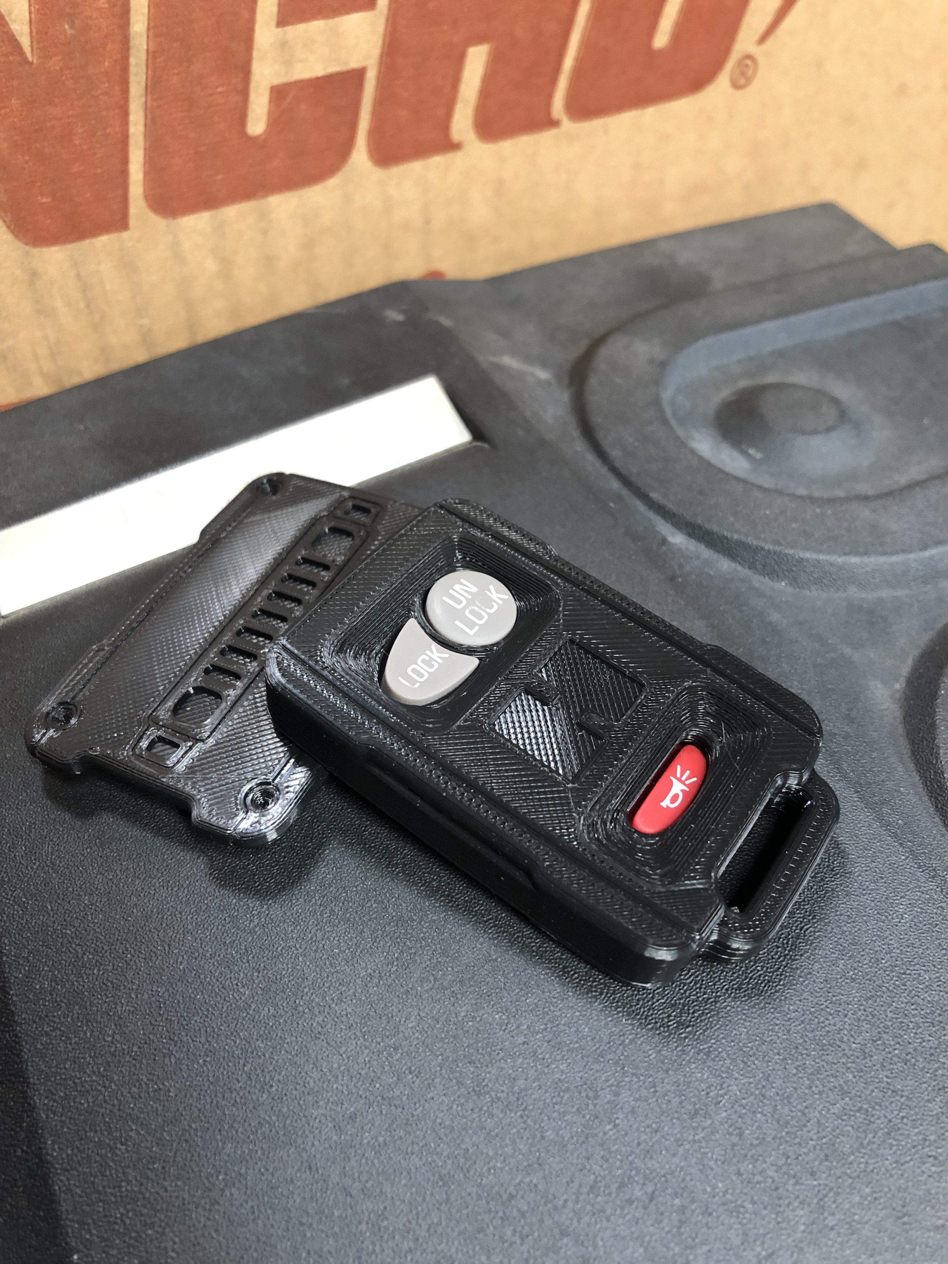

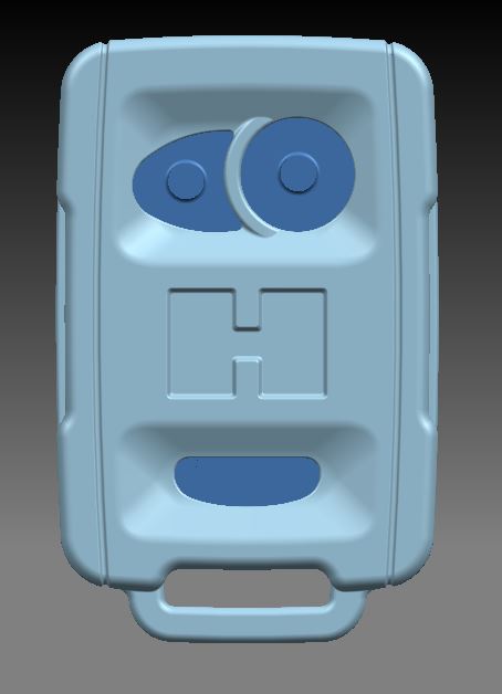

After breaking countless key fobs, I decided to have some fun with my 3D printer over the christmas break and made a completely new key fob case that reuses the buttons and circuit board from the teardrop shape one we all have. Inspired by the key fob case that I had on a Silverado. After a few trial prints, it's pretty close to being done. One more nice quality print and it should be good to go.

That key fob is really cool. You should make more and sell them!
If there was interest, I'd sell some key fobs. I'm also working on some other stuff to 3D print for my truck... headlight and foglight adapter brackets. I've been in the automotive design business for over 20 years, and if I had the time and money... I'd have a truck full of one off custom parts.
