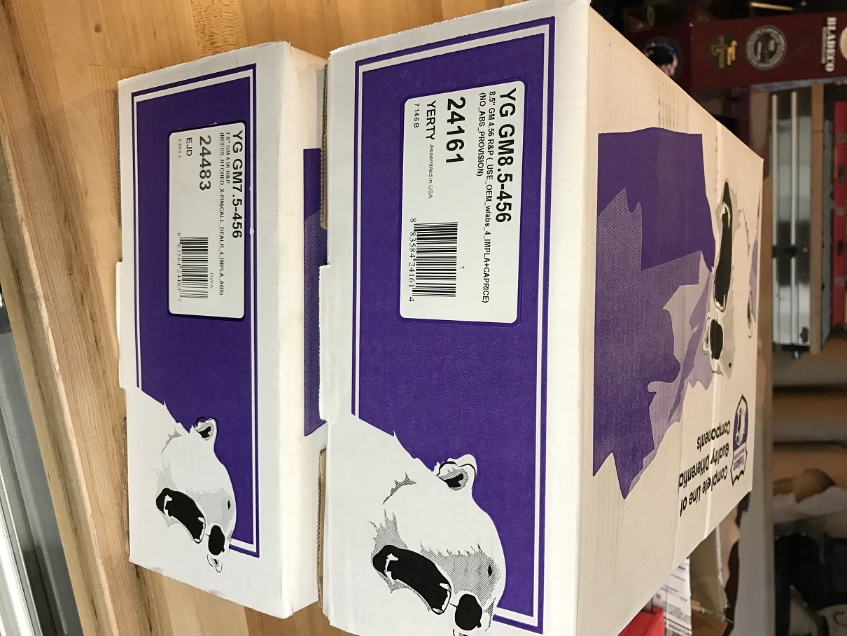

Ups dropped off some stuff for the T. Just need the master install kits and a diff cover now.
