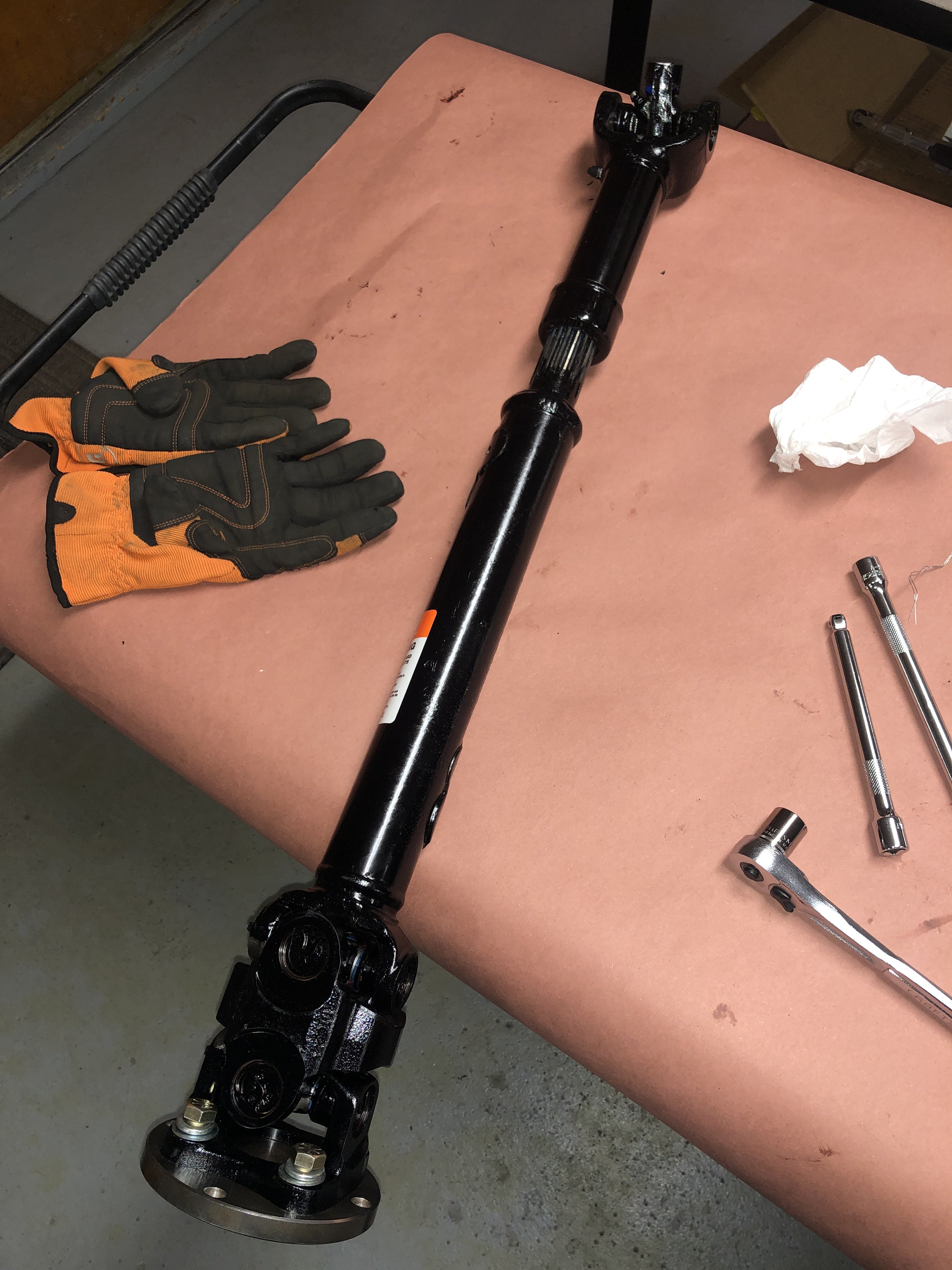

Okay...I stopped by the driveline shop today, and here is some additional info:

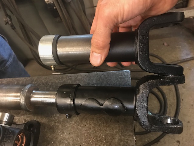

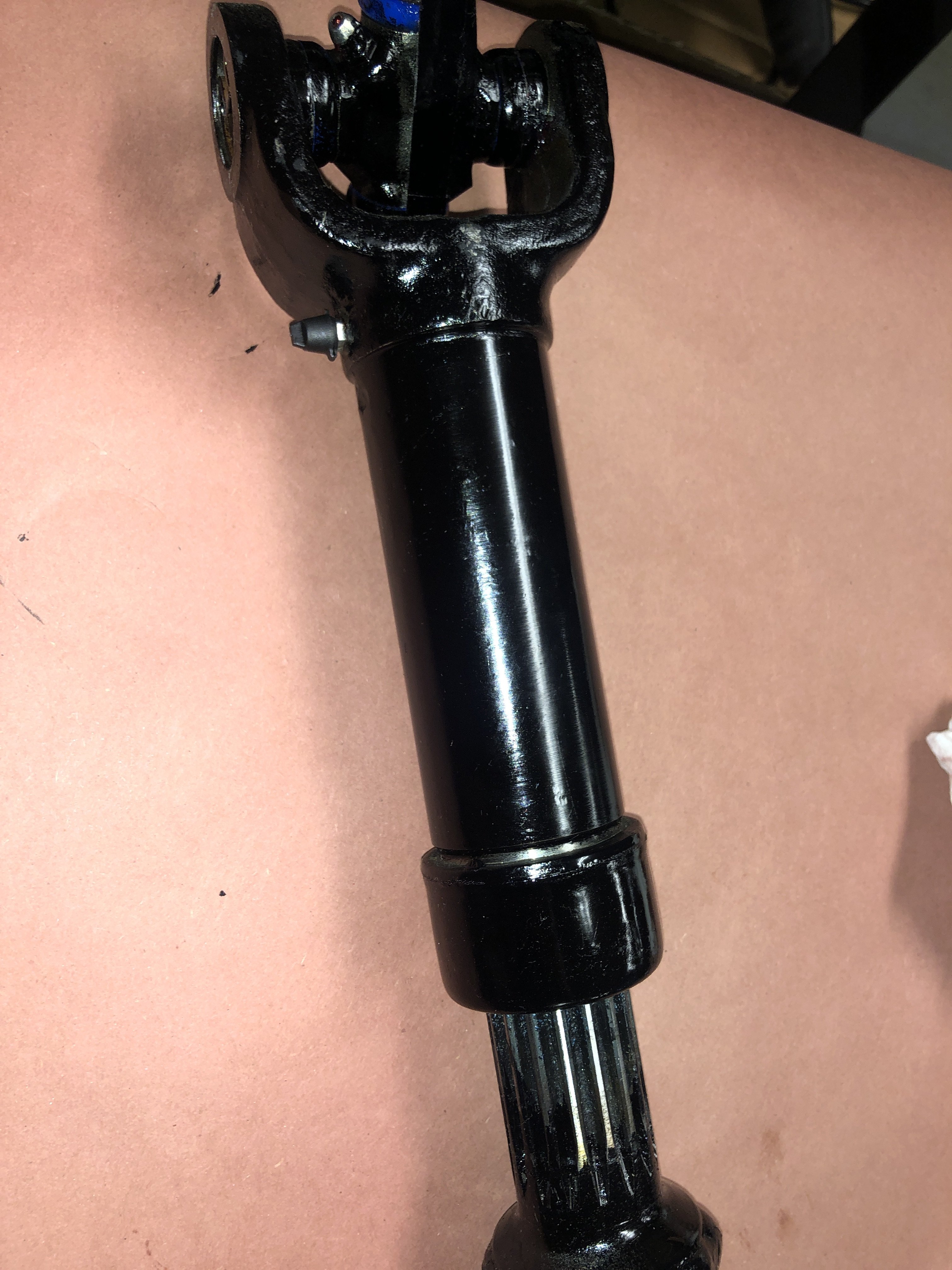

In addition to the Cardan parts & u-joints listed above, you will also need some driveshaft tube, a 1310 slip yoke, and the slip stud. These are the items you have circled in my photo, and they go on the front end of the shaft. The tubing used here is 2" O.D. x .120" wall ERW. This is a typical driveshaft tube size that most shops keep in stock. In the photo below this shaft is being built for a stock H3 with an IFS front axle. For this reason we are using a "short travel" slip yoke and stud. These are Spicer #2-3-8001KX (slip) and Spicer #2-40-1701 (stud). This will allow you to collapse the shaft to get it in place, and then extend it to get it bolted-up on both ends. The IFS does move a bit back & forth, so you definitely need some sort of way to vary the length, and thats what the slip yoke & stud do.

On SAS trucks, we use longer versions of these parts. The solid axle is "live" and therefore travels up and down quite a bit, so a longer slip assembly is needed.

The tube gets welded to the ball stud tube yoke on one end, and the slip stud on the other. This must be done while the piece is rotated at a very low rpm (lathe welded). This makes for very pretty and even welds, compared to trying to do it by hand. It also balances much better, since the weld is consistent all the way around. All of this is standard procedure at any driveline shop. There is nothing high-tech or custom about this. The only custom part is the THORparts adapter.
The stock length shaft is approx. 31" long. The THORparts adapter is .500" thick, so the target running length is 30.5" long. I usually specify a collapsed length of 29.5" and this gives you plenty of slip to get it installed, with some additional room for minor fore & aft movement of the IFS diff. Here are links to the stud and yoke for an IFS (short travel) build...

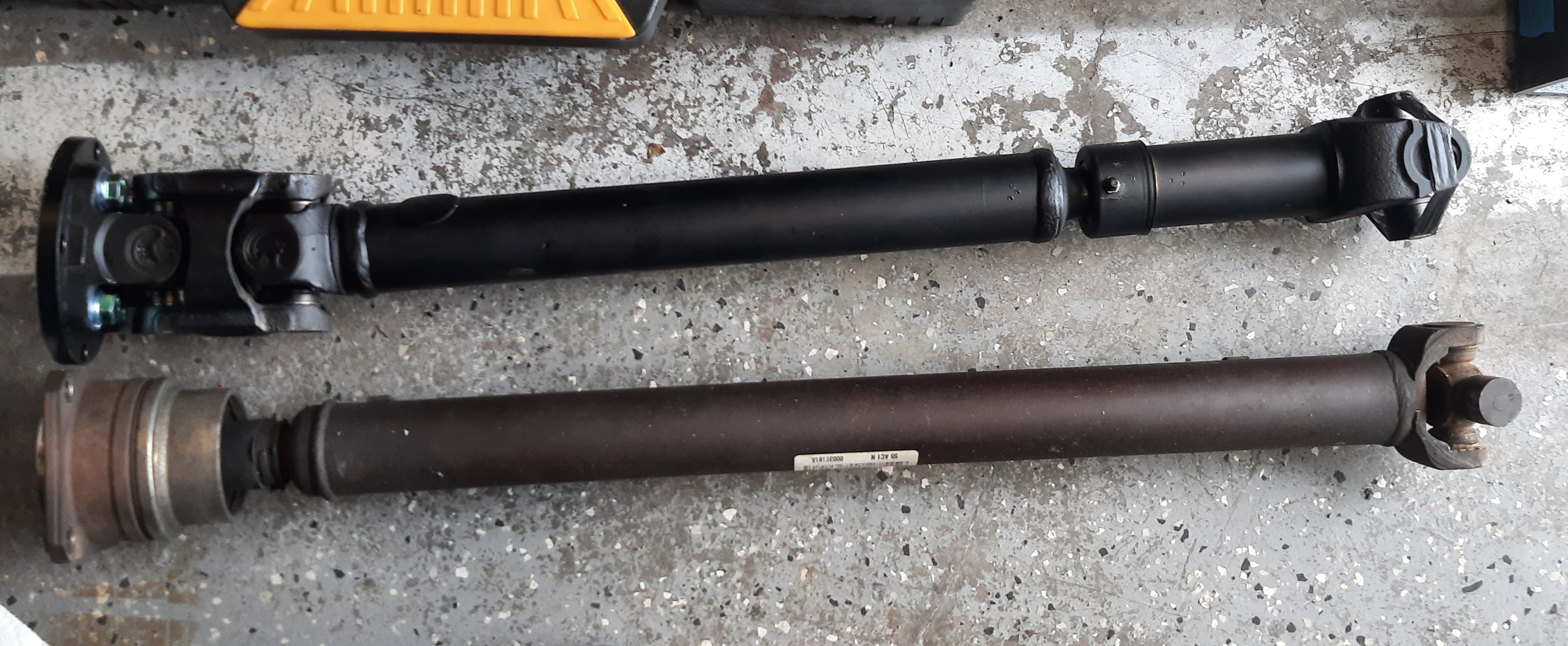

It's not often I have the opportunity to share photos of my shaft in such nice condition. This was from 2021, built from the info in this thread after I installed a Rancho lift kit. I purchased the parts and had Joint Clutch & Gear in Romulus, Michigan put it all together.

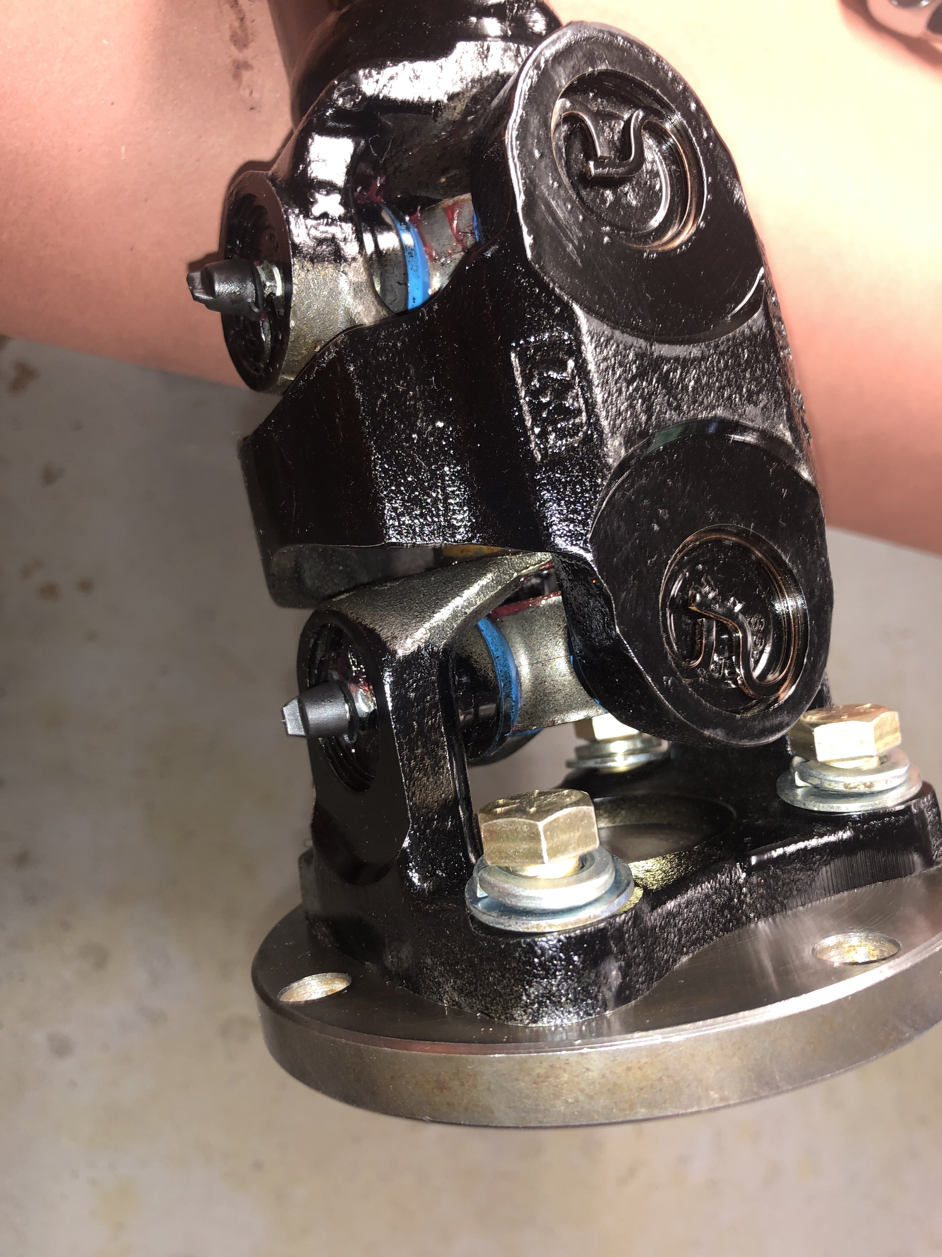

4speedfunk,
I’m getting ready to order my parts for my shaft build. A massive shaft it will be! However, what is the rational for not using parts that may be greased? Is the initial greasing of the centering yolk and ball stud yolk , and non-serviceable u-joints sufficient for the long haul?
Everyone appreciates a well greased shaft you know🤣
Thanks in advance!
Matt
Greaseable joints are hollow. The zirk threads into an "X" shaped hollow passage, which leads to the four cups that contain the bearings. In theory, the solid joints would be stronger because there is no grease tunnel in the middle of them. Almost all new vehicles have non-greasable (sealed) u-joints. They often last for hundreds of thousands of miles. I suppose the thinking behind this is that, when the time comes to grease them...it will be time to just replace them all together. My experience has been that the pivot-pin of the cardan will wear out long before any of the u-joints. These center-pins are available in sealed and greaseable versions. However the greaseable version requires a needle (instead of a zirk), and its a total PITA to try to maintain them, which again...sways the decision to go "sealed" on this item too.
