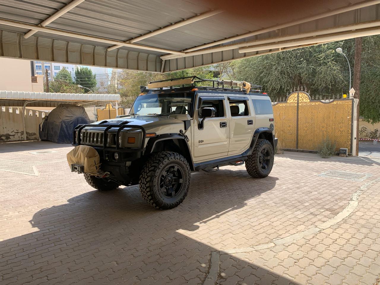

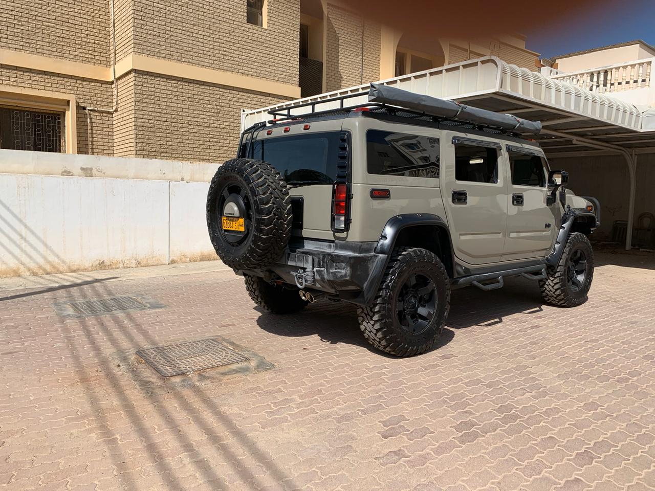

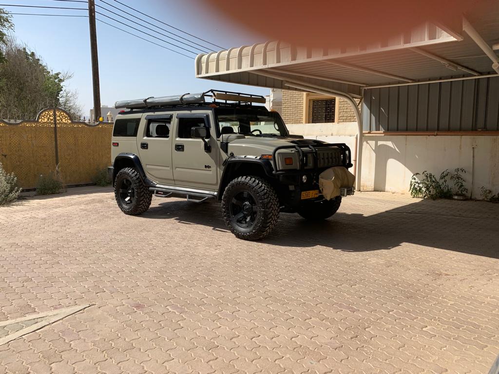

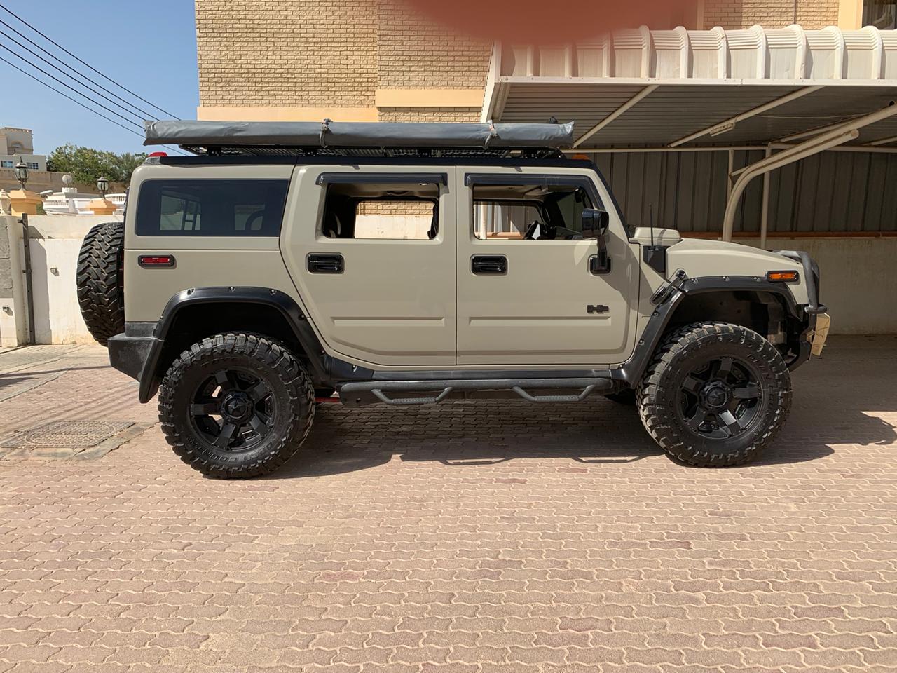

you get additional 3" of coverage, equally they're solid and functional and transform the looks of our H2'z. my H2 is on 38"X13.5 Toyo Mud tires and they're fully covered.
Got some higher priorities like new shocks and better undercarriage protection but these flares are definitely going on my list. I am running 35’s with no modifications and zero rubbing. Did you do anything to accommodate 38’s and do you experience any rubbing?
Big2dabank
Central Florida
38's fit nicely with a leveling kit. They will certainly rub the wheel/fender well when the suspension compresses off-road, more so in the front than the rear. Mostly when the wheels are straight, if you approach obstacles and compress the front while the wheels are turned slightly to the right or left, it hardly rubs at all.

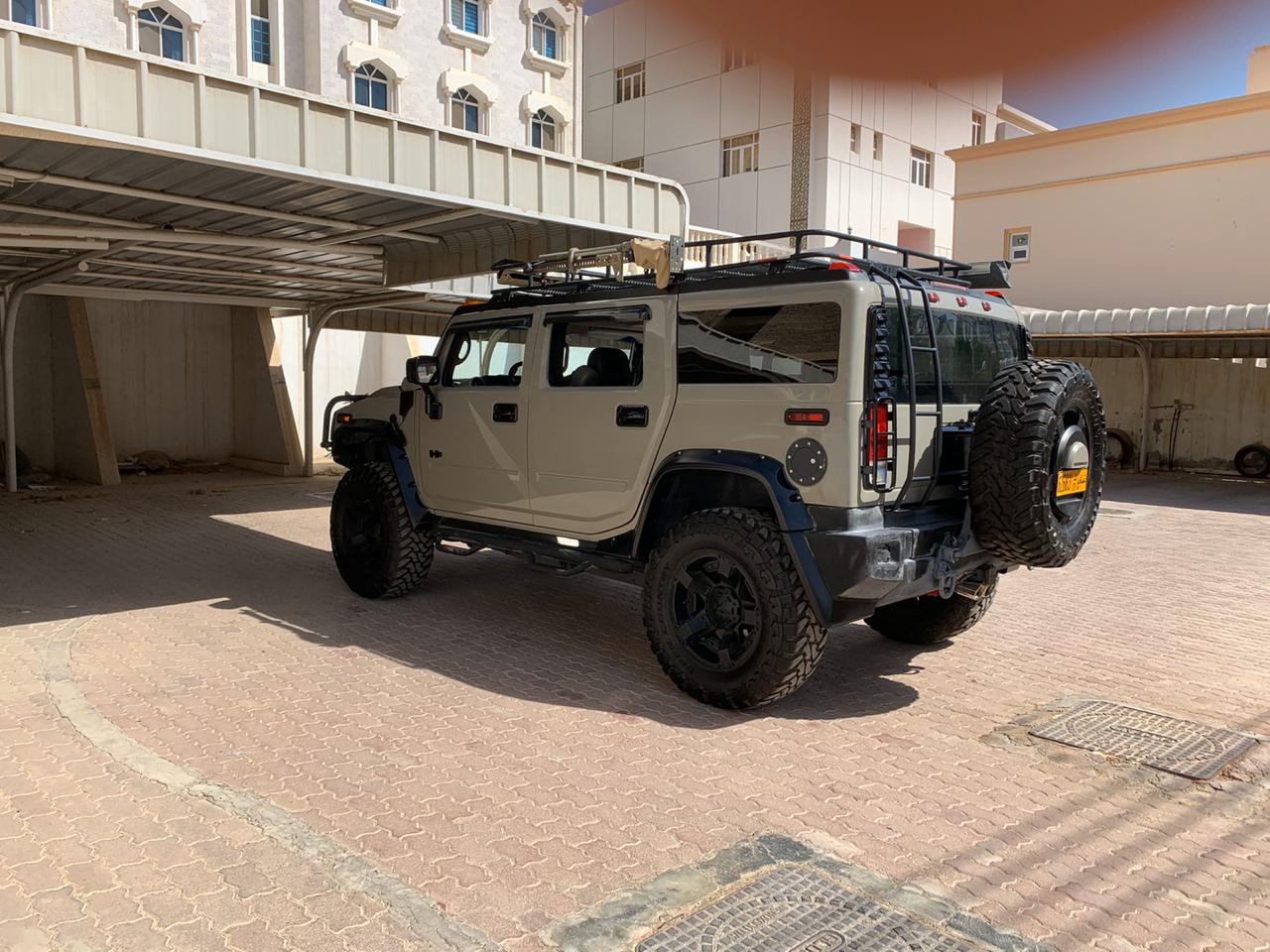

First of all, I love this truck.
Does this truck have a body lift? Everything looks even as if it does not but your rear bumper corners seem to have a lot more plastic running up the body than normal bumper corners, it looks very odd.
Also what power rear lower control arms are you running? I’ve noticed our selection of choices went from about 5 different manufacturers a couple years back to just the OEM ones and some thin looking adjustable rods that I’m not very impressed by.
