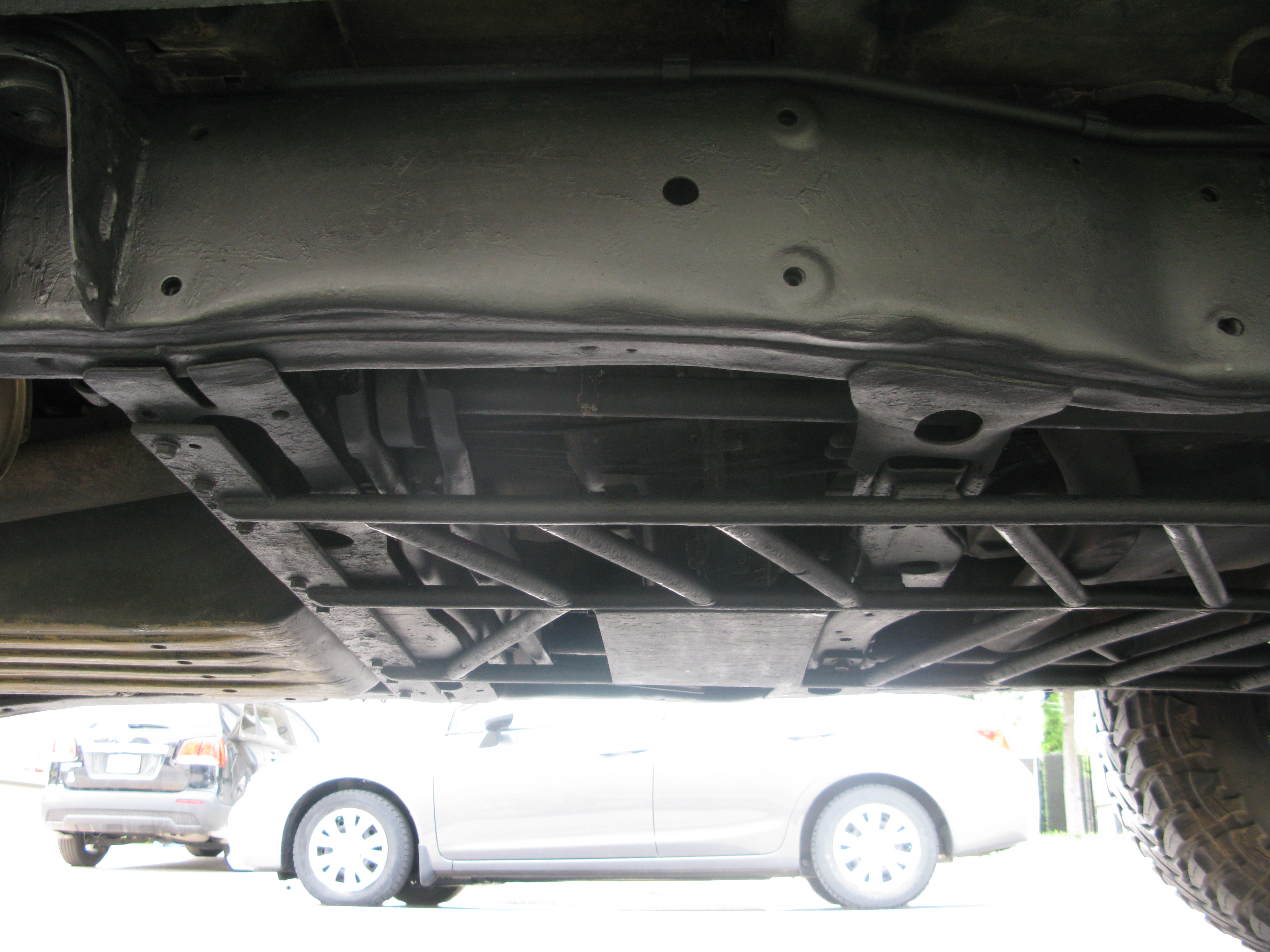

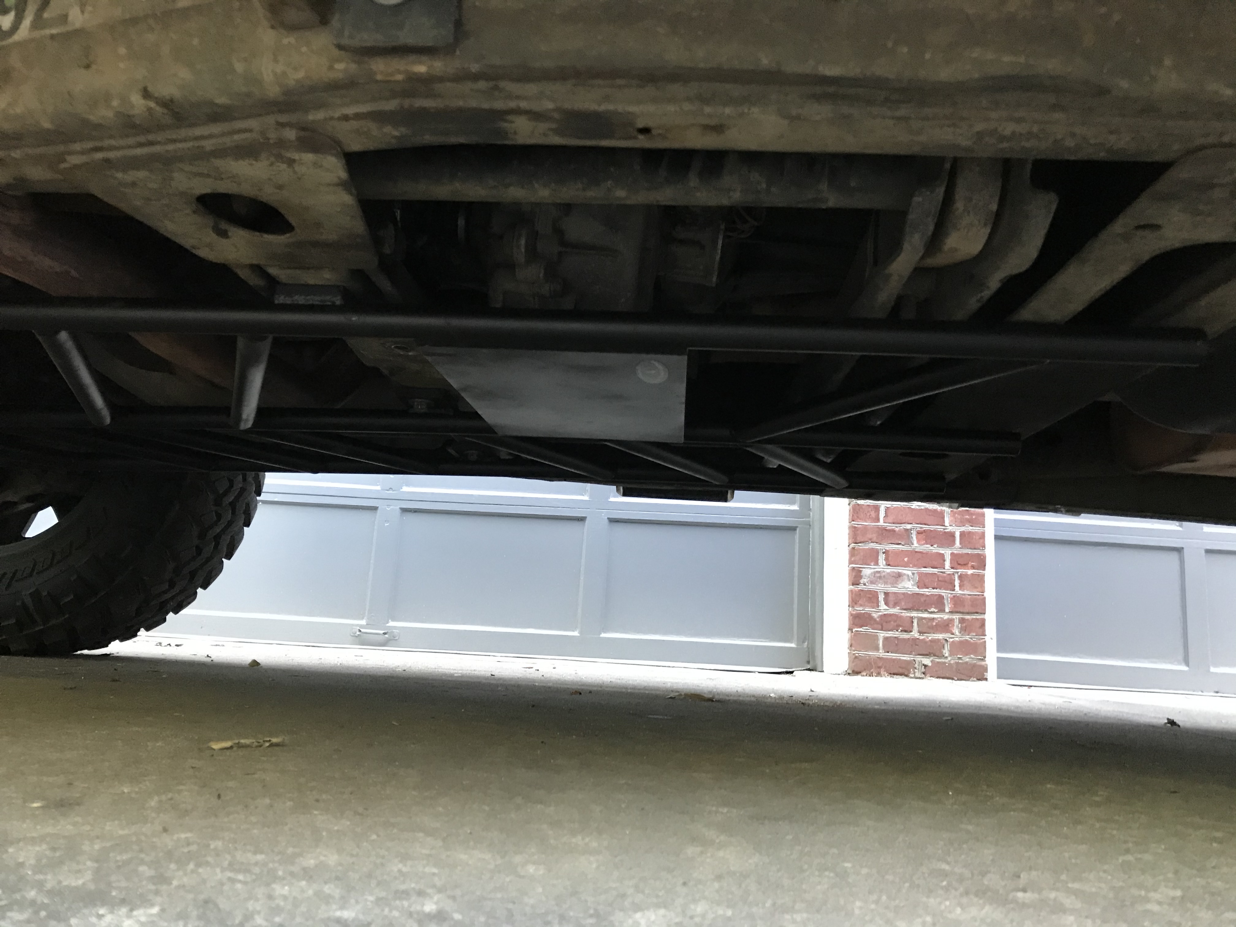

Where do you get those skidplates?
Installed the Rubber Duck UCP today. They come with no instructions. Put the rear one on first. IMG_3268.jpg
Also one hole did not match up on the back corner of front skid plate so I had to drill it out some to get the bolt to line up.
A motorcycle jack is very helpful for the installation. Last point is that I had to use the 3 bolts from the OEM transfer case plate for the 3 bolts in the very rear because the supplied bolts were too big.
