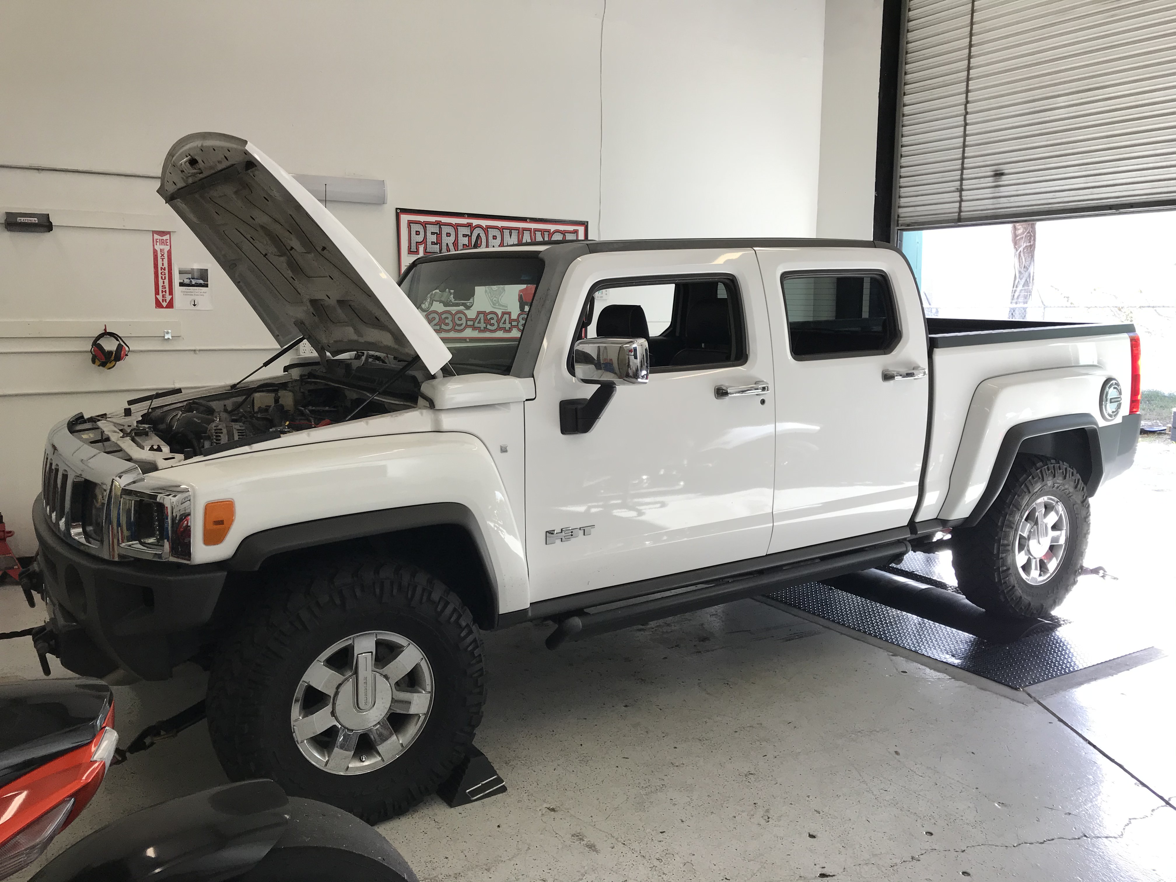

Brought The Duke to my buddy's shop to get custom tuned after the camshaft install!
Performance Cycle and Auto is the name of the shop and it is located in Naples, FL. Brandon Cunningham owns it along with his father and he was the one who tuned it. We used HPTuners software and everything came out quite nicely.

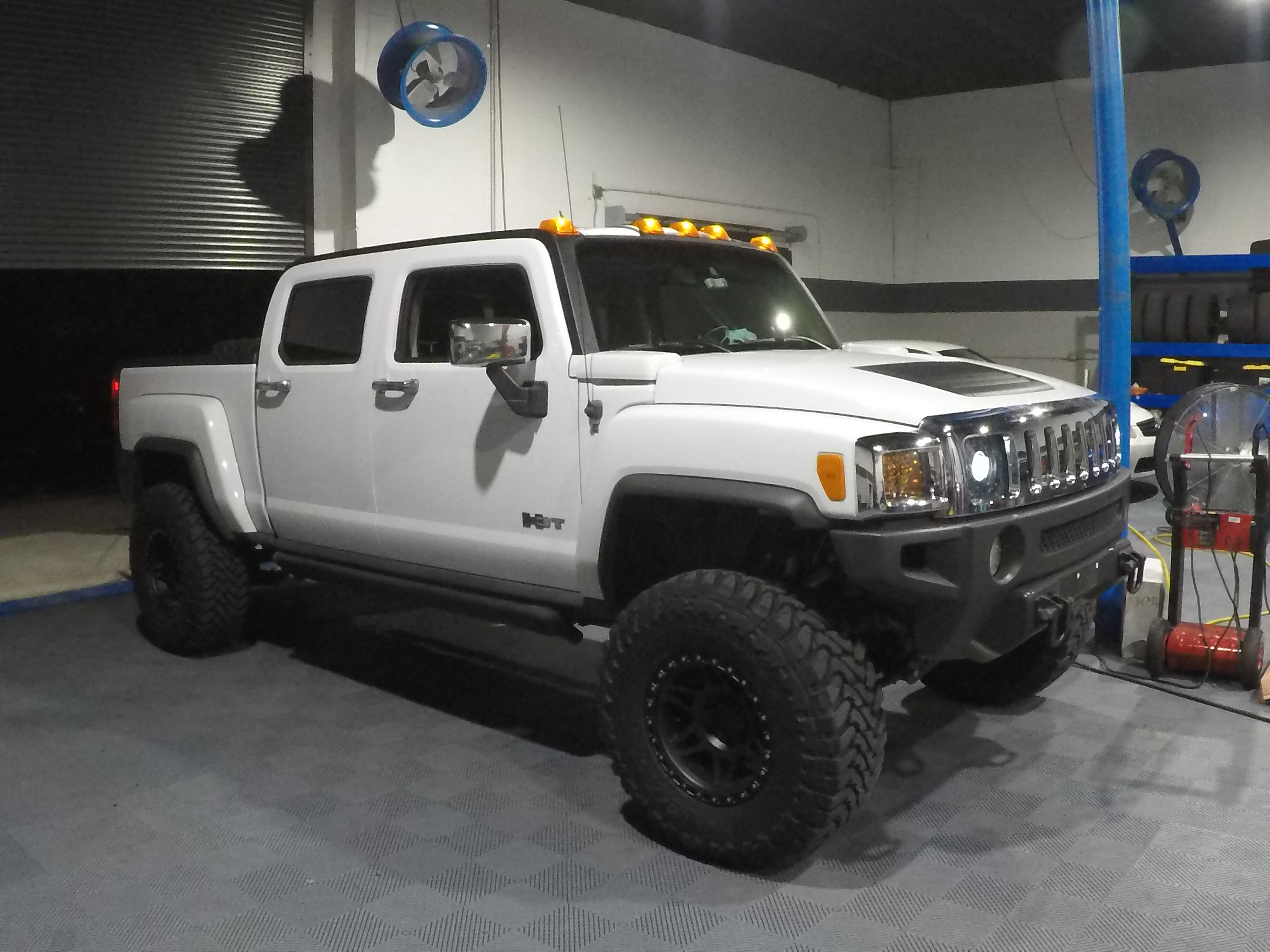

Here's The Duke all strapped down on the dyno for the second time. Again, the front driveshaft was removed and the transfer case was locked in 4-High in order to make it rear-wheel drive to use the dyno.

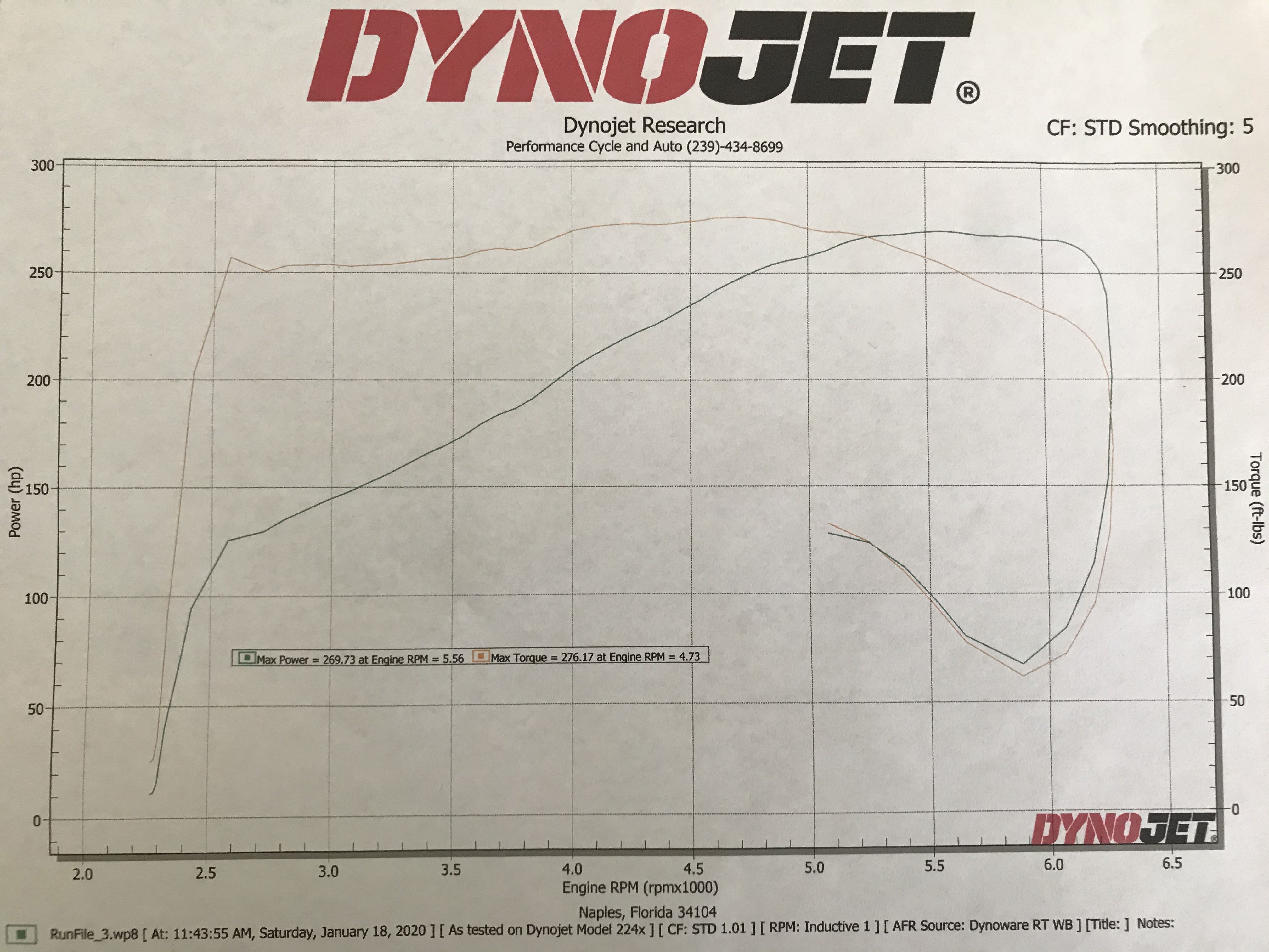

Here's a video of one of the pulls. Only took 4 pulls to get dialed in to where we wanted it to be on the dyno.
[video=youtube_share;l779ilULK1E]https://youtu.be/l779ilULK1E[/video]
After the final dyno pulls, we went out on the street to perform some drivability tuning and also worked on cam and idle tuning.
All in all, we gained +51 hp and +29 tq peak numbers. Final figures were 269 hp, 276 tq at the rear wheels, which was exactly the hp increased as advertised by Texas Speed lol.
At some point in the future, I'll have to record a new video of the cam idle after the tune for you guys, as it is a little more pronounced.
Drives like stock after the tune, even with the stock converter. And since the cam install, I have only seen a small loss on MPG, 1 MPG less than stock when monitoring before and after.

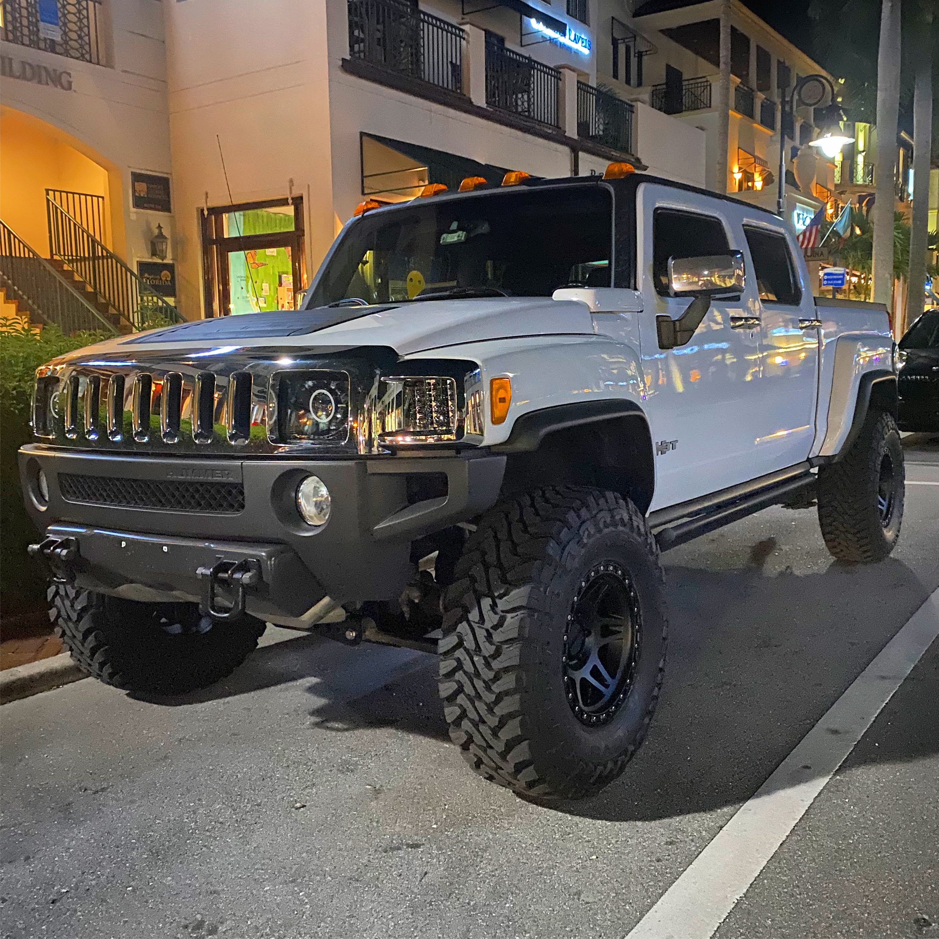

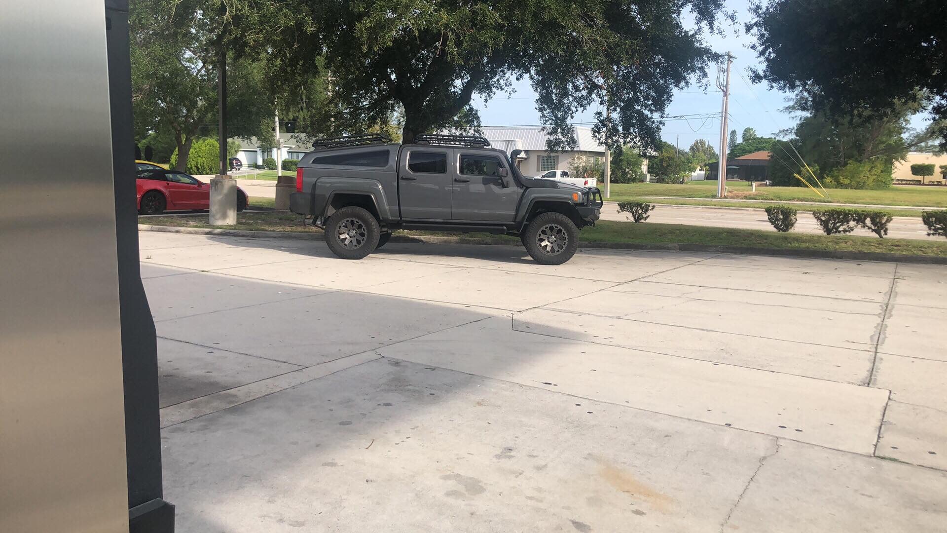

Local Sighting - Badass H3T
Saw this badass H3T not too long ago. Not sure if he's local but boy is his rig sweet.
Anybody know him?

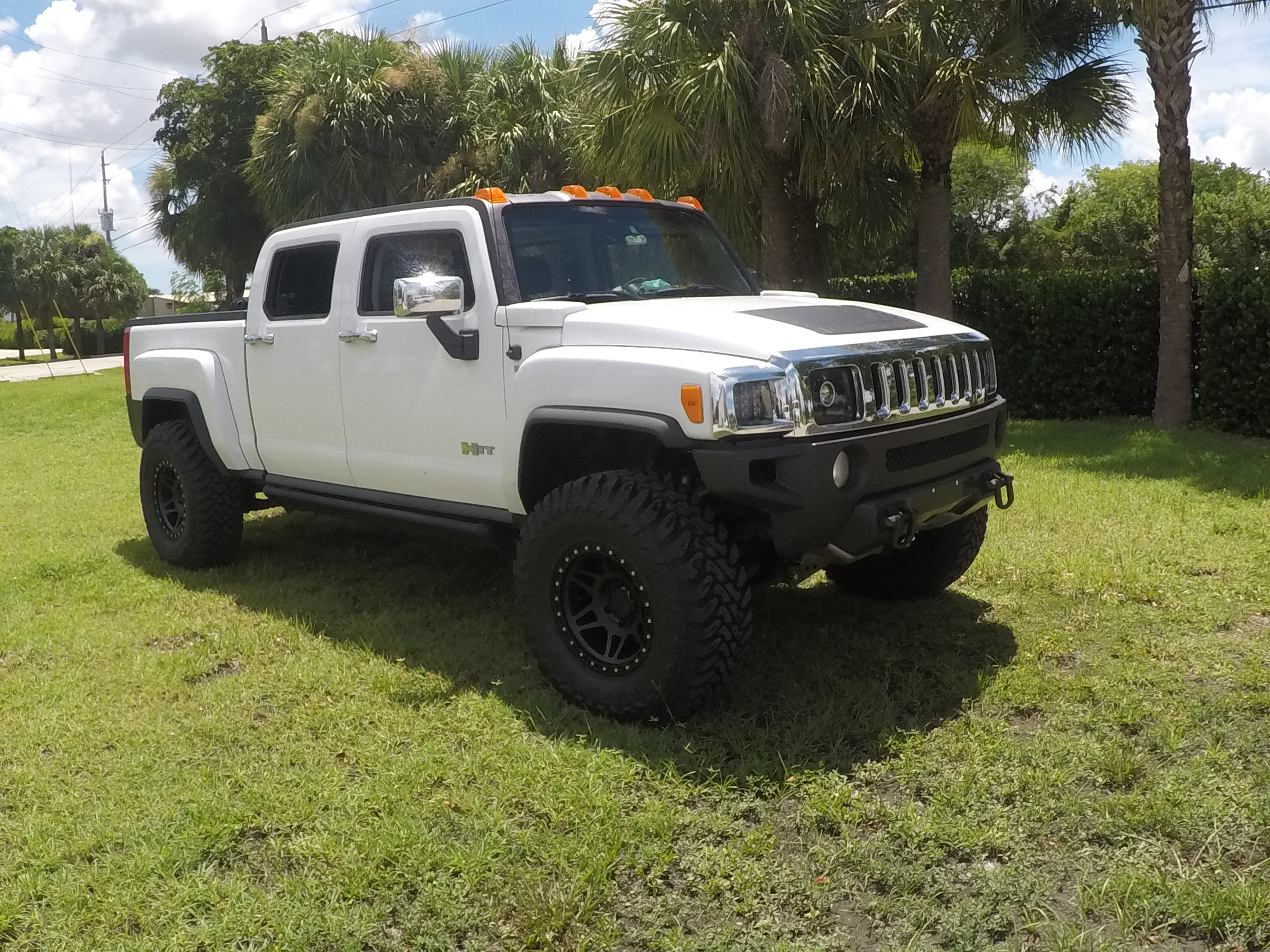

The Duke's New Look
This was a bit of a spa day for the Duke.
All of the trim on the truck was getting a little weathered, and the front A-pillar trim pieces most of all (like on all H3s for some reason). I kept applying plastic trim restore and honestly, they don't last that long after a detail and takes time to apply. So I looked around and found this trim restore paint from Dupli-Color. Yes, it's a trim paint and not restorer.
Even in the picture you can see how weathered the bed trim is and I wanted to make the truck look as close to new as possible.
​So I began by removing ALL of the trim pieces from the truck. Bed rail trim, rear bumper, tailgate inner wall piece, tailgate outside bottom trim piece A-piller, fake hood vent, roof rack trim & rear cab trim. Only two items I didn't do was the front bumper (new from previous damage), and fender flares because they both looked decent already.
Rear end trim pieces almost all removed here.
Once I removed the trim pieces, I laid them out and washed them with some water and degreaser prior to paint and let them dry in the sun. Notice the difference of fading on each piece. Soon they will all be consistent!
I couldn't find all of my pictures of this process because they are spread out between my phone and GoPro (and I did this a long time ago lol) but I also masked off the whole vehicle except for the bed and trim-painted the plastic bed and even the auxiliary fuel tank after degreasing them. I know the paint is not meant for the tank but I didn't want to drain and unbolt it. Has held up well so far, and if it starts peeling or coming off then I'll remove it and properly paint it or powder coat it black.
Once the bed was done, I moved on to these. I got lucky and scored a set of the roof marker lights off of eBay. Wasn't the cheapest purchase for what they are (basically just plastic pieces) but I always wanted them to complete the look of the truck. Whoever had them didn't install them right on their A-pillar trims, so I decided to dremel out my own A-pillar pieces and swap over the corner lights to mine. Here's how one of them turned out compared to before.
Couldn't find the pics of the install. But if anybody does this on their own then you will need riv-nuts and a riv-nut gun along with some caulking to seal the new holes you will be drilling into your roof.
Finally, after all the trim pieces had cured with a few coats of paint on them, they were reinstalled and a trip to my local tint guy was in order. I elected to go with a light ceramic tint on the front windshield and rear windows/rear cab window, as well as ceramic tint to the front windows dark enough to match the rears (since the rears already had privacy glass from factory).
Here's how it came out after a wash and wax a few days later. Love it. The roof marker lights, tint and trim really freshened up the look of the truck in my opinion. Very happy how it turned out.

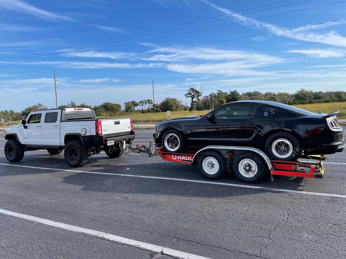

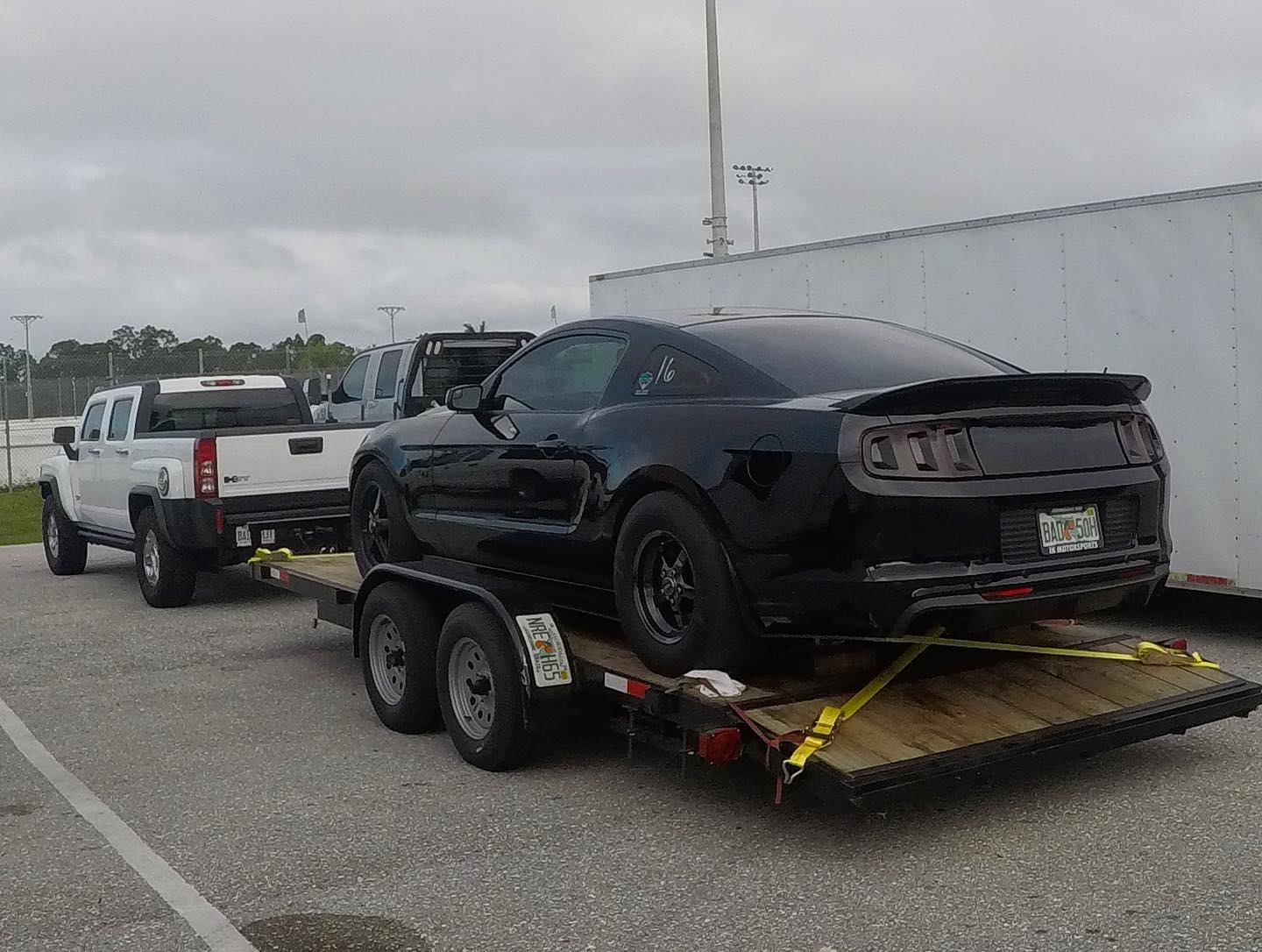

Trip to the drag strip using the T to tow the race car. The total weight is near the manufacturer limits but she seems to do just fine.

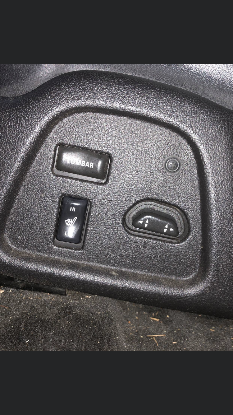

Around this time, I also did this mod to the lower side-trim piece on the drivers seat. Mine had started to sag and turn on my seat heater to High. Didn't take a pic of mine, this is one that I found online to address the issue. You put a screw in through the trim panel and into the seat plastic behind it to keep the panel from slipping down.

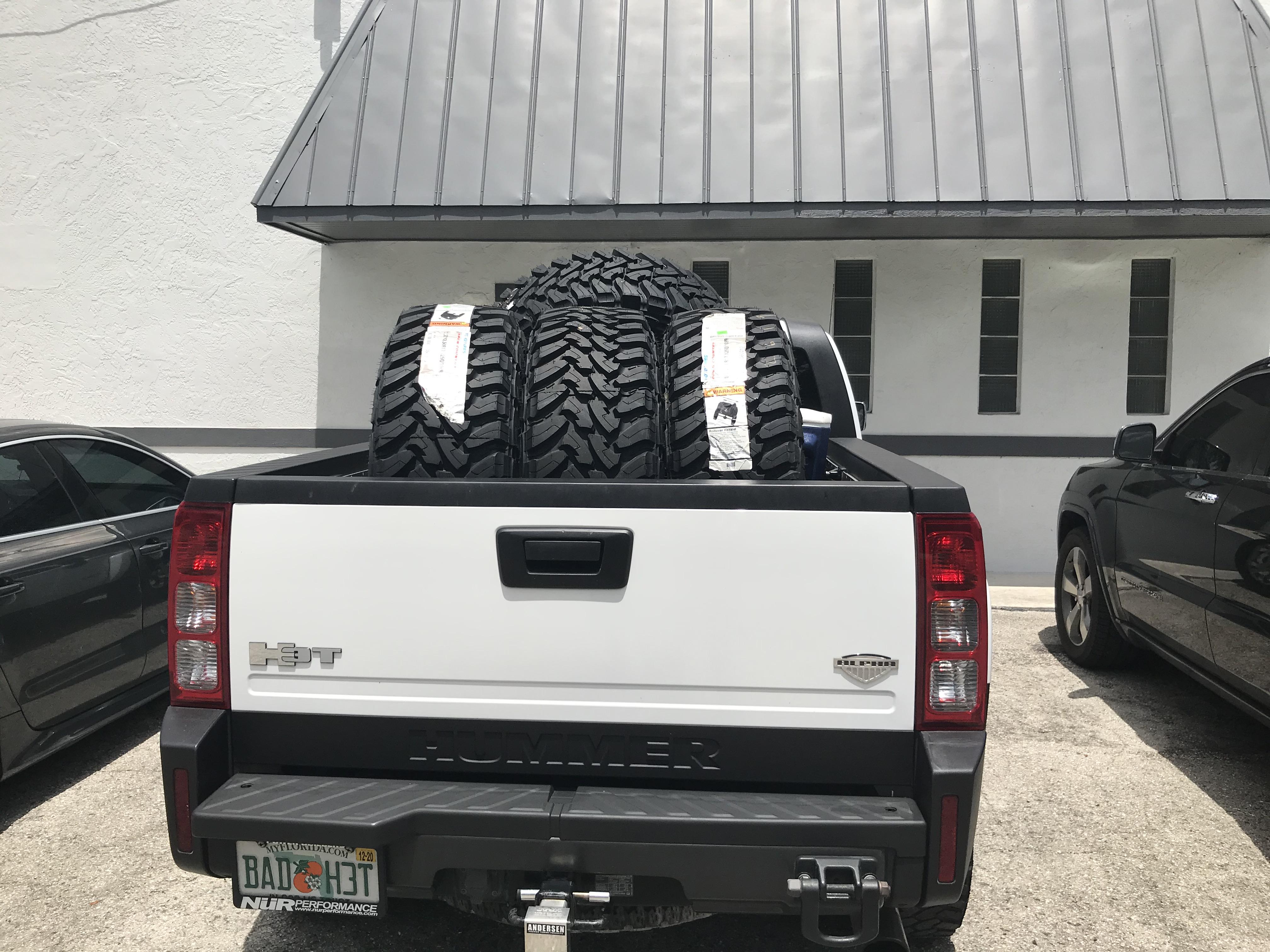

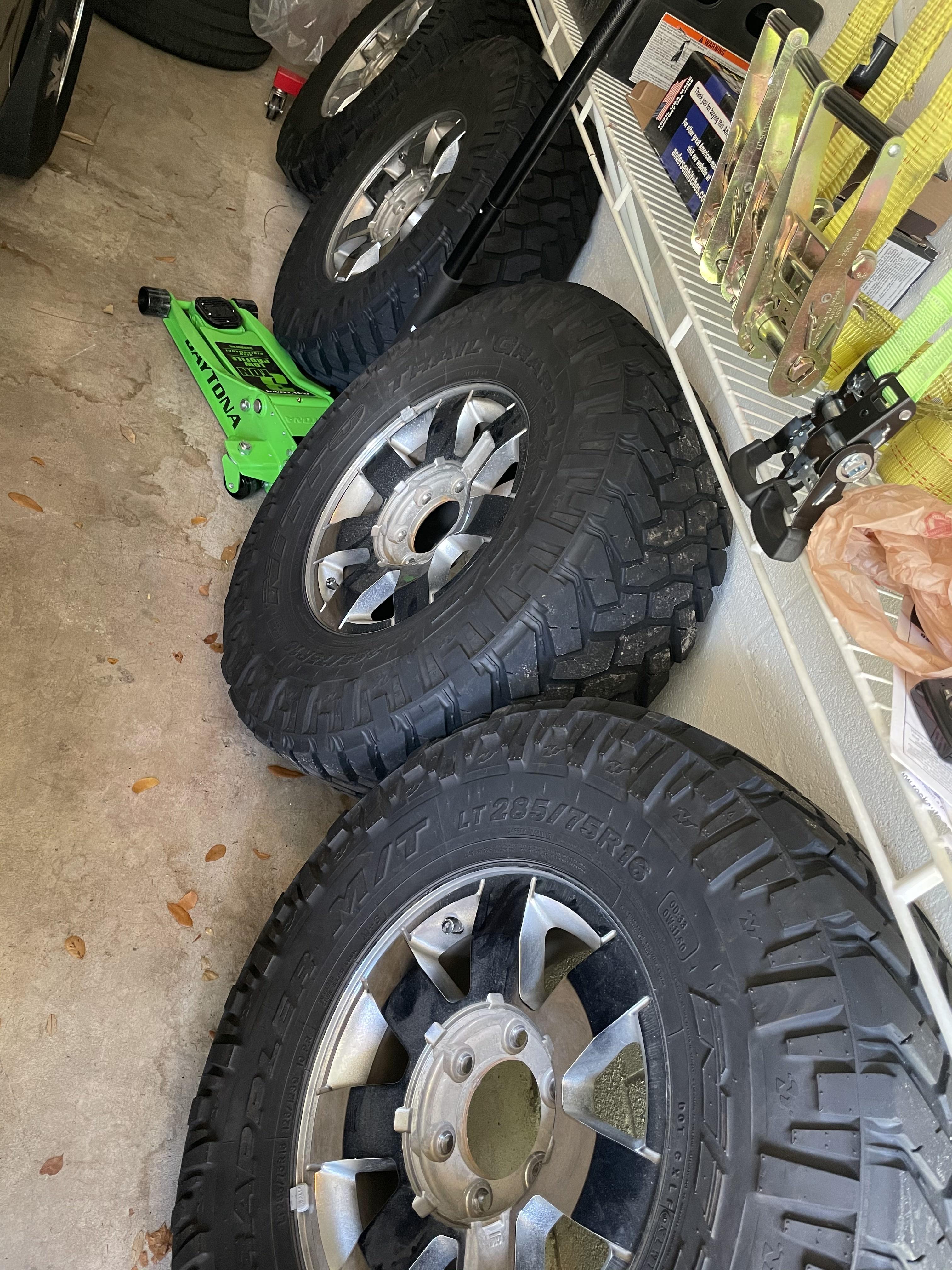

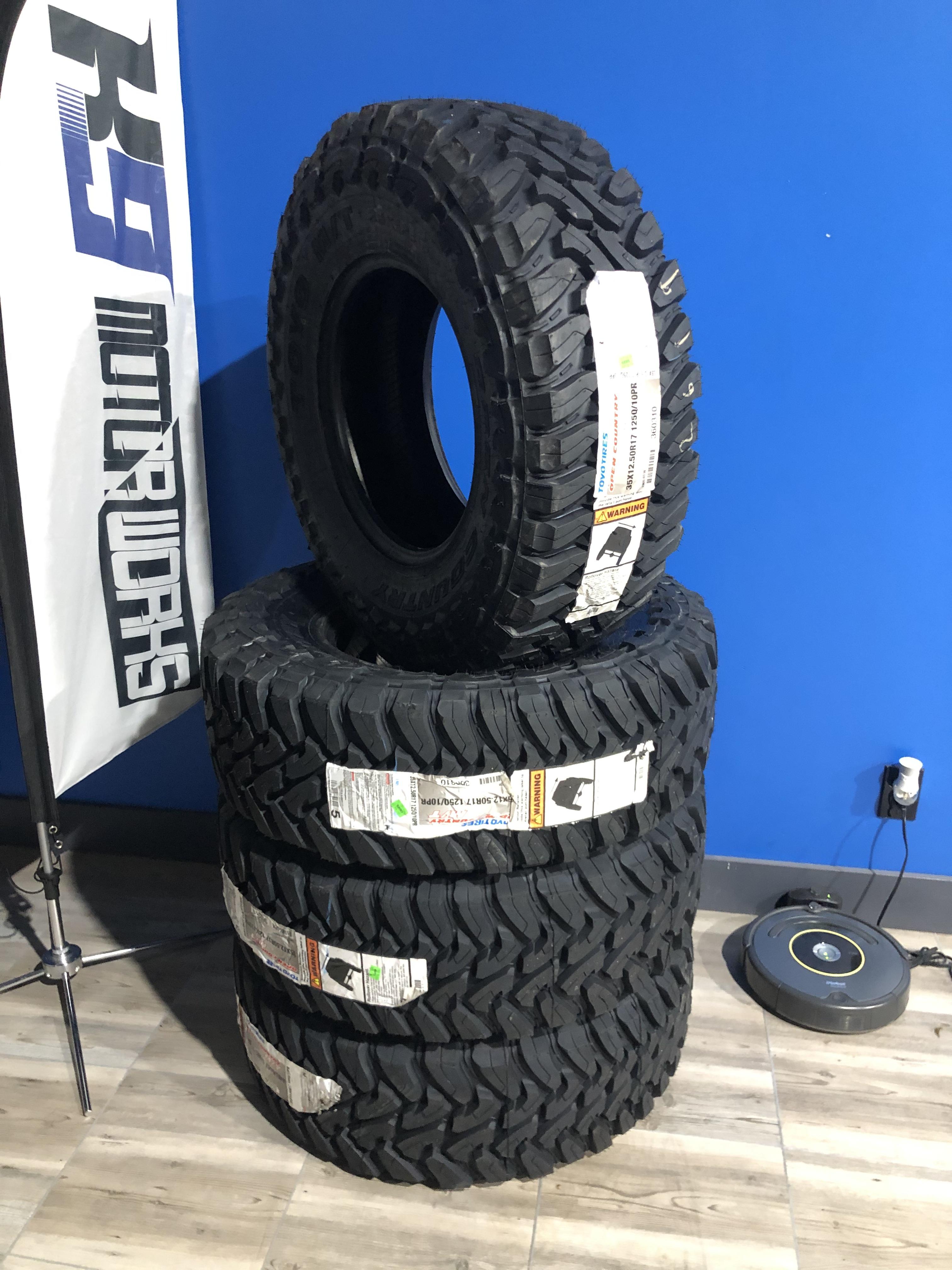

New tires showed up for the lift install. All loaded up for their temporary new home until the lift goes on.
I went with 35.00x12.50x17 Toyo MT tires. They are a bit heavier than a Trail Grap in the same size fyi, but sturdier construction evidently. Really wanted to go with a 37" tire but since I love to daily drive this thing, I figured to table that idea lmao.

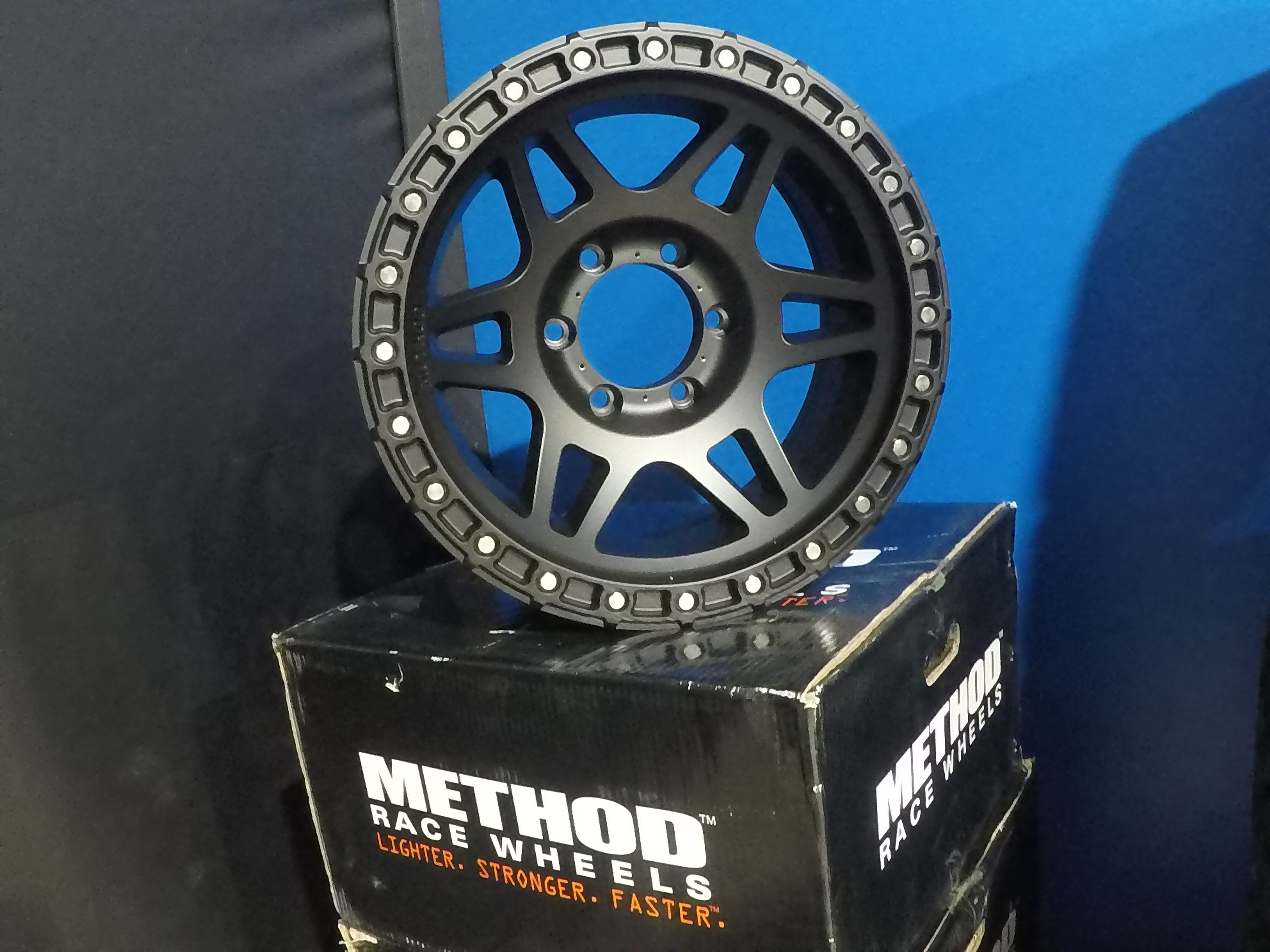

And here are the new wheels! I absolutely love them. Method Racing 312 in matte black and made from solid A356 aluminum.
Left these with my buddies over at K9 Motorworks to mount and balance for me.

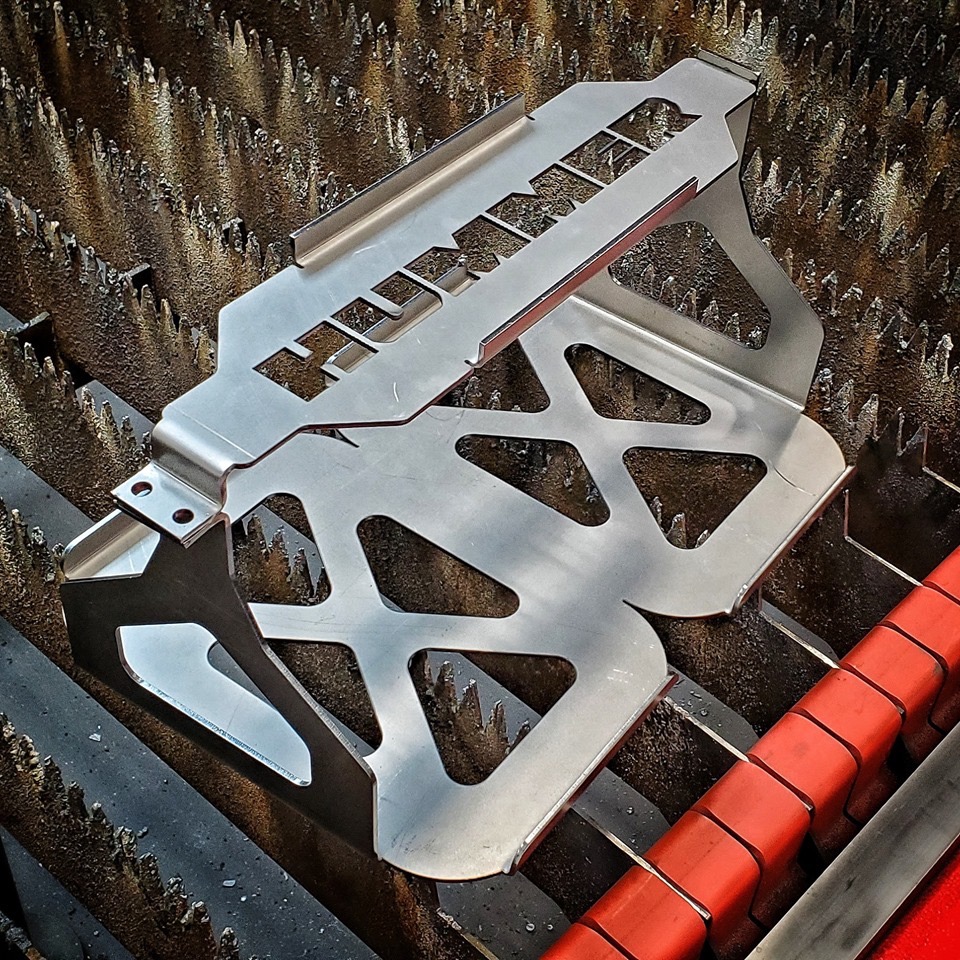

Also pulled the trigger on the Lased Designs dual Optima battery tray. Needed to replace the battery anyways so I purchased two and installed the new Optima Yellowtop in the truck. Mine is still wrapped up and in the box, here's a pic of how they look from German of LD. I need to get around to installing it, the battery and tray have been sitting in my garage for quite a while now lol. :no: Still deciding on what color to powdercoat it. Probably white or black. Hmmmm...

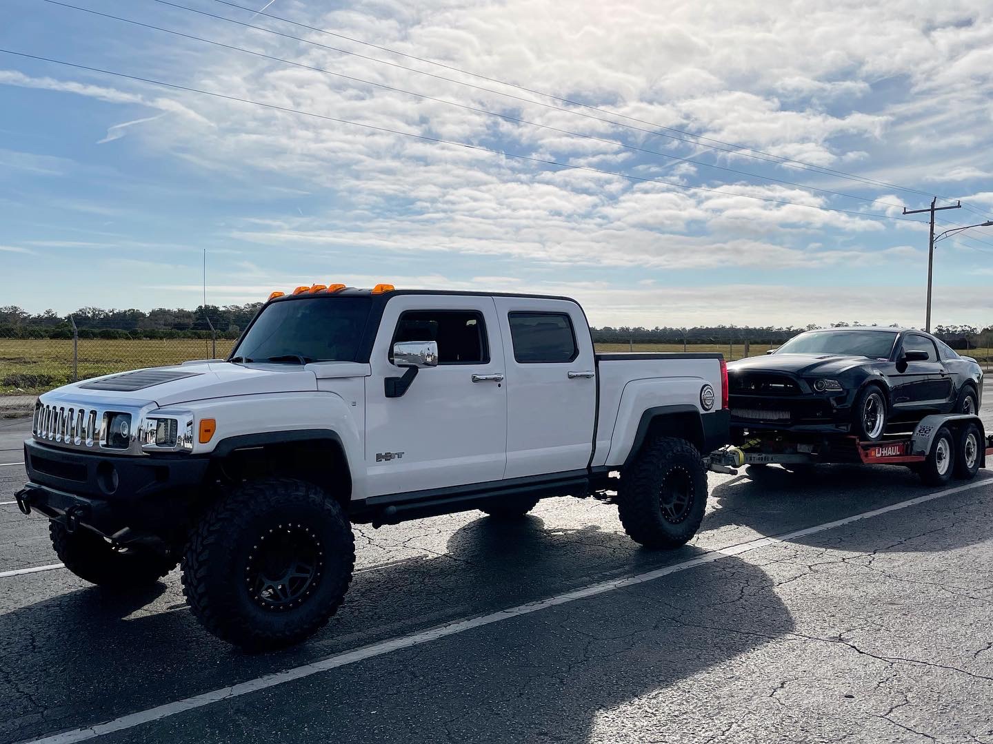

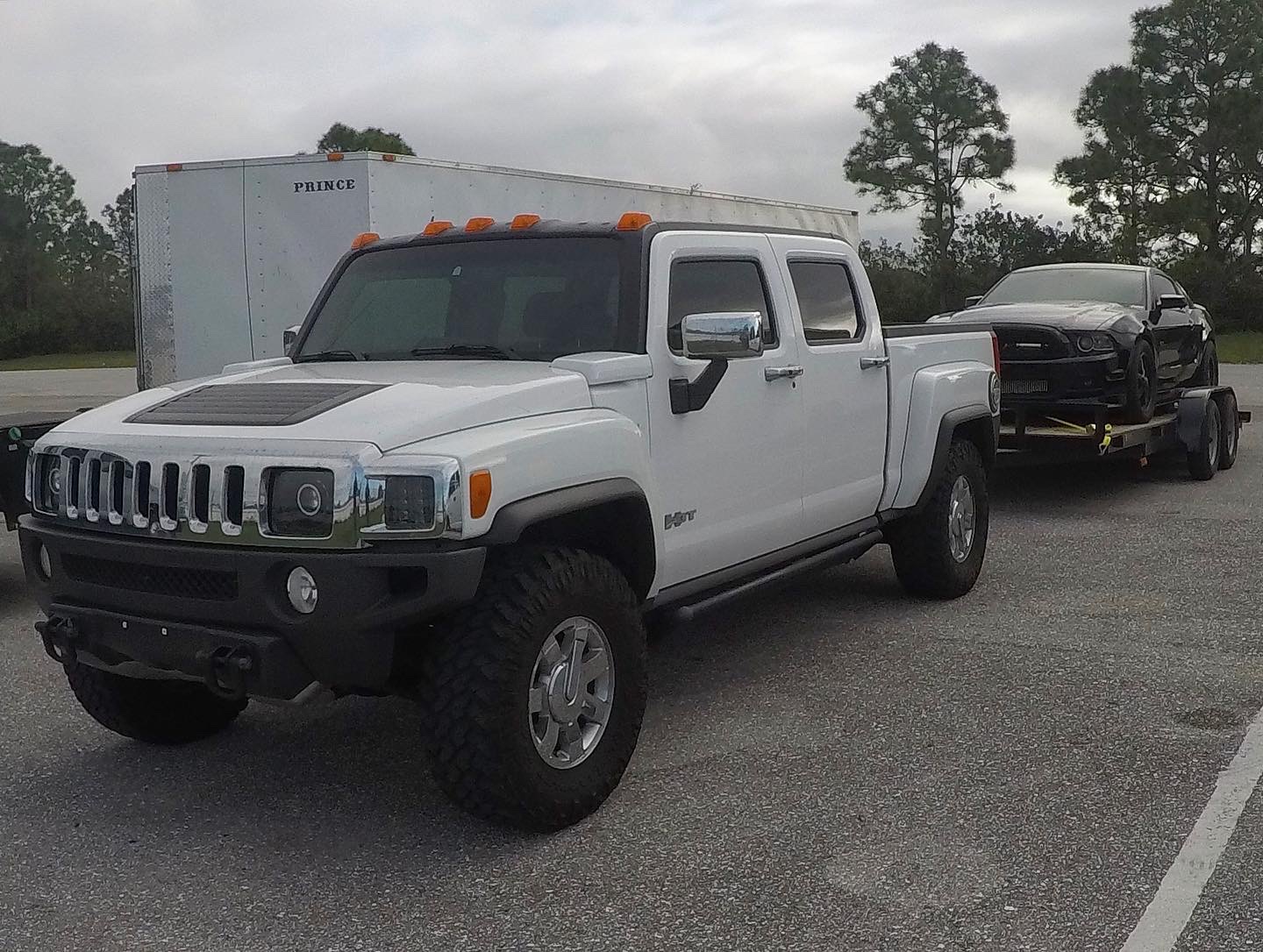

Another track day excursion with the H3T as the tow pig.
I think The Duke looks extremely sharp pulling the race car behind it. Plan is to continue to use it and make a few changes to help towing in the future.

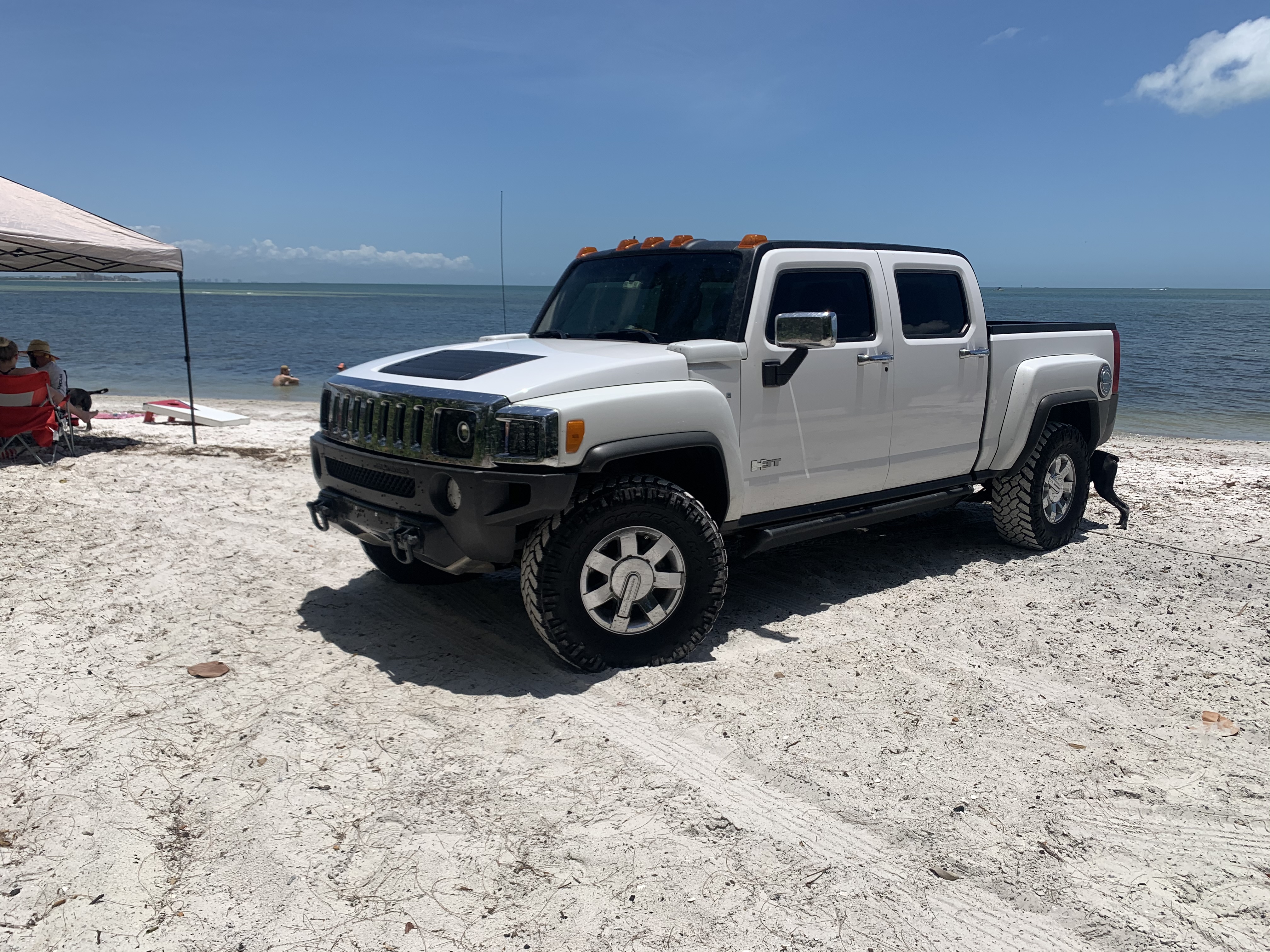

Then, a beach day with the T. Lazy summer day at the beach was long needed and right about now I could use another

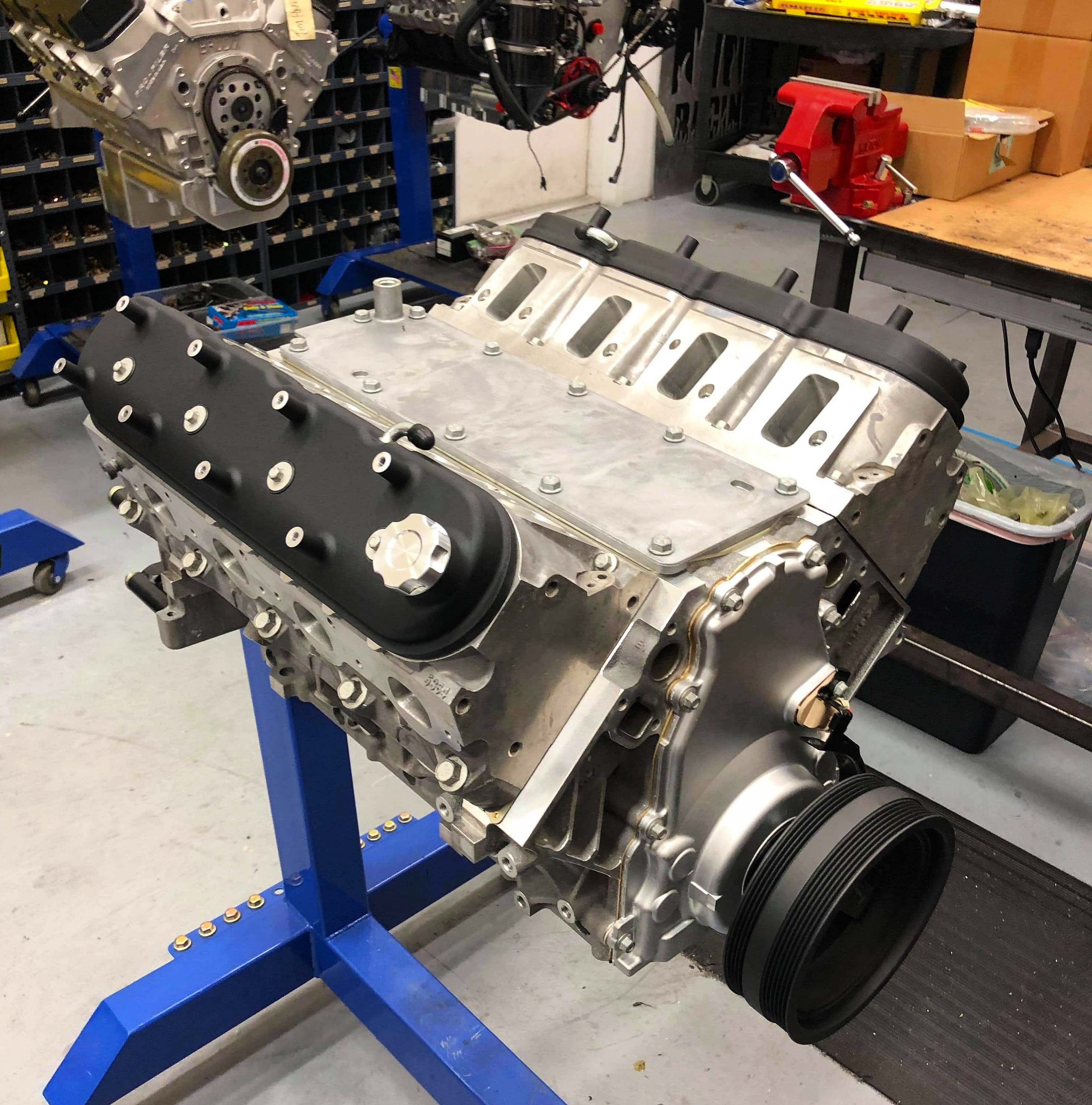

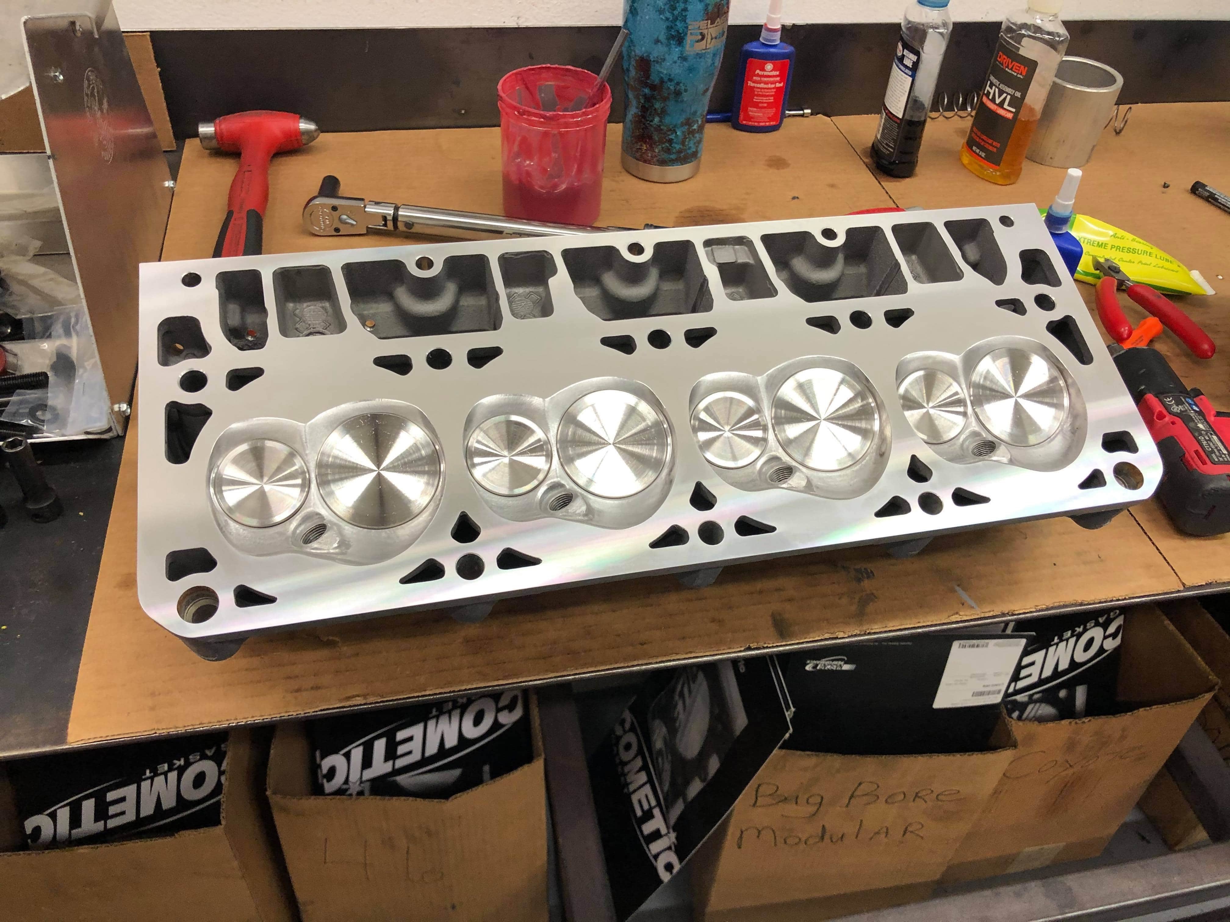

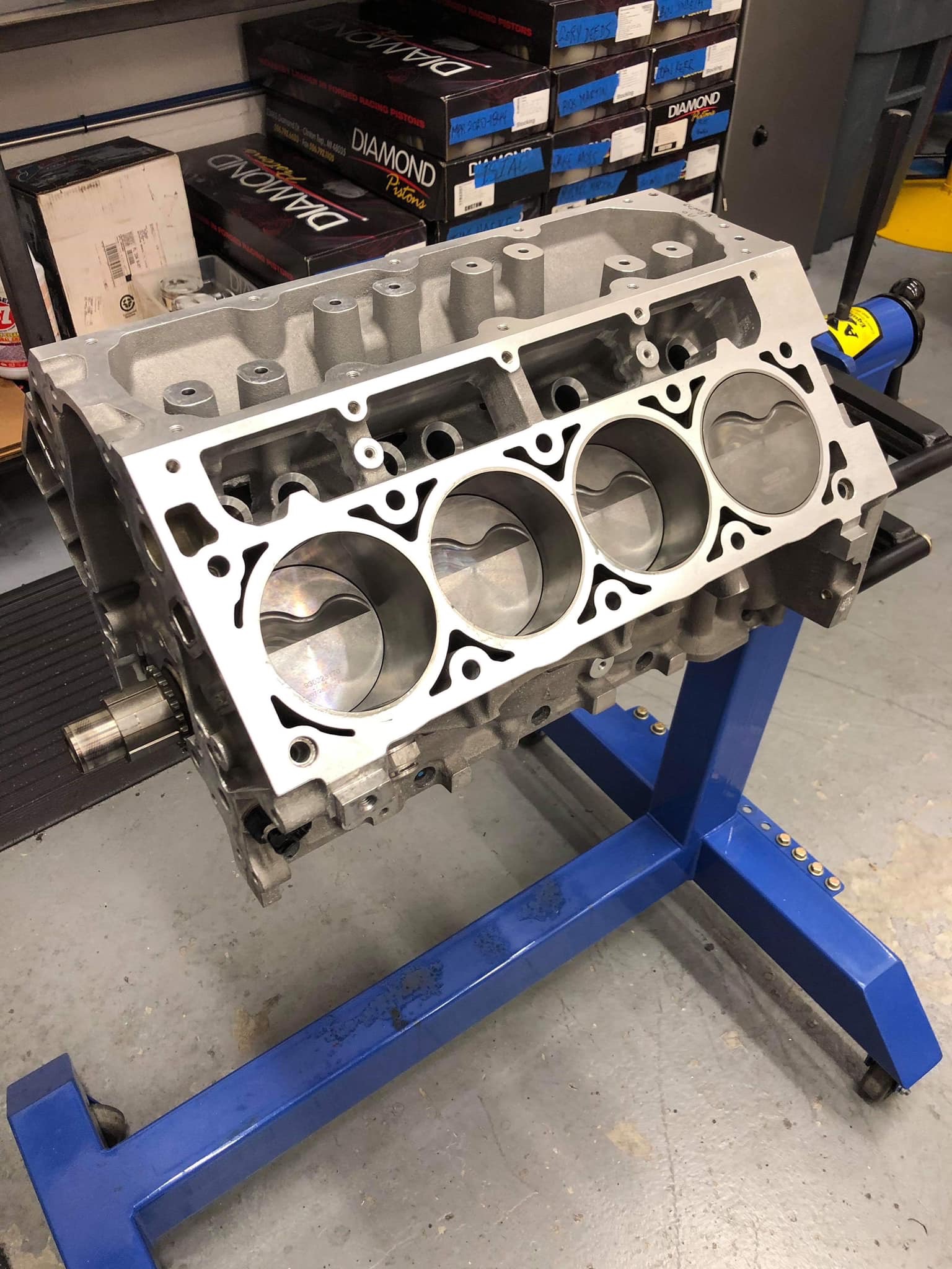

New custom built 6.2L LS3 short block is done. The rotating assembly is rated to 1000 rwhp according to Tim, the engine builder, although I won't be pushing anywhere near that figure. The plan is to keep it N/A and take advantage of the extra torque and displacement. Eagle crankshaft and Mahle pistons. The pistons are just slightly under the compression ratio of what a stock LS3 slug has.

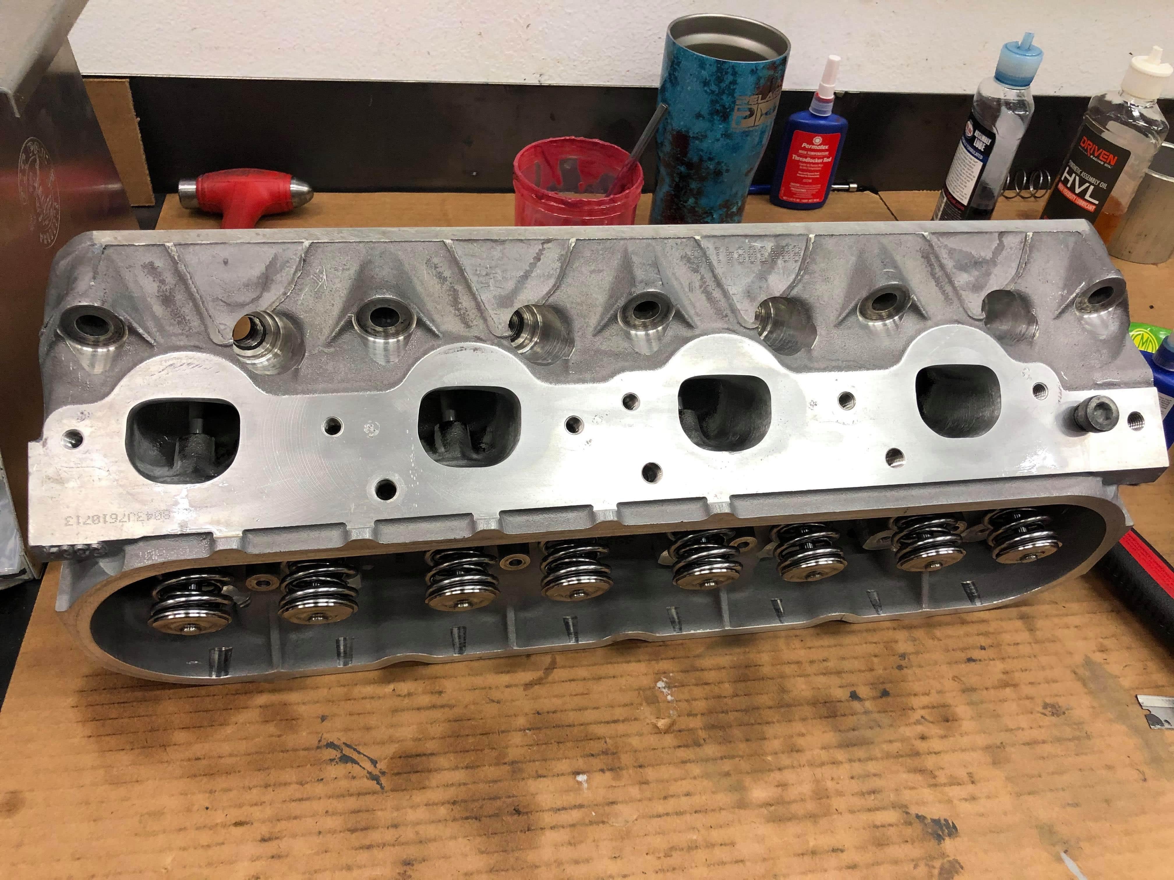

Heads are complete!

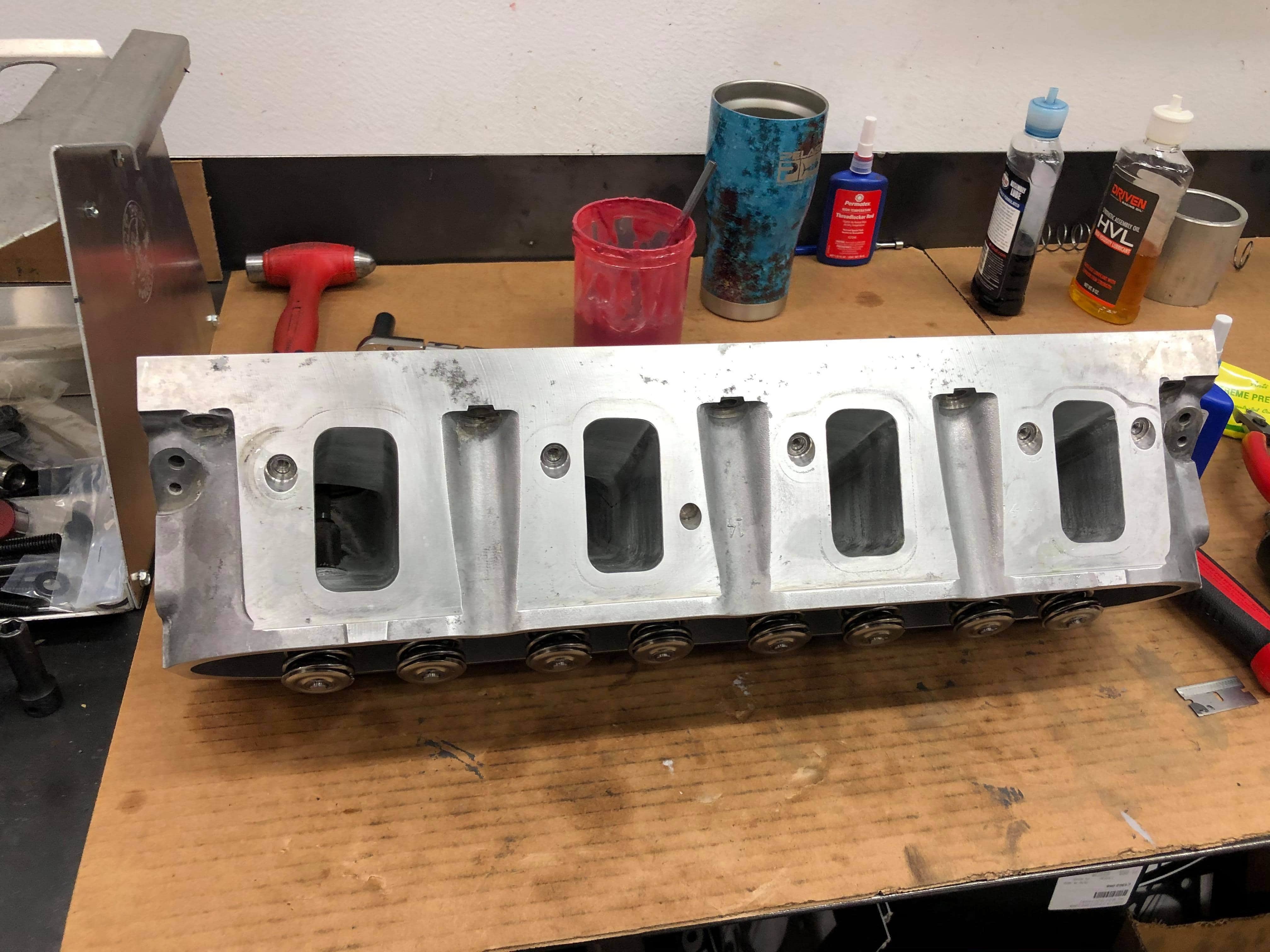

They are used LS3 castings that I had MPR port with Manley stainless steel intake and exhaust valves, and had the deck milled just a bit to bring back some of the compression lost from the pistons. With the new valve chamber volume, head gasket, and pistons, the compression ratio on this motor is going to be 11.2:1. In comparison, an LS3 engine has a stock compression ratio of 10.7:1. So the 11.2 CR is going to be perfect for an N/A truck.
It's a shame that I'll be covering these beauties up!
Here you can see the exhaust ports and the BTR Platinum dual valve spring kit installed. They are good for up to .660" of lift.
And the view of the intake side with the ports cleaned up a bit by MPR. Should flow quite nicely.
And finally, the completed long block assembled.
Has a new front timing cover with new sensors, new crank pulley (didn't see the need for an aftermarket high performance one in trucks intended use, Melling high output oil pump, and some nice matte black Holley valve covers that delete the ugly looking coil brackets. The valve covers put the coils at an angle and comes with a billet oil fill cap. Probably forgetting something but if you have a question, ask away.

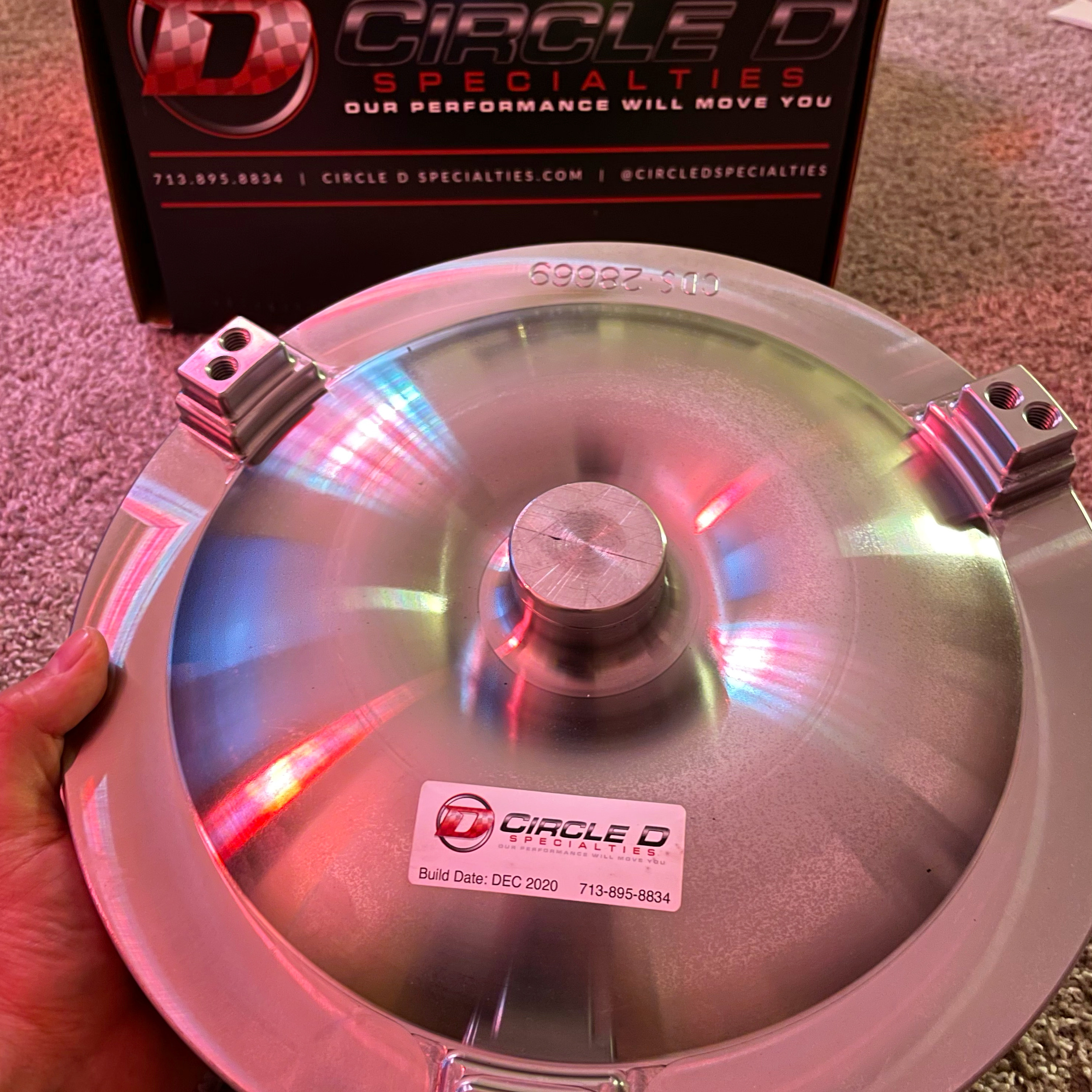

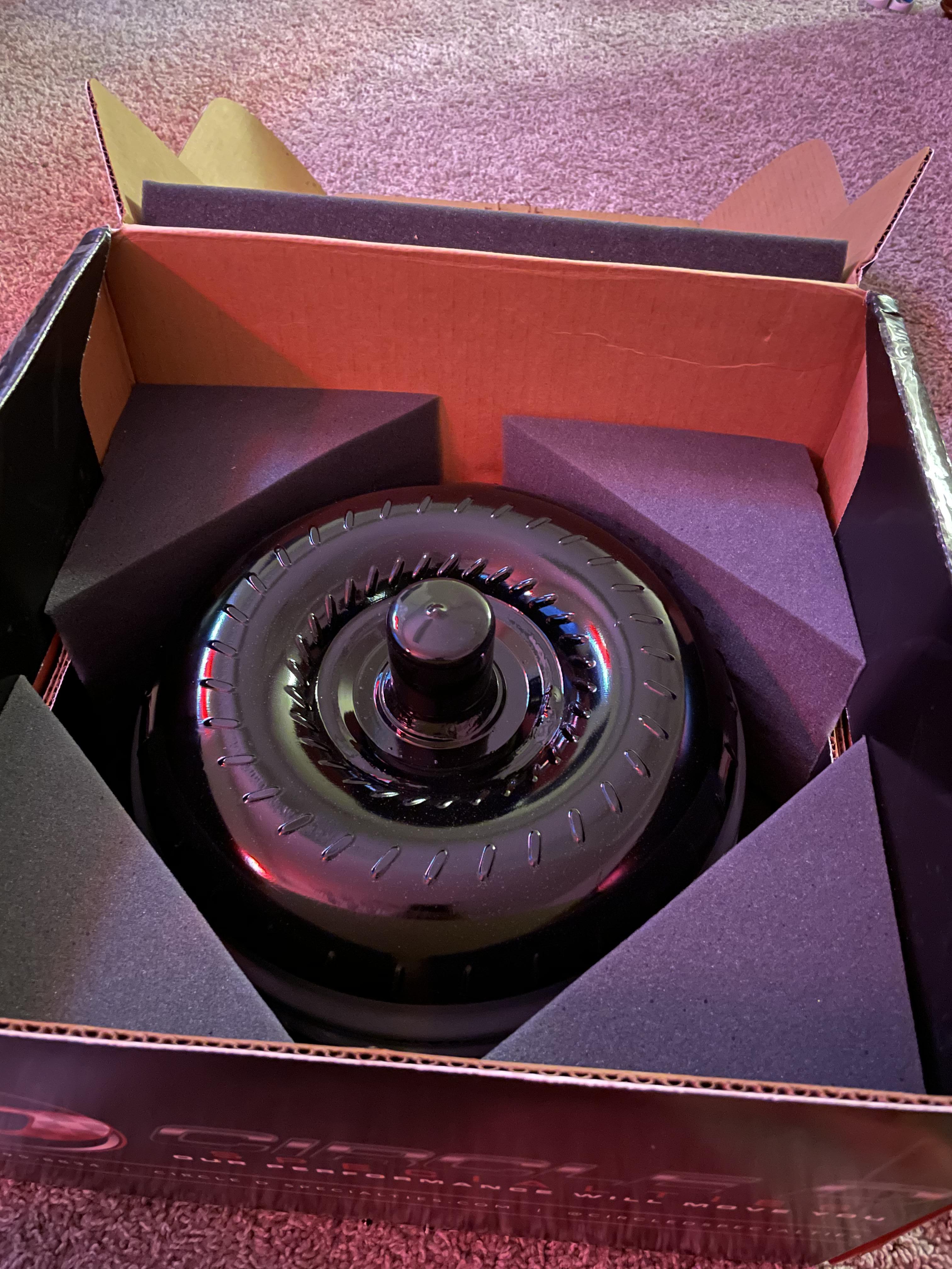

Pretty much up to speed on the motor stuff. Next steps are to order a new converter and start compiling parts to build the transmission during the engine swap. I have no doubt in my mind that it'll break with the newfound power if I don't build it. I've spoken to a few people that have broken these 4L60E's and 2 that have done the 6.0/6.2 swap and will definitely be purchasing new high strength parts like hardened input/output shafts and upgraded sun-shell and planetaries.
Fun fact that I thought I would throw in... The stock Alpha 5.3L LH8 has a compression ratio of 9.9 to 1. Realized that I never looked or included that figure in the post. 9.9:1 isn't awful... but I'm not sure why they didn't have more compression in these truck motors from the factory. I'm sure they could last just as long or longer than the car-going versions.
Going from 9.9 to 11.2.... can't wait! :horns:

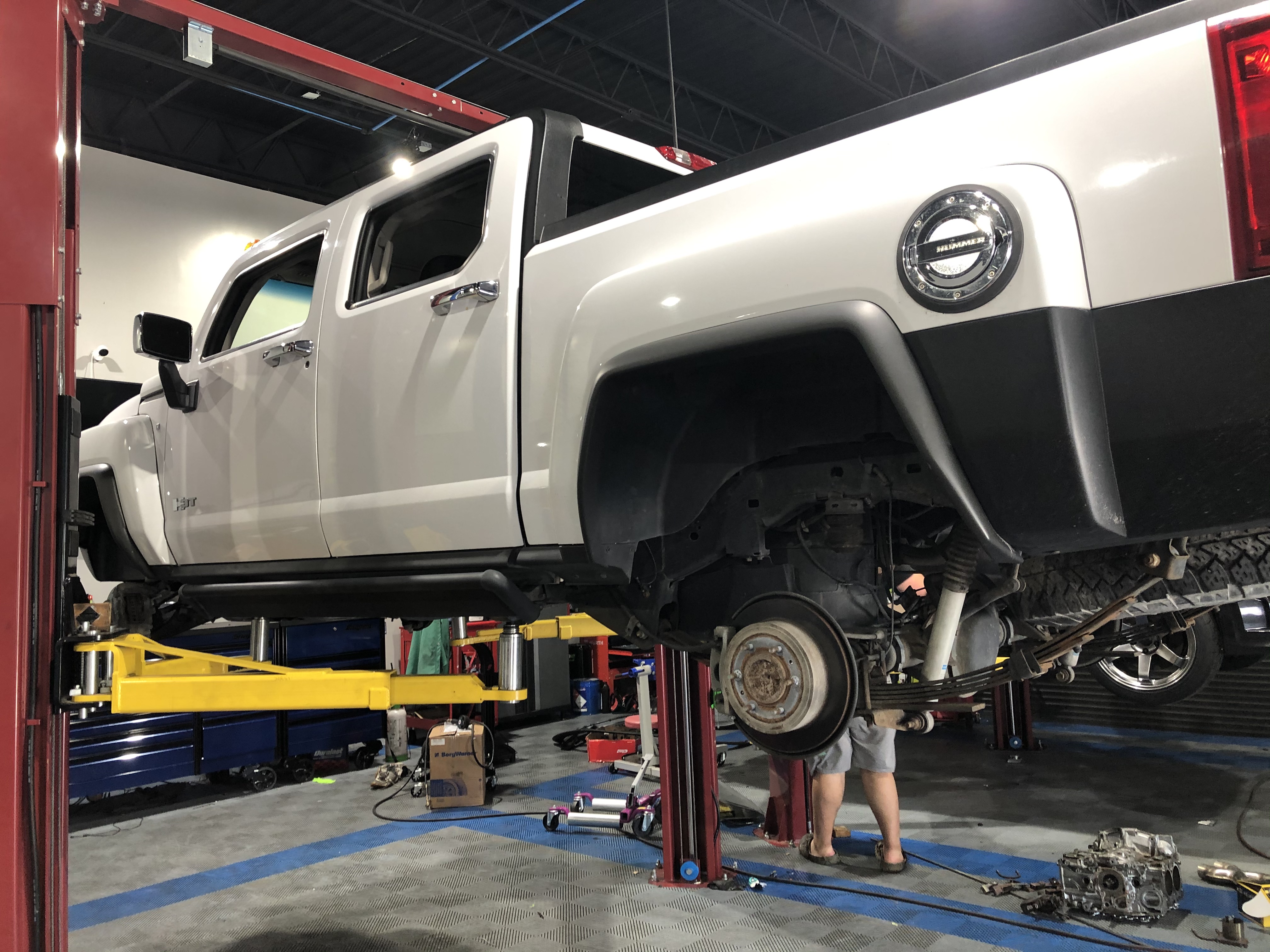

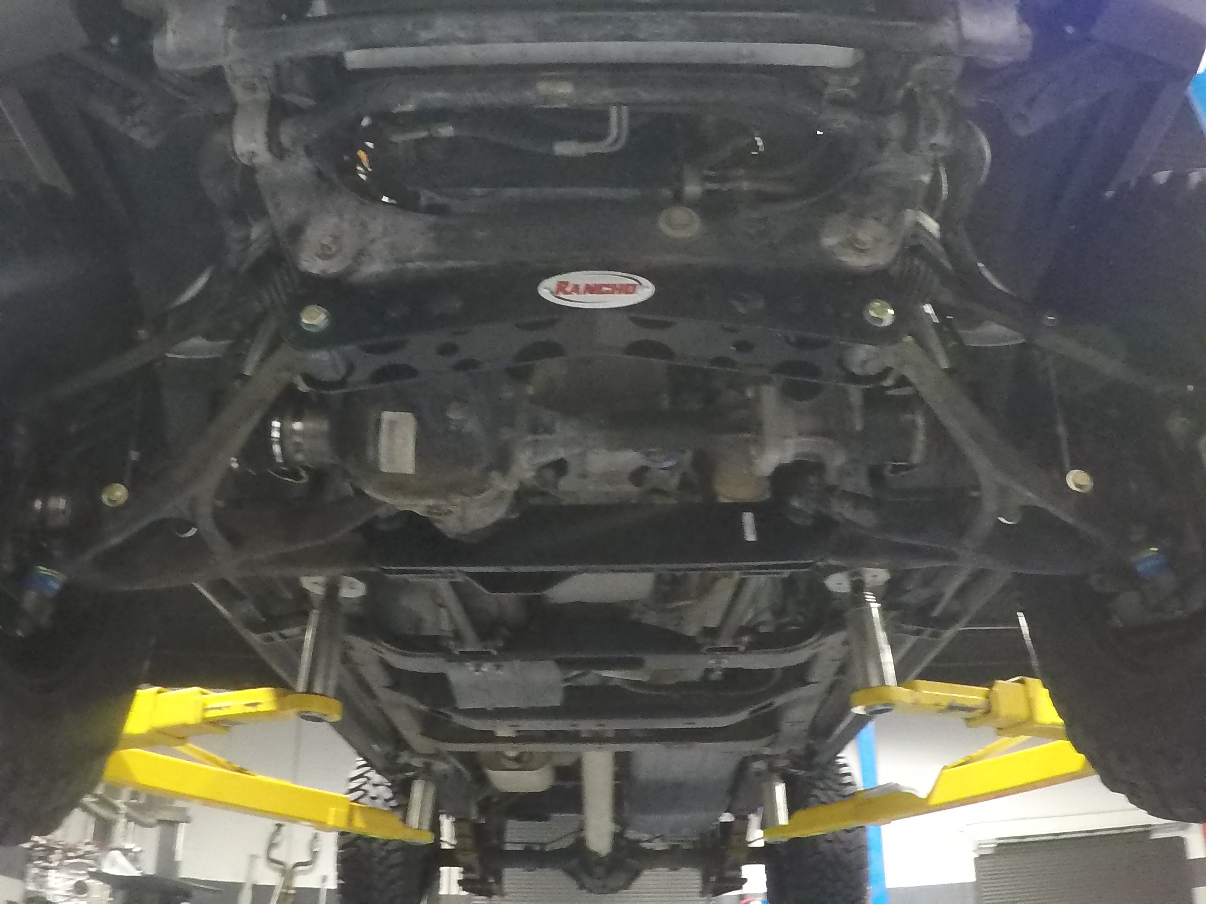

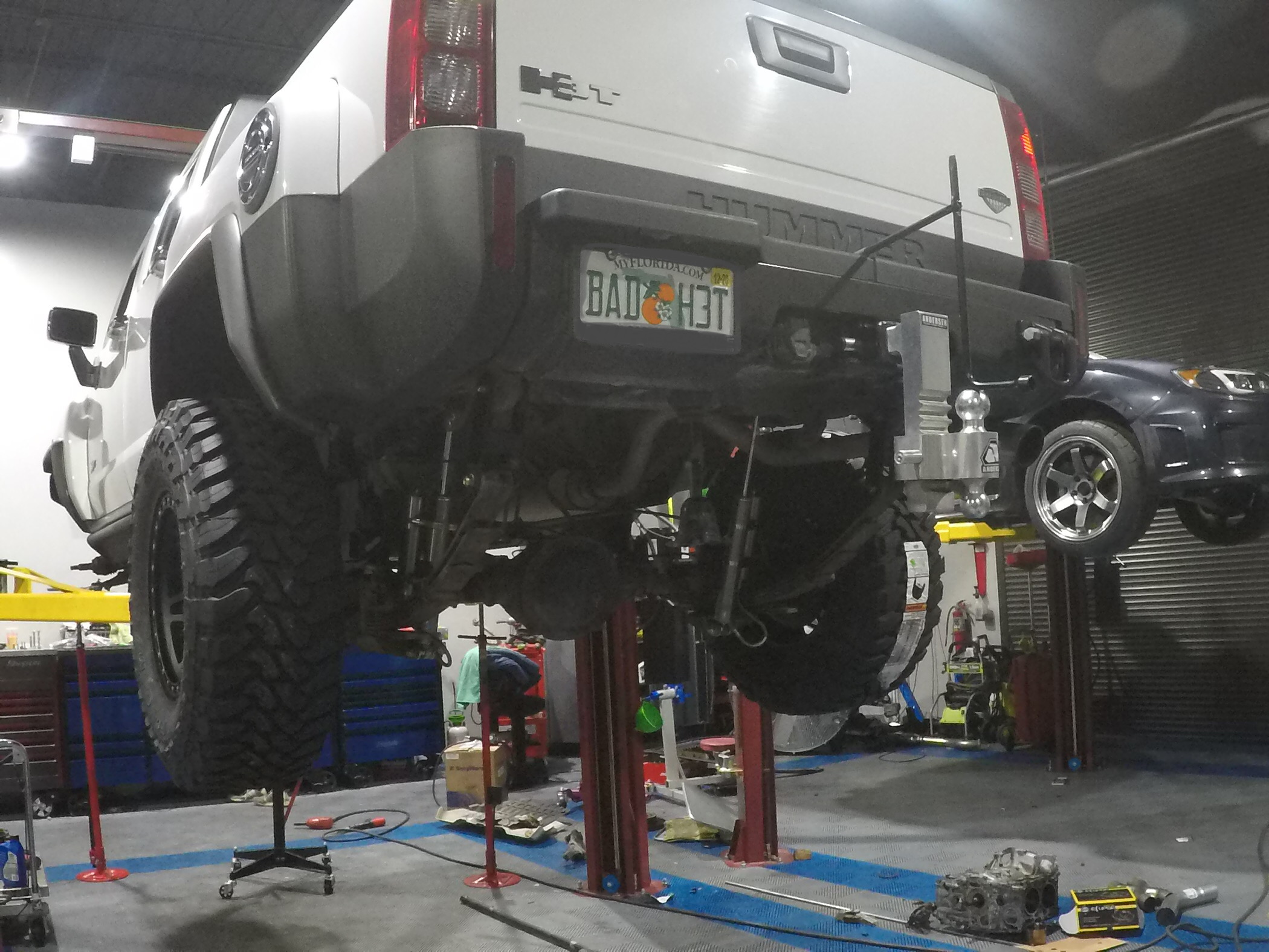

Time to finally install the Rancho 4" lift kit.
I was sitting on this kit for about a year and a half before I finally got off my rear and decided to start working on installing it back in August lol. And I should've done it sooner because it completely changed the truck, I love the way The Duke turned out.
I did this mostly by myself and with a help of a buddy for the first few hours. Really wasn't too difficult to install.

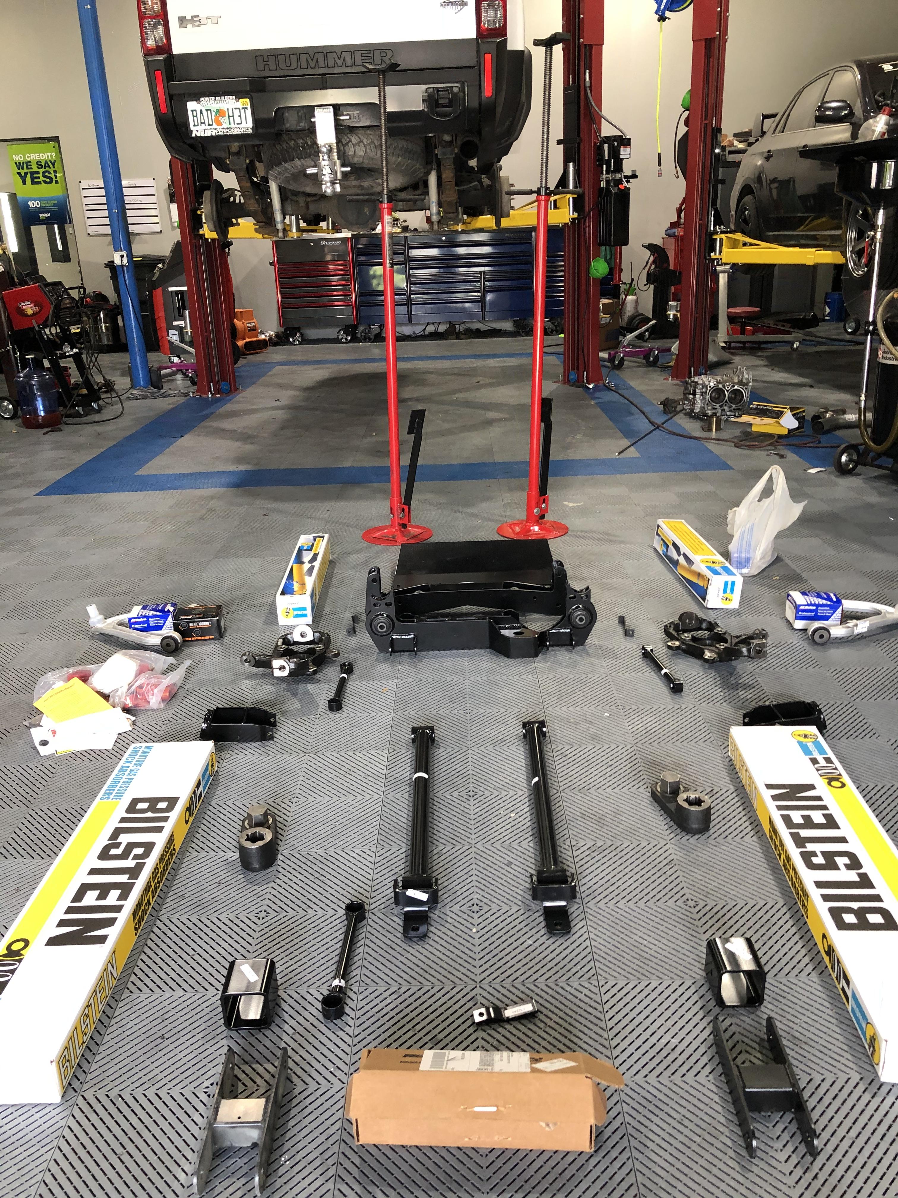

First thing was to lay out all of the parts get the truck on the lift & remove the wheels & tires.
In the kits that were found, they supplied longer shackles and an add a leaf to lift the rear (more on that later).

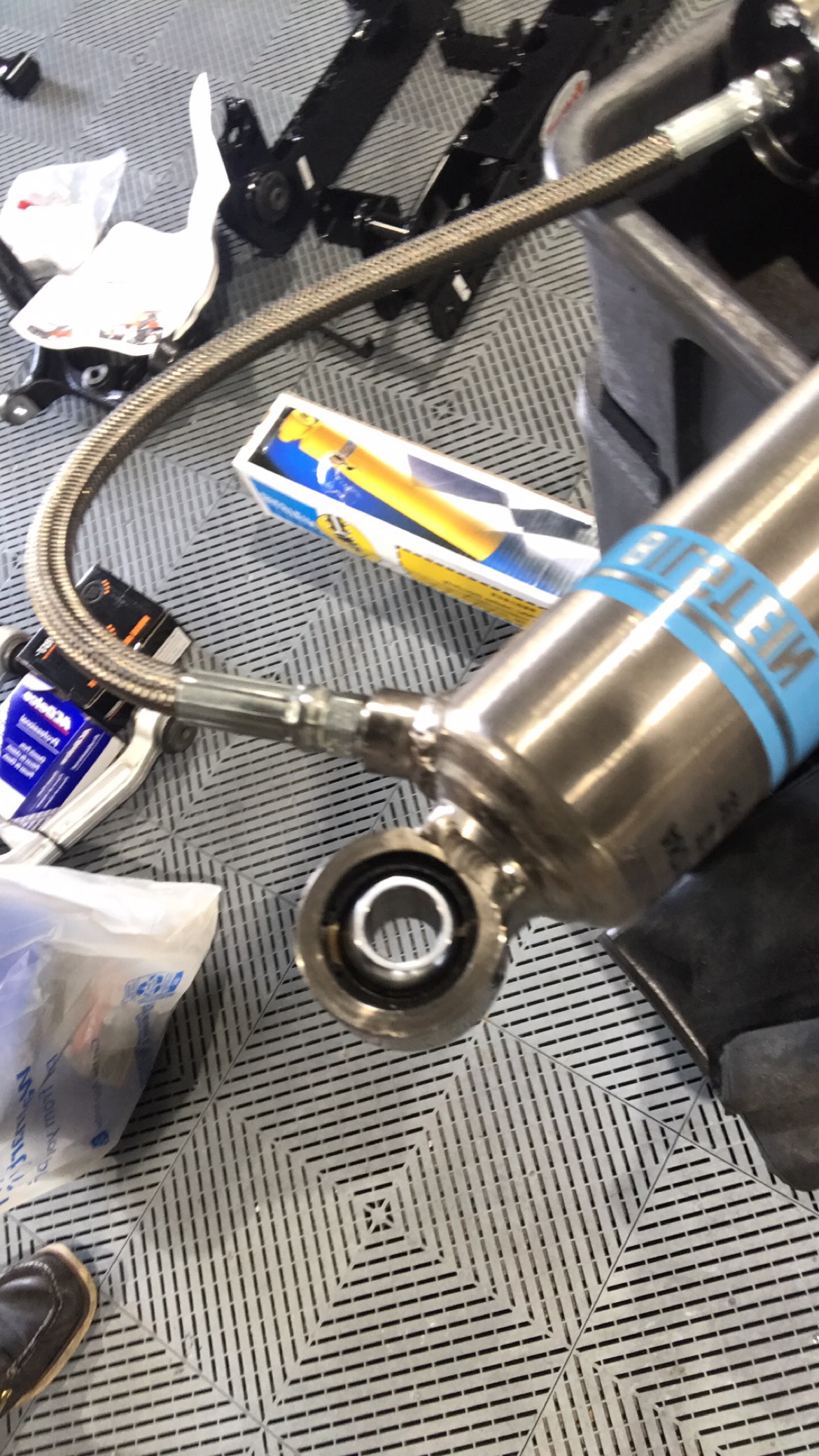

Non-Rancho items that I used were Bilstein shock absorbers with reservoirs on all 4 corners, new rear brake pads, new upper control arms, new ball joints for the lower control arms that are serviceable, and some Jeep shock mount adapters to adapt to the eyelet mounts on the new shocks.

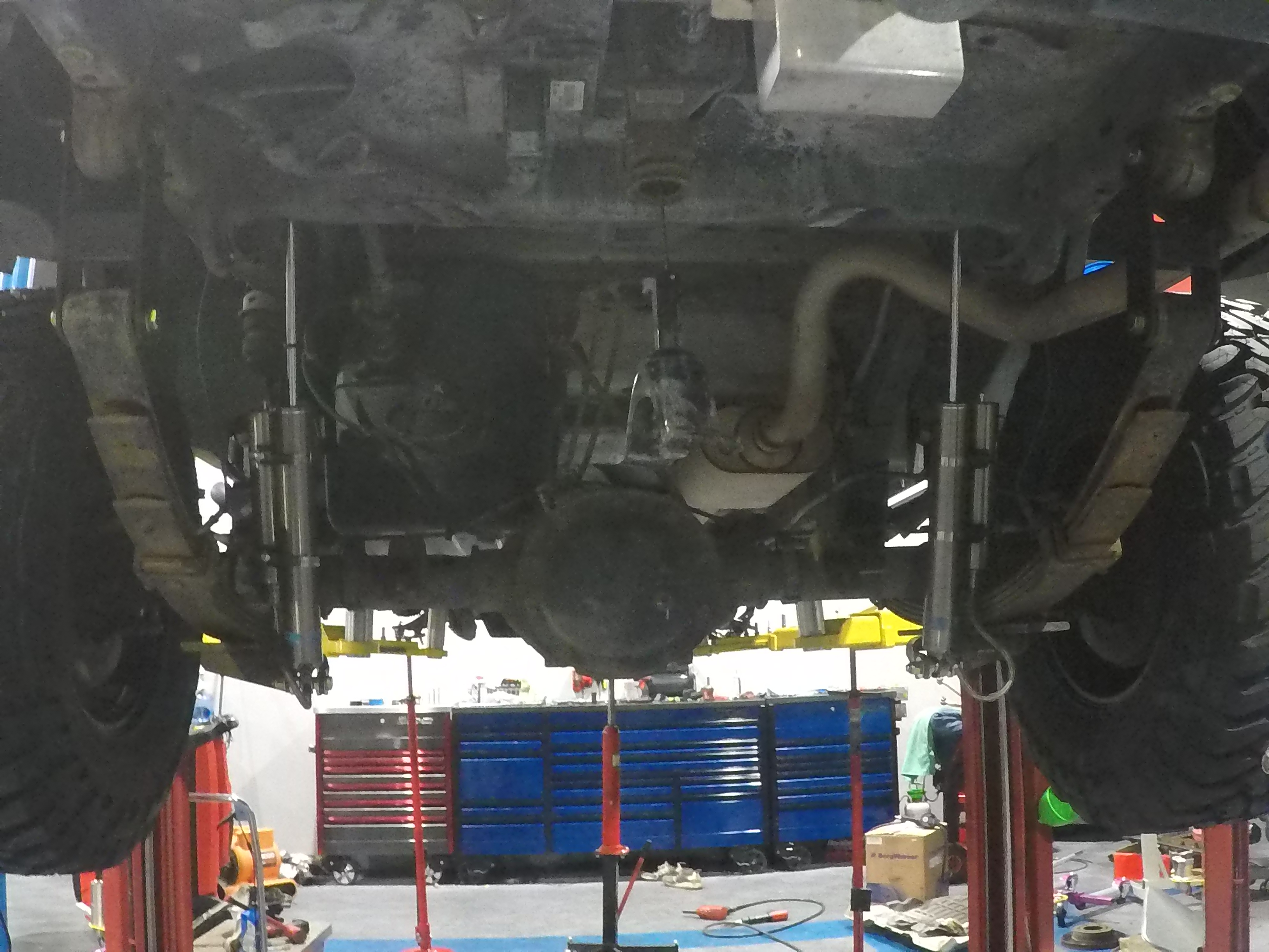

Started on the rear first to knock it out of the way since it is the easiest thing to tackle. Lowered and removed spare wheel/tire to gain more working room. Inspected the spare tire and it was showing signs of aging so I just threw the whole thing in the garbage. Have no use for that lol. On the positive note, the wheel had barely any rust on it.
I didn't take photos of every step (not that my photos are any good) but here is the rear finished*. New extended shackles installed, bump stop extensions done and rear shocks mounted. Here is where I ran into my first gripe. I ordered these shocks based off of my forum research and what reservoir shocks our fellow Hummer enthusiasts said would work. Do you see the issue here? Annoyingly, the placement on the reservoir lines prevented me from flipping them and mounting them the other way because the lines hit the shock reinforcement. As you can imagine, I wasn't too happy about that and couldn't return them because I bought them not long after buying the lift kit 298178298 weeks ago. The only way to run these was to have the lines dip down about an inch from the bottom of the shock which is going to be a BIG issue when off road. For the sake of finishing the install, I said screw it and will run these until they break, then buying the correct ones. Thank you to Shawn Townsend for getting me the part number for the correct shocks for when these break! And yes, they are bound to break at some point with my adventures.

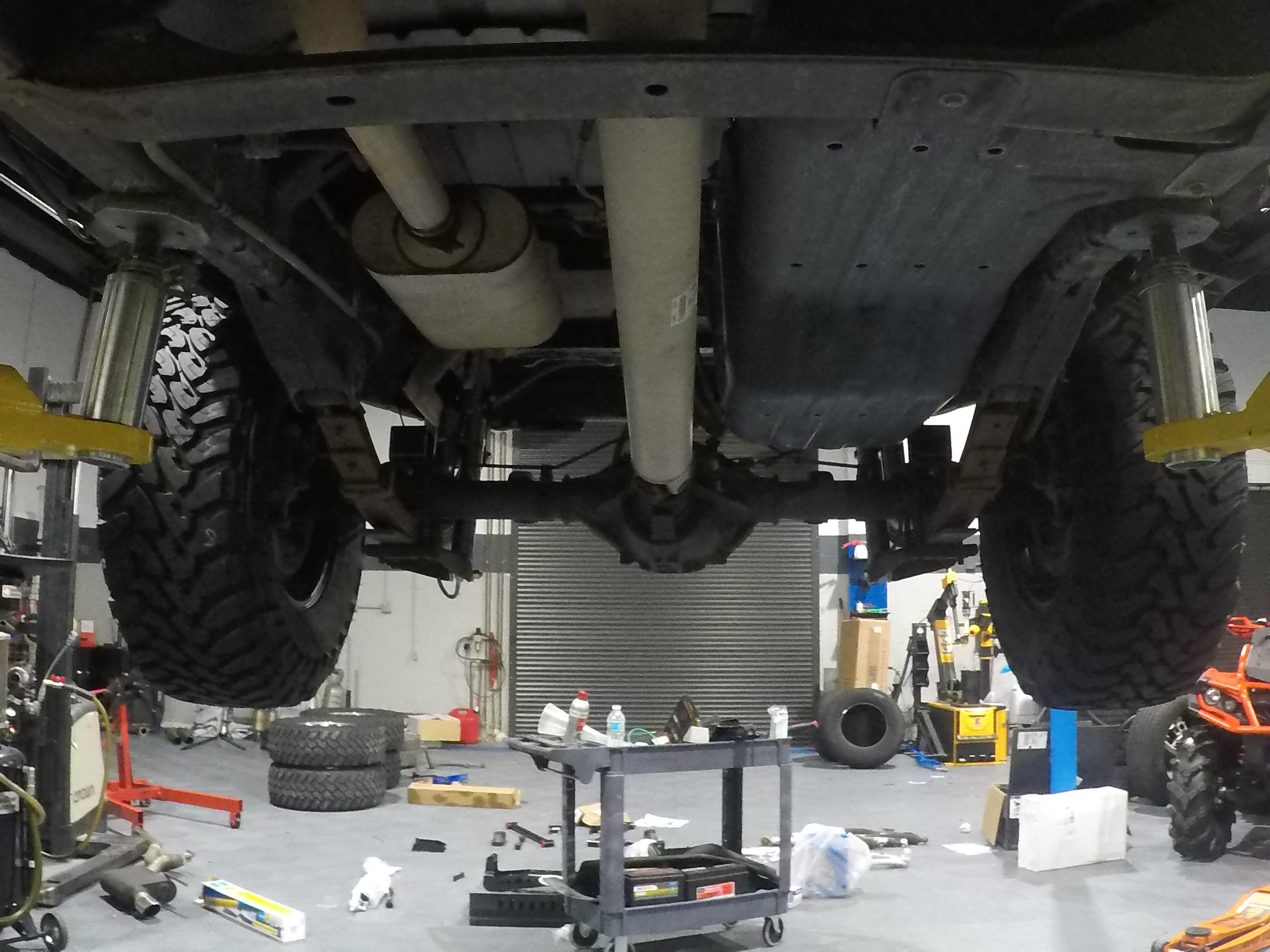

View of the shock. Instead of coming out perpendicular and then 90 parallel to the shock body, these just exit at a 45 degree angle and straight.

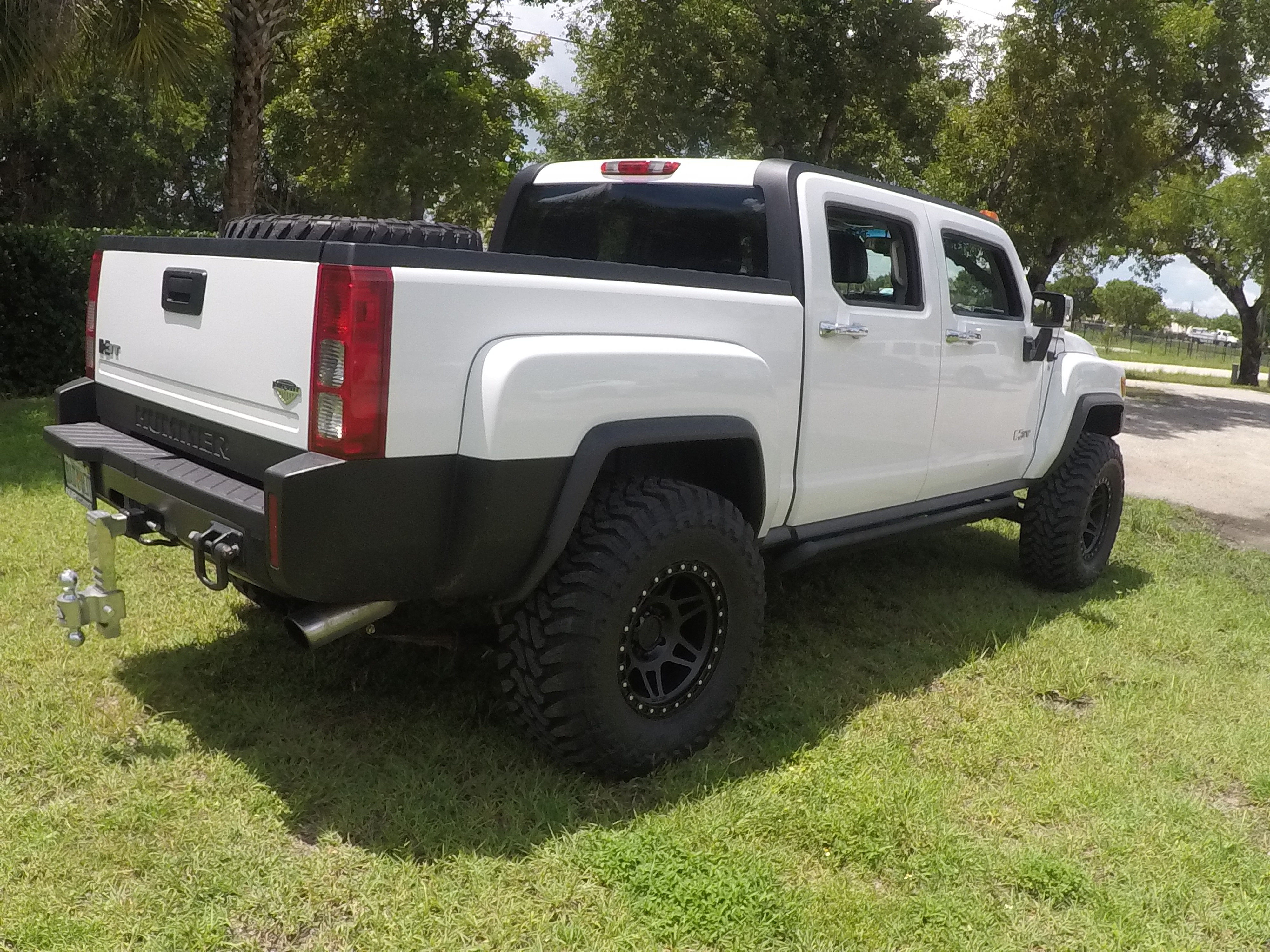

Rear complete and new wheels/tires mounted for test fitment. Minus the sway bar. My Rancho kit was missing a sway bar end link so I ordered up some JKS adjustable end links for a Jeep and re-installed the sway bar a few days later. I ended up liking the Rancho bushings better so I pressed the JKS ones out and put in the Rancho pieces.
Another view of completed rear and view of how far shock lines hang.

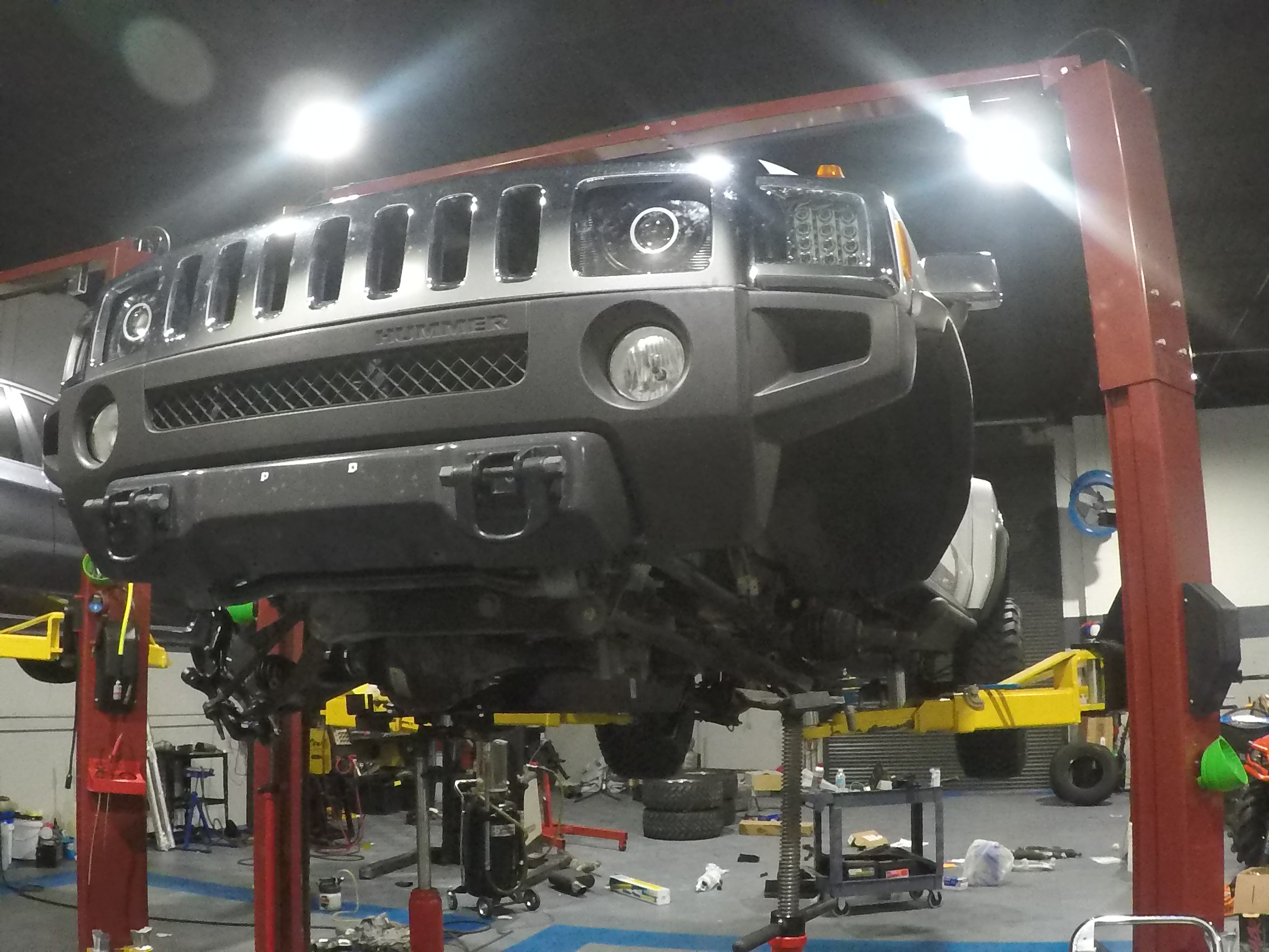

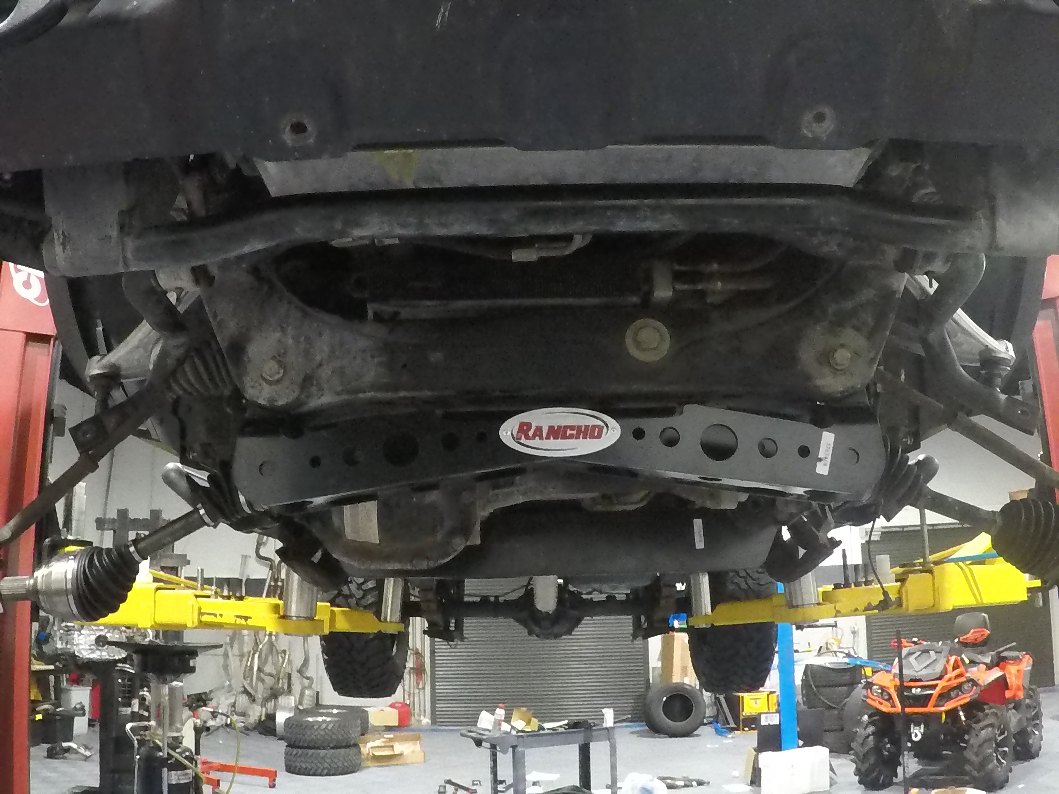

Moving on to the front end progress and did an oil change while everything was apart.

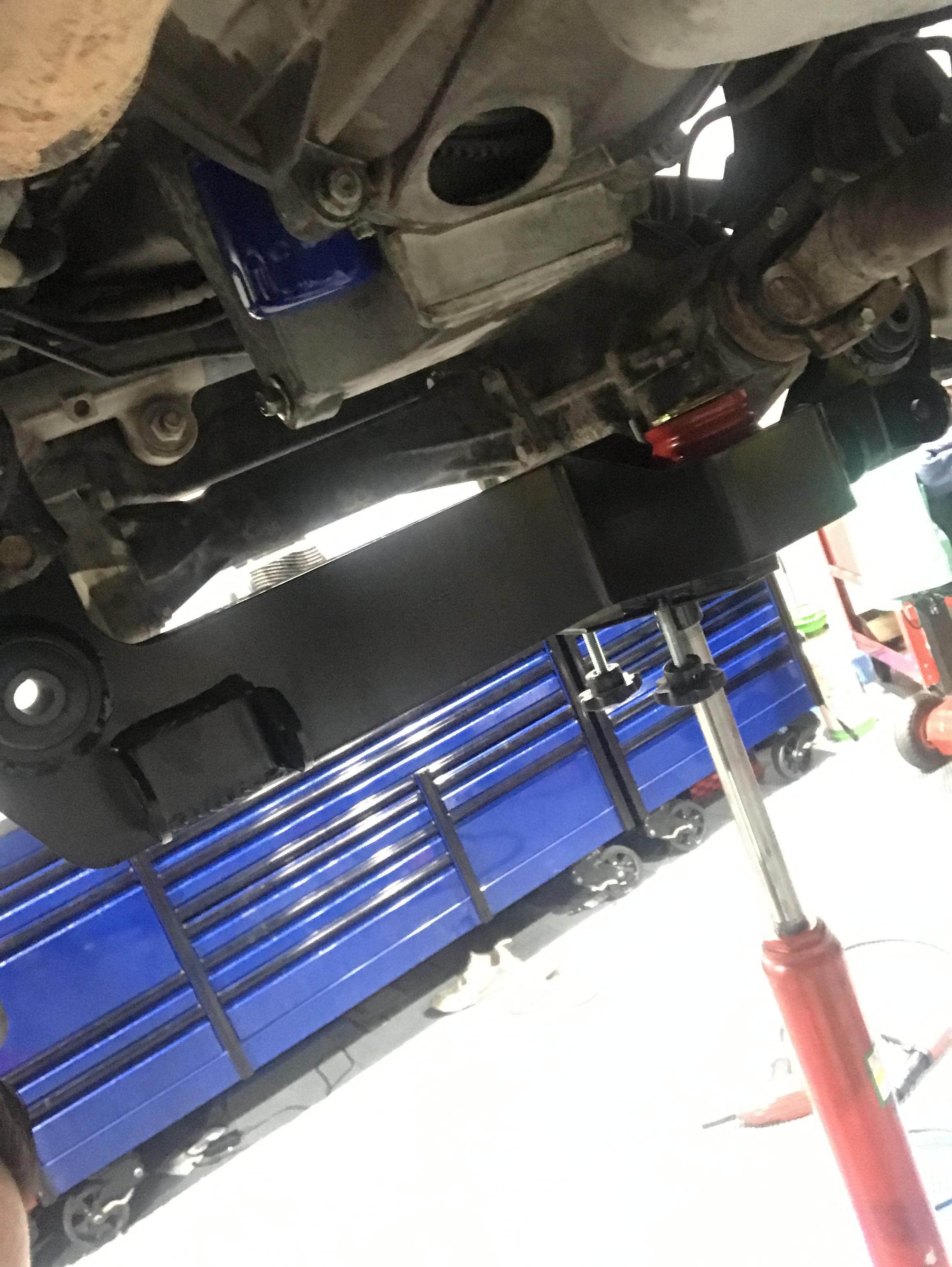

Front diff cross member on.
​More progress. Passenger axle was leaking so we threw in a new one.
New lower control arm ball joints pressed in, new upper control arms in, sway bar and end links done, extended bump stop mounts done, trailing arms installed and test fit wheels. Almost all set!

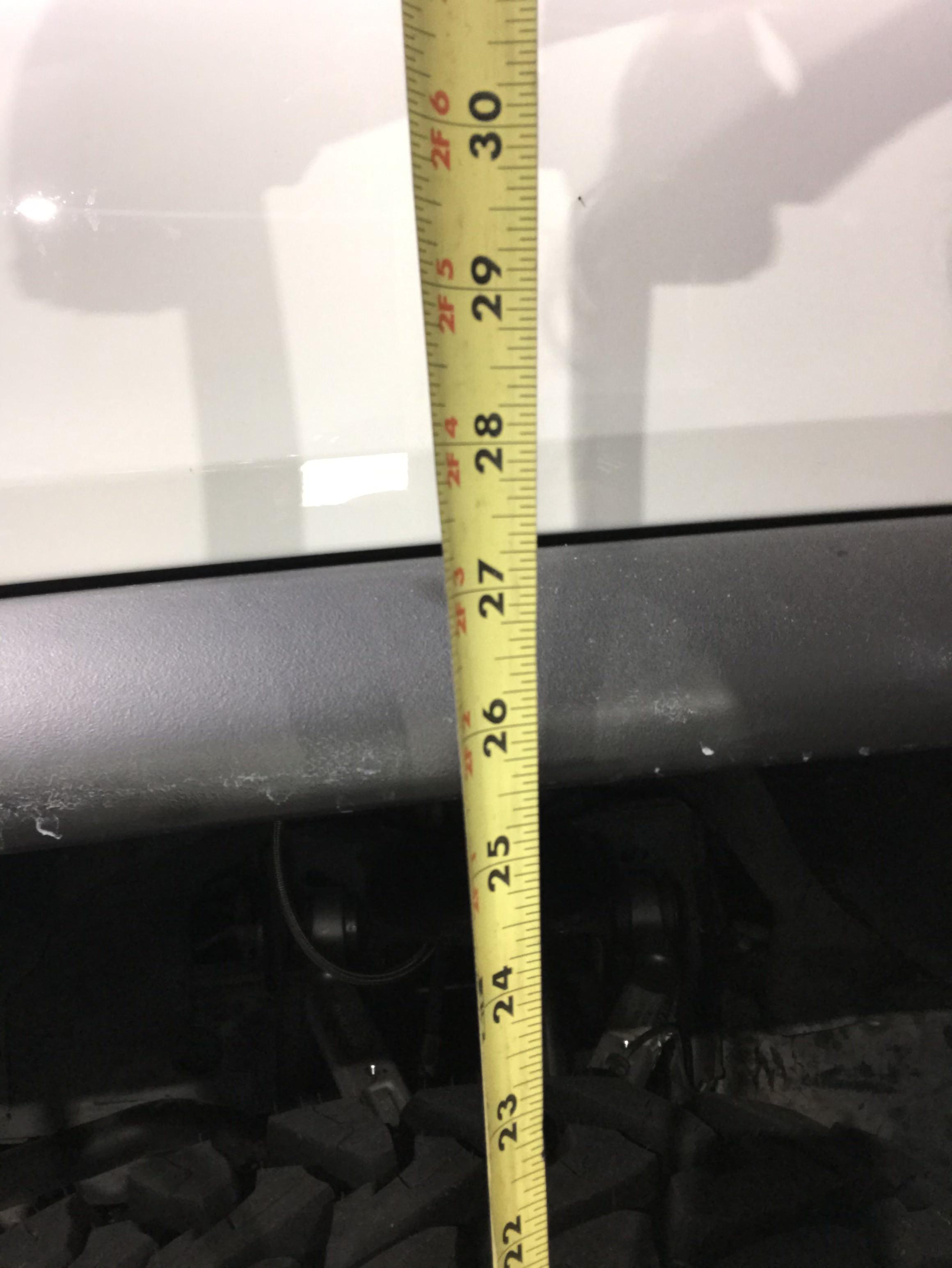

Setting ride height with the torsion bars. Crank the bolts, lower vehicle, jump on front end, measure fender height and repeat. Just the tires alone are making a big difference! Still need to install stock and Rancho skid plates.

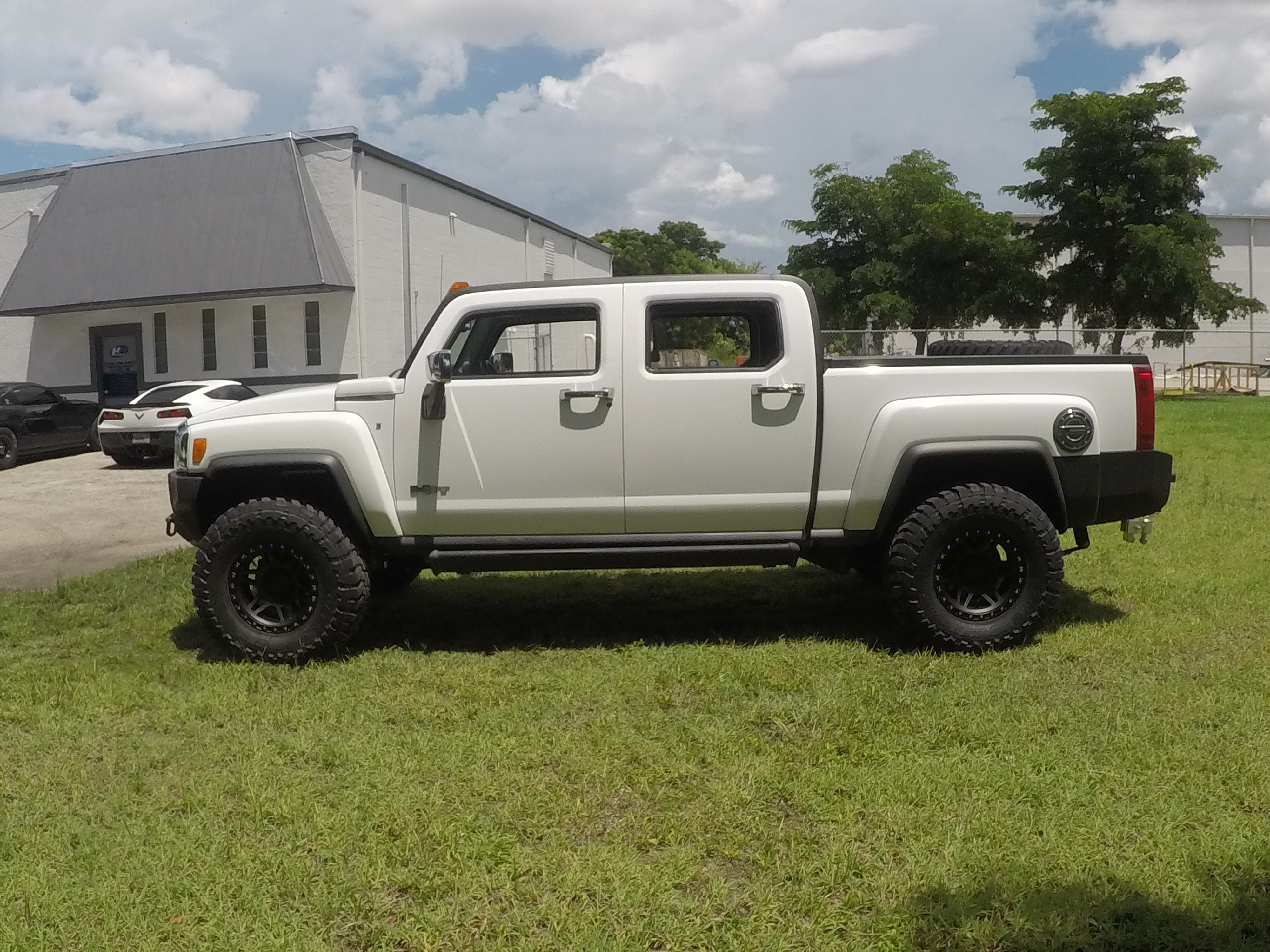

Finished this weekend project late Sunday night with the exception of a few missing bolts. Left it at the shop and came back next morning after a run to the hardware store. My kit was missing the bolts for the trailing arms so I had some longer bolts laying around the shop that I used as a placeholder.

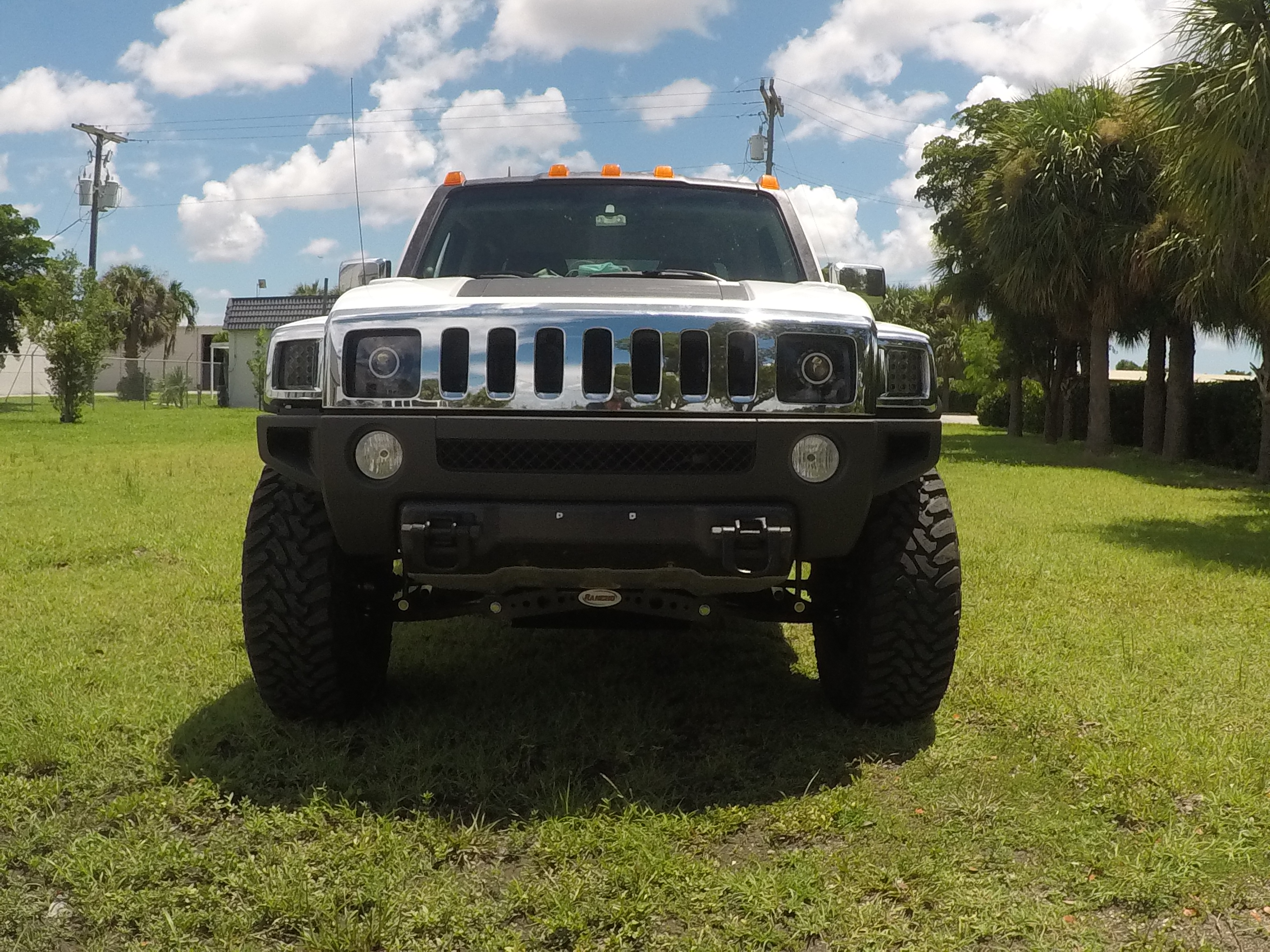

Here's how it turned out.
All I can say is, wow! The truck looks great and I can't stop staring at it lol, like I'm in love with the truck all over again. Still a few things that need to be addressed... the front still needed to be adjusted a bit more before a trip to the alignment shop and the rear really only received a minor lift and looked low and out of place. Being that this sat in my garage for over a year, I forgot all about the rear add a leaf lol. Considered a spring over on the rear but have some other plans. The fender flares also make the lift seem not as high because they come down and out from the fenders as opposed to just out.

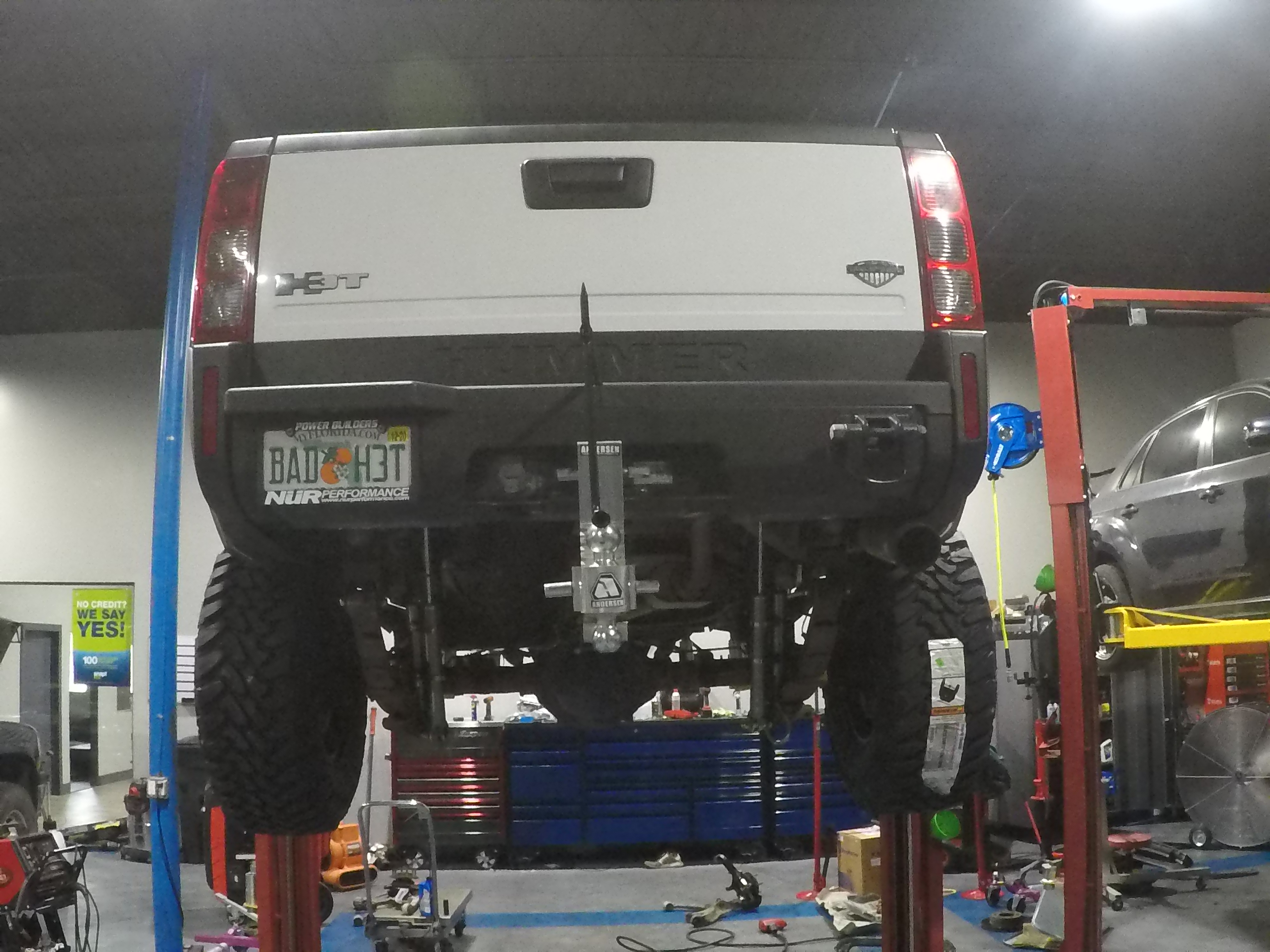

Rear Airbag Installation Time
After the last round of adjustments to the front T bars, I felt like I went a bit too aggressive with the height. So I brought it back down some prior to going off to get an alignment.
I'm sure this wouldn't have lasted too long at this angle.
After an alignment, I had the wheels & tires rebalanced. There was a noticeable vibration on the of the wheels, and the shop that balanced them before indicated that they were "chasing weights" on one of them. I.e., the balancer kept telling him to put more and more weight on the wheel to balance it.
So now that I had the front to the height I was finally comfortable with, I wanted to tackle the lack of lift on the rear. All that I did to the rear when I did the Rancho install above was the extended shackles and an add-a-leaf. And they definitely lifted the rear some (I'd say maybe 2-2.5-ish inches), they weren't enough to match the front. If you just glanced at the truck you might not have noticed it, but if you stare for more than a second or two then you can see the subtle difference in height between the front and rear. And this would probably be even more pronounced when towing the race car or anything with a bit of tongue weight.
The solution came from my buddy Joshua Gostomski, a fellow H3T enthusiast that some of you know, who suggested I run the Firestone airbags in combination of the Daystar cups. Not only will this be able to lift the rear the additional ~1.5-2" that was missing, but it would also be able to level the rear when towing AND have the off-road benefit of not being mounted to both the leaf spring and frame. By only being mounted on the frame, it allows the rear to articulate and not pull up or push down on the axle when going over obstacles. I put pictures of what I used below
What I also purchased that's not above was the mount spacers. These are pretty universal and depending on your set up, you will need a 2-4 inch spacer.

​The Firestone airbag system will go in place of your bump stops. First thing to do is cut out the bump stop mounts and grind down the frame for welding. Once that is done, I mocked up the frame mounts to where I wanted them, tacked in place and welded outside face. After that, I heated them up with a propane torch. This is because the frame mounts that come in this kit are just slightly wider than the frame for the H3/H3T and meant for a Silverado frame I believe. Not a huge deal. After the mount has some decent heat in it, we took a BFH and coerced the mount to conform to the shape of our frames and welded the inside of the mounts. My buddy Will took care of the welding while I prepped the other side of the truck.
If you also do this, just be careful of the fuel lines on the drivers side. Here Will is welding the bottom and inside of the drivers side mount.
Driver side views after some chassis paint and install of the spacer, Daystar cup and airbag on top mount. You can see my red air line routed to the other bag (they are Tee'd together) and brake line not yet secured. This was a test of the system to identify any potential issues or line snags.
My recommendation for you if you do this is to go for the 3" spacer if you have around the same amount of lift that I do in the rear. Maybe even a 2" spacer for a stock rear. I bought the 4" spacer as recommended by Josh, and it works but I find that it is a bit too tall on my truck and will be switching to a 3". I want more compression space between the bottom of the mount and the top of the Daystar cup.
The amount the airbags can lift up the rear is impressive! Firestone doesn't recommend going over 100 PSI in the air bags, so in our test we aired them up to 80 lbs to see if any lines would be caught or stretched. To my amusement, the bags at 80 lbs lifted the rear 5 inches over it's static height without the lift.
:thumbs:
I'm very happy with these and would recommend to both trail-goers (with Daystar cups) and people looking to level the rear when towing. Here's a shot of the rear after install with just 25 psi in the rear to level it out. Much better. I will also post towing pics when I try it out.
No more of that saggy butt look!
Anddddd then there's this to top it off. The LS3 is back from the engine builder and on the engine stand in the garage.

Rancho Update:
I felt like the front end was settling down some months after the install so I cranked each side half a turn and re-measured ride height. Opposite of what I would think, the ride quality improved noticeably and unexpectedly. Just thought I'd share something I thought was odd.

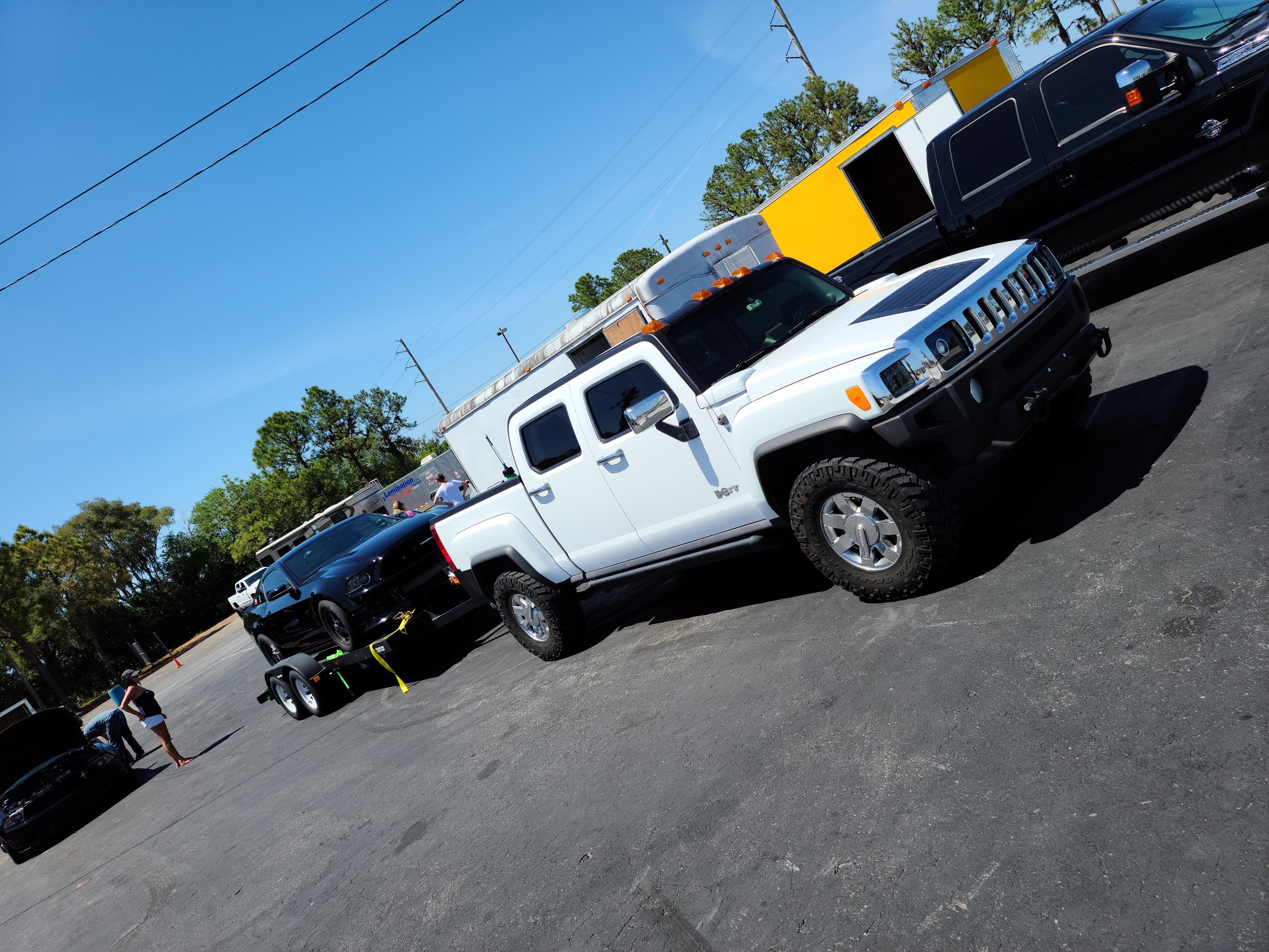

Anyways, my other fun vehicle has mostly been sitting in the garage but I finally got a chance to go out racing again and use the truck to tow the race car for the first time with the Rancho last month!
It pulled rather well with the lift and 35's there and back, and I got the chance to add some psi to the rear bags to level it out. Also I think it looks sexy af when towing lol.
Getting back into the racing groove so I'll be towing the Mustang more often. I definitely am thinking about re-gearing to the 4.56 gears to help towing. But might hold off until after the new engine is in and I see how it pulls with that first. Taking my time on it, more on that in a bit.
Anybody interested in these items before I list them for sale? Stock H3 16" wheels with 33" Nitto Trail Grapplers & front and rear Bilstein shocks for a torsion bar cranked H3/H3T. Taking up space in my garage!

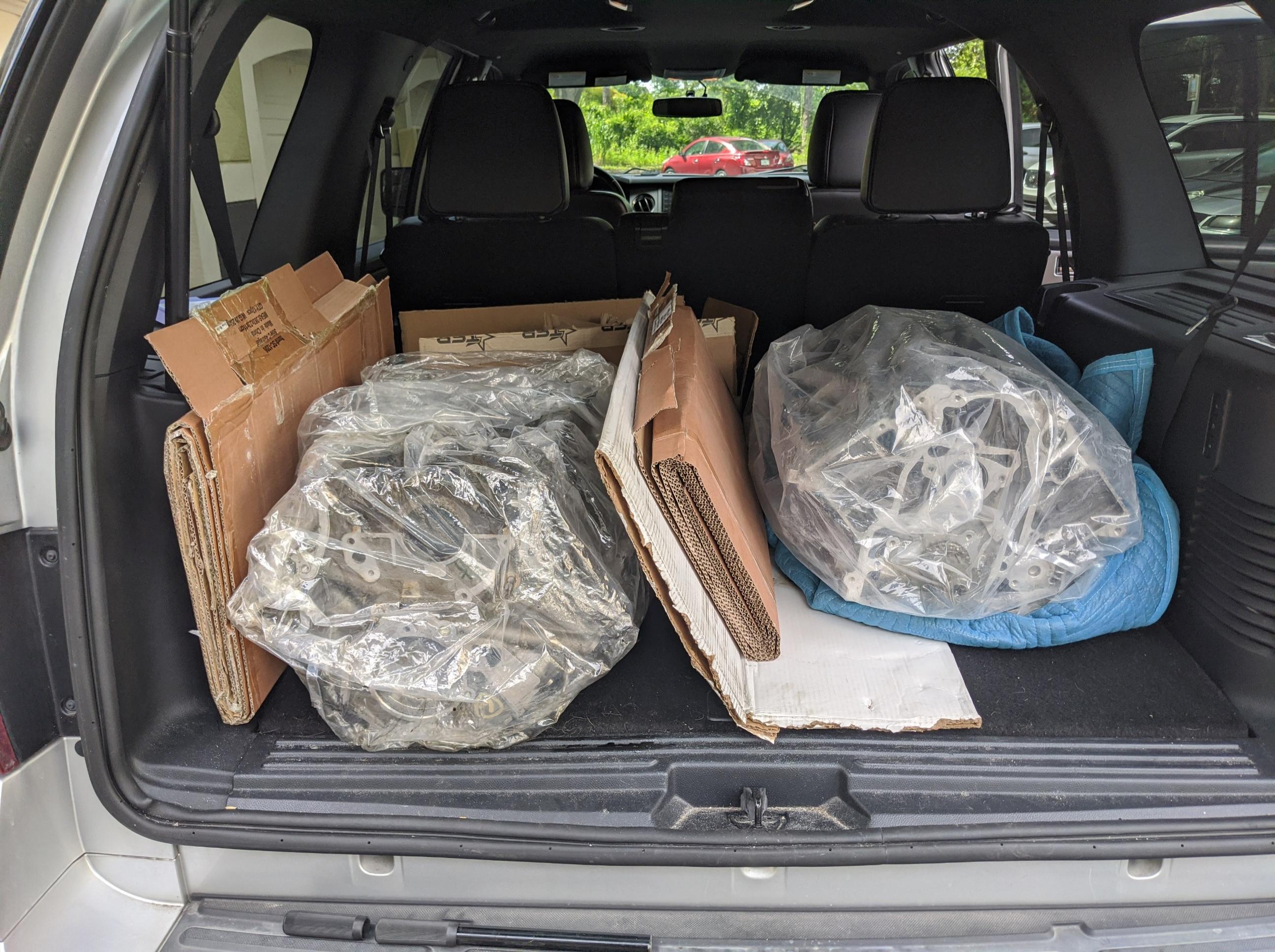

A big part of the motor swap came in last month from Circle D Specialties too...
Nicely packaged converter with some swag goodies!
View of the rear above
And the front ^^^
Ordered this from Circle D Specialties and didn't expect to get it before Christmas due to the 6 week lead time, came in 4 weeks! I went with the 278mm LS HP Series with 2800 stall and optional billet front. Now that I have this, I'm pretty sure I have most everything I need for the built 6.2 swap to run technically. But I want to wait and get a few more things like an oil cooler for the trans, build the trans itself, decide how I want to re-do the exhaust & miscellaneous hardware.

Im sure when you do that full throttle "engine break in" launch you will be impressed. When I got me engine it said to do one after 100 miles, glad I was driving on an empty service road the way the truck jumped and pulled.
How much did that converter set you back? I had a 3200 converter but not billet, but on hindsight I shouldve went 2800 since my trans really heats up offroad and easily goes above 210* even with a 40K trans cooler. If I really pushed my truck wouldve be surprised id hit 250*.
Hoping with my axle swap to 4.56 Ill solve that issue (or reduce it significantly) otherwise im gona have to either add a second trans cooler woth fan or change to a lower converter.
As for your ride, if you set the ride height to rancho specs then you probably were riding on the bump stops. Raising it probably reduced contact and that improved your ride quality.
I am definitely excited to floor it but at the same time, I am worried that the front diff might break lmao. Converter is about $549 on their website and another $100 if you want the billet front. But I ordered it during one of their Black Friday deals so I got a small discount.
And I know man! I was reading through your various threads about a year ago and was wondering why you did the 3200 stall at the time as I thought it was a bit much. This should be good enough for the cam and also be able to tow well without flashing it. I think you should probably do the lower stall converter either way because the gears would just make your rpm higher in overdrive and may make it run a little hotter at cruise. If I recall correctly, you run a Circle D converter too, eh? If so, I'm pretty sure they will re-stall it once for you for free. I know it might not make the most sense due to your location, but you could check it out.
I think you're right on the ride height and bump stops, that absolutely makes sense.
