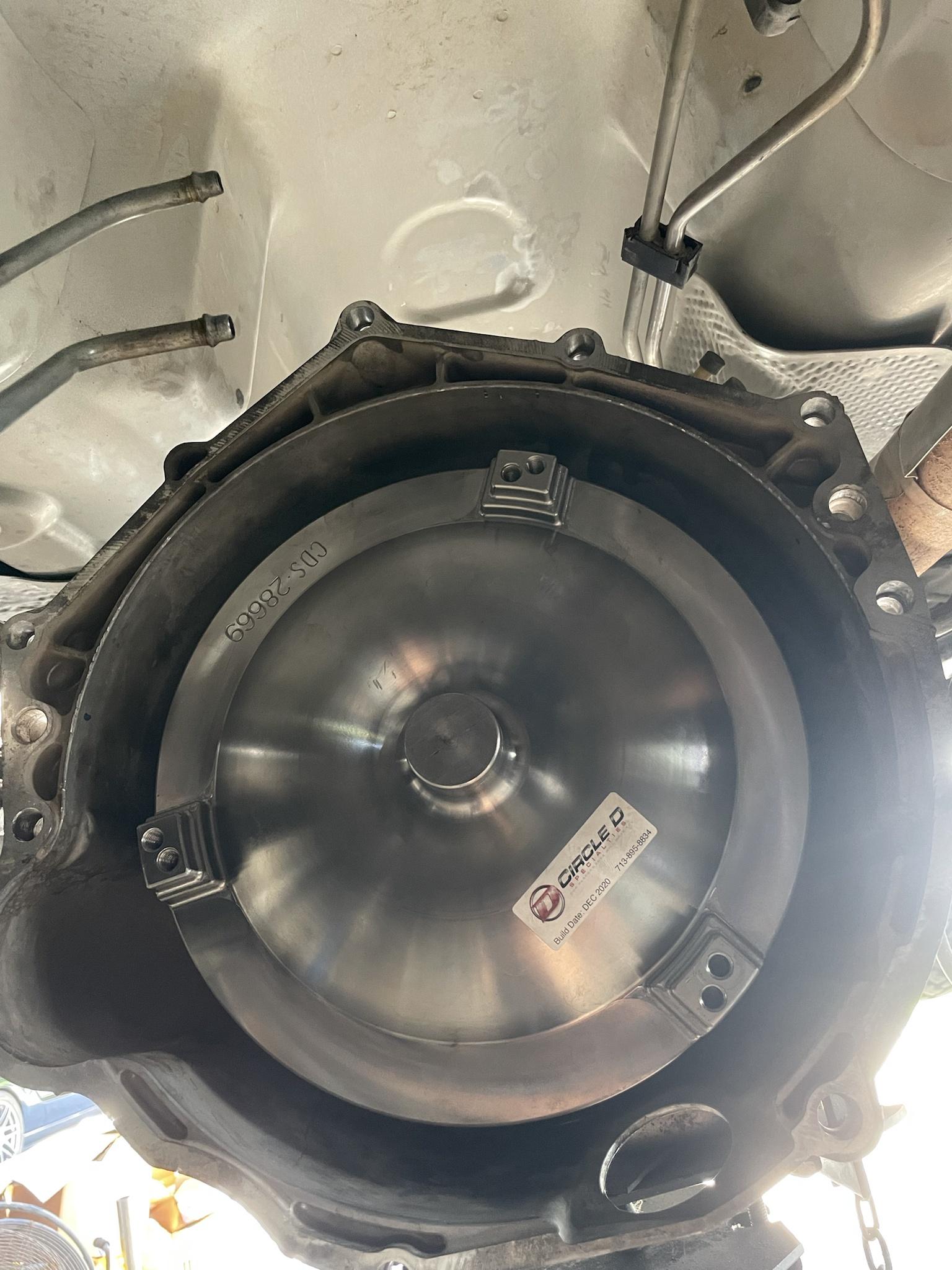

I went with the 3200 based on circle ds recommendation. I havent seen anyone here with a stalled car/truck so I really had no idea what to expect, I just knew it was needed based on the feedback of the first person to do the ls376/480 on an H3 and how much the stock stall affected driveability and stopping due to the higher idle rpm.
I wish I could restall, but Due to my location, it would be cheaper to buy a new one than send this back. But again its a 4l60 and I believe one day its gona be a 4l80 so im not planning to invest into this.
With 4.56 and 37s my trans will be better since it will lockup earlier and stay locked at highway speeds. it will also make the truck flash to a lower rpm which should reduce heat.
The lockup part is important, with 37s the trans wont stay locked at 100 mph (highway speed here) while with 35s it would. In the summer this caused my trans temps to spike to 250* and thats not what I want.
Finally, with 4.10s the rpms hover at 1400 at 60 mph in overdrive, too low for my cams power curve and it feels like im lugging. With 35s I never had an issue so hopefully 4.56 is the answer

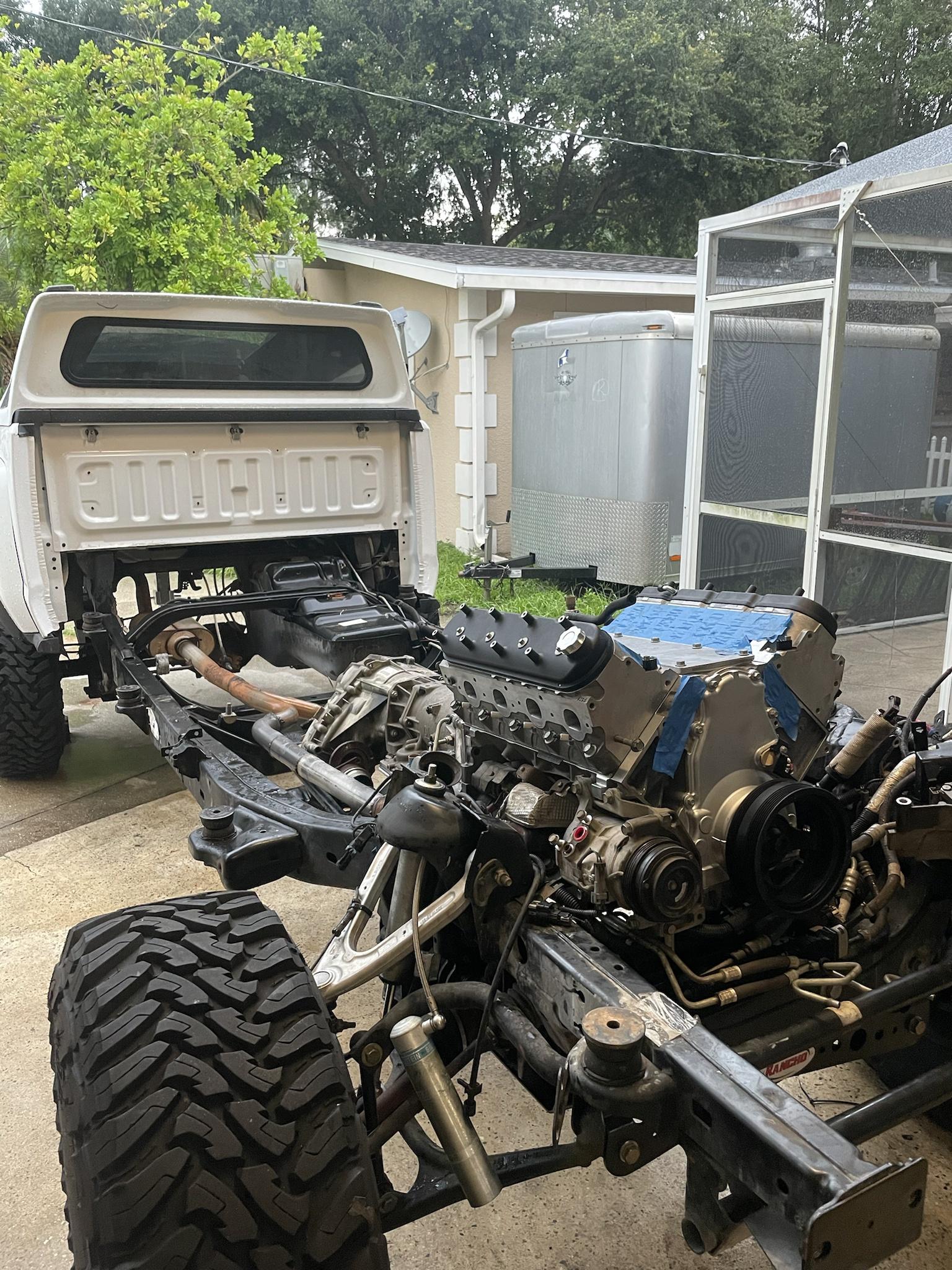

And finally, I nailed down a long weekend to start the 6.2L LS3 swap. After work, I loaded up the T with all the new goodies you'll see in time and went to my buddies place to get started. The SnugTop definitely came in handy here, no fear of stuff flying out of the bed or things flying out of the open boxes lol
I took Friday (today) off and started yesterday after work. Works out well for me because my employer observes July 4th on the 5th since it's on a Sunday, so I have a 4 day weekend full of wrenching. Here's what we accomplished so far. Bumper & grille removed, radiator, engine harness and misc items disconnected, cab mounts removed. We are ready to lift the cab off the frame in the morning and get more room to pull the engine/trans.
I'm gonna try to keep this updated in real time over the weekend so you guys can follow along.

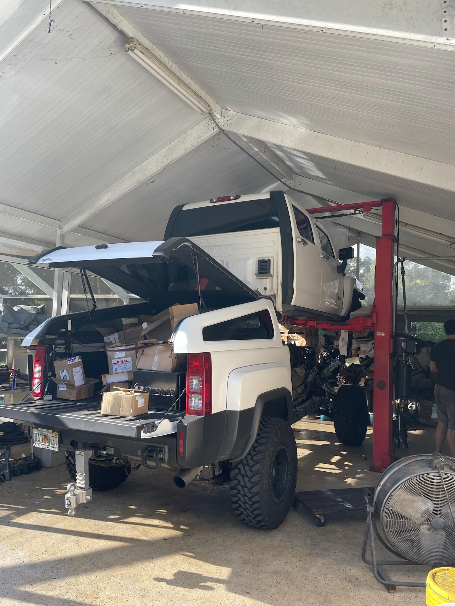

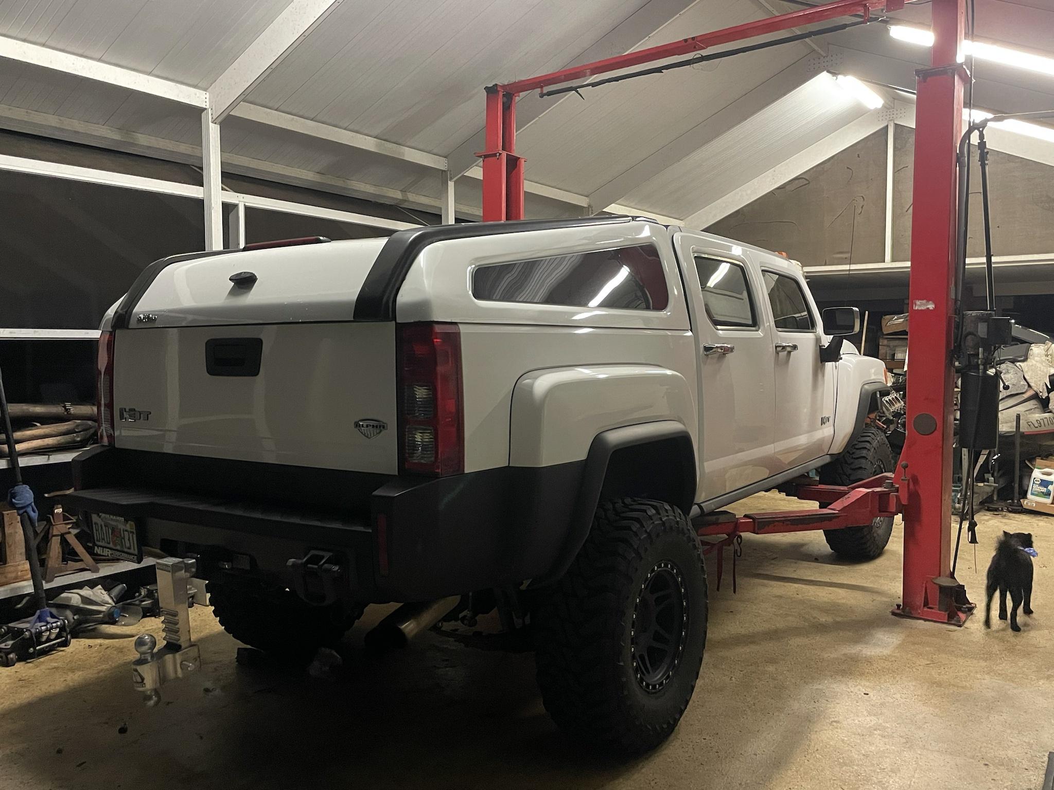

Started the day with lifting the cab off of the frame. Doing so makes it so much easier to pull the engine/trans/TC.
​Rolled the frame back for access with the hoist
Done!
:horns:
Engine/trans pictured below. We had already removed the transfer case at this point.
The T looks a little funky with just the bed and Snug Top on it lol. :whaa:
Got the transmission off and back in the build room and isolated the Alpha's V8.

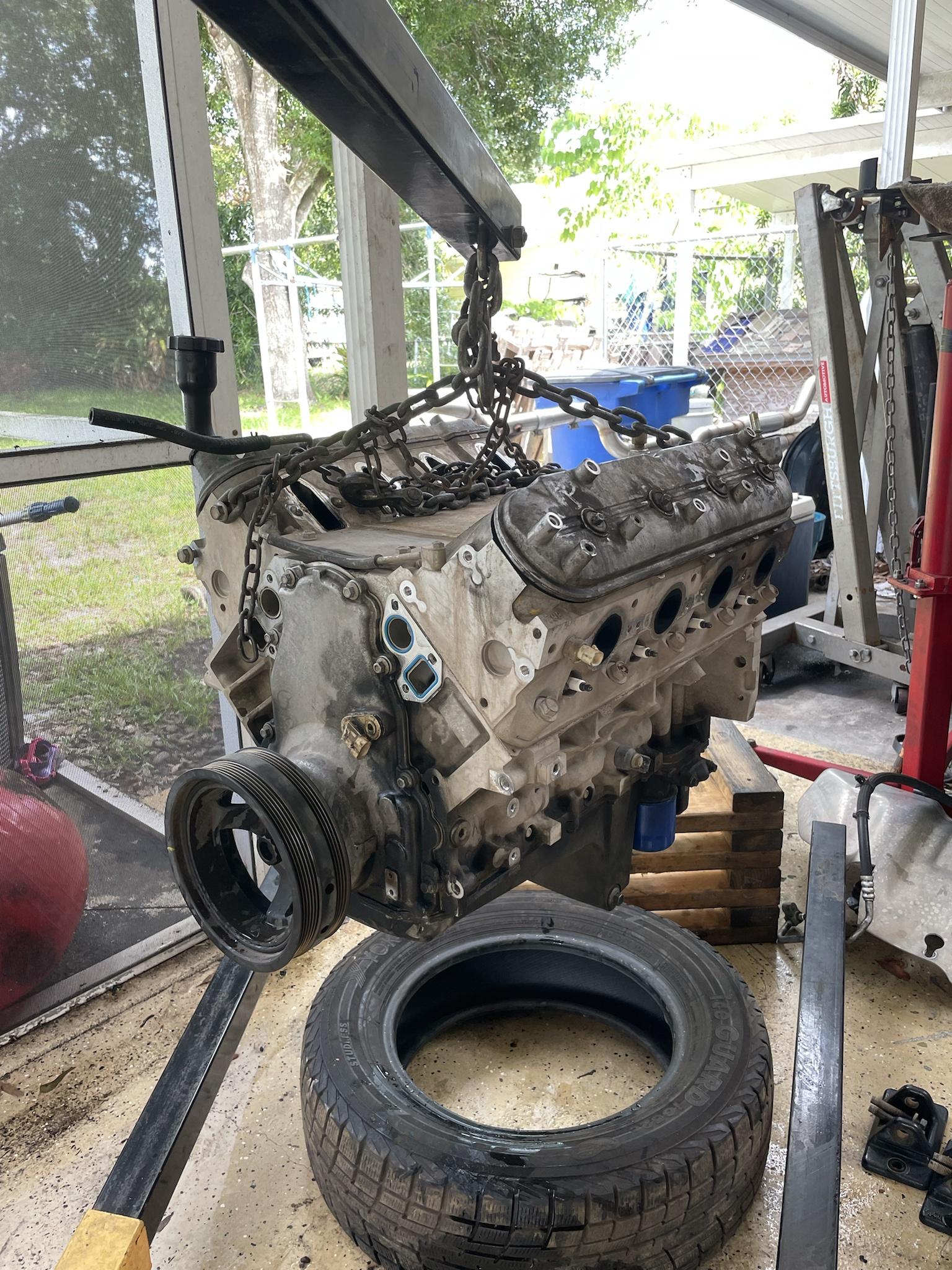

Wow! I did it the old fashioned way, pulled the engine out. One thing I forgot to do was replace the firewall insulation, it got damaged during the instal and fell apart very quickly. Id recommend you insulate that area and around the trans to reduce incabin heat
Pulling the motor was a breeze this way. The only annoying part is aligning the cab to the body mounts when reinstalling.

The engine is still for sale. My buddy was going to buy it for his turbo charged Fox body mustang since these engines are highly sought after due to being an aluminum Gen 4 (strong pistons & rods) with no DOD or VVT. But he ended up buying another Fox body.
Yup! Aluminum block, no AFM/DOD, good exhaust manifolds and high flow truck intake manifolds. Yet, GM only gave us 300 hp to play with!

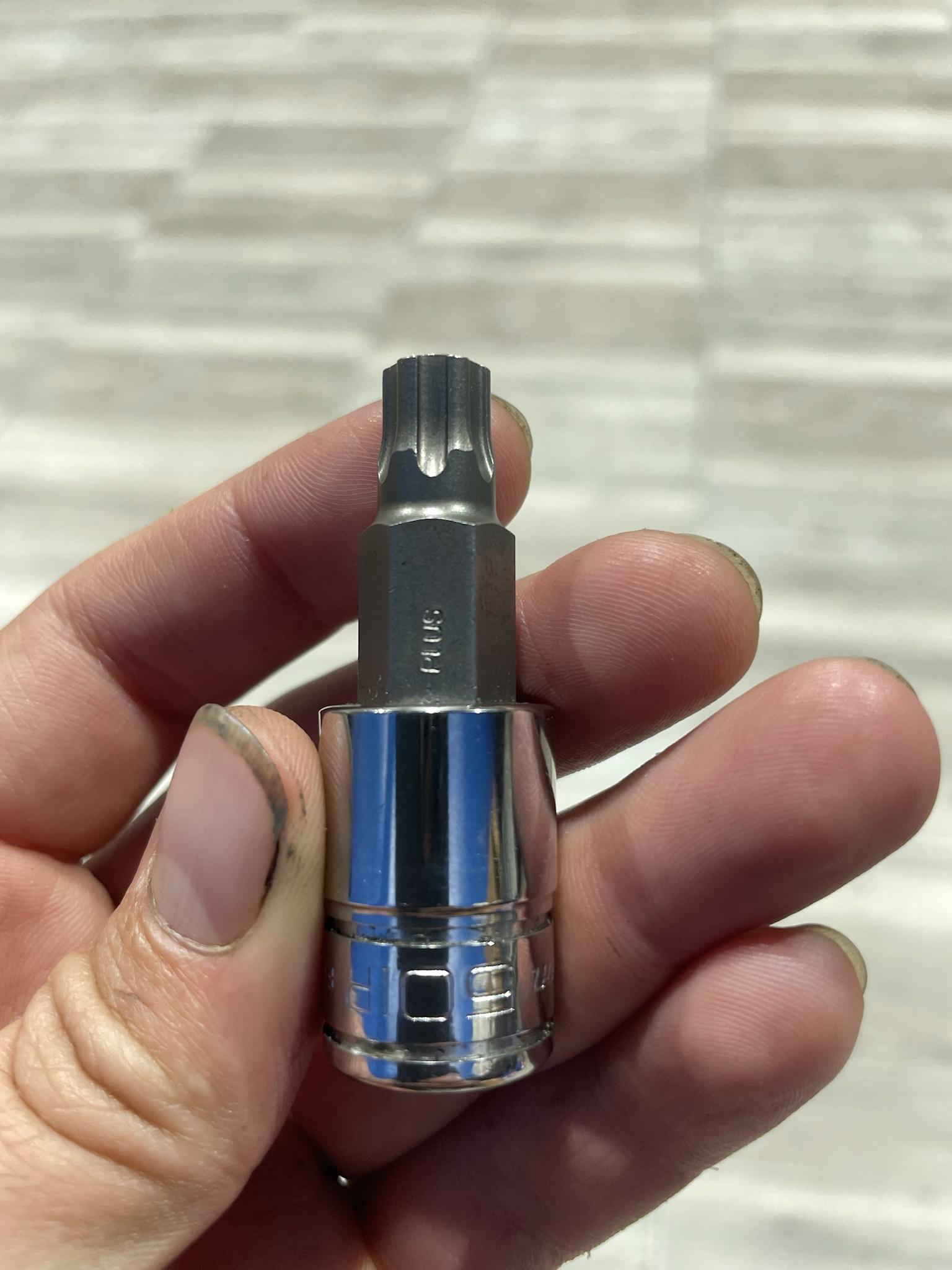

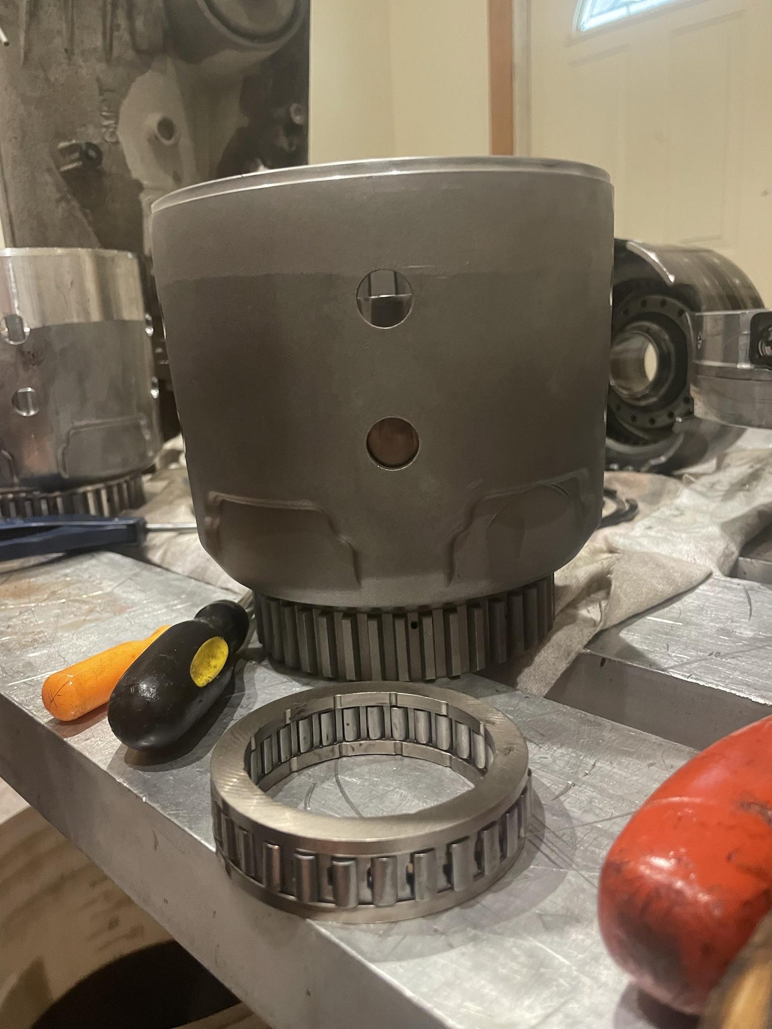

It took a while but I got the missing pieces that I needed. This Torx Plus bit, and the rest of the clutches and steels for the forward and overrun sets. Due to the pandemic, Raybestos had a 6-8 lead time on the pieces that I needed. Luckily, I was able to get the friction set from WIT and they pieced together the few missing steels that I needed to move forward.

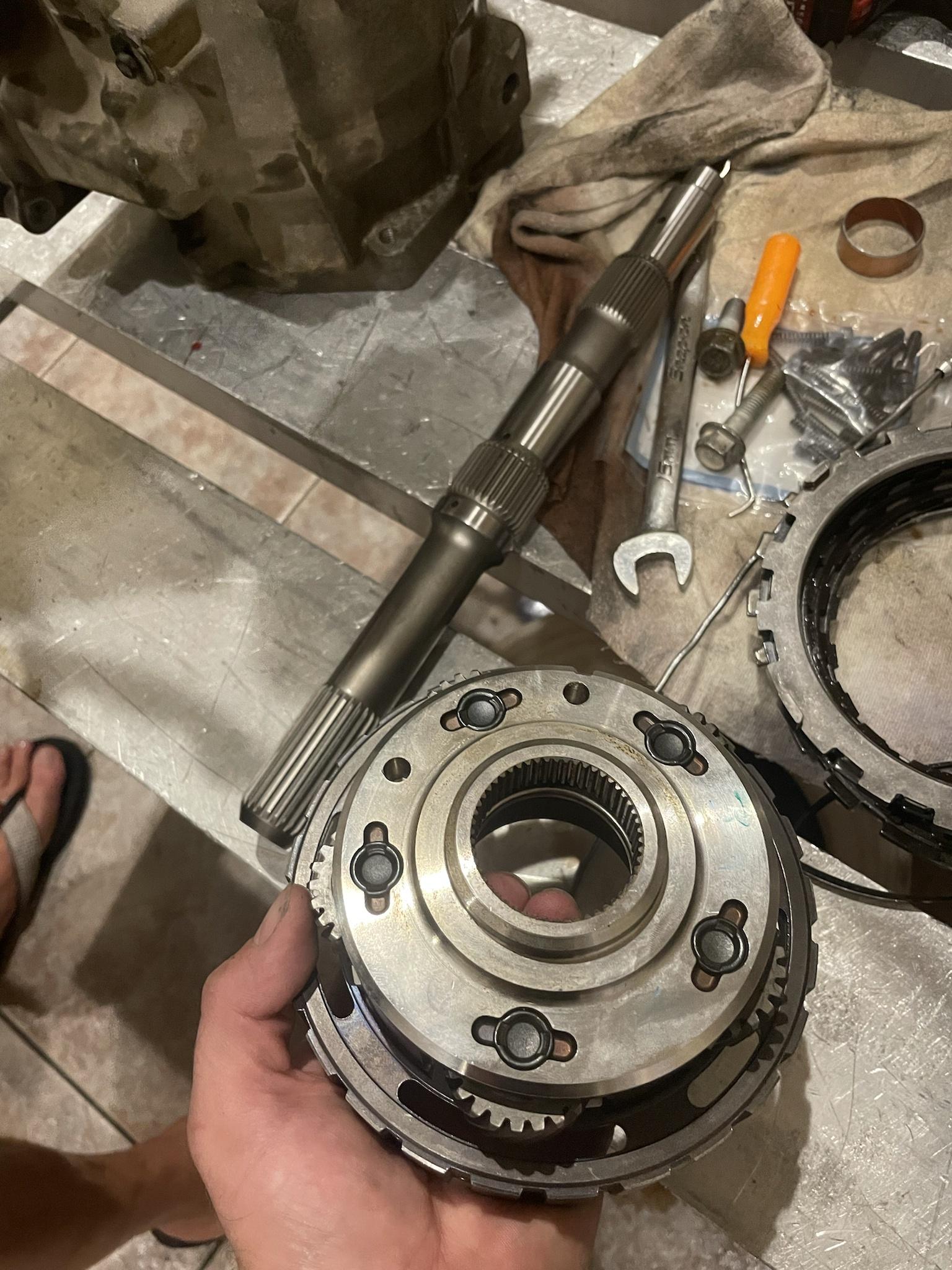

Started the teardown.
​Don't want to do this twice so I've tried to build this thing the right way.

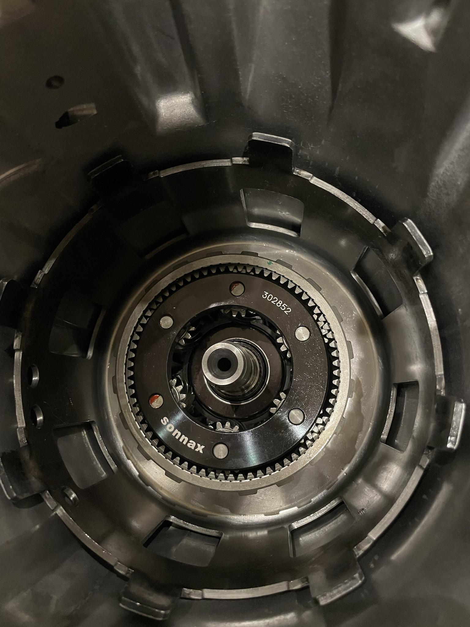

Sonnax smart tech input housing and Borg Warner 29 element dual cage sprag. The Sonnax housing allows for more full sized frictions and steels for more power holding capacity.
GM 5-pinion rear planetary to replace our stock 4-pinion piece & Sonnax high strength input shaft.
Installing the Sonnax 2nd & 4th gear super hold servos.

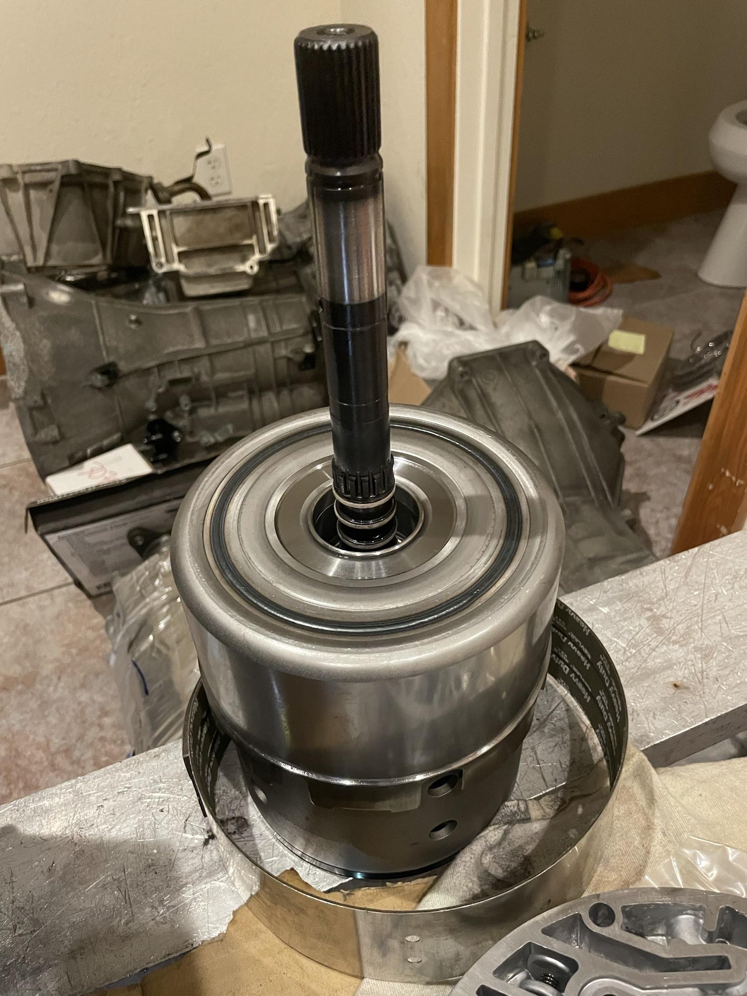

The smart tech input housing loaded up with the 3/4 Raybestos GPZ frictions and lindered steels
New GM reverse input drum and Sonnax extra wide Kevlar band

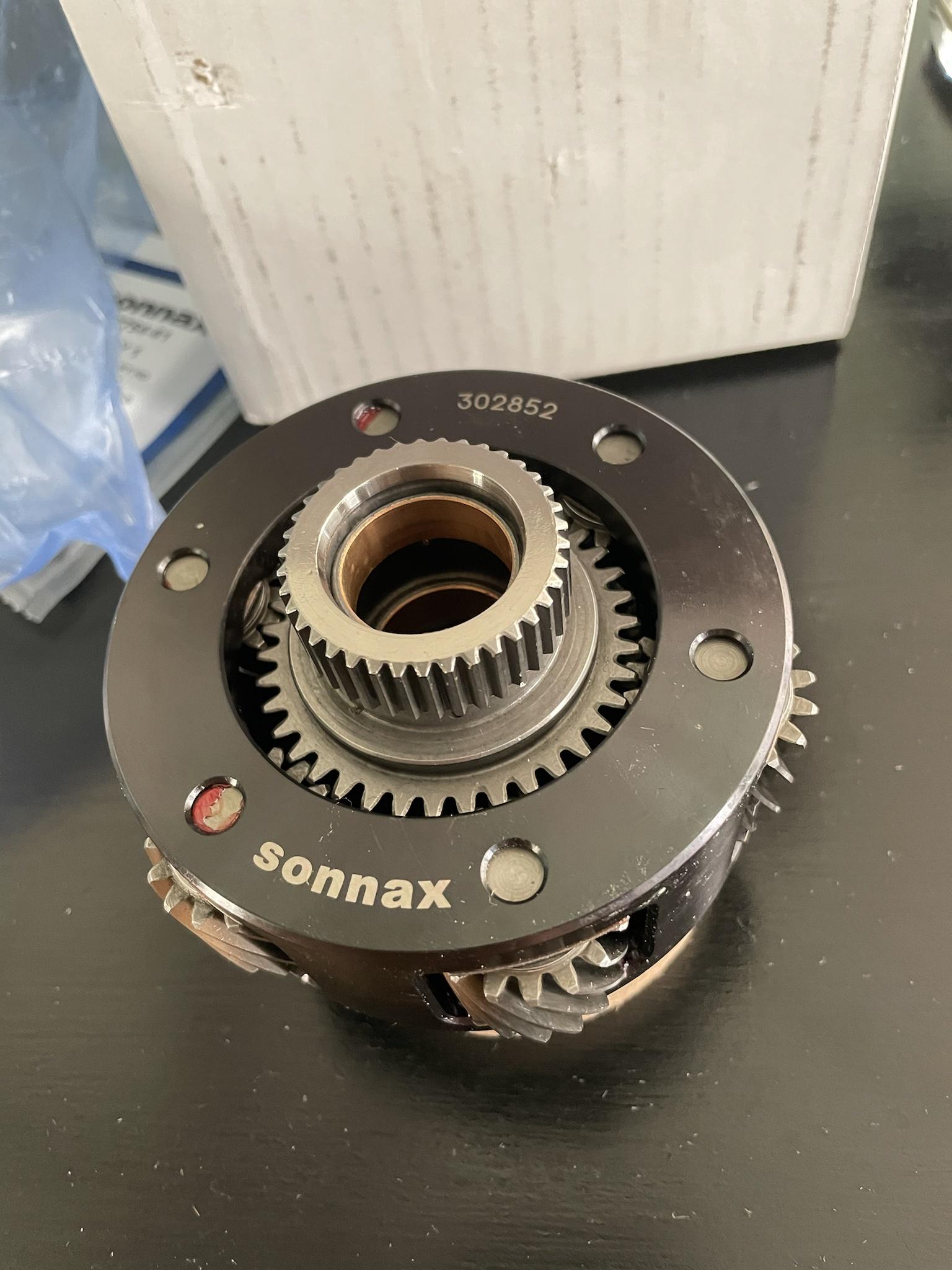

And probably my favorite piece of this tranny build is this 6-pinion front planetary. This changes our gear ratios to allow less engine RPM on the 1-2 and 2-3 shifts, thus keeping the engine better in it's power band.

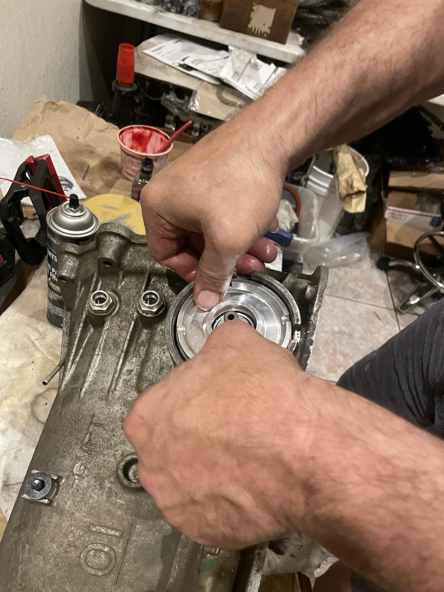

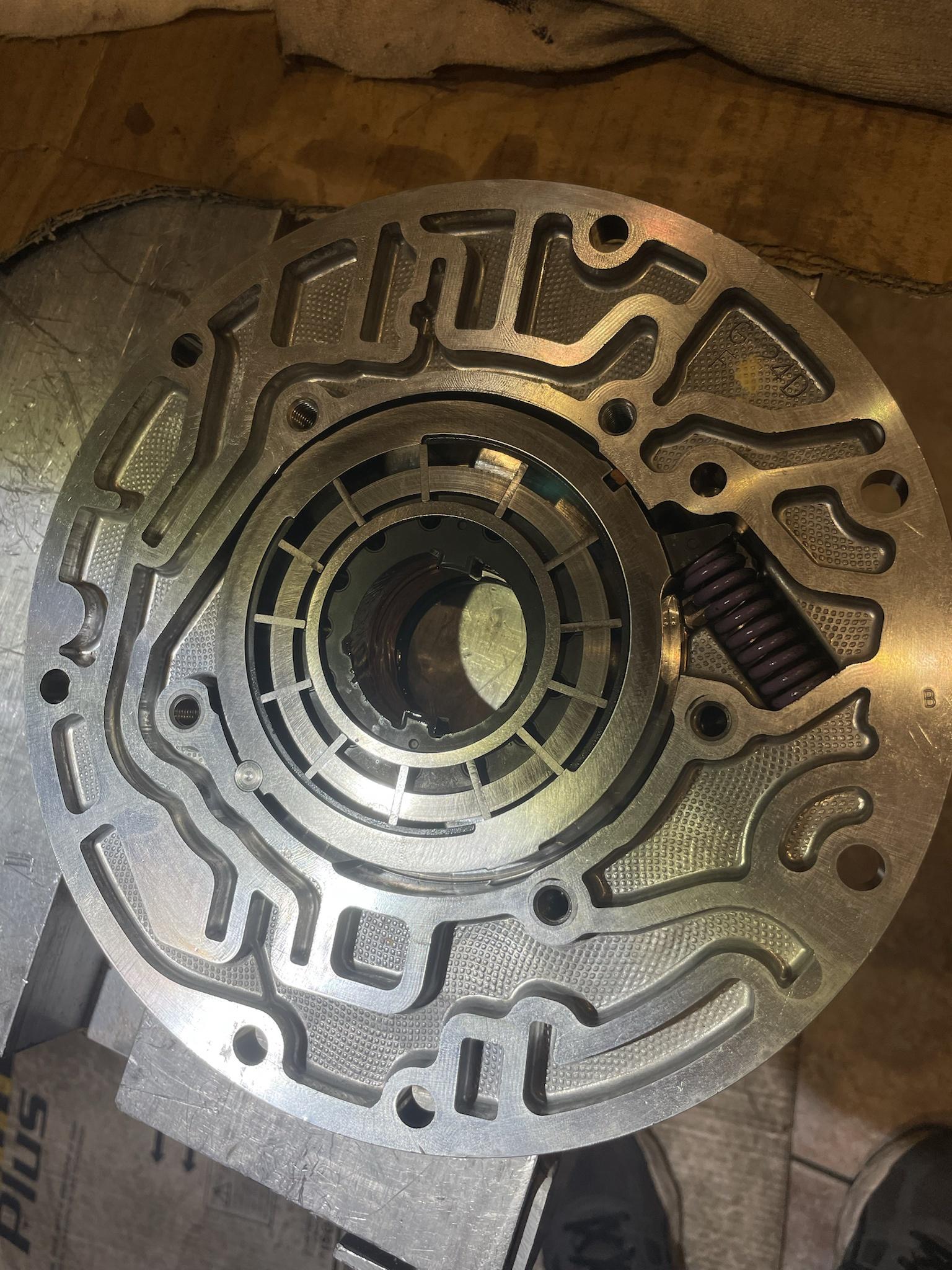

More Sonnax parts. Modified oil pump and installed their Performance Pack modifications to the valve body (didn't get any pictures).
All wrapped up and ready to go back in

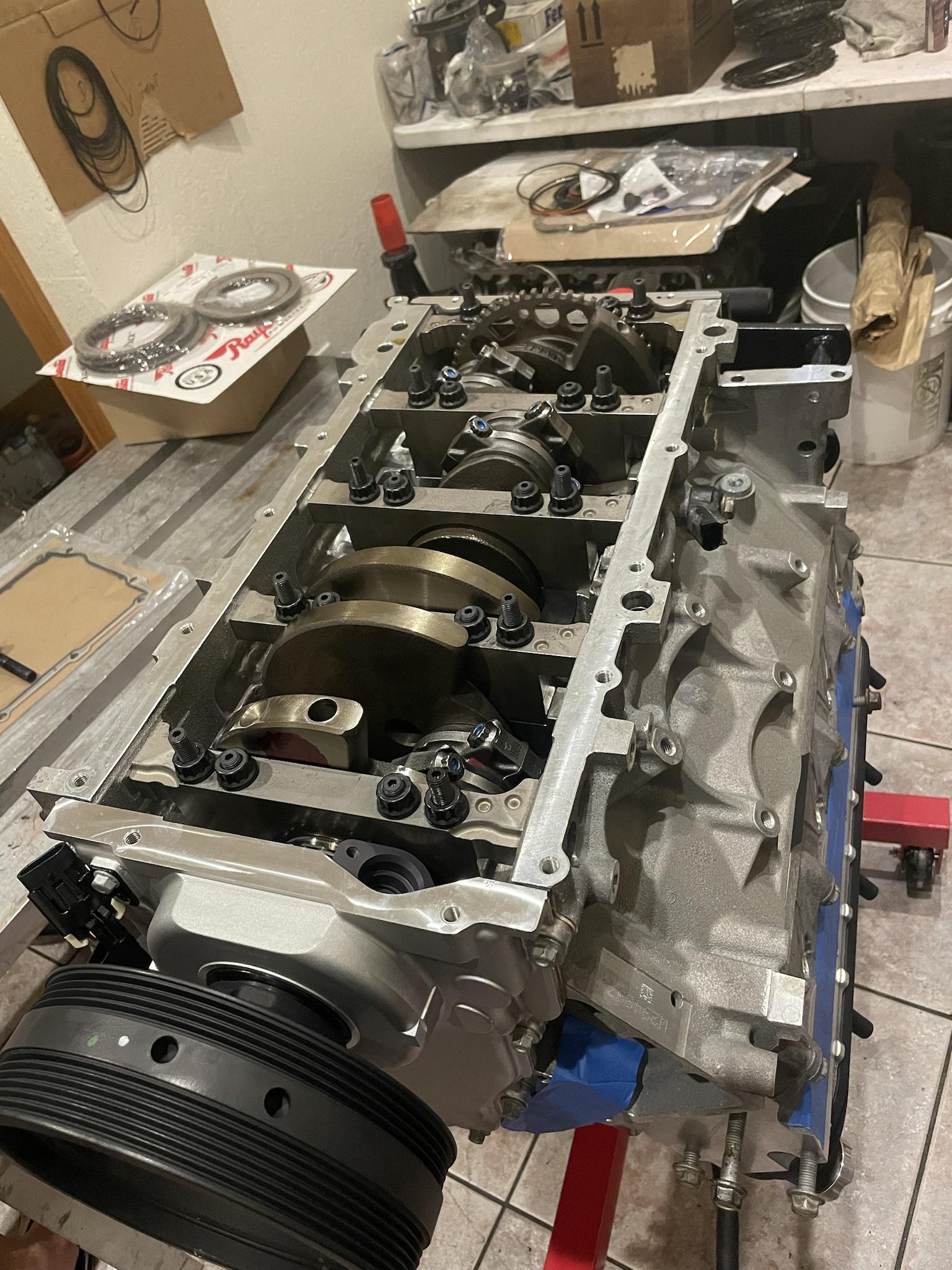

Prepping the bottom of the LS3. Installed windage tray and oil pick-up tube
Close up of cylinder #4's forged internals.

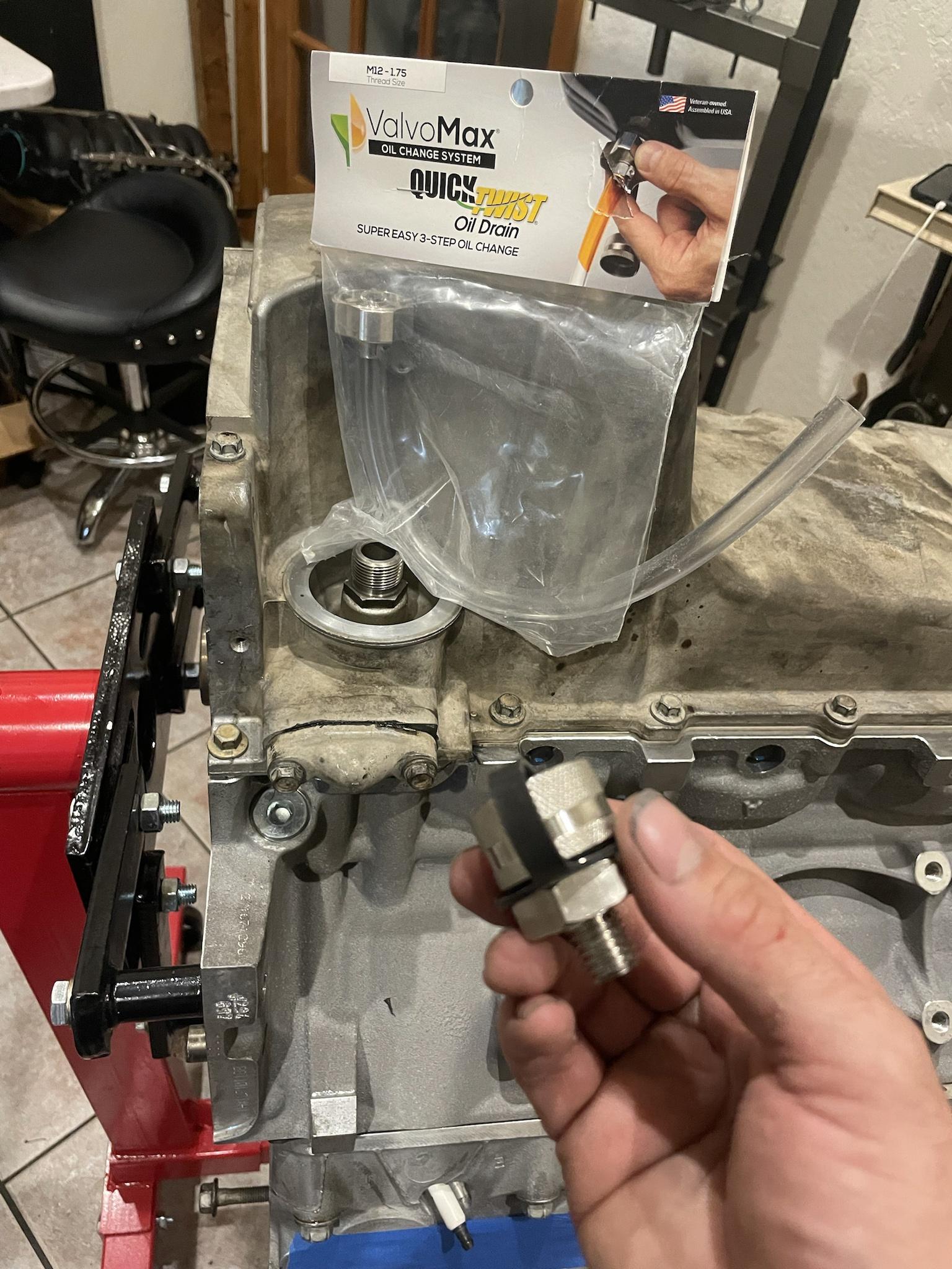

Thanks to the Hummer chat boys for this one. This is going to make future oil changes much quicker and easier with the Rancho.

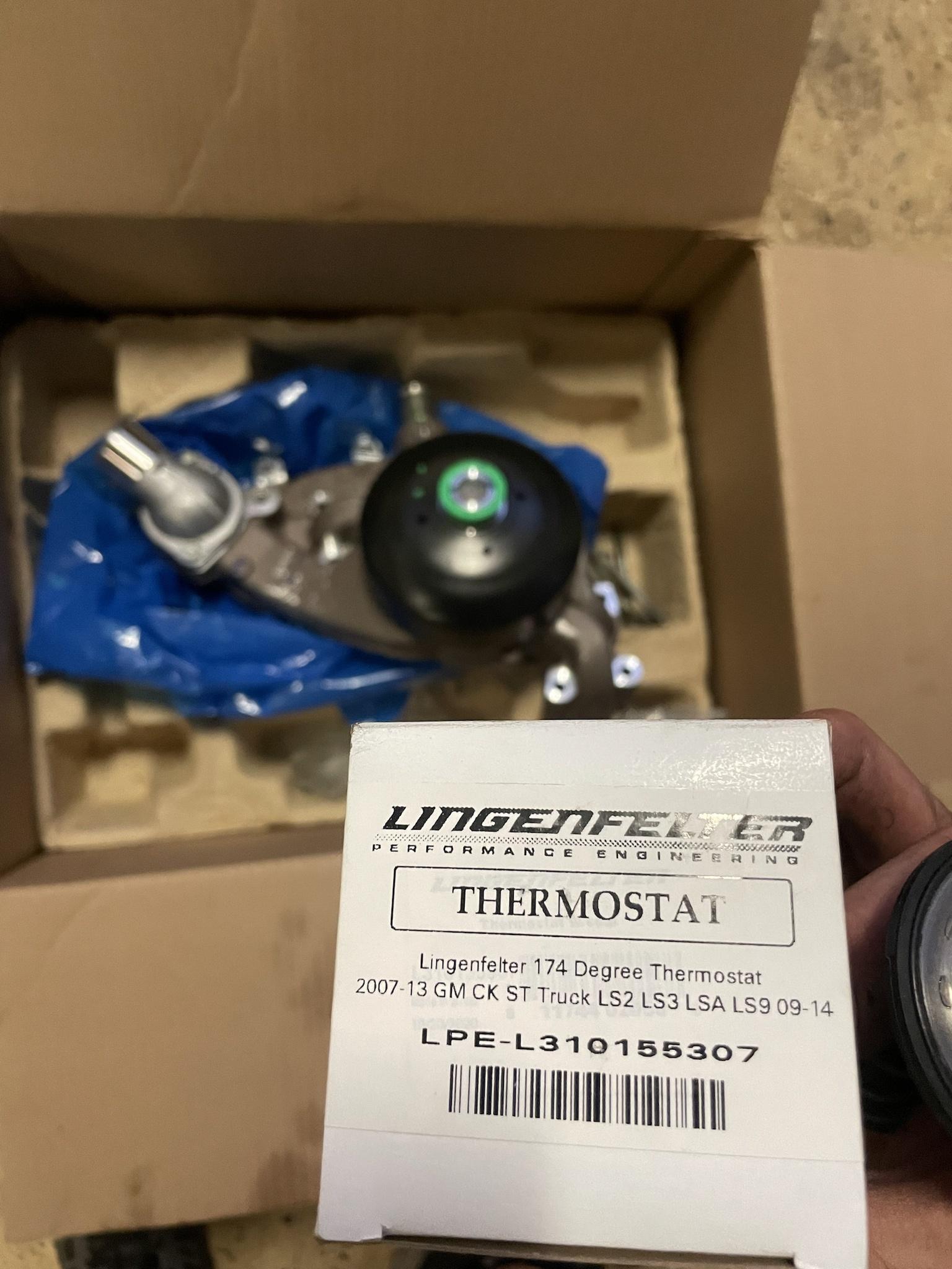

I've read in a few different threads that some of the few other that have done the larger motor swaps experience higher coolant temps, so I have a few mods to help with that.
One of them being the thermostat. Stock Alpha thermostat is a 186 degree F unit, and this new Lingenfelter piece is a little lower than that at 174 degrees. They make much lower stats (170, 160, etc), but I didn't want to go too aggressive, this isn't a race car. Should help a bit

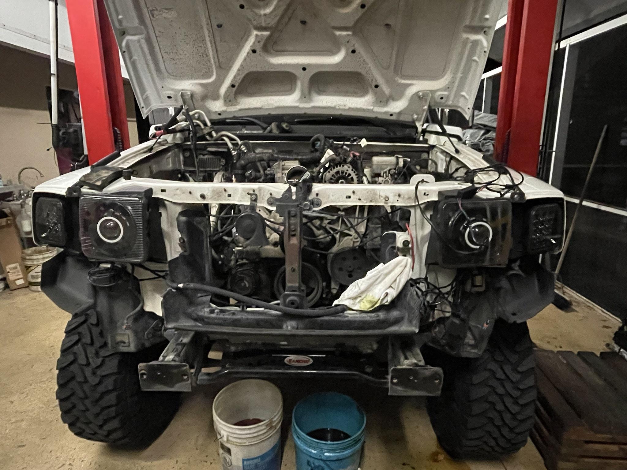

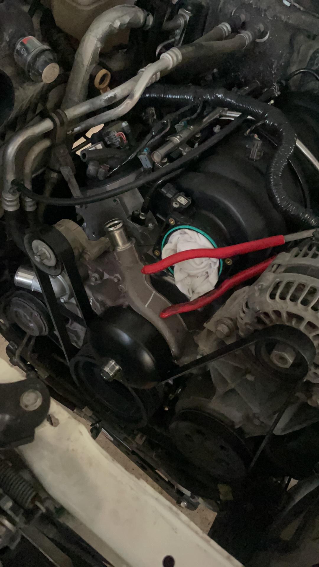

Swapped the Lingenfelter thermostat in the new water pump, mounted accessories. Ran into the known issue of running the LS3 intake manifold with the Alpha accessories. As you can see, the throttle body has clearance issues with the pulley in front of it. Will have to cut on the line shown. Thanks to Armg for reminding me of this and the part number to the new belt size needed to run without the pulley (it was almost perfect, I had to grab a size larger though).
Installed the new ceramic coated JBA shorty headers. They are pretty nice in general, but I am really not a fan of the raised port design on them (the flanges aren't flat). Added copper RTV on new OEM gaskets to ensure no exhaust leaks. Threw their junk gaskets that came in the headers in the trash.
Starting to look like a proper engine!

Looking good. What gets modified on their oil pump?
Sent from my SM-G960U using Tapatalk
Thanks buddy. The Performance Pack from Sonnax gives you a billet pressure regulator boost valve & higher pressure spring, as well as a high RPM pump slide spring. According to their website, the performance pack does:
  • "Consistent, firmer shifts under load without sacrificing low-speed drivability or guessing on calibration
    • Faster pressure increase and higher overall pressure for greater clutch/band holding power
    • Three ultra-reliable, patented, billet pinless accumulator pistons
    • Unique 1-2 accumulator spring combination for shifts with character
    • Improved high RPM pressure
    • Third accumulator valve gets the 2-3 right the first time, every time
  • Durable parts target commonly worn areas and prevent future damage to the accumulators and separator plate
  • The only way to eliminate PWM function without over-pressurizing converters (optional)"

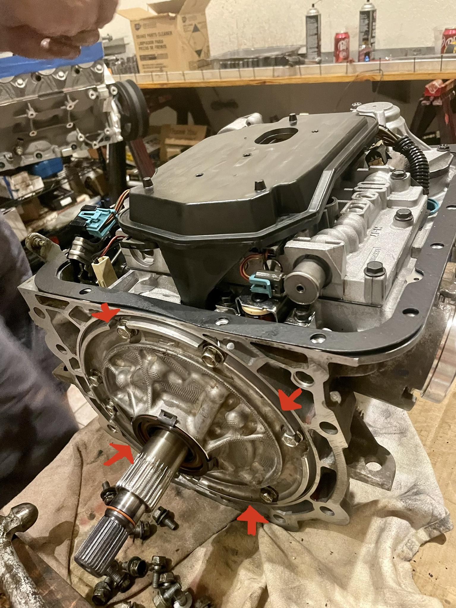

Well... I f**king jinx'd myself.
Drained the transfer-case and replaced with fresh fluid. Surprised that these BorgWarner cases only take 1.7 quarts. Stuff looked like it was long overdue for a fluid change! Feel like it should be changed more often that you think. Anyways, after filling the T-case, I filled the transmission with 10 quarts of Dex XI (overhaul/dry fill is 11 quarts) and moved on to filling the engine with the break-in oil.
After this, I noticed ATF dripping from the bottom of the truck. Doesn't take a genius to know that's not good. Under further inspection, it wasn't leaking from the pan or dripping down the side of torque converter, it's coming from behind the torque converter which means only one thing... the transmission is leaking from the front of the housing/oil pump. So the transmission has to come out again, but this time, from under the truck.
:mad:
Being upset was an understatement. I was so mad lol.
We went over everything. Double and triple checked our whole transmission procedures and found that we missed a quick but important step. Our oil pumps don't have an internal seal/o-ring, they are wedge-style pumps which means you press them in and bolt them down. However, the front/exterior of the pump does take a seal, and it gets pressed in between the ridges of the oil pump/case and the bell housing shown below. I think in our excitement having finished the trans, we bolted on the bell housing and dropped in on the frame with the engine. Luckily, we don't have to pull the pan or take apart the the actual transmission, just drop it and remove the bell housing.
Pic just showing the location of the missed seal.
Grateful to have Amazon Prime next day delivery. New seal came in and we installed it, and compressed it in with the bell housing. Such a bummer to have to backtrack, but that's the game we play. And for those that rebuild their own transmissions, be mindful that the seal kit you buy, may not have this newer style seal in it. Ours didn't.
Reinstalled transmission. Nice and final (hopefully) view of the Circle D Specialties billet converter.
Another setback. Pulled a couple of wires mistakenly and broke off a diode on the e-fans while troubleshooting them and disabling the fans. Attempting repair tomorrow when parts get in but wrapped up the rest of the engine bay for first start! Just need to do some wire management and she'll be all set.
​Never a dull moment

Hey bud. Yep, I know the JBA shorties will clear the frame no problem, and no issues with the steering column either! But they don't bolt up directly to stock exhaust. And I don't really like their portside flange design. Other than that, they are decent. Here's an excerpt I wrote up for another forum member the other day.
-- The passenger side exit is aimed nicely parallel to the frame. The driver side is a little bit more tight but it fits on my vehicle without any modifications to the header or surrounding parts on my truck (besides the receiving stock exhaust). The stock exhaust will only be a little bit off on the passenger side but you should be able to fabricate the little misalignment there. The driver side however is quite a bit off, and it does aim the output in an area that gets tight/close to the frame but the headers themselves clear just fine.
Here is the passenger side showing how nicely it falls into place. And then below, my driver side. Don’t pay attention to my booger welds, this is just a temporary set up to finish my swap before I have an actual exhaust shop weld me in a full system lol. I am by no means a good welder! :weld: :giggle:
