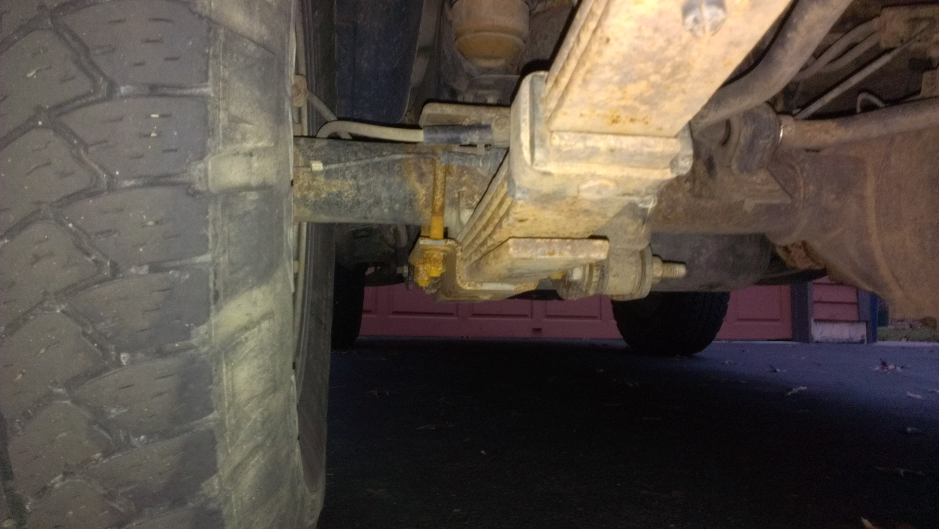

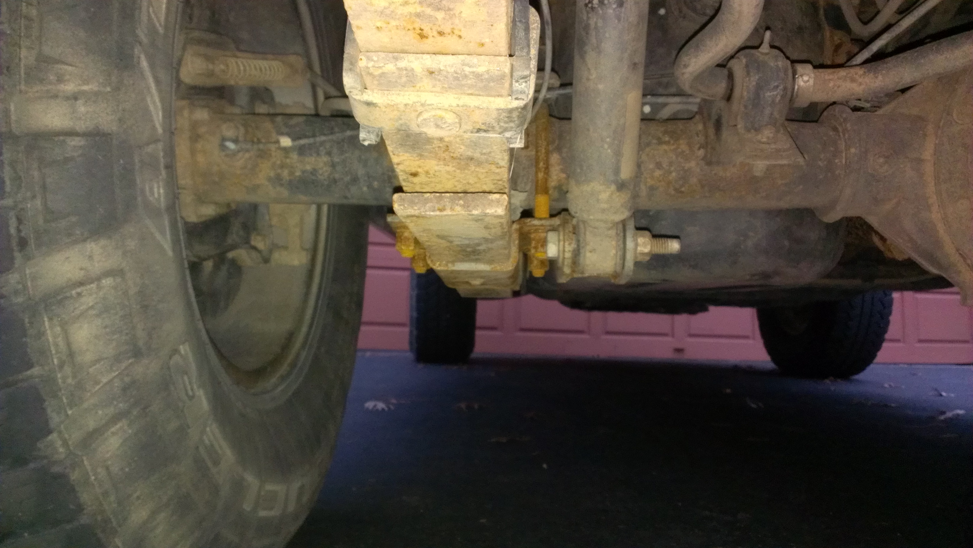

Okay, I had the new mounts put on today and chose to put the OEMs back on. I have a safety concern after seeing them on my truck.
The tabs outside of the springs started to bend upward once the proper torque was applied to the u-bolts. Also, the u-bolts sit apart more, just barely grabbing the re-enforcement on the top of the axle.
With the type of wheeling I do, it was recommended by my mechanic to put the OEM mounts back on. I am not sure what needs to be modified to make this work properly. Maybe some of our seasoned metal workers can give some insight.

Proper torque!? That is too much torque, they should only deflect a little. Just enough to pre-load on the U-Bolt Bolts so that the metal acts like a lock washer so the bolts can't loosen up. Also the bolt on the shocks are backwards, you have to reverse it. Which also means you have to thread the bolt for the shock before putting the High Clearance Mount on the leaf springs. My intention isn't to sound rude, but to inform you that who ever put those on wasn't paying attention to what they were doing.
Trust me there was nothing wrong with the design, I drive my Hummer entirely to fast around turns and have wheeled it the crap out of it and have no problems. I literally just took these photos and this is how it should look.

I would also like to add that I intentionally designed the High Clearance Leaf Spring Mount to deflect a bit so that you have better chance seating the U-bolts better on the axle braces.
Really, you purposely designed them to bend? I have $100 to bet you that the outer portion that holds the shock will also bend when the vehicle bottoms out hard because you raised the shock up too high...LOL. I'm not buying that your plates only raise the shock up 1" as you noted in your previous claims. I am betting that it's more like 2" which will certainly bend those thin un-braced plates when bottoming hard on rear suspension. It can clearly be seen it's more like two inches in the pic you posted with the measuring tape, yet you went on record to state it was only an inch?
If the proper torque spec is causing the plate to bend and you say that is to much torque, that I would suggest you let everyone know what the proper torque for these plates is? I would then include a safety disclaimer that your plates do not meet the GM spec and require a reduced torque specification.
On a serious note, do you really think if they are bending this easy from just tightening the bolts that the part extending outward for the shock is even remotely strong enough; especially considering you raised the shock up beyond the maximum amount of travel available before the jounce jumper engages the axle stop?

I don't mean to play the bad guy here, but it's time to speak up. The more I look at this plate, the worse my thoughts of them are. So, the spring pack is pushing down and the axle housing is applying upward pressure on the u-bolts and plates. Everytime you hit severe bumps in the road, there is risk that the tabs on side of the plates could get bent upward. Over time, the sides will be bent up enough where the small leaf spring indention that goes into the hole in the center of the plate is no longer in the hole; thus allowing the axle to move side-to-side sperate from the leaf spring pack. Cbetts has noted that there is already barely any of the u-bolt resting atop the perch on the axle tube. Thus, barely any play in this assembly is going to allow the u-bolt to slip off the perch and now the axle is flowing freely on the spring pack. An additional concern is that each time the sides bend upward (given that they were designed to bend), the nuts will become looser and increase risk even further.

trust me when I say that you got thiso all wrong, they used an impack gun and cranked the piss out of the bolts, and when I say it bends it is nothing like you're talking about.

Well, that's what you said last time I warned that the design was prone to be bending. No worries, time will tell so I will sit back and watch.
