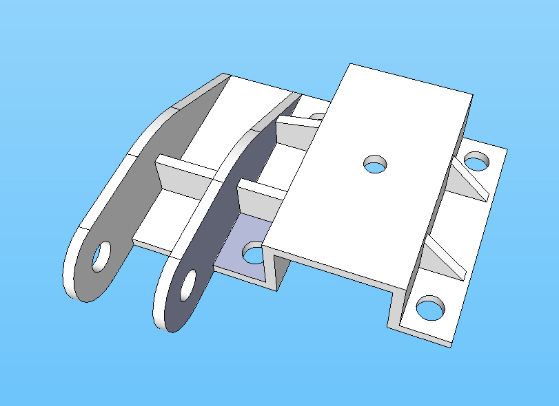

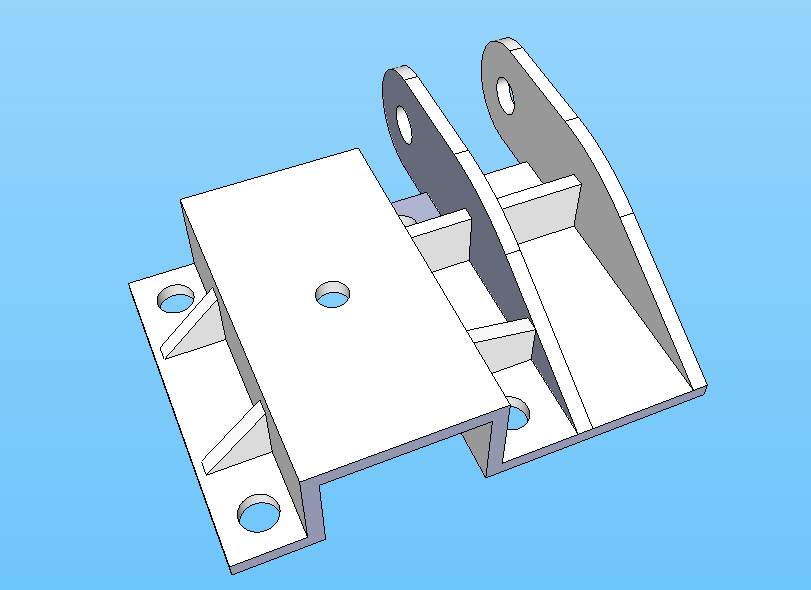

I thought I managed to get all of my High Clearance Leaf Spring mounts back and modify them with additional metal pieces. However if you have the first design that doesn't include the additional bracing similar to the photos above, I recommend that you ship them back to me. As long as you pay for shipping, I'll weld on the additional pieces and ship them back free of charge, even powder coat them again if you paid for it.
I haven't had any failures, but you cannot use the factory torque specs, something I over looked. I ran that version for months on my own H3, and even wheeled on it with no problems, but I would rather weld the additional metal on.

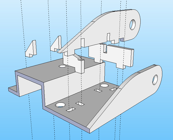

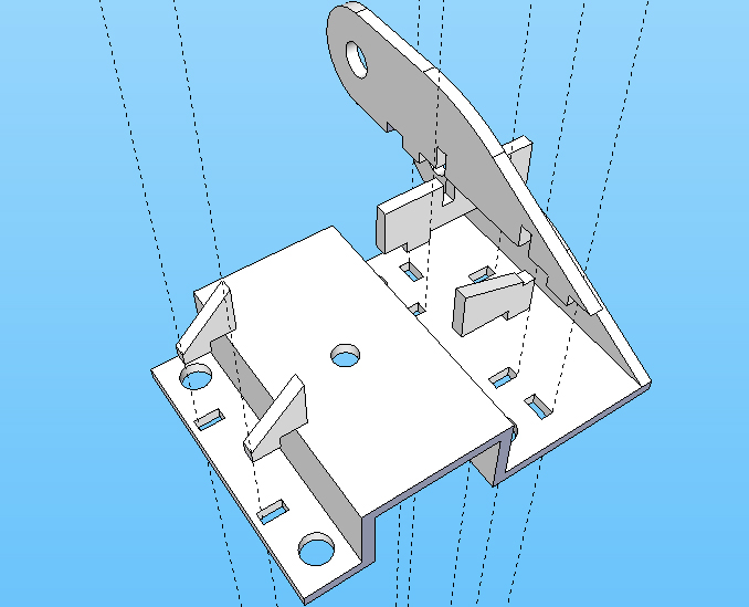

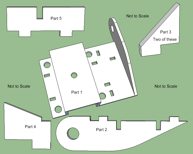

The newest design is mainly to improve the look of the finished product and make it much quicker for me to weld together. The slots mean that I won't have to take and measurements or have pieces shift when putting the heat to the metal. It will however be stronger, not that they need it. The design won't be any easier to install and the dimension overall will be the same.
