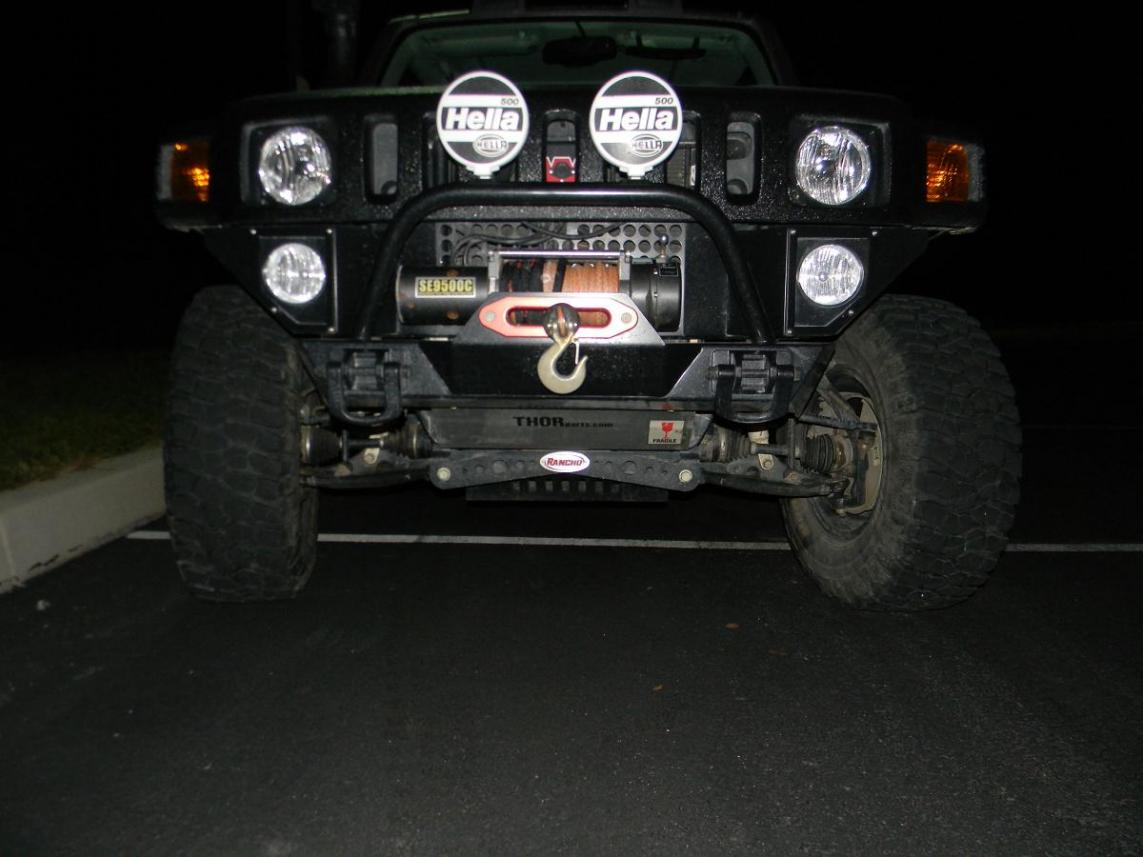

Since you said your hub to fender in the front was 23 you want it at like 26. Thats how rancho is...maybe 05 mudiak can attest to the tuff country hub to fender recommendation but I assume its the same seeing they are both 4in lifts. After cranking them make sure that your halfshafts are still level! You want them to look like this:
Not like this: This is exaggerated seeing he is flexed out but if everything is angled like this then you went too far.
http://www.flickr.com/photos/bigkurt/6222456510/
Chris, here is how my CVs are right now... As you can see, I have a lot of room to go up. They're very low.
9,505
AHHHHH holy ****! that is way low!!! your gonna have to crank those damn things like 30 times! your gonna get an arm workout
I'll have the install shop do it with power tools! :) These rear springs not working really f*d up the lift. Hoping Monday that they will be able to help me sort things out.
Funny thing is, even as it is, the truck is still noticeably higher than it was pre-lift. I hope to get everything to how it should be ASAP.

that is really low. Hopefully they can have you up and running the way you should be soon. Now that I just went out and checked maybe my CVs are a little high. I guess I could come down a little, but I am only at 26". The instructions recommended 26-26.5 so I should be good...I hope. I think youd have to be around 25" in the front to have level half shafts
Yeah, so I definitely see that the front needs to come up...but I cannot really do that until the rear is solved. Thank you all for the photos and help on my questions. We'll get Barney right eventually! :)

I concur. Might as well make them level even if you dont like the looks of the rear sagging at the moment.
Well, I am driving >30 miles/week right now, so I'm not tearing the CVs apart by any means. I'd like to get the rear figured out and bring it all up at once -- it also means one less trip to the shop in town.
