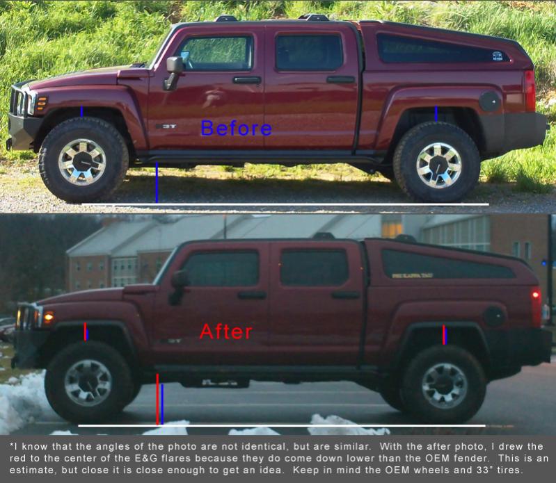

H3T Hans3T's Tuff Country Build

Once there are 35"s on the truck, I'm sure the transformation will be even more noticeable.

Looks good Hans.. That extra lift really helped to set it off I think.. Good job...
Thanks kindly! It really gives the T a subtle, yet bold stance. I know that's sort of contradictory... My point is this: The lift looks good, but is not noticeable like a 6" lift on an H2 or a Ram/F-250/etc.
EDIT TO UPDATE: After my mechanic worked on the front end some more, the lift is much more noticeable. I also added extended shackles in the back, which really helped a lot. The T definitely has a lifted look now, but is still far from a "wild" lift.

Ok, so I just measured the distances from the center of my wheel to the fender lip: Front: 23.5-24" Rear: 24.5-25"
The tech who installed the lift said I only gained about an inch or so of height in the rear...I looks like more than that to me, but I'm trying to figure it out. He also said they didn't bring the front up as high as it could go because the rear was not raised too high.
I parked next to a stock H3 last night for the first time and did not look as noticeably larger as I thought I would...
Couple of questions for you all:
Can anyone give me the distances from the center of the wheel to the fender lip for stock ride height? -- Seems OEM height is 22.5" front and 24"ish rear.
Also, to bring my front level with my rear height, would that just require a t-bar adjustment, or is there more to that? -- 06 H3 has informed me that this is correct. It would just be a simply t-bar crank now to get the front up to around 26" where it should be. I'll need to use a 1 1/16" socket.
EDIT TO UPDATE: I took the truck back to my mechanic to adjust. He couldn't bring the front up too much before because the rear add-a-leaves were not lifting much. Once I added extended shackles in the rear I was able to have the front brought way up and give the truck the height it was supposed to have.

WHAT?!?!? thats low!
Stock is 22.5 for the front and rear is 24 or 24.5
After the lift you should be at 26 to 26.5 front and rear. I am at 26 with flat CV's in the front and rear I am at 24.5 with the new springs and 24 with the first rancho set
At this point, I think my truck is more "leveled" than lifted because my rear add-a-leaves didn't really add much height I guess. I'm going to be in contact with TC to see what they suggest.

Seems like the rear add-a-leaves did not add the 3" they were supposed to, and that is what is A) keeping the rear too low, and B) forcing the front to stay too low so that it does not ride at a baja truck stance.
