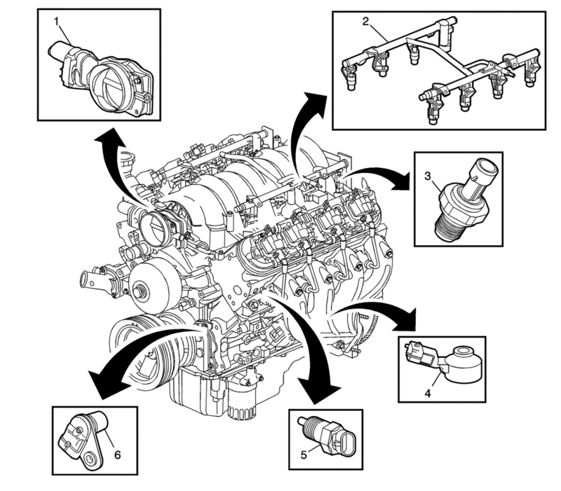

thanks guys! I am going to add a mechanical oil pressure gauge. I killed the inline 5 because by the time my oil light came on it was too late. Dont want that to happen again. I am thinking about those oil filter sandwhich plates that have a threaded insert for the oil pressure line
9,505
Ive been doing some searching around and whats your guys opinion? I can drill/tap the oil cooler block off plate above the oil filter, use a sandwhich plate adapter or drill and tap on the top of the motor by the OEM Sensor. Is there any benefit to having the pressure read from the top of the motor vs the bottom? The bottom seems easier.
Oil pressure warning light sending unit should be on the back topside of the motor (item #3 in the diagram). On past motors I have removed the oil light sensor...installed a tee fitting...then put the light sensor back in place (usually sideways due to the tee). Then on the other end of the tee I install the mechanical gauge sending unit. That way I get to keep both...the light and a mechanical gauge.

What he said. Don't drill and tap anything, please. One slip and you puncture through the oil galley or cross thread the tap and you have just hosed up your block.

As someone who has dealt with the same setup on my last two motors, go with the T fitting and an electronic sender. Way easier than attempting another solution. Cleaner too.
I think that's a roarin' good idea. Now that you're at this point you want to protect your investment. On the F-body oil pans there is a fitting that is retained by two M6 bolts just above the oil filter. Does your oil pan have this fitting? Check out Street and Performance. In one of my LS books there is reference to just that part that is already drilled and tapped.

As for drilling and tapping I really really didnt want to do that into the top of the block and was a last option. I havent looked at the piece in the picture closely under my truck yet but it is removable so if I had to drill and tap it that is a WAY safer option.
a T fitting is an option too...Thanks for all the input so far guys and to anyone else reading this, dont consider this v8 related. I5 guys can benefit from this too knowing your engine vitals is important. Its crazy we live in a society where we have ditched a good ole gauge in favor of a big red tea kettle looking light. Its also just as crazy that you can lose pressure and destroy a motor faster then that light can turn on so having a gauge is a good thing to add.
I havent driven it since the oil light came but I did have to move it out of the driveway and the oil light didnt come on. I did do a google search and this issue seems more common then broken H3 front diffs (that comment is for you 4speed :)) there are literally hundreds and hundreds of posts that just continue on about vehicles with 5.3s that had their oil light come on then they turn off the motor start it back up and it goes away and its fine. Supposedly those sensors go out and malfunction like nobody's business but I am not driving it till I get a gauge on it. Im not gonna take a chance even though its running fine and has oil.
