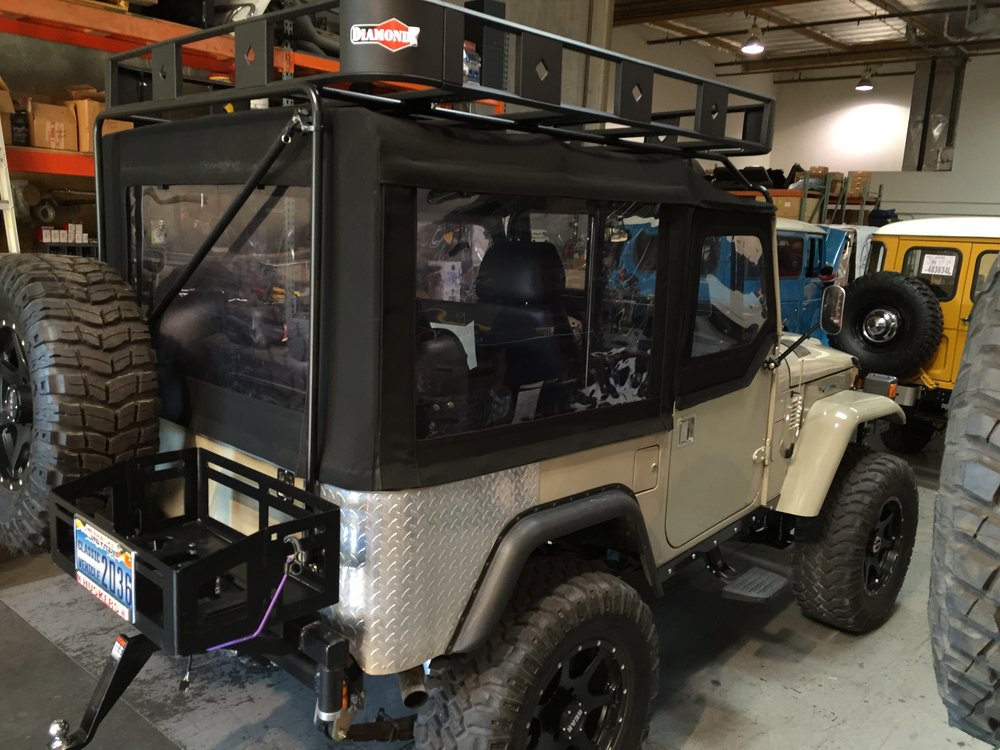

What's funny is I may not ever use the hard top. I plan on buying this soft top
